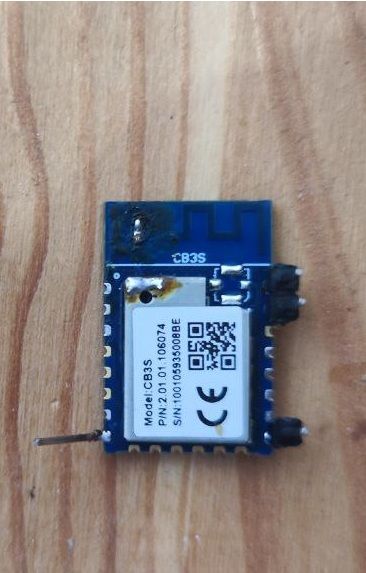

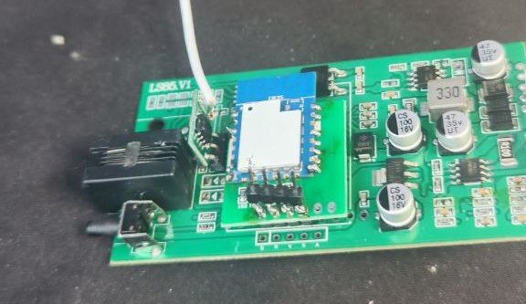

    I had a problem: the Wi-Fi board in my curtain motor (CB3S / BK7231N) burned out. I didn’t have the original backup, and flashing a dump from another motor caused a conflict in Tuya (one device connects while the other drops, then vice versa). In the end I built a proper local solution: OpenBeken + MQTT + Home Assistant, and everything works without the cloud.

    Where to get a CB3S board
    You can easily buy a Tuya CB3S (BK7231N) board on AliExpress — that’s what I did. I bought one заранее “as a spare”, and it sat unused for a long time until the original board in the motor burned out.

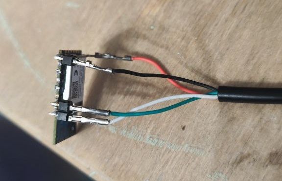

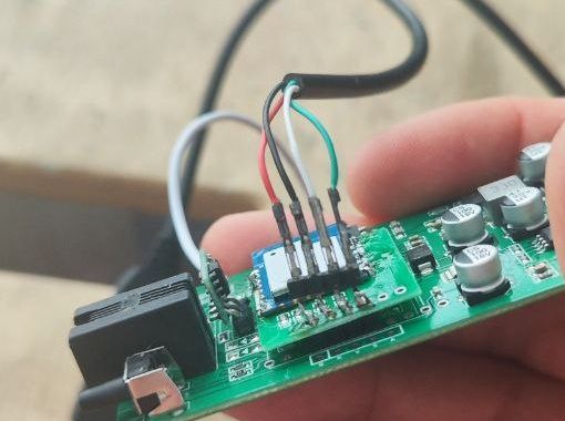

    1) Flash CB3S with OpenBeken
    To flash CB3S you need a regular USB-UART adapter (I used CP2102).
    Required wires
    Basically you only need 4 lines:
    GND ↔ GND
    3.3V ↔ VCC (3.3V only!)
    TX (adapter) ↔ RX (board)
    RX (adapter) ↔ TX (board)
    ⚠️ Important: power must be strictly 3.3V. Do NOT feed 5V — you can kill the module.
    Entering flash mode
    Usually BK7231Flasher shows something like “reboot device / power cycle”.
    Since I only had power + TX/RX accessible, I simply:
    removed power for a second
    and applied power again right when the program was waiting for a reboot.
    Tips
    If it won’t connect, swap TX/RX first.
    Make sure the adapter and the board share common GND.
    If the module keeps rebooting/glitching, use a stable 3.3V supply, not a weak 3.3V regulator on some UART adapters (depends on the adapter).
    Flash the CB3S (BK7231N) module using BK7231Flasher.
    ✅ Important: in recent versions of BK7231Flasher, OpenBeken is built in (there are ready images/firmwares inside the program), so you usually don’t need to search for and download a separate .bin file — just select OpenBeken in the UI and flash.
