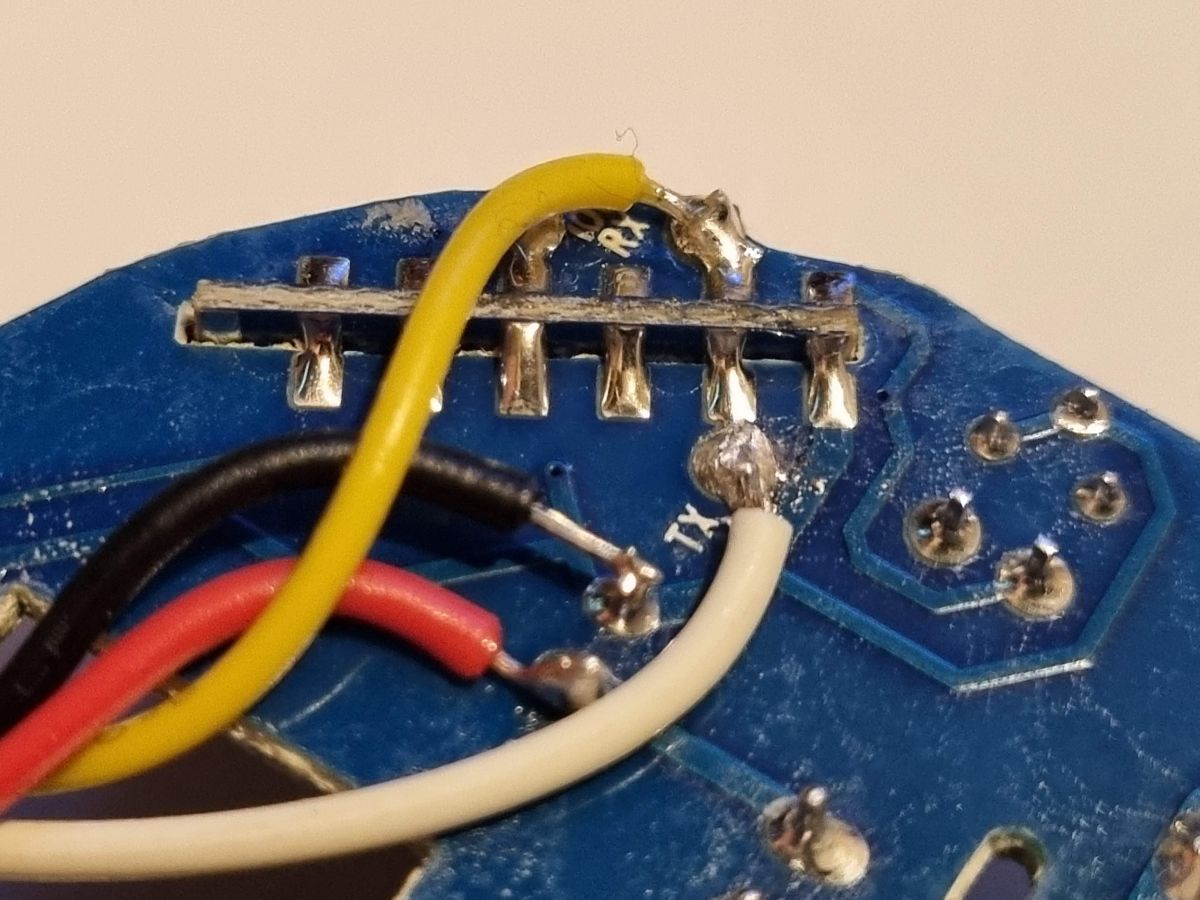

    I have a UK version of a Teckin SP23 Smart Plug, T112_v1.1 W302 (RTL8710BN), that will not connect to a BT Smart Hub 2 Wifi, but will connect to an Android Hot Spot.
    For anyone else trying to program this device:
    I opened the device up, soldered wires to TX, RX, GND, and the +V of C7 (before AMS1117 3v3 reg) and supplied it with 10V from an external PSU.
    The TX & RX are connected through an FTDI USB TTL-232R-3v3 for programming and debug.
    Holding the TX line low (for about 1 second) at power up puts the device into programming mode.
    Programmed using BK7231GUIFlashTool-build-233 (a really easy tool and would recommend)
    Firmware auto selected as OpenRTL8710B_1.18.251.bin

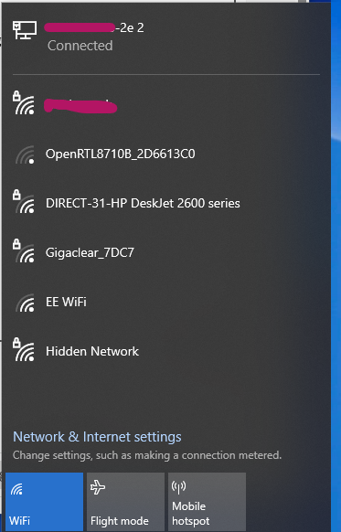

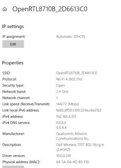

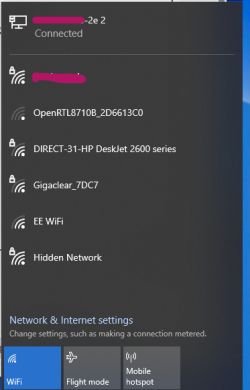

    After a bit more investigation I have discovered the following:
    When the device is in safe mode and broadcasting an AP, SSID: OpenRTL8710B_2D6613C0, on channel 1, 2.4 GHz, I can connect to it easily from my Android phone, with a really strong signal.
    However, my desktop PC, only just sees the AP, reporting a really low signal. It will connect eventually, but I cannot get any useful information through it.
    Windows showing a connection the OpenRTL device
    Screenshot of Wi-Fi settings for OpenRTL8710B_2D6613C0 connection in Windows
    Really low signal from the OpenRTL device
    Windows Wi-Fi network list showing OpenRTL8710B_2D6613C0 with weak signal
    The desktop distance is less than 30 cm from the device, the same as the phone.
    A quick scan of the airwaves shows there is nothing else around on channel 1 (which is the channel the OpenRTL is on).
    In summary
    1. My desktop PC cannot connect to the device's AP, but my Android phone will connect to the device's AP.
    2. The device cannot connect to my home network (BT Smart Hub 2) despite listing it as the strongest signal around.
    This is looking like a Wi-Fi configuration issue within the RTL8710B.

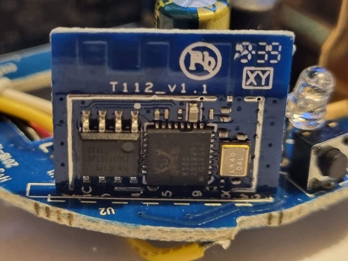

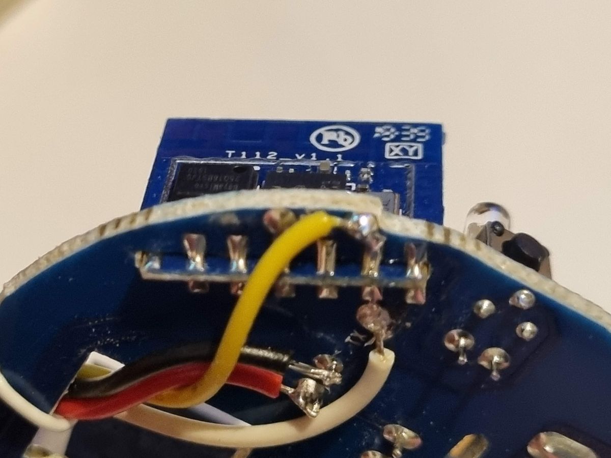

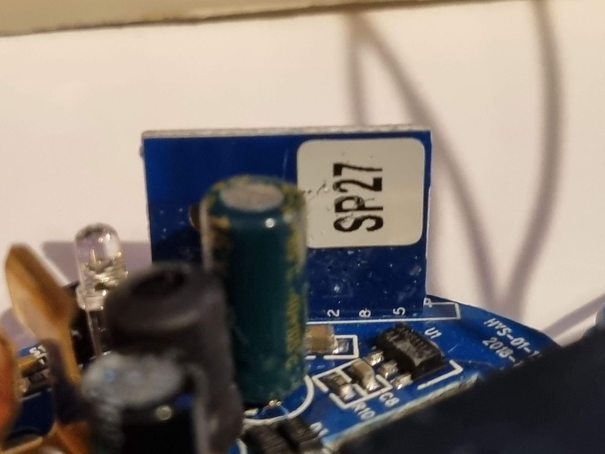

    Can you share a photo of your module, perhaps antenna is somehow damaged? (though i doubt it).
    RTL firmware itself is stable, my RTL8710B plug uptime is 3 month without reboots.
    Wi-Fi code is shared between RTL8710B, RTL87X0C and RTL8720D and is considered stable.
    Still, i believe it's a router problem. BT Smart Hub 2 hardware is based on broadcom, and they don't have a good reputation in open source community.

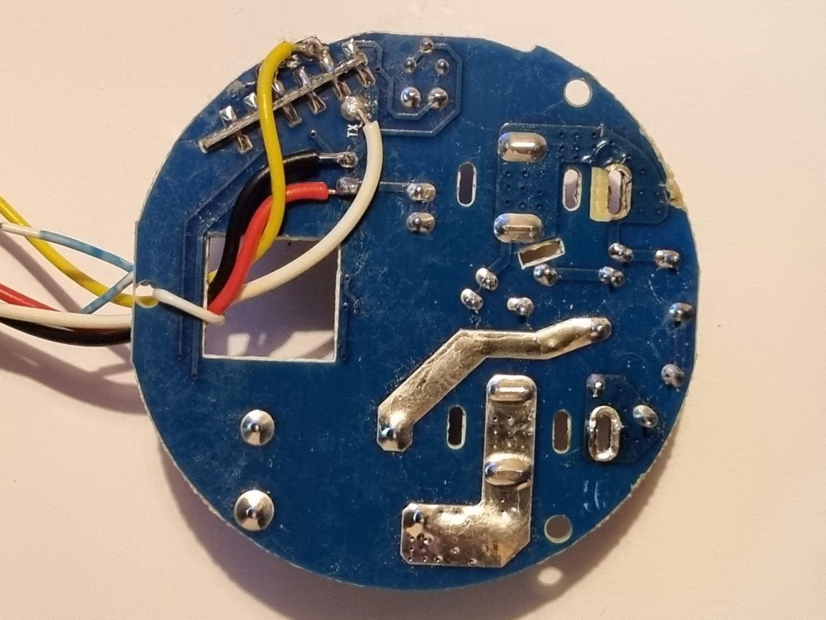

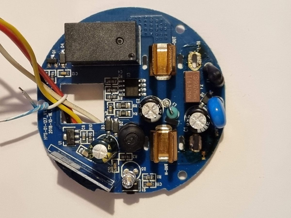

  • Restored Tuya firmware still fails to join Wi-Fi
    #10 21829332
    nigel945webb
    Posts: 9
    >>21828308

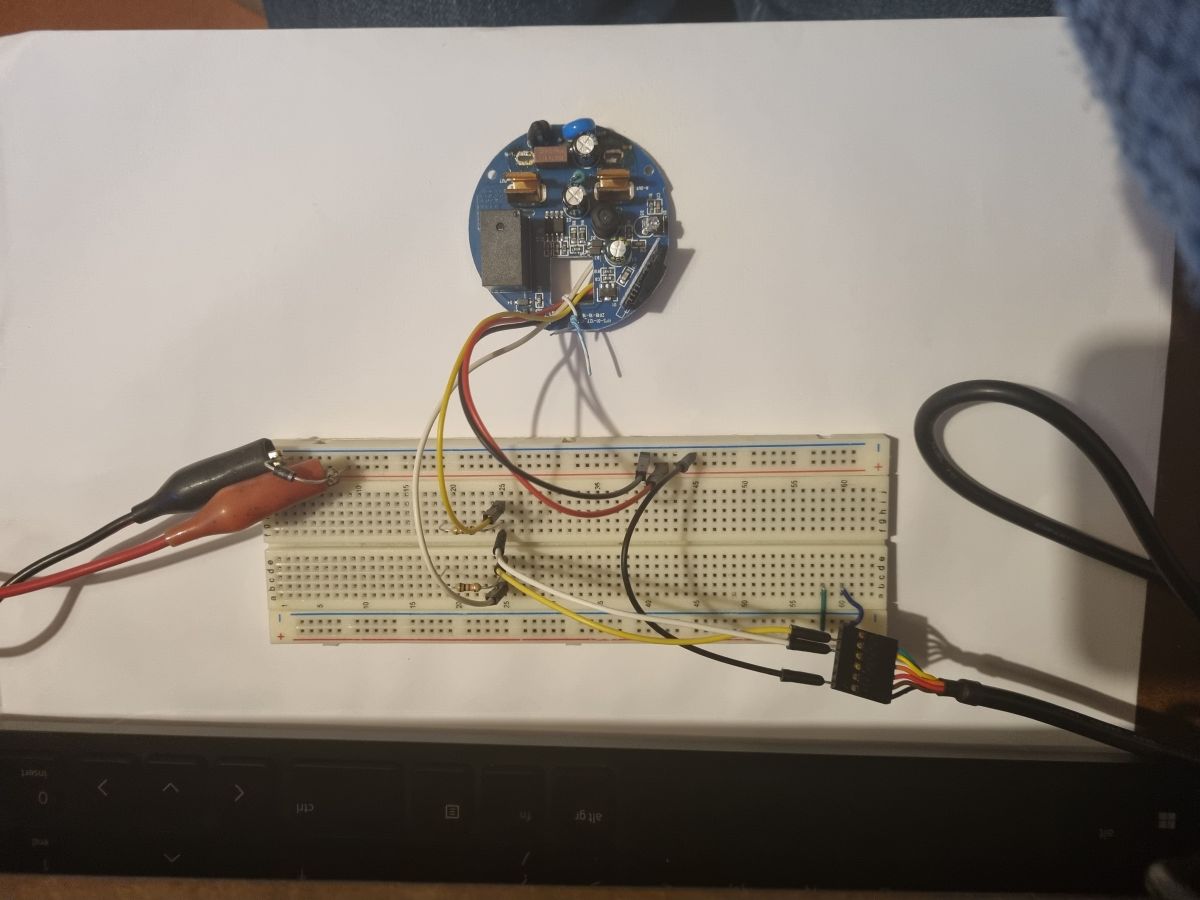

    Hi, I may be getting somewhere :-)
    Your comment about the release for these RTL chips being stable, and the question about damage has been very helpful.
    This device, before reprogramming, was running the stock firmware from Tuya, and successfully connected to the BT Smart Hub 2 for years. I had saved a copy of the Tuya firmware, so today I restored it, booted it up, and tried to connect to my home Wi-Fi (the Smart Hub) - and it wouldn't. This is a result! The fact that OpenBeken won't connect to my home Wi-Fi is duplicated with the Tuya firmware.
    Something has happened to the device during the disassembly that prevents it connecting to anything but an Android phone.
    Pictures attached of the device. I can't see any damage and I've looked really closely at the decoupling caps too.
    I think it's time to move on and put this one in the bin :-)
    Thank you (all) for your help
    Nigel
    PCB connected by wires to a breadboard; alligator clips on the left, a connector and cable on the right Round blue PCB with relay, capacitors, and a side bundle of colored wires Round blue PCB underside with soldered wires and large metal traces, close-up Close-up of a blue PCB module with ICs and the marking “T112_v1.1”. Close-up of a blue PCB with capacitors, an LED and an IC; “SP27” sticker in the background. Close-up of a PCB with soldered wires and a metal slide switch. Close-up of a device interior: PCB with soldered wires and electronic components. Back of a white smart socket with three UK pins, a QR code, and printed electrical markings

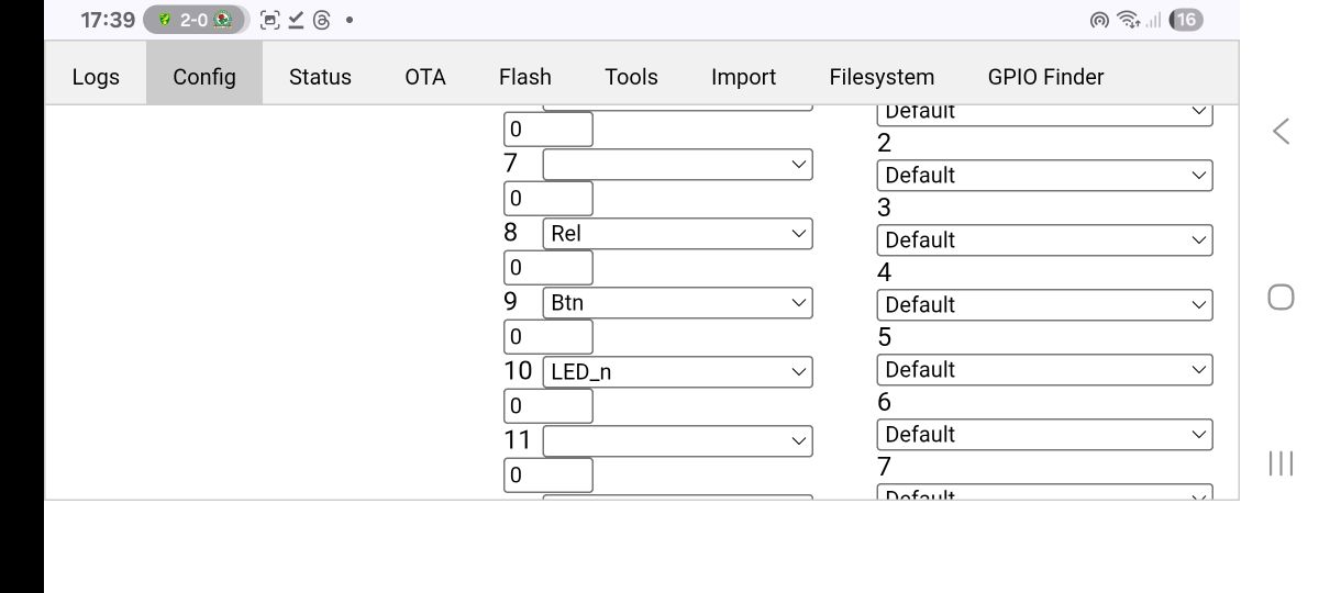

  • Manual Tuya config created after extraction failure
    #14 21832080
    nigel945webb
    Posts: 9
    >>21832013I am unable to extract the Tuya config by using the Webapp download (72 kB) and extracting in the BK7231 Easy UART Flasher. It reports: Failed — see log for more details — Failed to extract Tuya keys — magic constant header not found in binary
    So I have created my own config that appears to be doing the correct thing.
    Screenshot of a GPIO configuration panel with dropdowns and fields, including Rel, Btn, and LED_n entries.
    Screenshot of 10.108.48.37/cfg_pins showing pins PA12, PA14, PA15 mapped to Rel, Btn and LED_n
  • #15 21832140

    nigel945webb
    Posts: 9
    Tuya config file attached - the one I couldn't read.
    Tried the new version 256.
    Initializing Wi-Fi... OpenRTL8710B, version 1.18.256
    Unfortunately, it still will not connect to the Smart Hub 2
    I have a second Teckin SP23 that I'm just cutting a hole in to access the pins, without opening the whole case.
    Now I know a bit more about the process; I can try to see if this one works with the latest OBK firmware, and hopefully be able to revert it back to the original firmware.

  • Second SP23 works with OBK, confirming hardware fault
    #18 21833137
    nigel945webb
    Posts: 9
    On the 2nd Teckin SP23, I have downloaded the Tuya firmware with both ltchiptool-v4.12.2 and BK7231GUIFlashTool-build-233.
    The files are very slightly different near the end?
    I then re-flashed with OBK OpenRTL8710B_1.18.256.bin.
    After a reboot and config, this one connects to my BT Smart Hub 2. All looks good :-)
    That confirms that the previous/original Teckin SP23 had a hardware problem after disassembly, and it is not an OBK firmware problem.
    Thank you everyone for your help.

  • #20 21846888
    nigel945webb
    Posts: 9
    The Wi-Fi module must have been damaged during the disassembly, as reverting to the stock Teckin firmware also had the same problem of not connecting to the BT Smart Hub 2.
    On a second Teckin SP23 unit, I confirmed that the OBK firmware works and connects to my Wi-Fi.
    Thanks all for your help.
