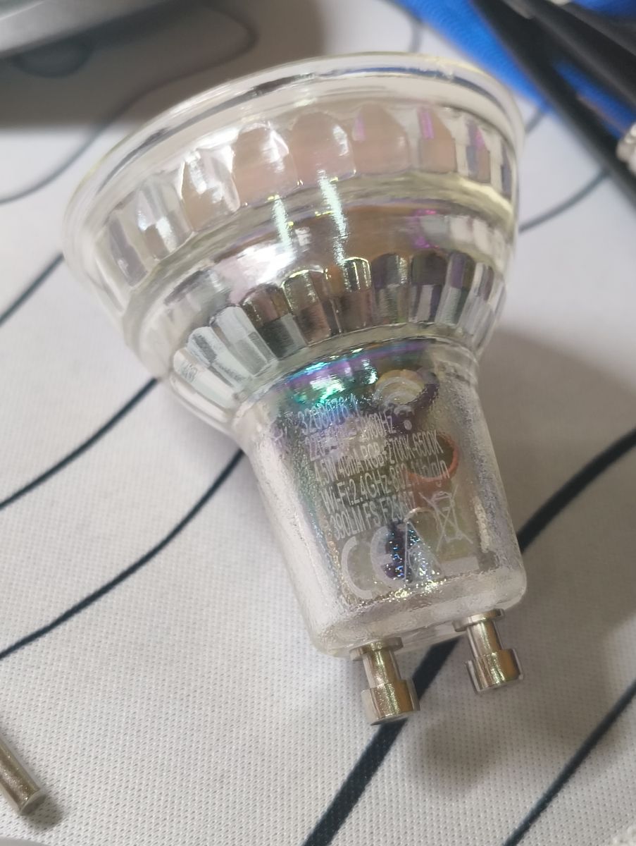

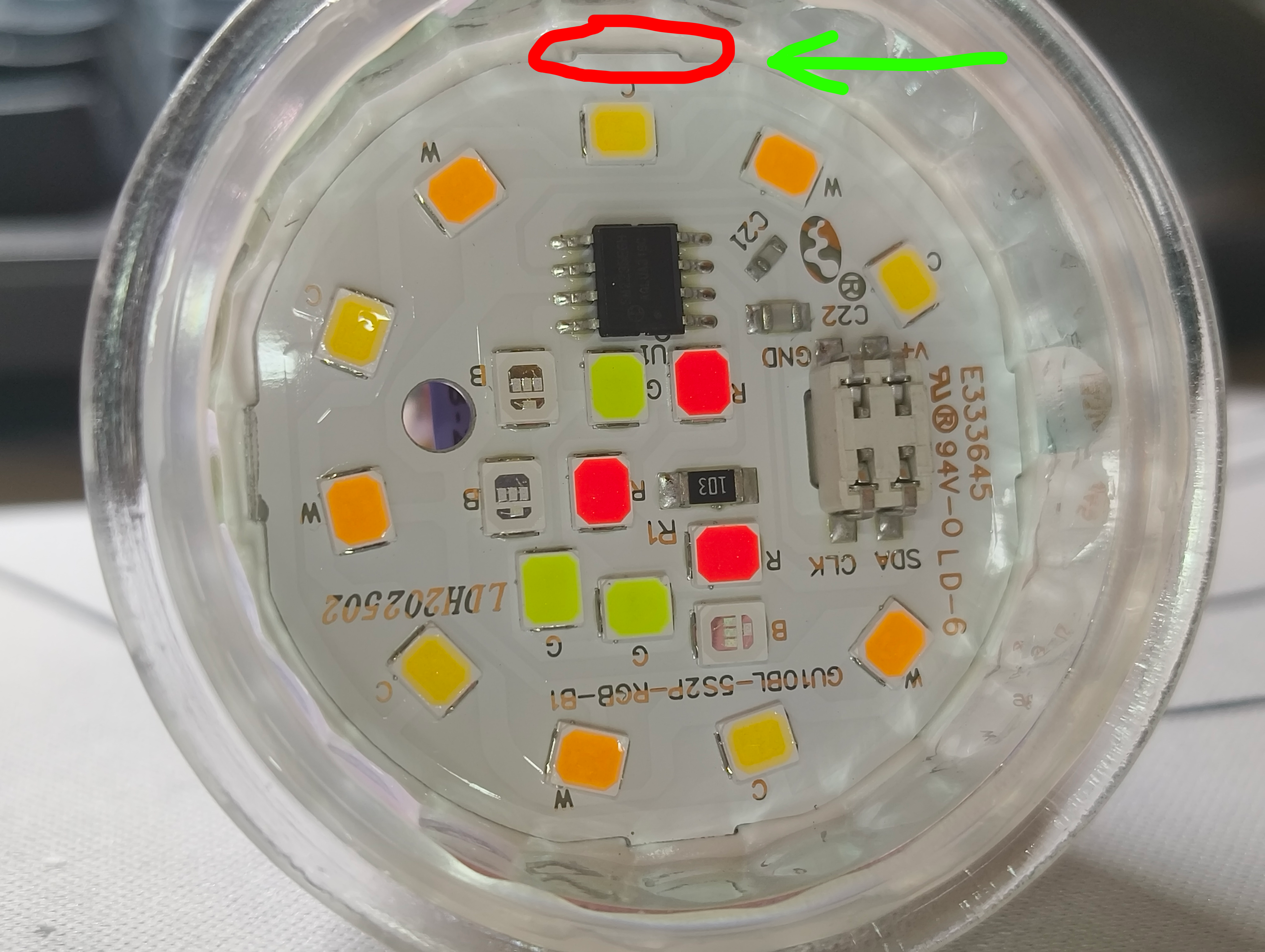

    This is a Teardown and some findings on the "new" 3-Pack LSC GU10 bulbs. Also some general findings on LSC bulbs.
    !! WARNING !! If you attempt to disassemble these bulbs be aware that it won't be easy. Not only because the whole body of the GU10 bulb is made of glass but also because you have to use excessive force to get the components out of the bulb.
    ALSO: Soldering to the T1 and R1 Pads is much much harder as with the "normal" E27 Bulbs from LSC (also 3-Pack) since directly in front of the pads we need to access are multiple capacitors.
    Continue at your own risk!

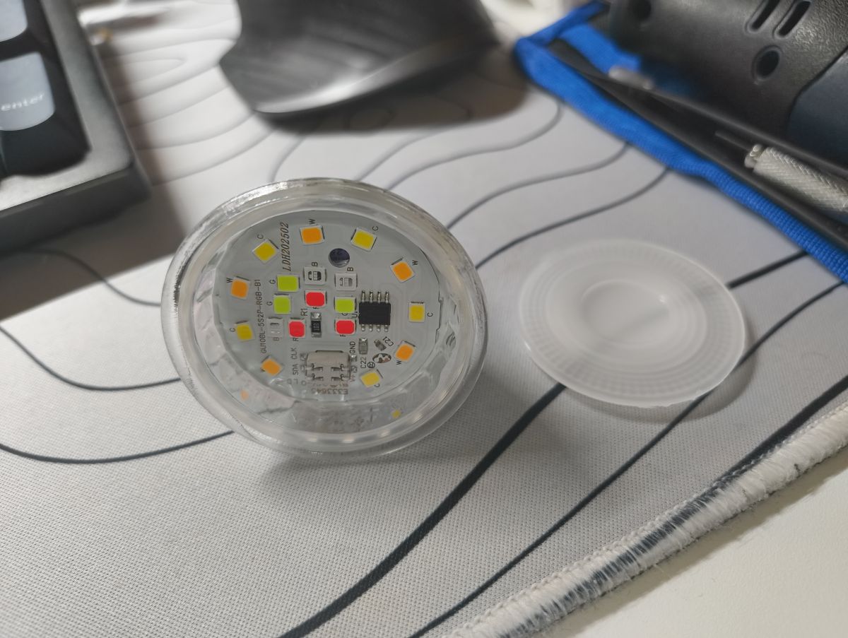

    The first thing you will need to remove is the plastic disk covering the LED PCB.
    Make sure to enjoy it!
    This will be the only easy component to remove in the whole disassembly xD
    You should be able to feel the gap between the plastic and the glass edge with your fingernail. Just stick something flat and pointy in this gap (like a small precision flat head screwdriver) and use the glass edge as leverage point. You will have to use a little bit of force since the plastic disk is lightly glued on.
    When you done you have this laying in front of you:
    Colorful RGB LED bulb on a desk next to a translucent plastic cover
    Next step will be the worst:

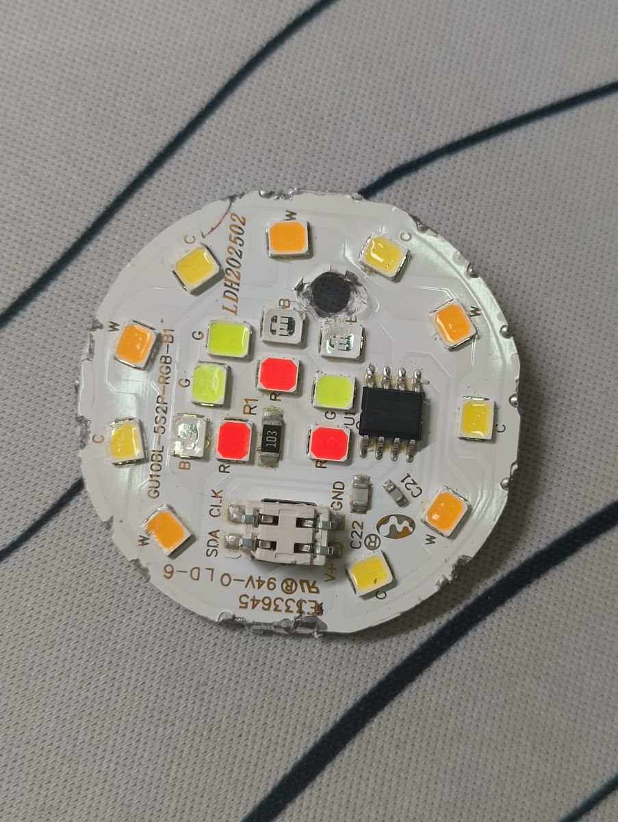

    Getting the LED board out.
    This will be really really hard since the LED board is glued onto a 4mm glass lip with silicone.
    It will take a lot of time and nerves to get it off.
    First of all use something sharp and pointy like some tweezers or a scalpel to scrape around the outside of the LED Board. If you look from the top you can see that there is silicone between the board and the glass wall of the housing which needs to go.
    Get as much of as possible by really scraping a couple of times around the board.
    The next step is to get the actual board out.
    What worked best for me was actually using the flat head screwdriver from before and leveraging the board off BUT sideways!
    If you try to leverage the board by basically leaning your screwdriver against the glass you will break the glass your board will still be stuck.
    You will need to actually get the screwdriver under your board from the side and leverage it this way.
    To explain it a bit better:
    Close-up of a circular LED board with RGBW diodes and circuit components in a plastic case
    The board has 4 "lips" each facing North, West, South and East.
    You need to get your screwdriver under one of those lips from the side (your screwdriver should point the direction of the arrow).
    Then once you are under the PCB you can try to slowly leverage it up.
    If you are lucky you get it out. If not continue with the one of the other 4 lips.
    You will maybe also have more luck if you but a little IPA (isopropyl alcohol) on top of the LED board, hold the bulb at an angle and turn it so the IPA gets to the silicone underneath the board. Let it soak for round about 10 minutes.
    Be aware that you probably will damage the LED board a bit on the edge. This is okay since there should be no traces so close to the edge and the better you get your screwdriver under the lip the less likely it is that you break off the lip.
    It is also extremely easy to break the glass so be prepared that you will waste one or two bulbs on this.
    Now lift the LED board all the way up until its free.

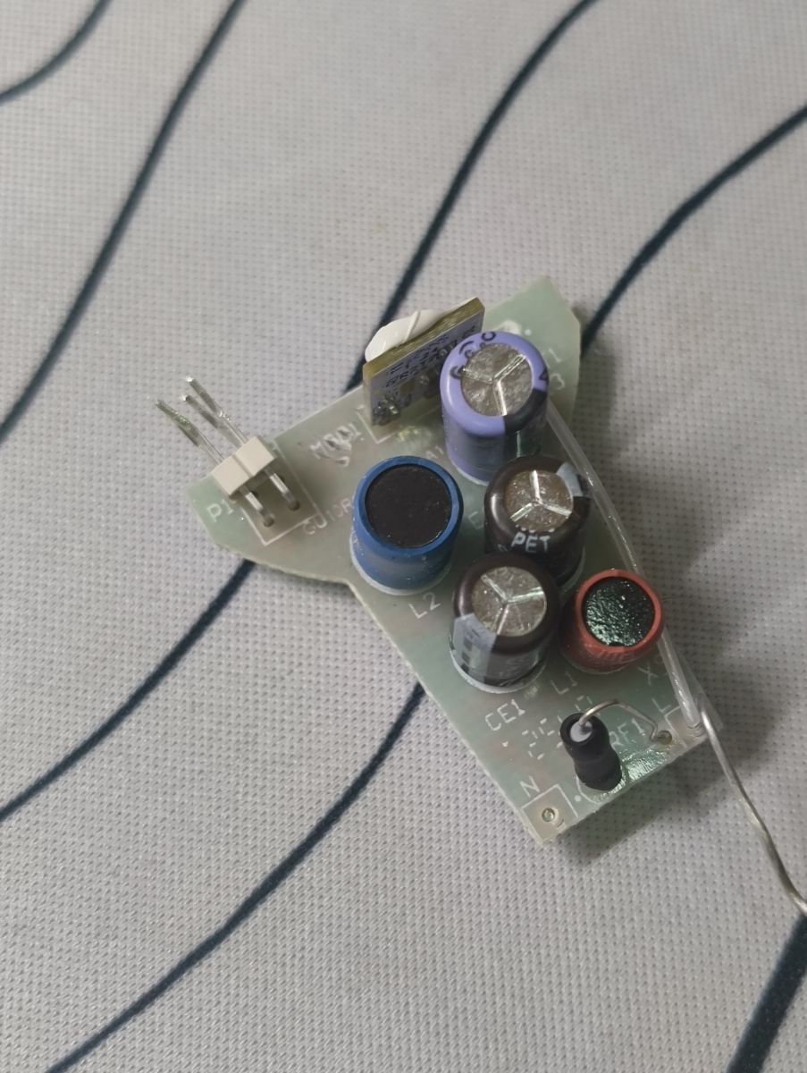

    After that you should see the green board with the BK7231N (CBLC5 Module) mounted sideways that is still in the housing.
    We actually also need to get this one out since the pads we need to solder to are on the backside xD.
    Since the board is somewhat v-shaped you can just use some rounded tweezers to put at the thinner part further down and slowly and carefully wiggle the board out.
    It is held in the housing by the two wires at the bottom that connect the board to the terminals. It is quite a tight fit so you will need to be very gentle when pulling them out so you don't damage the board or rip out the wires.
    Here you can see the board and how i grab it with my tweezers to get it out of the housing:
    Close-up of PCB with electronic components held by metal tweezers
    Now the worst part is done. Good job!

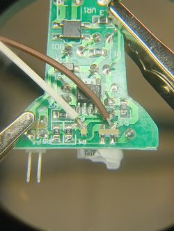

    Next step: Soldering all the wires we need for UART.
    Be aware that the BK7231N Chip only takes 3.3V. Most UART USB Cables output 5V.
    Be sure to use a separate power supply that outputs 3.3V and connect the GND Cable of your UART Adapter to it (VCC/5V Cable of the UART Adapter should not be connected to anything!). Connect this shared GND connection to the board as well as the +3.3V from your PSU.

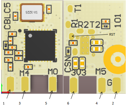

    Since the bulb is using the CBLC5 Module you can solder GND and +3.3V according to this schematic from the official Tuya website:
    PCB with labeled pins, SMD components, an IC, and a quartz resonator
    You will find the perfect contact points to solder to on the side that doesn't have capacitors and the CBLC5 Module sticking out (so the flat side is the right side).
    Here is a picture:
    Brown = GND
    White = +3.3V
    PCB close-up with soldered wires and surface-mounted components in metal clips

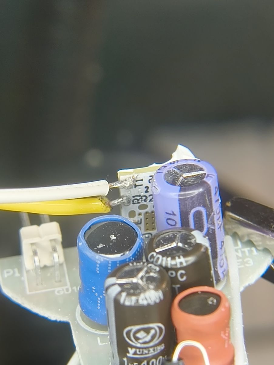

    Now on the backside of the CBLC5 Module (white PCB sticking out of the green PCB) hidden by a capacitor you will find T1 (TX) and R1 (RX).
    These will be a bit more finicky to solder but not impossible:
    Close-up of electrolytic capacitors and wires on a PCB
