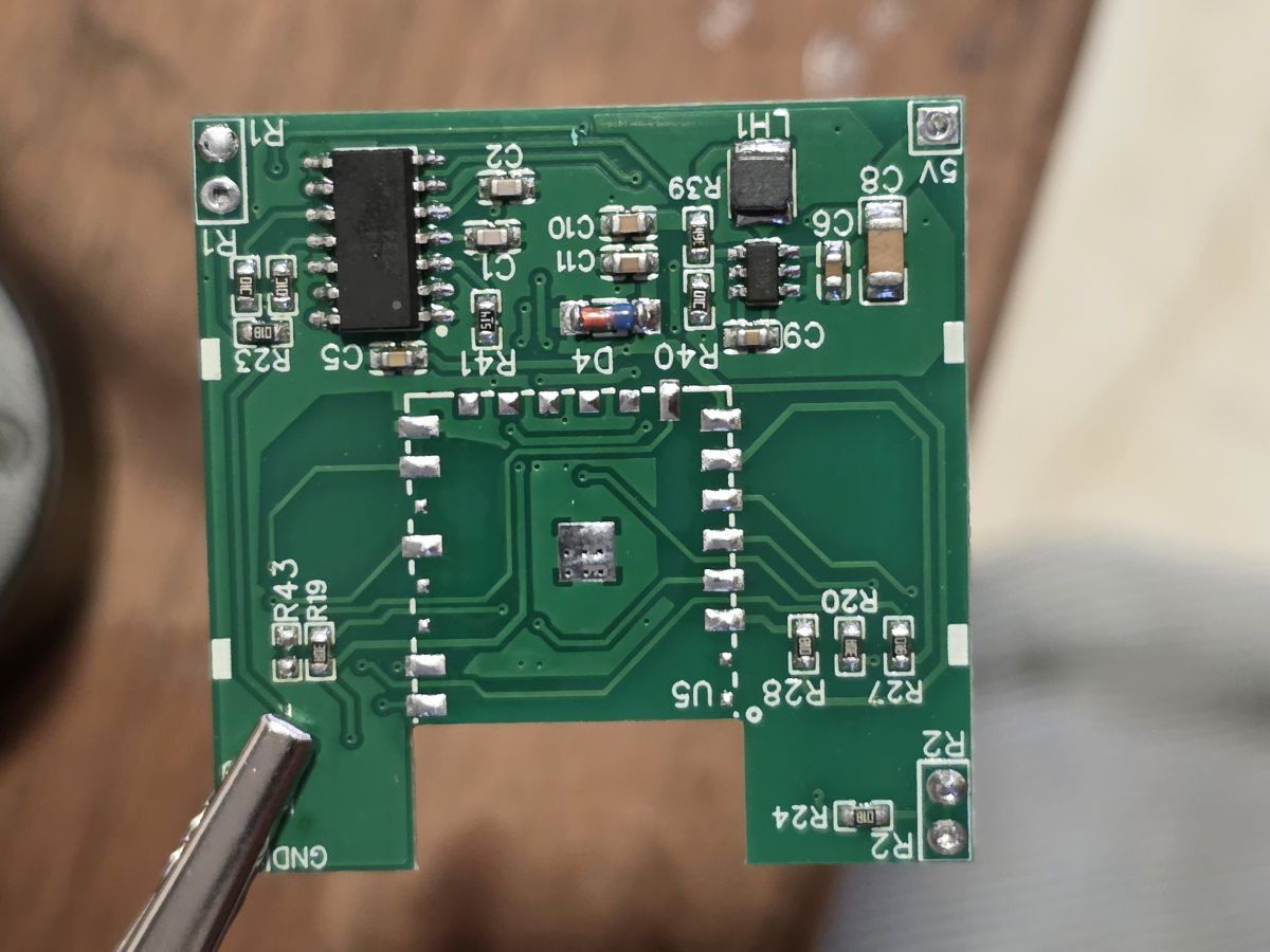

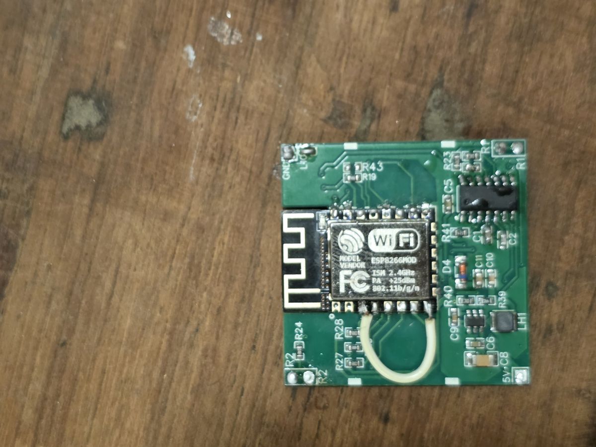

    I’m working on a homemade / modified 4-channel relay board. Originally the board used a Tuya CB3S (BK7231) Wi-Fi module. I removed the CB3S and replaced it with an ESP8266 module (ESP-12F / ESP86322) so I can run ESPHome.
    The ESP8266 is working perfectly:
    It boots correctly.
    Connects to Wi-Fi.
    Shows up in ESPHome.
    Web UI works.
    Status LED (GPIO2) works.
    OTA updates work.
    But the relay outputs do not switch, no matter which GPIO I assign in ESPHome.
    What I already tested:
    5 V rail is present (about 4.8 V), regulator outputs 3.3 V correctly.
    ESP8266 VCC, EN, GND, GPIO0, GPIO2, and GPIO15 are all wired properly.
    ESPHome firmware is running.
    Web server control panel loads.
    I tested GPIO4, GPIO5, GPIO12, GPIO13, and GPIO14 as outputs.
    None of them activate the relay/triac drivers on this board.
    Touch buttons also don’t trigger any change in the GPIO inputs.
    My suspicion:
    The original relay driver traces may not be connected to the pins I assumed, or I may have missed a trace that was originally routed under the CB3S module.
    What I need help with:
    How to correctly trace which GPIO goes to each relay driver (there are 4 channels)?
    Whether the CB3S had internal copper bridges that the ESP8266 does not recreate?
    Any known pin mappings for 4-gang Tuya touch/relay boards?
    Advice on identifying the relay control lines (R5 / R7 / Q1 / Q2 etc.)?
    Confirming whether I need to restore any missing jumpers / traces under the CB3S footprint?
    If needed, I can provide clear PCB photos (front, back, and close-ups of the relay driver section and CB3S footprint).
    Any help would be greatly appreciated — I’ve got ESPHome fully running but cannot get the relay outputs to toggle.
    Thank you!

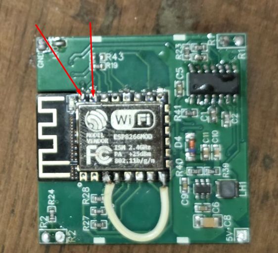

    Is the MCU connected to those pins?
    ESP8266MOD module on PCB with red arrows pointing to specific GPIO pins
    Maybe it's TuyaMCU device - with UART protocol.
    Can you show more device photos?
