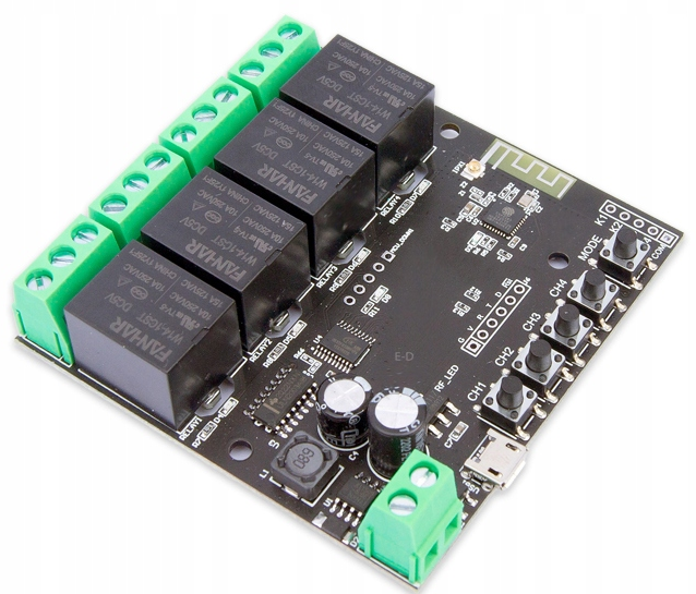

    Hello forumers.
    I have bought from a well-known portal TUYA DC 4CH Voltage free WiFi NO/NC relay
    Pinout and wiring diagram for TUYA DC 4CH WiFi relay ESP8266 for custom code .
    Do you perhaps have a diagram or recognised leads from the ESP for the relays and buttons.
    I need this to write my own control code.
    Best regards
  • #2 21145576
    Posts: 14763
    Rate: 12893
    Rather a diagram is not available, but you could look for Tasmota's template here:
    https://templates.blakadder.com/
    Although without a specific model it's hard.
    On the other hand just searching the GPIOs is not a problem, in Tasmota for example you even manually set 4 consecutive GPIOs per Relay and investigate if something happens as you switch their state.
  • Board uses ESP8285 and hk32f030mf4p6 controllers
    #3 21146955
    Marek320
    Posts: 86
    Rate: 7
    Thank you mate for your reply.
    This is how I am going to test the pins experimentally, just waiting for the programmer - maybe it will arrive today.
    The board has a USB socket for 5V power only.
    The link to Tasmota is also interesting and I will use something on it.
    If anyone would like to use this module for their own purposes, I will hint that there are two processors on board: an ESP8285 for WiFi and a hk32f030mf4p6 for DI and DO.
