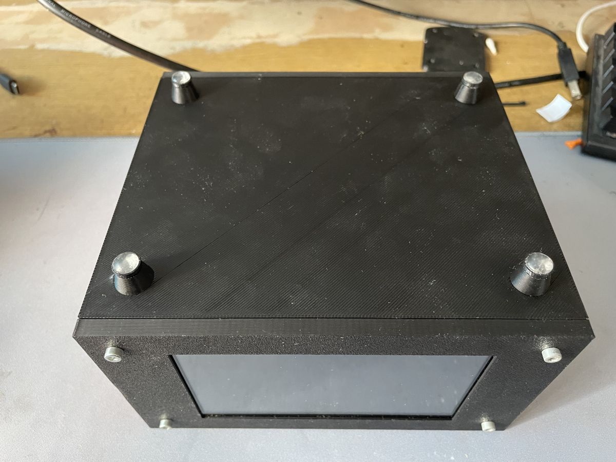

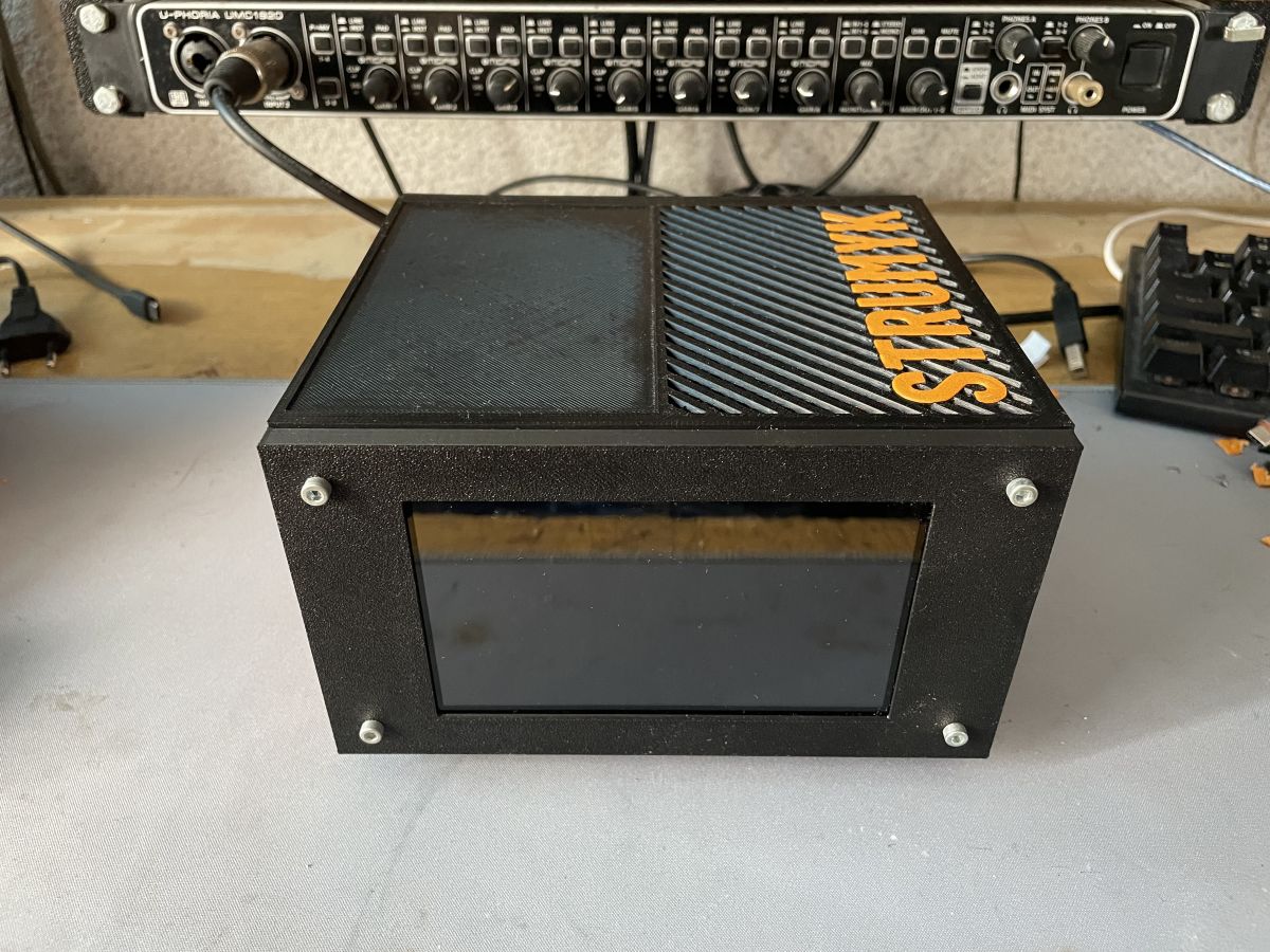

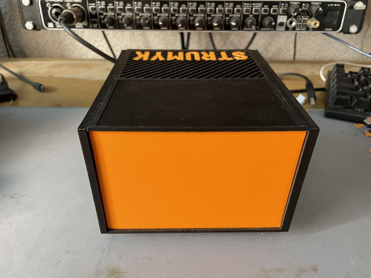

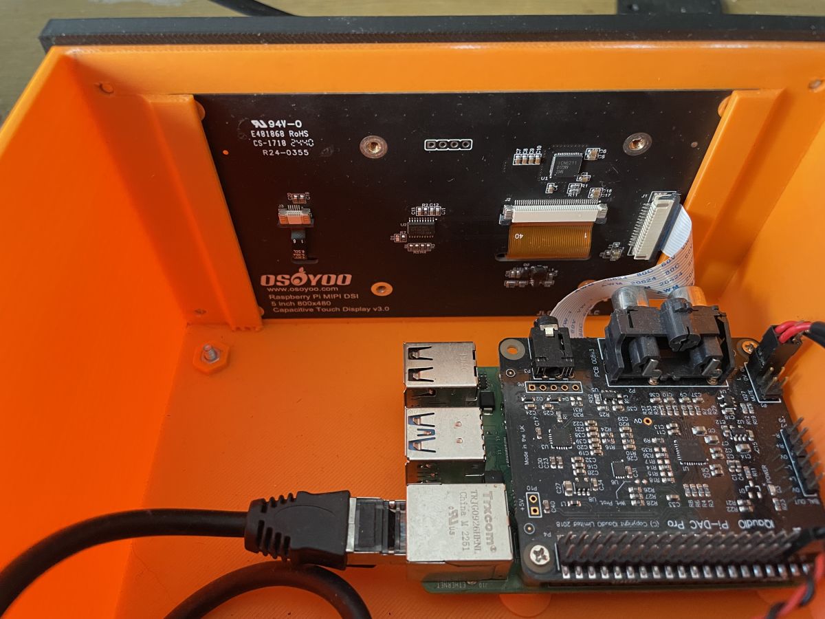

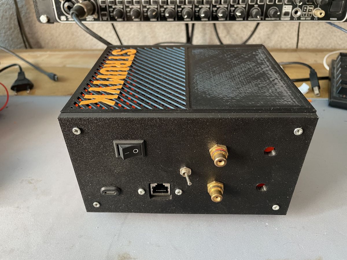

    >>21752128 here you go, here are pictures of the device from every possible side (I think) :p
    Black device with a front screen and STRUMYK text on the top surface.
    Black electronic device with orange front panel and “STRUMYK” label on top
    Black plastic device case with switches, ports, and SYRNYX label on top
    Black rectangular device with screen and four conical feet on the top surface
    Raspberry Pi board and OSOYOO screen inside an orange enclosure with connected cables
    >>21752572 That black what the user marked is the line made by the marker. on the 2nd photo you can see my hair (i hope nobody will trace me by that), and as for those things around the screws it is indeed a printing error, but i assure you that the whole housing has no cracks. it's good that it came out, because I didn't add that the version I'm showing is my version, on which I tested a lot of solutions that were corrected in the final version, so you can see a lot of "shortcomings". For me personally more important is the external appearance, which in my product, is simple, minimalist, and clear :)
    acctr wrote:
    As it stands, the case could just as well have been made of cardboard, painted orange with crayons with a "designer" logo, the texture would have been better and the case would have gained because "hand made".
    i see that some people really cultivate the stereotypical electrode
    >>21752574 and this is the kind of opinion I like and respect very much. you express your opinion, not attacking but substantively writing what is wrong. Thank you for the plus!>>21752769 I created a manual that also required a lot of work from me, so I decided to put it in the paid version. As for the feedback, so far I have not received any messages from people who have bought the product, but yes clearly, if there is something to improve, people who bought version 1.0 will get the files for free.
    >>21752833 Thank you for your feedback. PS. I am also not interested
    Added after 4 [minutes]:
    >>21752875 I'd love to get your opinion on what needs to be polished, and I'm serious here, if you want to present what you see wrong there ;D

    Nepto wrote:
    Have you perhaps considered whether it would be possible to somehow avoid those screw heads on the front panel?
    acctr wrote:
    However, to be honest, the case you presented is simple but not great - terrible 3d printing texture and lack of any structural reinforcement, some cracks around the mounts, screws without nuts, bent walls.
    I did not notice any cracks. Inside, the enclosure is supposed to be functional first and foremost. And it is, so the rest is just art for art's sake. Let's not exaggerate with the reinforcements either, because it is unlikely to fall apart from standing on a desk top. Aesthetics? Colour? Texture? After all, these are highly subjective issues. Some people like it, others not so much. These screws on the front, for example, are characteristic of a certain style. I even have the impression that the majority of small Asian enclosures and the devices packed in them are now made to this standard. It doesn't quite convince me, and neither does the contemporary retro styling. Well, but others probably do, if it sells?
    If something is DIY, then you make your own design, aiming mainly at individual tastes and needs. And if someone wants to have something completely different and "nicer", then let them. But why educate the author of the project about what is to stand in his own home and how it should look on his own table? As far as I am concerned, this box does not irritate me at all and could easily stand in my home too. In any case, it does not differ at all from the "company" products, and beats the Chinese products from various aliekspres if only by its originality and individuality. I also think that it is possible to successfully offer such a set to everyone who is interested. And I will not at all write that I am not interested (as someone above). If it would cost me a lot more to assemble it myself, or I simply wouldn't have the time for such a game.... Then why not?
    I'm not referring personally to anyone, but the palpable criticism here of the fact that it's not a true DIY but a "building block assembler" is probably completely out of place today. After all, it is the attempt to build a microcomputer from scratch that would be completely absurd. Especially since the whole concept of Raspberry (and other open-source 'single-boarders') was invented precisely as a support for this kind of self-built project. Anyway, going further down this road.... Should the author also get into the business of growing silicon microcrystals just so that he can one day fully realise a project for himself? After all, even building a simple classic audio amplifier also essentially consists of ready-made components produced by others. Unfortunately, as the scale of integration and the digitisation of electronics advances, there will be less and less "swimming in chloride" and playing with Lutola in hand in our DIY, and more and more such ready-made "blocks", programmers and algorithms. Whether one likes it or not, this is happening. But one thing will probably always remain - the need, one's own conception and implementation of the idea. What will probably remain is criticism, usually the greatest from those who don't even want to build with blocks anymore ;-)

    Mobali wrote:
    Esthetics? Colours? Texture...? After all, these are eminently subjective issues
    Such a feature of 3D printing that objects have a texture of poor quality. And this does not only affect the aesthetics but also the usability side because the surface easily collects dirt and dust, which is hard to remove.
    Mobali wrote:
    On the inside, the case is supposed to be functional first and foremost. And it is, so the rest is just art for art's sake.
    Explain where you see this functionality apart from the sizable volume that a box of similar size fulfils.

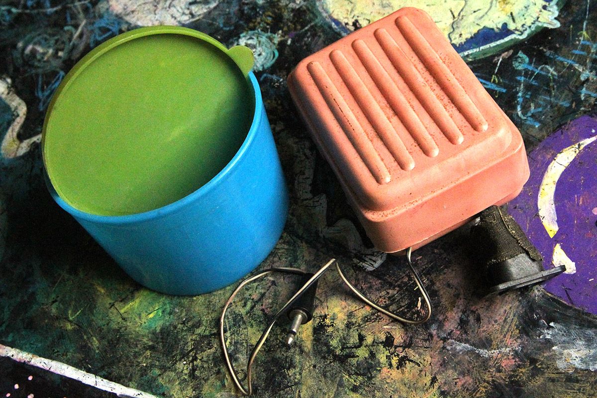

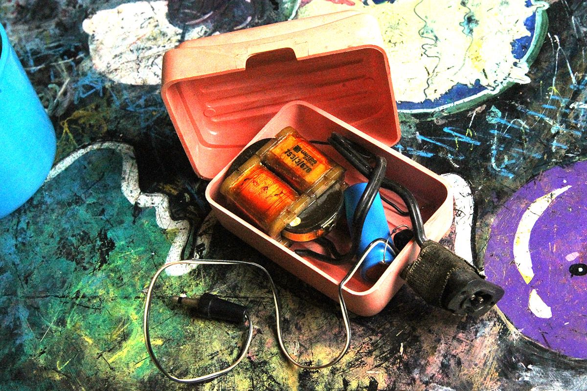

    Jawi_P wrote:
    No offence,
    😊 No offence I have 17 years (for the umpteenth time) , not 6 :wink: Emoji is my way of adding content to a post, especially since plotting has never been on my mind :(
    Jawi_P wrote:
    Maybe I just have it that way, but it's impossible to read,
    Sorry that I take life casually and not seriously as if the survival of the world depended on it, today you are, tomorrow I am gone Carpe diem :smile:
    👀 The atmosphere got a little tense for the sake of relaxation and laughing at my enclosures I give two pictures 😎
    Plastic container and pink soap dish repurposed as electronic enclosures
    DIY power supply in a pink plastic case with transformers and tangled wires
    :idea: In one like the blue one I hid the interface, for that the soapbox did the power supply, the osem socket protected by tar-soaked rag insulation, such were the technologies in the late years 80 these :razz:

    Mobali wrote:
    Let's not exaggerate with the reinforcements either, as it's unlikely to fall apart from standing on a desk top.
    If you are making something solely for yourself - full agreement. If you (for a fee) make it available to others, who I guess trust that the design has passed the prototype stage, and yet then the top cover warps into a slight banana, then imho it's worth digging deeper into the subject.
    @Pltin74 Thanks for the additional pics. I'm assuming you redesigned the rear panel in the final version, as yes strice from an aesthetic point of view the reciprocal arrangement of inputs/outputs/switches leaves a bit to be desired.
    1. Connecting the power supply directly to the GPIO pins is not a recommended practice; you bypass the whole power input circuitry and voltage/power negotiation that way.
    What power supply are you using? As far as I can see 5V and GND goes directly from the socket. Since you're bypassing the usb-c of the raspberry itself, most power supplies, except maybe the official one, won't allow enough current to flow to power the raspberry itself, let alone the expansion card and screen.
    2. Are you happy with the screen used? From experience, such screens have b.poor blacks and b.poor viewing angles, among other things, which is why I would personally rule them out at the start, because in intimate lighting, looking from the side they just look bad.
    3. Did you make sure that the RJ-45 terminals go in well, even if the cable has extra covers? Because it seems to me that a more heavily sheathed plug might not want to plug in, so either there would have to be a recess on the outside, or a dressed material on the inside and a shallower socket as a result.
    acctr wrote:
    Such is a feature of 3D printing that objects have a texture of poor quality. And this doesn't only affect the aesthetics but also the usability side because the surface easily collects dirt and dust, which is hard to remove.
    I don't know about 3D printing, but I think it changes a lot:
    - the plastic used
    - the print settings
    Although it is clear that the smoothness and even gloss of injection moulding plastic cannot be achieved, and certainly not with amateur printers.

    oshii wrote:
    I assume that you redesigned the rear panel in the final version, because so strice from the aesthetic point of view the mutual arrangement of inputs/outputs/switches leaves a little to be desired.
    remains as it is ;)
    oshii wrote:
    1. Connecting the power supply directly to the GPIO pins is not a recommended practice; you bypass the whole power input circuitry and voltage/power negotiation.
    What power supply are you using? As far as I can see 5V and GND goes directly from the socket. Since you are bypassing the usb-c of the raspberry itself, most power supplies, except maybe the official one won't allow enough current to flow to power the raspberry itself, let alone the expansion card and screen.
    ok thanks for the insight! i had no idea about that. 5V/2A power supply from botland. In your opinion how else to connect the power supply?
    oshii wrote:
    2. Are you satisfied with the screen used? From experience, such screens have b.poor blacks and b.poor viewing angles, among other things, which is why I personally would rule them out at the start, because with intimate lighting, looking from the side they simply look bad.
    Yes I am! I'm usually looking at it straight on, so I don't mind poor angles (if there are any)
    oshii wrote:
    3. Have you made sure the RJ-45 terminals go in well, even if the cable has extra covers? Because it seems to me that a more heavily shrouded plug might not want to plug in, so either there would have to be a recess on the outside, or a dressed material on the inside and a shallower socket because of that.
    2
    Yes, everything goes in as it should :)

    efi222 wrote:
    The print straight from the printer's table is simply ugly.
    in your opinion, I personally like it. but everyone has their own style and their own taste ;)
    cinepi wrote:
    All in all, I think it's only the aesthetics of the screws that could be complained about - the front ones are still ok, although they could have a lens head or be blackened. The rear ones - preferably in the same style as the front ones, or at least with chamfered holes to hide the 4 screws securing the rear panel. The rest as OK as possible.
    Thanks very much, I specifically gave the allen screws protruding because I just like them. There will be some on the back as well, but they are not "in stock" at the moment :)
    The safest way would be to connect with a usb-c extension cable directly to the raspberry input. By default the usb provides max. 500-900 mA, only after negotiation is the limit increased to e.g. 3A. So, depending on which power supply the end user uses, he may be surprised, because the device will not start up at all. 500 mA is definitely too little for raspberry + card + display to work.
    Unless I'm wrong, someone here will probably correct me.

    >>21754292 I will measure today the current draw the raspberry takes, from these pins, THANK YOU!

    oshii wrote:
    It would be safest to connect with a usb-c extension cable directly to the raspberry input.
    If you use an external power supply with USB-C then definitely yes.
    On the other hand, if you would use a built-in (reliable) inverter with a current capacity of 3A or better more, then you can safely power the Raspberry via the pins in the GPIO strip.
    I, in my rpi projects, supply power from the built-in power supplies (5/6A) via the GPIO and have no problems with this.
