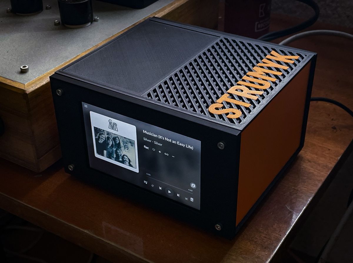

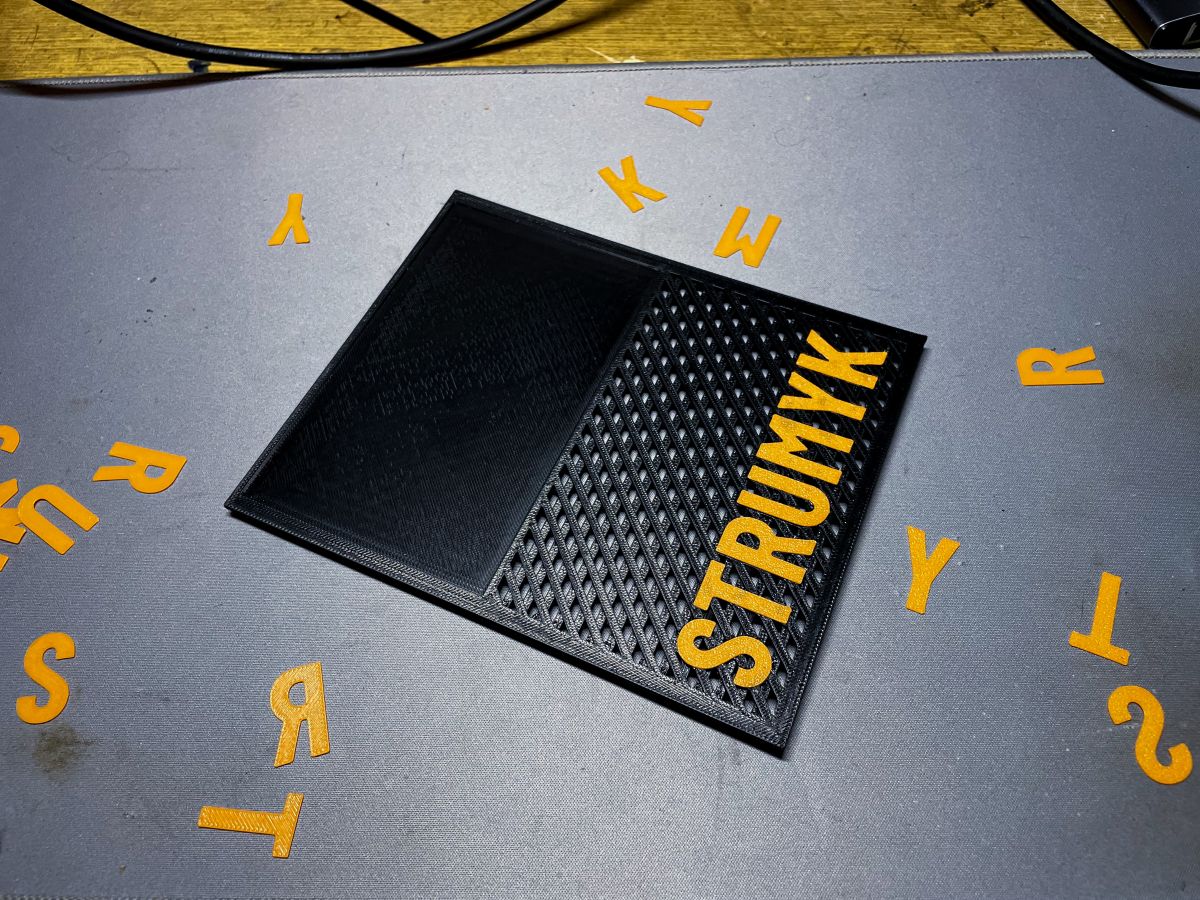

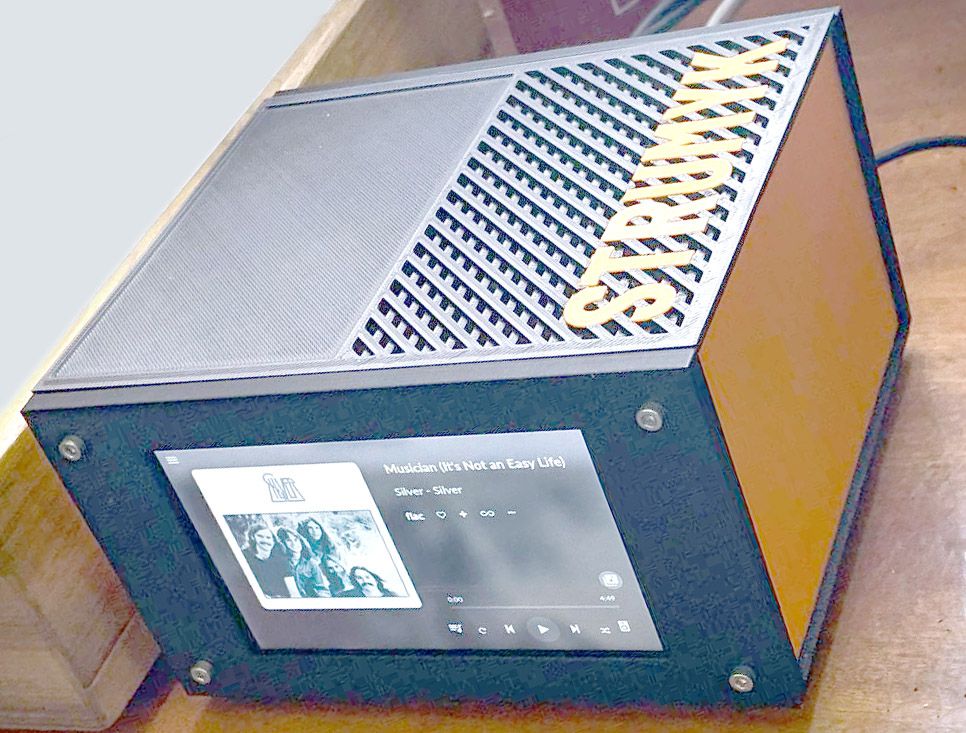

  • Hello forum members.

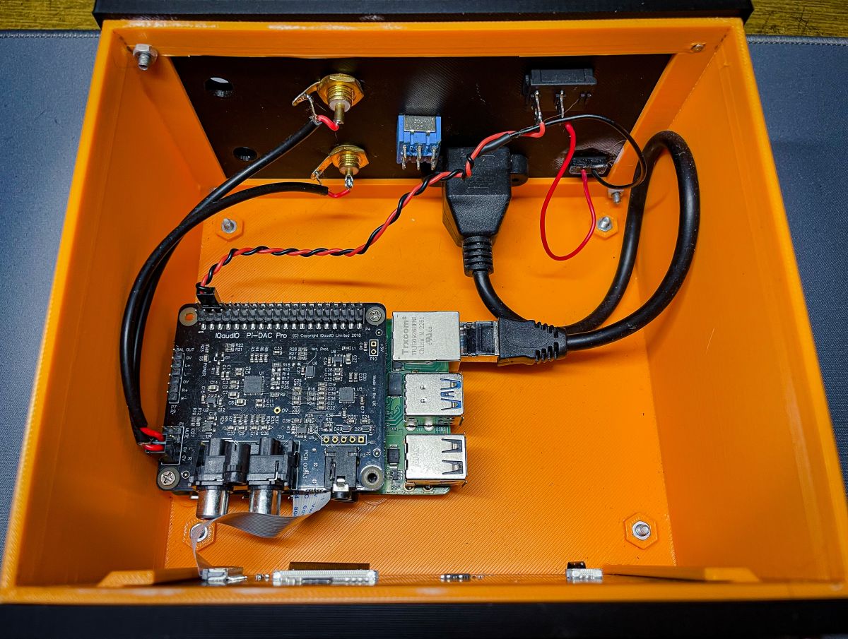

    I would like to present a chassis design I have made for the Raspberry Pi 4 that works with the IQaudIO DAC Pro card. The device serves as a music streamer from a home NAS server and can play audio material in 16-24 bit quality.
    I used the Volumio system as the software. Operation is possible both from the mobile app and via the 5" OSOYOO touchscreen display connected via DSI.
    The rear panel houses:
    - two pairs of RCA outputs (switchable via a switch),
    - RJ45 socket,
    - power switch,
    - USB-C connector for power supply.
    The enclosure was printed on a Bambu Lab P1S printer. The design works with my tube amplifier on 6P6S tubes, which I featured earlier in the profile.
    It's nothing amazing, but interestingly on Reddit the design has been very positively received, and this is my first product that can be purchased on my patreon :)

    Elegant! Have you perhaps wondered if it would be possible to somehow avoid those screw heads on the front panel?
    What kind of screen is it?

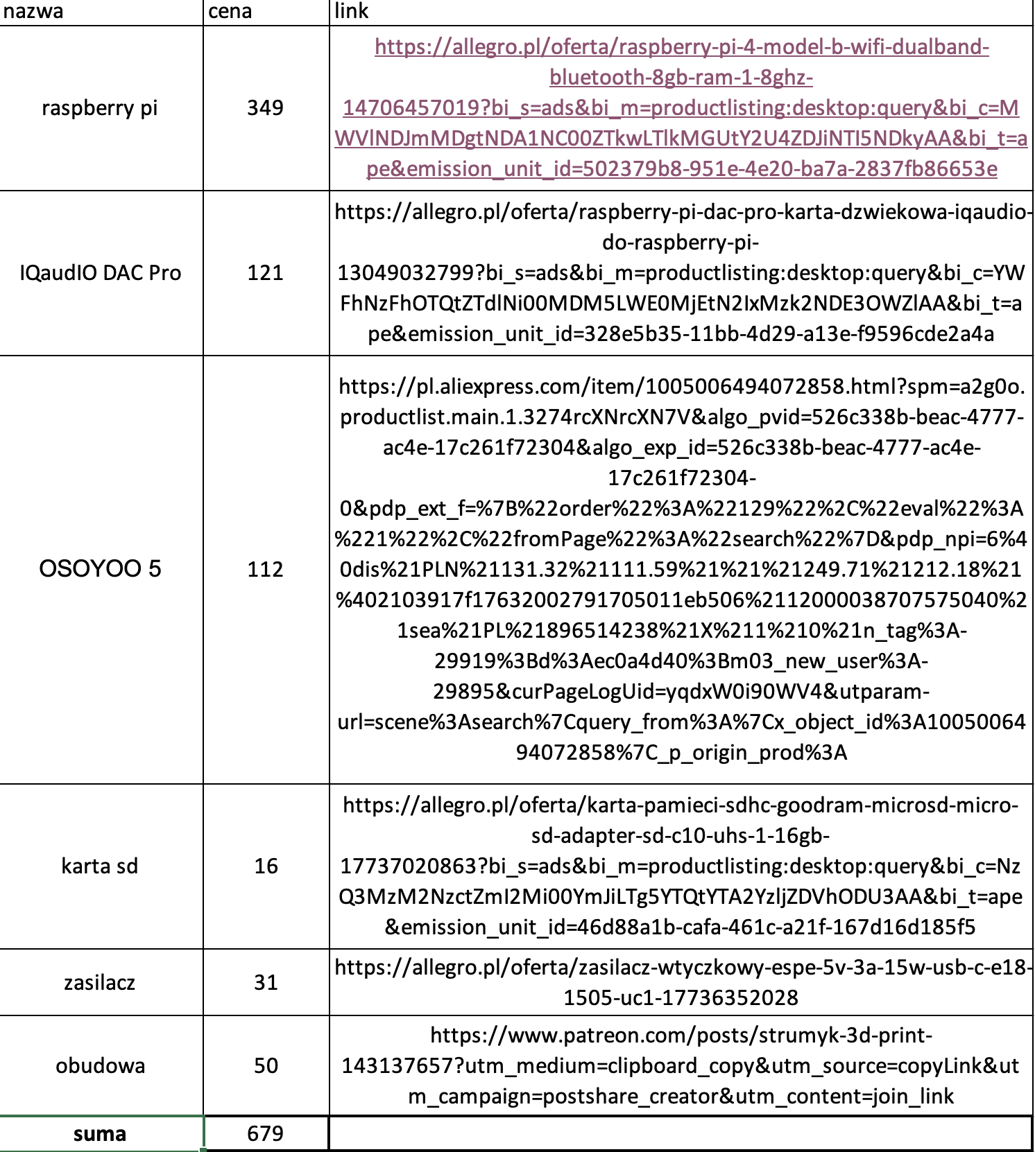

    >>21751793
    main parts:
    Table listing Raspberry Pi project components with prices and purchase links
    • strumyk - koszty.xlsx (11.43 KB) You must be logged in to download this attachment.

    >>21751852 No, just the casing
    >>21751872 I probably could, but in my opinion they add to the look so I wasn't hiding anything. The screen is OSOYOO 5", it says in the description :)

  • Critique of enclosure design and Reddit feedback
    #11 21751961
    acctr
    Posts: 4554
    Help: 389
    Rate: 2025
    Pltin74 wrote:
    play "with these finished blocks" and see how 3d printing and design is simple and wonderful
    Congratulations on a successful project. However, to be honest, the enclosure you presented is simple but not great - terrible 3d printing texture and lack of any structural reinforcement, some cracks around the mounts, screws without nuts, bent walls. With a 3d printer at your disposal you could have done better because as it stands it's a plain box without any engineering finesse.
    The reddit community is the level of an amateur lego block builder not an amateur electronics builder, sure good feedback from them is edifying but is it constructive?

    >>21751961
    So am I to understand that Elektroda.co.uk is an elitist and luxury community (not society*)? :D
    Regarding that awful texture; what pleases who, I'm not complaining, and reinforcements? What for? Nobody will throw it :D
    Where the user saw the cracks, I don't know, but I have a -6 in both eyes, so maybe that's why ;P
    This isn't meant to be another skyscraper in Dubai, just a simple enclosure to be assembled by someone who can handle an Allen spanner. As for the curved top - fact, it could have come out better, but you can always print again.
    Thanks for the feedback and congratulations ;)

    #17 21752128
    oshii
    Level 26  
    Posts: 794
    Help: 84
    Rate: 259
    You would add a view of the rear panel.
    I wouldn't count on the accolades on the forum, as these are finished blocks both in terms of hardware and software. Have you modified anything in the system? At least some script that does something that isn't in the Volumio documentation?
    It looks like the only creative work is the enclosure and you are unlikely to find many printed enclosure enthusiasts here.
    Personally, I don't mind printing usable enclosures, but if they are not only to be practical, but also to look...well no, plastic is not my fave.

    It's hard to give constructive criticism, because the whole project is based on taste - either you like the printed plastic or you don't, and there are so few photos that it's even hard to judge the quality of the printing. The front panel is too dark to see any details in the photo, the rear panel is missing, there are no feet, no close-ups.
    I would be interested, for example, in how aesthetically you have managed to embed the display and sockets in the case, but all I know from the photos is that there is a display in the case, and that there are sockets.
    When I made my parents a streamer for their home cinema, I put the RPi in a multipurpose enclosure, replaced one of the walls with tinted acrylic and put two 8x8 led arrays behind it, precisely because I had no idea how to aesthetically use a ready-made LCD panel.

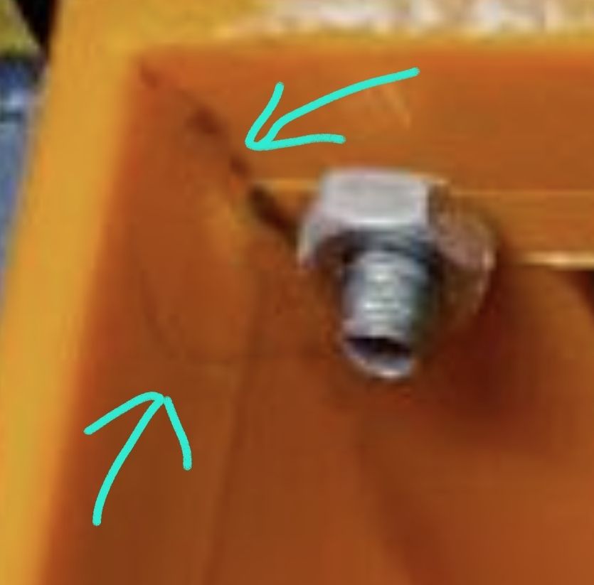

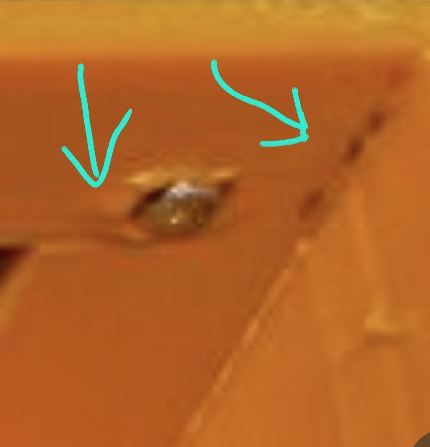

  • Critique of enclosure texture and unnecessary reinforcements
    #22 21752572
    acctr
    Posts: 4554
    Help: 389
    Rate: 2025
    Pltin74 wrote:
    Where the user found the cracks, I don't know, but I have a defect -6 on both eyes, so maybe that's why ;P
    Defect no excuse because photos can be enlarged :D
    Close-up of orange plastic housing with surface flaws and arrow markers Close-up of orange housing corner with crack and metal screw
    Pltin74 wrote:
    About that awful texture; what suits who, I'm not complaining, but reinforcements? What for? Nobody is going to throw it
    Pltin74 wrote:
    What about the curved top - fact, it could have come out better but you can always print again.
    Just for that reinforcement :) pick up any PE container from the market and look at it from all sides, maybe you will be inspired what to improve and what to add before the next print.
    As it stands now, you might as well have made the enclosure out of cardboard, painted orange with crayons with a "designer" logo, the texture would have been better and the enclosure gained because "hand made".

    As for the project. Hmm... It has already been said about tastes we do not discuss. Plastic in audio somehow not for me though.
    There was talk of reinforcements - you ask why. So that the walls don't bend, as you can see on the top cover.
    Personally, I like the fact that you presented the project. Assembling ready-made blocks and using them is not a bad thing in the current reality. Sometimes blocks like this get banged around in drawers. Not every project has to be from scratch.

  • Front panel photo too dark to show details
    #24 21752749
    _ACeK_
    Posts: 201
    Help: 6
    Rate: 221
    oshii wrote:
    ...The front panel is too dark to see any detail in the photo...
    Modern audio device with display screen and STRUNYK lettering on top panel
    :smile: Can be brightened up :idea:
    🙃 For as long as I can remember it was always when I made any board that I had a problem with the enclosure :cry: My first enclosure I made, it was for a VCR interface Atari 😇 Made from a round handwash box 😛 looks horrible but serves its purpose :wink:
    😎 There was once a guy who put a bunch of inventions in a box and patented it as a radio ✅
