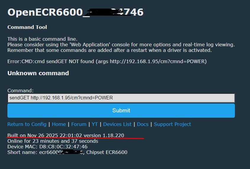

    Can somebody help with my problem?
    "SendGet..." - Unknown command - on ECR6600 Tuya Wi-Fi Smart Plug with Energy Measurement.
    My software version is 1.18.220

    Welcome to forum. I think this is disabled on ECR by default. Still, no problem - you can enable and build it online, no toolchain required.
    You need:
    Code: C / C++
    in obk_config.h in ECR section.
    See our online building system for more information: https://www.elektroda.com/rtvforum/topic4033833.html

    Now it (sendGET/POST) works! But I have another question.
