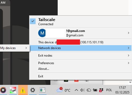

    It is best to log into Tailscale via your Google account. Once installed, the service will be hidden as an icon in the toolbar:
    Tailscale app menu showing device connection and IP address 100.115.101.119

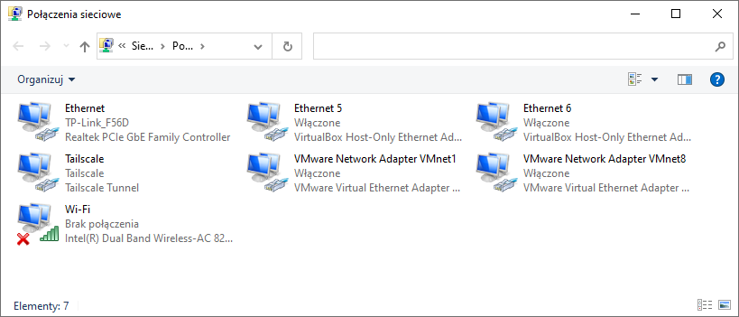

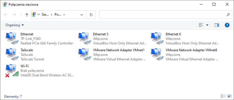

    It also sees the new IP of our device. Similarly, the installation should add the Tailscale virtual network card for us:
    Network Connections window showing Tailscale Tunnel and various network adapters

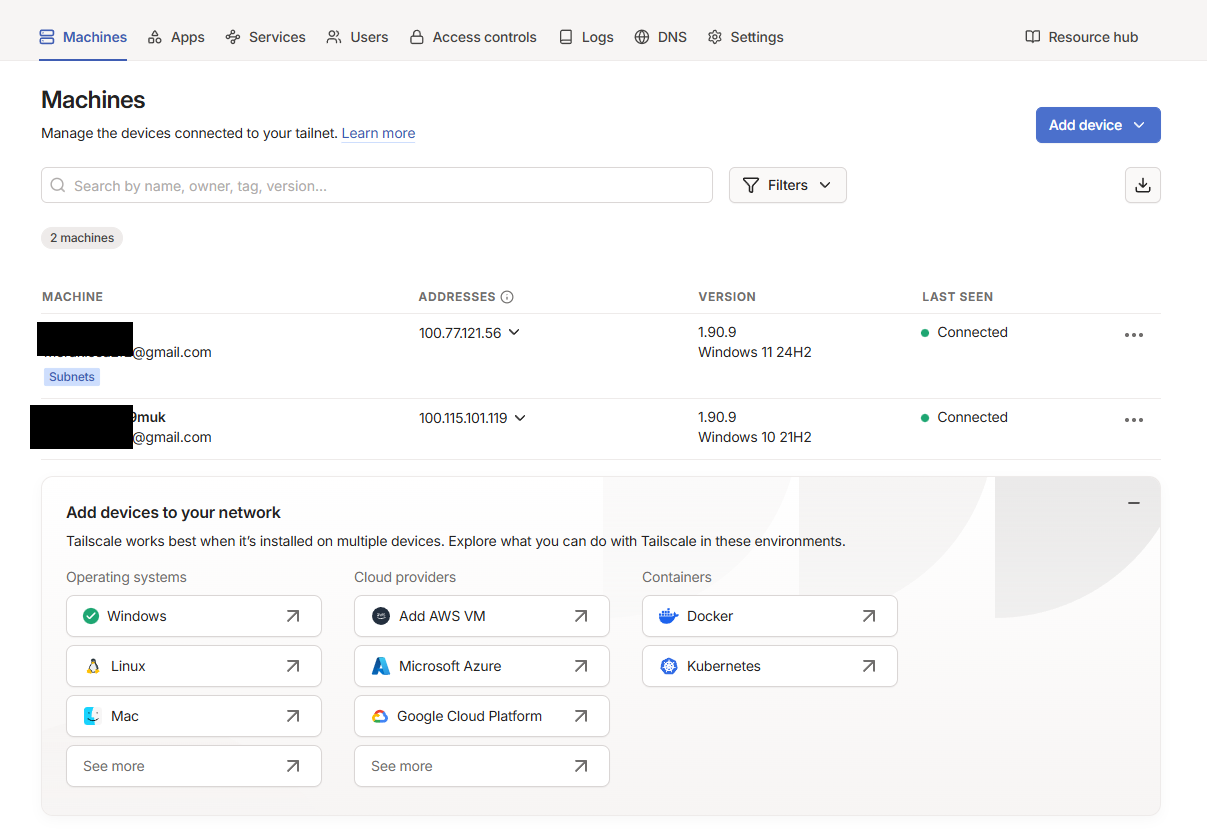

    The full extent of our virtual network is easiest to check on the Tailscale website:
    Tailscale panel showing two connected devices with IP addresses and OS versions.

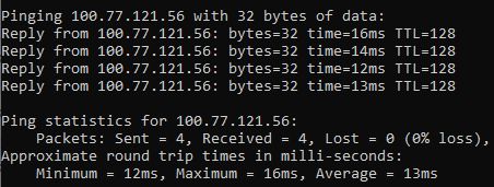

    This is sufficient for the devices to see each other:
    Ping result to IP 100.77.121.56 with minimum latency of 12 ms

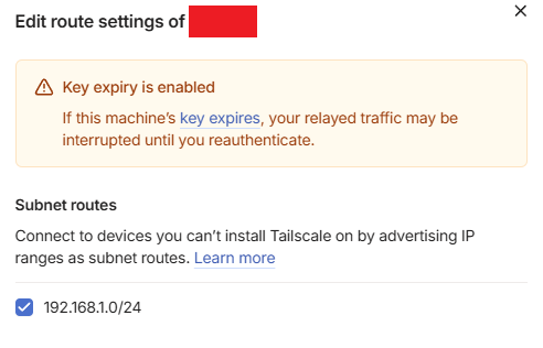

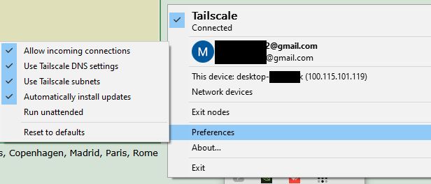

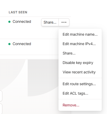

    But this will not give us access to the entire LAN of the target computer. You need to do more than that - you need to enable the so-called Subnet Router (subnet routing). This will allow other devices on the Tailscale network to see the entire LAN behind this computer - i.e. ESP8266, ESP32, router, cameras, printers etc.
    Screenshot of Tailscale settings with options menu expanded
    You can also use the command: tailscale up --reset --advertise-routes=192.168.1.0/24

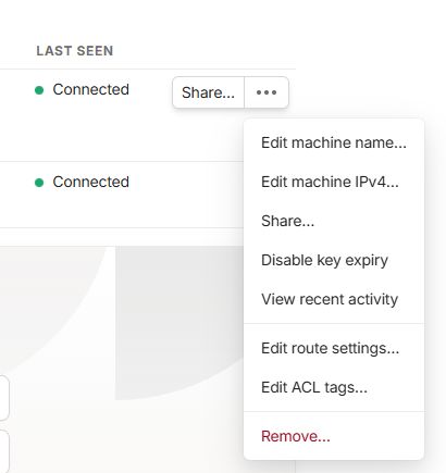

    Then on the intermediary computer go into the routing settings:
    Screenshot of Tailscale panel showing machine options menu
    There we enable the subnet-router:
    Tailscale routing settings window with selected 192.168.1.0/24 subnet route
    By default this checkbox is disabled!
    From now on we can access the devices from the target network via their normal IP.

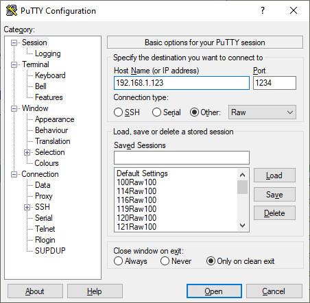

    and being on my machine on my LAN, I can access the device from the target LAN by its normal IP, e.g. IP 192.168.1.123 works, both in the browser and in programs. I can make TCP or HTTP connections normally and communication works both ways.

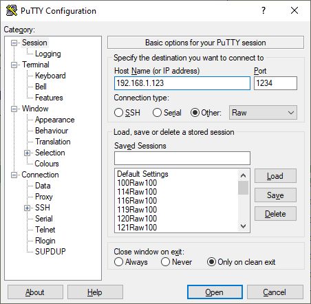

    If in doubt, this can be tested at least in PuTTY:
    PuTTY configuration window with IP address 192.168.1.123 and port 1234 entered.

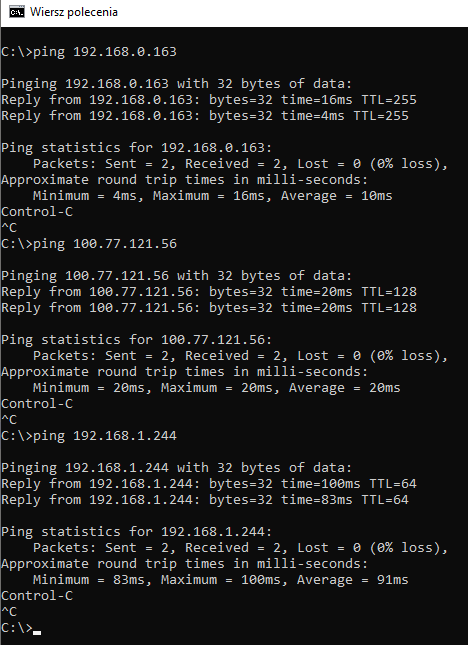

    The screenshot shows the final test for three levels of communication - device on my LAN, target computer, device on the target LAN:
    Command Prompt screenshot showing ping results for three different IP addresses
    This is a very convenient solution - and certainly more accessible than public IP and port forwarding.
