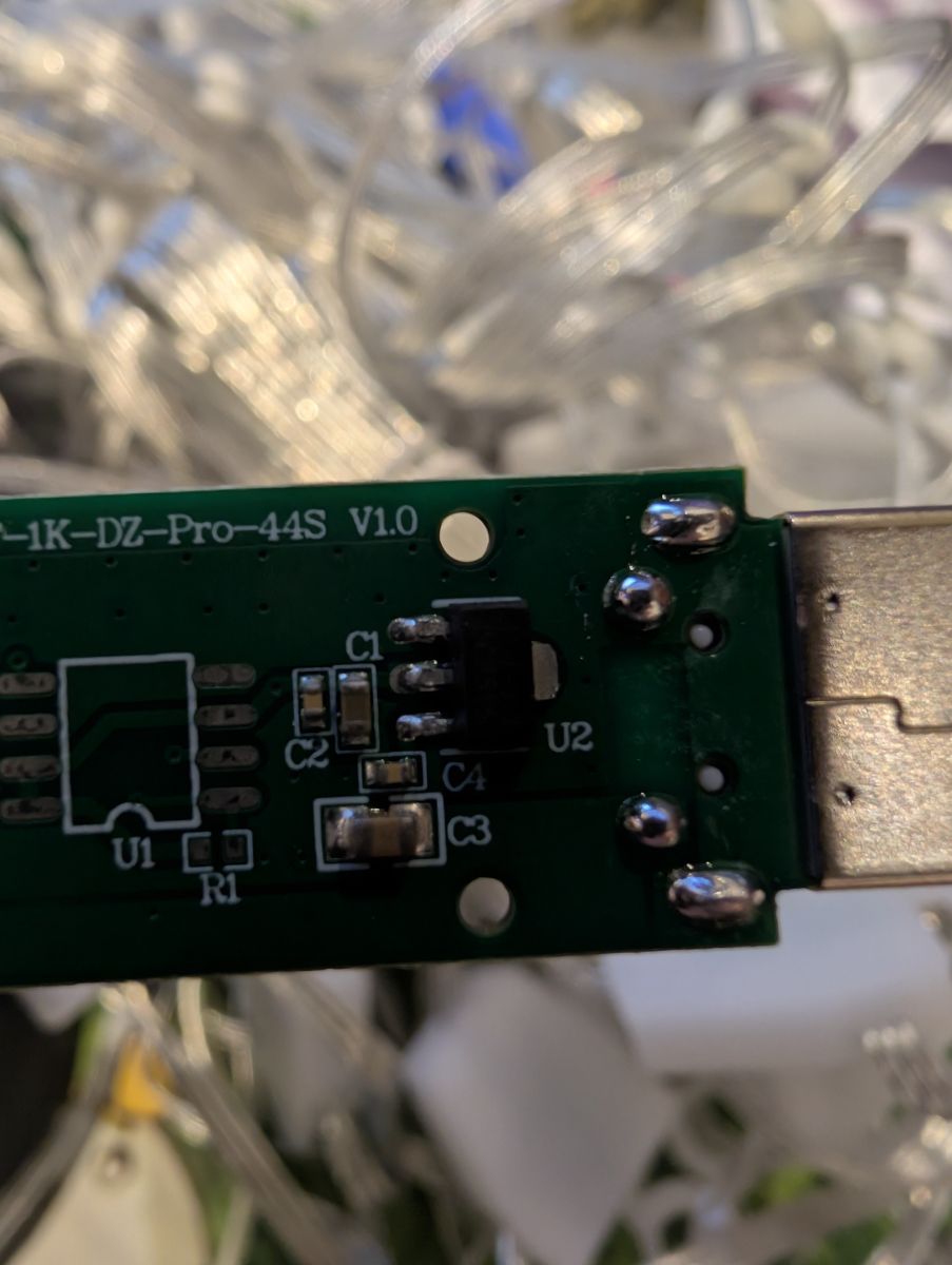

    eirikzakariassen

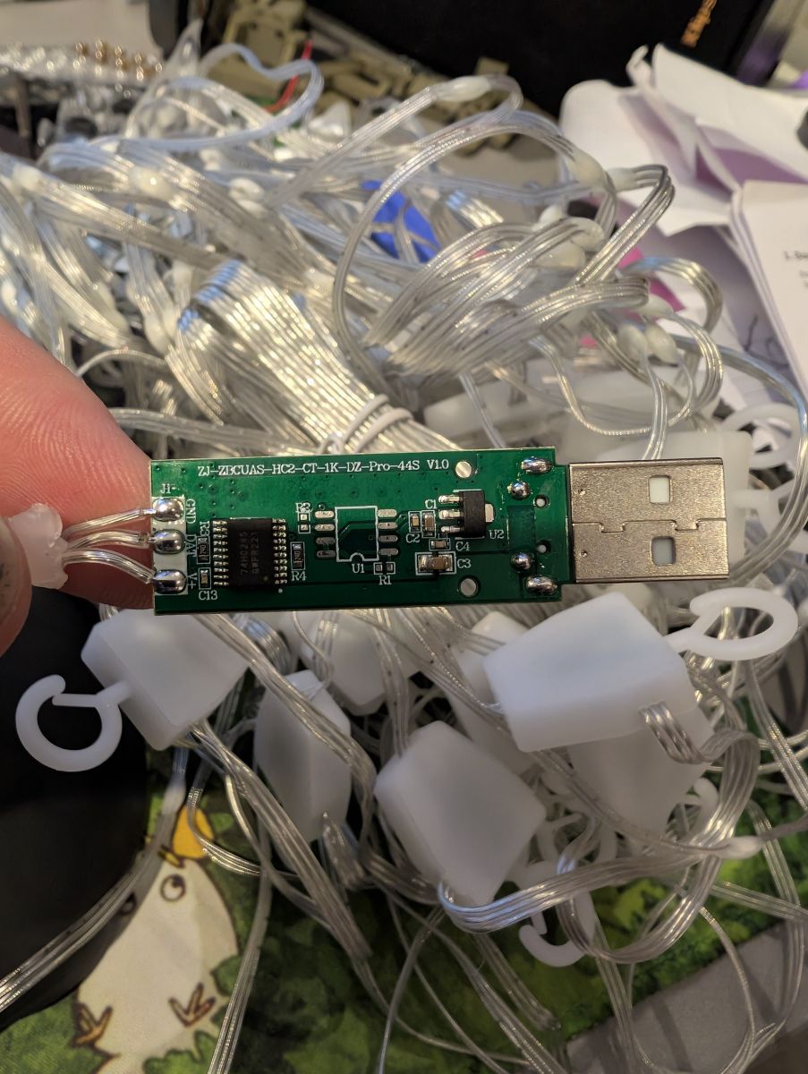

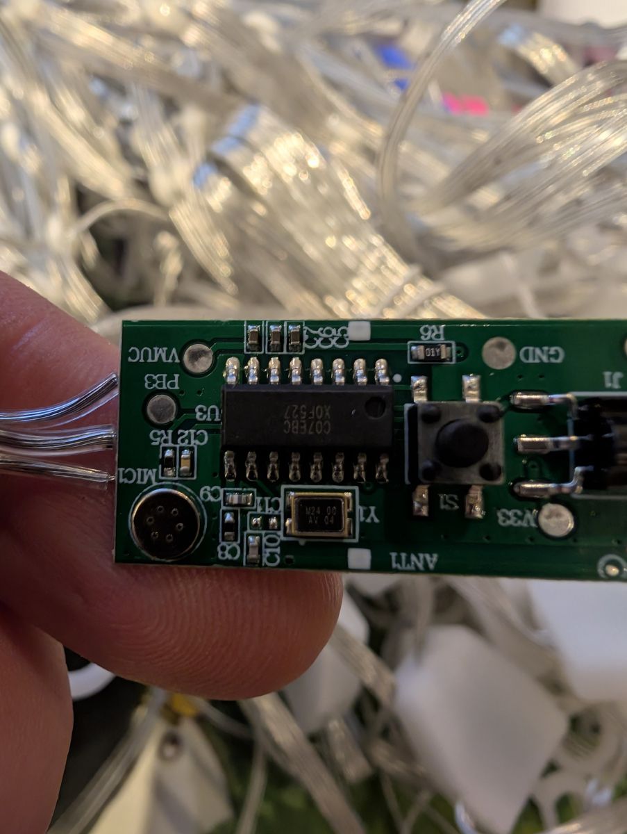

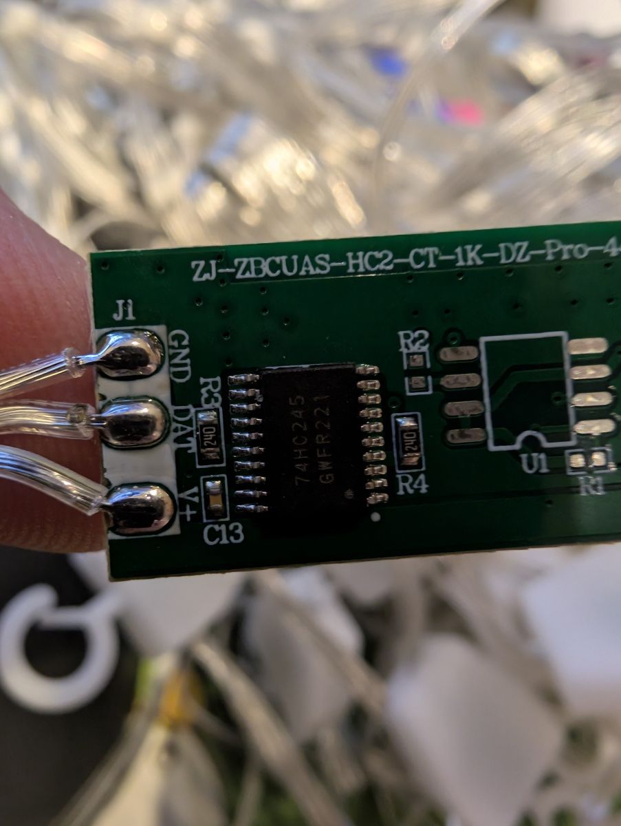

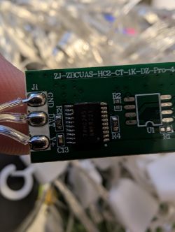

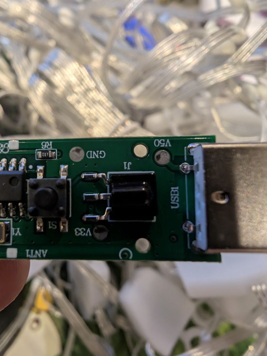

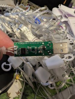

    Bought a LED strings set from AliExpress, curious if this is supported by openbeken
    Close-up of an LED controller board with USB port and labeled componentsClose-up of LED controller PCB with integrated circuit and labeled connectorsClose-up of LED set PCB marked 1K-DZ-Pro-44S V1.0Close-up of a PCB with a 74HC245 chip and marking ZJ-ZBCUAS-HC2USB LED controller board labeled ZJ-ZEUCAS-HC2 with wires and light caps
    AI: Can you provide the model number or a link to the specific LED string set you bought on AliExpress?
    https://a.aliexpress.com/_EHoqY1Q
    AI: Do you know what chipset or controller your LED string set uses (for example, BK7231, ESP8266, etc.)?
    No, see pics
  • #2 21779830
    insmod
    Posts: 1397
    Help: 164
    Rate: 436
    No, this is a bluetooth-only device.
  • #3 21780056
    eirikzakariassen
    Thanks; I assumed as much
    I tried controlling it with a WeMos D1 mini. However, the LEDs just flicker randomly, even on solid.
    Tried adding a level shifter; no avail
    Tried using WLED with WS2812 and 400 LED config.
  • #4 21808181
    andydlighthouse
    >>21780056 So I got a 20x20 LED curtain with this same controller (visually, anyway, microphone in the same place, IR in the same place, works with Surplife app).
    I attached it to a WLED controller, set it up as a string of 400 WS2812 (RGB order), and it works. I haven't checked the order yet, but solid colors work.
