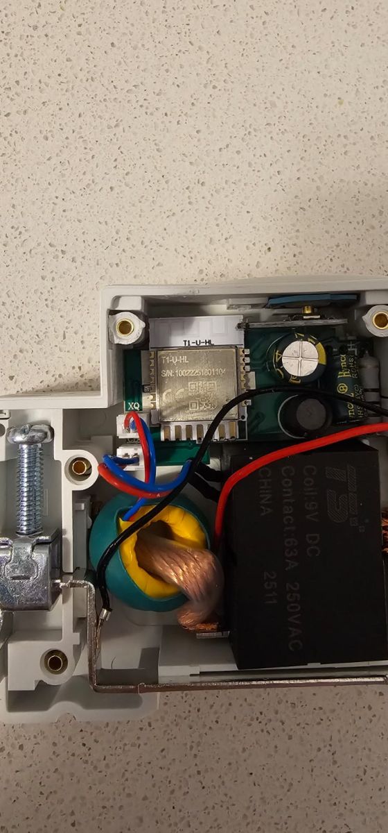

    TOMZ-TOB9-63M with T1-U-HL and not BK7231N CBU
    T1-U-HL module installed inside a device, visible with wires and components
    Link: https://www.aliexpress.com/item/1005005566505137.html
       "bt1_pin":"17",
       "led1_pin":"21",
       "rl1_drvtime":"60",
       "net_trig":"2",
       "rl_on1_pin":"8",
       "jv":"1.0.5",
       "netled1_lv":"0",
       "netled_reuse":"0",
       "bt1_type":"0",
       "temp_fun_en":"0",
       "online_time":"10",
       "nety_led":"1",
       "rl_off1_pin":"6",
       "over_cur":"63000",
       "wide_vol":"1",
       "bt1_lv":"0",
       "reset_t":"5",
       "netled1_pin":"15",
       "equi_sampling":"mode_1",
       "chip_type":"3",
       "rl_on1_lv":"1",
       "lose_vol":"80",
       "over_vol":"265",
       "module":"T1-U",
       "ch_cddpid1":"9",
       "ch1_stat":"2",
       "led1_lv":"0",
       "rl1_type":"1",
       "ch_num":"1",
       "ele_fun_en":"1",
       "rl_off1_lv":"1",
       "netn_led":"0",
       "vol_def":"0",
       "ch_dpid1":"1",
       "crc":"37"
    - Button (channel 1) on P17
    - LED (channel 1) on P21
    - Bridge Relay On (channel 1) on P8
    - Bridge Relay Off (channel 1) on P6
    - WiFi LED on P15
    Device seems to be using T1-U module, which is using BK7238.
    And the Tuya section starts at 2052096, which is a default T1/XR806 and some T34 offset.
    StartupCommand is set to startDriver BL0942
    • readResult_BK7238_2025-17-12-09-51-14.bin (2 MB) You must be logged in to download this attachment.
