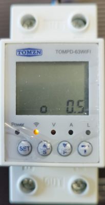

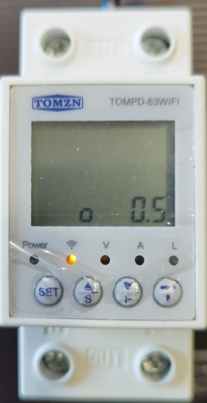

    You can already see some differences between the settings in the advertisement and those in the manual. The real thing also included another setting "t" (see next pictures), that can be set to "on" or to a number between 5 and 120.
    TOMZN TOMPD-63WIFI device with active display and lit indicators. TOMZN TOMPD-63WIFI device with display and buttons
    I haven't been able to deduct what is this setting for.

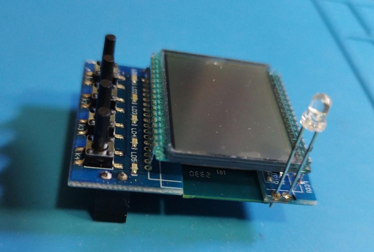

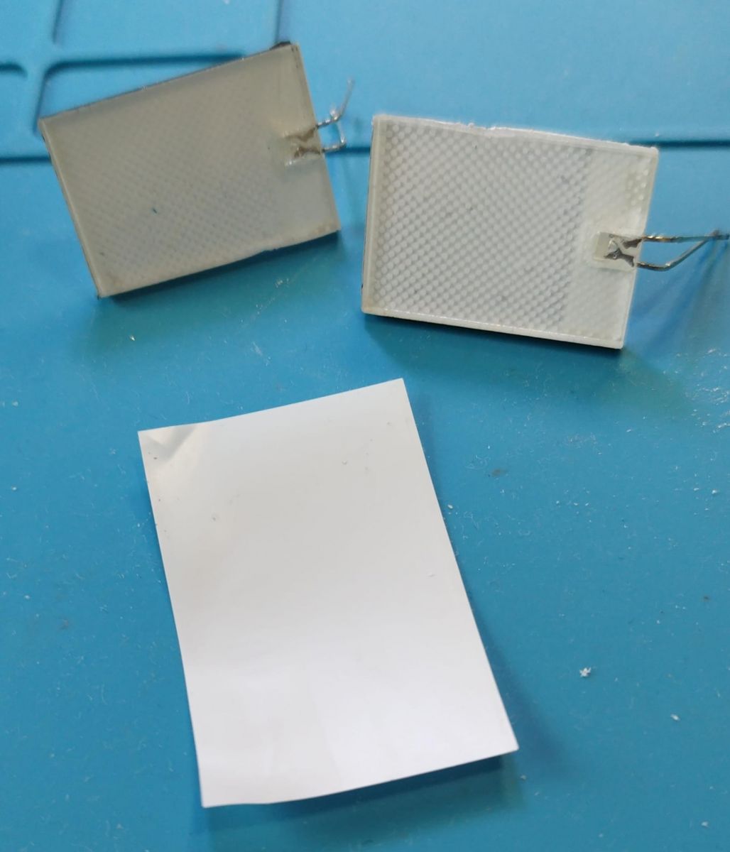

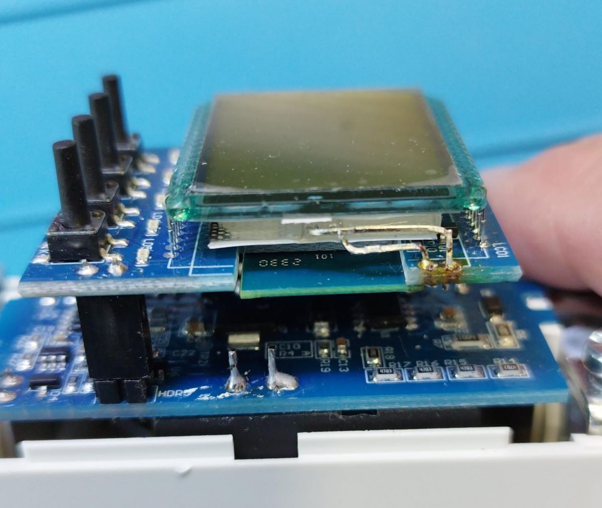

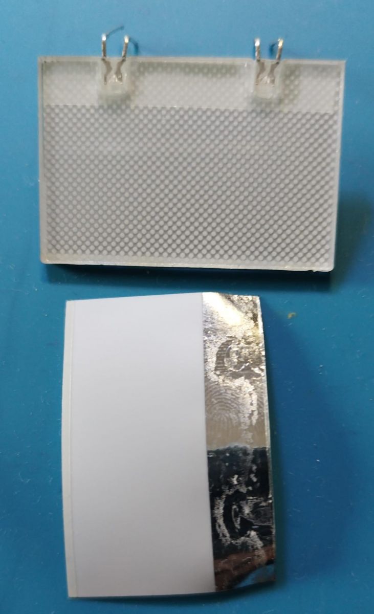

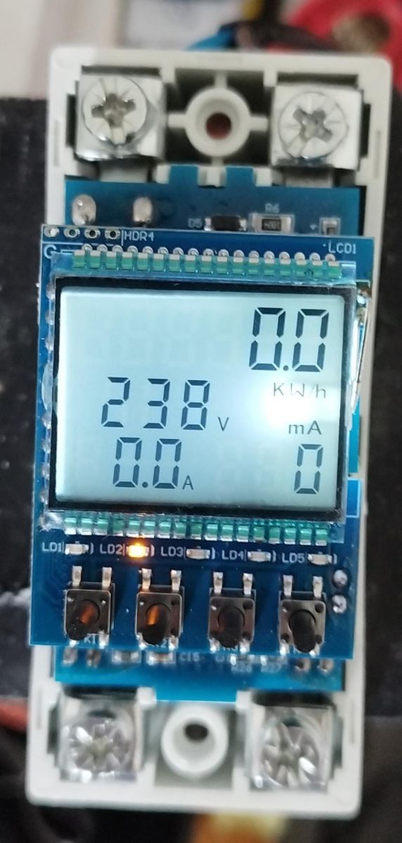

    Now, some photos of the teardown:
    View of a device from Aliexpress with visible holes and a latch. Electronic device with LCD screen and five buttons. Side view of an opened electronic device with visible components on PCB boards. Modular electronic device with a PCB and buttons. Close-up of a printed circuit board with various electronic components inside a device. Front panel of a device from Aliexpress with an LCD screen and buttons. WB3S WiFi module on a blue PCB. Close-up of a PCB from an electronic device purchased from AliExpress. Internal circuitry of a device from Aliexpress with visible capacitors and wiring. View of disassembled QY60F-C relay with PCB boards. Internal view of a disassembled electrical device.
    Opening the device is very easy: just unfasten the two screws in the holes of the first photo (after pushing apart the lower side lock). It's well constructed; there are two PCBs: the bigger one supports the relay (latching type, no need to keep the coil energized to set it on), the components for the power supply (12V output for the relay and two 3.3V outputs, one with a linear regulator from 12V and the other one with a switch mode one), and the energy metering chip BL0942 (attached English datasheet). The smaller PCB has the LCD screen, push buttons, the Tuya MCU (behind the LCD screen), and the WB3S WiFi module.

    To flash it with OBK, after unplugging the smaller board from the bigger one, is enough to solder just two wires to the RX and TX pads, as Vcc and Gnd can be connected to the header:
    WB3S module on blue PCB with marked TX, RX, GND, and 3.3V pins
    I didn't need to cut any traces to flash OBK as the Tuya MCU doesn't seem to interfere with the process (in principle, it should be shut off, as it gets the power from a different pin in the header). To avoid problems, I only connect TX, RX, and GND to the serial to USB adapter, and connect Vcc just after hitting the corresponding key to start flashing in BK7231Flasher.

  • DpID 104 rounds 0.5 s steps to integers
    #2 20879436
    Angel0fDeath
    Posts: 118
    Rate: 33
    I have exactly the same device. All DpIDs match exactly.
    About DpID 104 - From the device I'm able to change the values from 0.5s to 30s with step 0.5s. However with tuya-mqtt.js I always receive this as integer, i.e. 0.5 is 1 and 1 is also 1, 1.5 is 2 etc.
    About 't' setting of the device - according to users manual this should be light source. By me this do nothing. Probably for future use - light for LCD or something like that. Maybe some models have LCD light and this don't (in manual it is written it's optional)
  • Tuya MCU rounds DpID 104 to integers

    Added after 46 [minutes]:

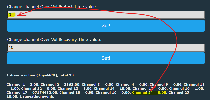

    I've just checked that, with OBK, if I set it to 0.5 in the device, the corresponding channel shows 0:
    Display of TOMZN TOMPD-63WIFI device showing 0.5 Screenshot of channel settings and logs in the TuyaMCU panel.
    It must be a problem of Tuya MCU's firmware, as the logs effectively report 0:
    Logs of Tuya MCU communication showing transmitted and processed data.

    So after I spent a few hours with openbeken firmware, I have the following observations:
    dpID 104:
    for 1.0s -> 55 AA 03 07 00 08 68 02 00 04 00 00 00 01 80
    for 1.5s -> 55 AA 03 07 00 08 68 02 00 04 00 00 00 01 80
    Definitely wrong transmission from tuyaMCU. But usually you set this once, so it could bbe done from the device

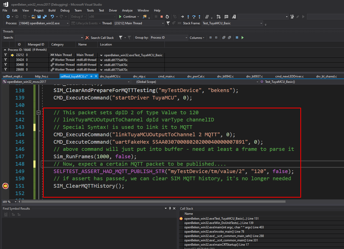

    @Angel0fDeath , while you are mostly correct, this is not a bug. We just don't have parsing for raw data, well, maybe except for one format. We have a work around for that in place but it requires writing a simple byte split in C code.
    We need to thing how to handle that, maybe we could just redirect it to MQTT directly, or just add a parser per each type when it becomes required.
    Take a look here:
    https://github.com/openshwprojects/OpenBK7231T_App/blob/main/src/driver/drv_tuyaMCU.c
    Search for DP_TYPE_RAW_TAC2121C_VCP to see an example how we parse that.

  • MQTT path proposal and dpID 104 timing observation
    #12 20881016
    Posts: 14770
    Rate: 12913
    I'm working on it, along with a self test, I hope this will suit your basic needs, then we will work on more advanced version:
    Screenshot displaying the debugger window in Microsoft Visual Studio with code related to MQTT tests.
    Is the following MQTT path okay for you?
    myTestDevice/tm/value/2
    NOTE: for raw, you will have 'raw' instead of 'value' in path
    Added after 1 [hours] 15 [minutes]:
    dpID 104:
    I don't think it's wrong. It's a value, number 1. They must be rounding seconds to full integer. What kind of dpID usage is this? Would user notice device using 1 second instead of 1.5 seconds?

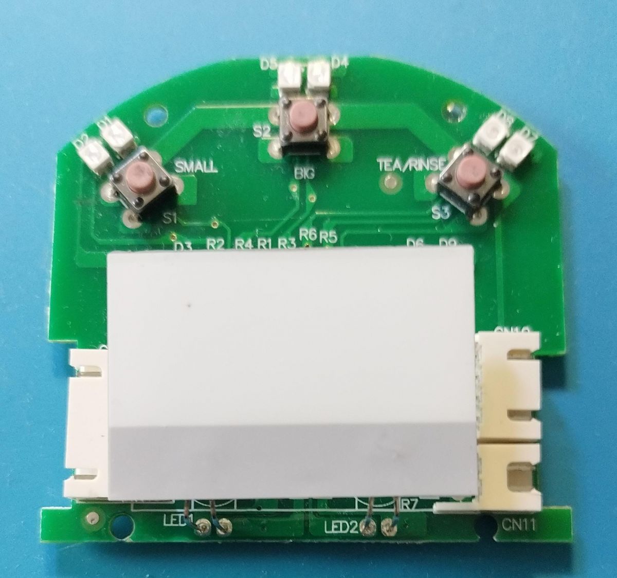

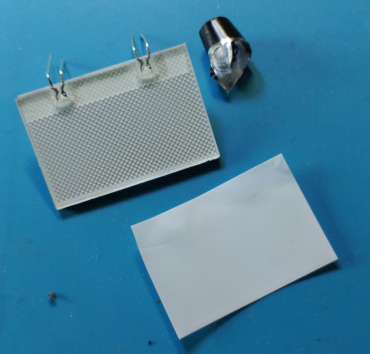

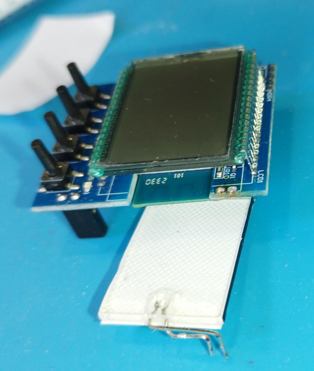

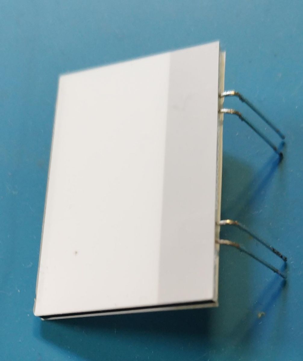

  • LED backlight pads found on TOMPD-63 PCB
    #21 20883603
    morgan_flint
    Posts: 251
    Rate: 63
    I opened the device again and checked that there were two "suspicious" pads at one side of the smaller PCB: one of them was ground and the other went to a resistor and a transistor (difficult to see as it is behind the LCD), which looked very much like a LED driver. I soldered an LED to these pads, set the "t" setting to a low value and as expected, the LED turns on after pressing a key and goes back to off after the settled time. Now I have to guess how to attach the LED to the LCD in a way that illuminates it effectively and fits into the case
    Electronic circuit with buttons and an LCD display, with a soldered LED.
    Added after 1 [hours] 2 [minutes]:
    Sorry, when I posted this I hadn't refreshed the browser, so I hadn't seen your last post.
    Angel0fDeath wrote:
    2 channels are enough - 1 channel for num value and 1 channel for text value
    But, would this work with more than one alarm at the same time? Or the second channel (string) would contain all active alarms?
    Angel0fDeath wrote:
    Today I discovered a new issue - although the value of dpID17 is correct, I was not able to set it
    Same for me, in the other thread @p.kaczmarek2 asked about implementing the possibility of sending the info to the MCU, so I understand OBK doesn't allow it now.
    Angel0fDeath wrote:
    Of course your statement will update all readings faster, because you call it each 5 seconds, but do you really need this info each 5 seconds?
    In general, no, maybe only in some special applications
  • Awaiting raw format support in driver

    1. Nice discovery about LED - this confirms this setting is or LCD backlight. If you have remote control, do you really need backlight? I'm not going to do anything, because I don't need it, more over it seems no way to oparete it remotely. Probably if t setting is with timer backlight should turn on by pressing any button and turn off after timer expires. But thank you for the feedback.
    2. If we have command in firmware to append string to the channel instead of setting it - it will have all alarms, but in order to fit in string definition of the channel probably text descriptions should be shortened.
    3. Yes we are awaiting implementation of this new raw format in the driver, then we can test and give feedback to p.kaczmarek
  • Added a junk-box backlight panel behind the LCD
    #23 20885440
    morgan_flint
    Posts: 251
    Rate: 63
    Probably not, but just for the sake of it, I finally added it :-)
    Circuit board with buttons and LCD backlight. Backlight panel with clipped wire. DIY backlight panel and a sheet of paper with aluminum foil. Backlight panel from a trash bin with a trimmed paper sheet and a diode. Two rectangular backlight panels with wires and a piece of paper on a blue surface. Backlight panel installed behind an LCD display with buttons. Circuit board with mounted LCD display and additional electronic components. View of an electric energy meter with a backlit display showing various values.
    I used a backlight panel from my junk box, cut it to size, and installed it behind the LCD. The place where the diode is is brighter than the rest, but I've dimmed it a bit more with a piece of paper
