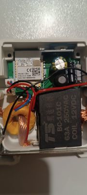

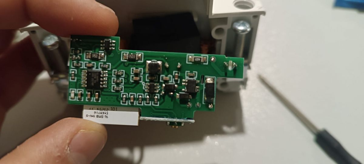

    #3 20853888
    jony4t
    Posts: 21
    Hello partners. A few days ago I received the tomz tob9-63. I decided to open the device, it is relatively easy and there are no marks left, you have to extract the golden pins with a flat screwdriver and separate the two faces, inside there is a CBU. Attached photos. I'll try to extract a backup. If you need any more photos, tell me.
    Close-up of a circuit board removed from a device. Interior of an electronic device with visible components and wiring.
  • #4 20853912
    Posts: 14791
    Rate: 12937
    Is that BL0942 there?
  • OpenBeken with BL0942 pin configuration may suffice

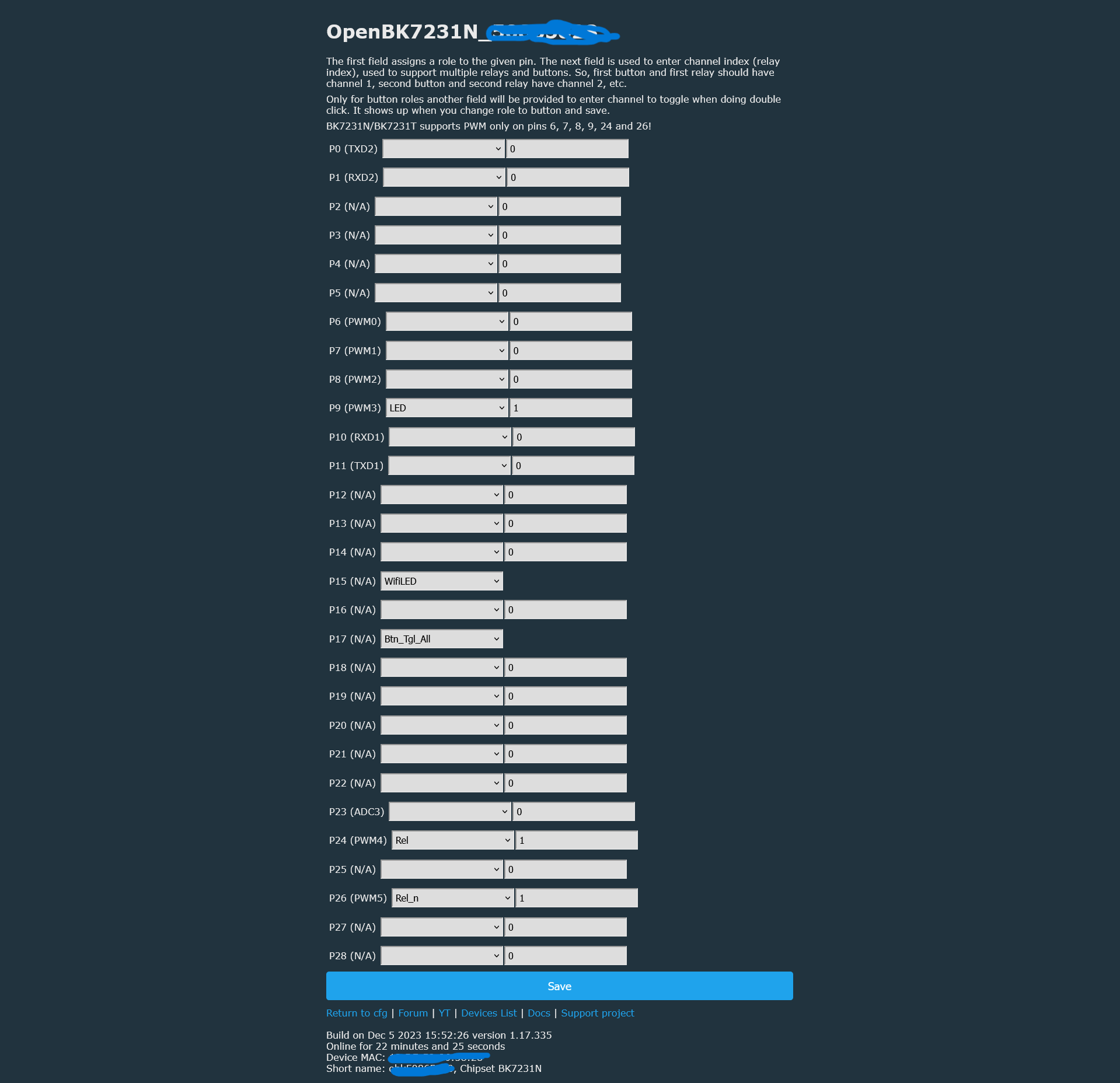

  • #9 20855531
    jony4t
    Posts: 21
    Hello, good evening.
    I have flashed the CBU module using UART successfully.
    To configure the pins:
    P9 = LED 1
    P15 = WIFILED
    P17 = BTN_TGL_ALL
    P24 = BridgeFWD;1
    P26 = BridgeREV;1
    The BL0942 works perfectly running startDriver BL0942. I haven't had time to calibrate it yet.
    Screenshot of the OpenBK7231N configuration interface with pin assignments.
  • #10 20855593
    Posts: 14791
    Rate: 12937
    Please include JSON template from the web App if you can
  • Proposed BK7231N pin mapping for TOB9-63M breaker
    #11 20855733
    jony4t
    Posts: 21
    Would that be correct? Thanks for your help.

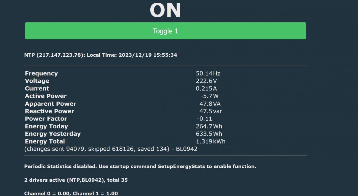

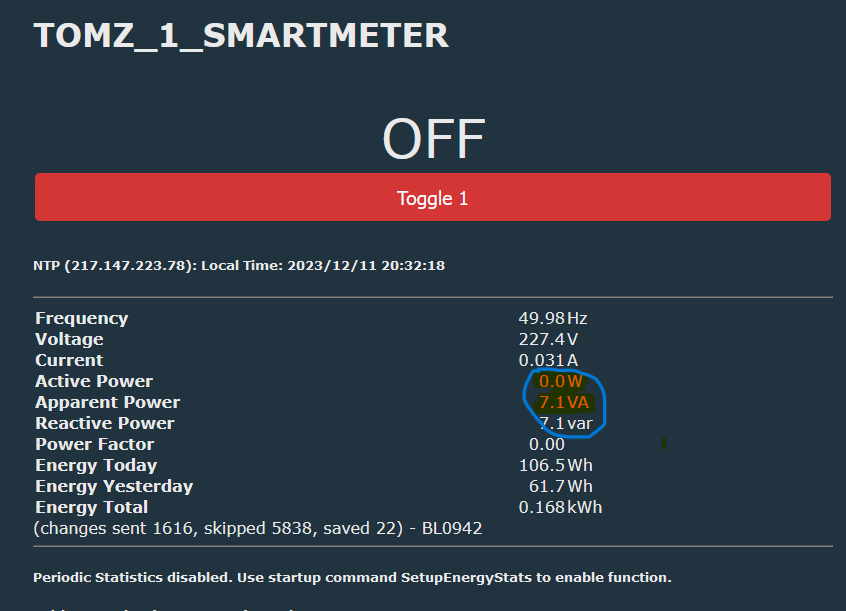

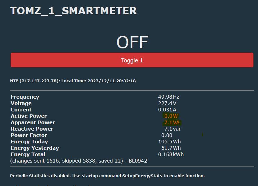

    Posts: 21
    Today, I calibrated tomz.
    I have noticed that the real power is changed with the reactive power, therefore the power factor is wrong.
    Furthermore, when consumption is removed, the counter never reaches zero.
    How can I change the data from reactive power to power?
    And how can I make the consumption zero?
    TOMZ_1 smart meter interface displaying energy data, including active, apparent, and reactive power.
  • #14 20858182
    jony4t
    Posts: 21
    At the moment, I have seen that flags 38 contemplate the option of setting the power to zero when the relays are open.
    I have not been able to correct or change the MQTT topic from real power to reactive power.
  • #15 20858198
    Posts: 14791
    Rate: 12937
    Okay, so the command to clear stats is: EnergyCntReset
    as per our docs: https://github.com/openshwprojects/OpenBK7231T_App/blob/main/docs/commands.md
    So you think that values of real power and reactive power are swapped?
    Which driver are you using, BL0942 or BL0942SPI?
    I am not the author of BL0942SPI, there might be a bug in the code that I need to fix...
  • #16 20858227
    jony4t
    Posts: 21
    I am using BL0942. In other plugs, they work fine. But in this new device, I don't know why it appears rotated. I connect a 400W power resistor. 400VAR appears on the screen. Since it is a pure resistance, it should not be reactive energy.
    Screenshot of the TOMZ_1_SMARTMETER interface showing energy measurements with values of 0W active power and 7.1 VA apparent power.
  • #17 20858254
    Posts: 14791
    Rate: 12937
    And you have other BL0942 devices and they work fine? This is very strange.
    Well, maybe I could create a flag for you, something like "swap" option, but it seems very odd.
    Are all your devices on the same OBK version? Maybe something was broken in the update?
  • BL0942 reports power in reactive instead of active mode

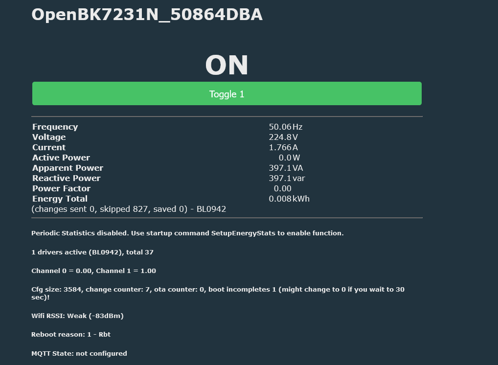

  • Incorrect power readings despite pin mapping

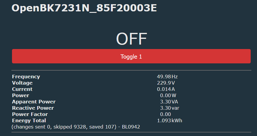

    #24 21157691
    polarbeer
    I have set this up and allocated the pins as follows:
      "vendor": "Tuya",
      "bDetailed": "0",
      "chip": "BK7231N",
      "board": "TODO",
      "flags": "0",
      "keywords": [
        "TODO",
        "TODO",
        "TODO"
      "pins": {
        "9": "LED;1",
        "15": "WifiLED_n;0",
        "17": "Btn;1",
        "24": "BridgeFWD;1",
        "26": "BridgeREV;1"
      "command": "backlog startDriver BL0942;",
    However, the power is still incorrect for a purely resistive load:
    Screenshot of OpenBK7231N interface with electrical parameter readings.
  • #25 21157709
    Posts: 14791
    Rate: 12937
    I will add this template to database, what is your device model? Is it 100% the same as in the first post - TOB9-63M?

What causes a flashed TOB9-63M or TOB9-VAP to get hot and report phantom power with no load connected?
The main cause reported here was a wrong pin configuration on outputs 24 and 26. When those pins were set as standard relay roles instead of bridge roles, the breaker ran hot and reported a few Watts with no load. After changing them to BridgeFWD and BridgeREV, both symptoms stopped. [#20869347]
How do I start and calibrate BL0942 in OpenBeken, and when should I try BL0942SPI instead?
Start with startDriver BL0942 and calibrate after confirming values appear. The thread says that is the first driver to use on this breaker, and only if it does not work should you retry with startDriver BL0942SPI. One user confirmed BL0942 worked immediately after flashing, before calibration. [#20855531]
Why does a purely resistive load on the TOMZN TOB9-63M show up as reactive power instead of active power after flashing OpenBeken?
Because this device family showed a measurement-mapping problem in the thread, even with BL0942 running. One test used a 400W resistive load, yet the interface showed about 400VAR reactive power instead of active power. The same behavior was reproduced on a second unit of the same brand and model, so it was not a one-off board fault. [#20859055]
Which OpenBeken flags help force no-load power readings to zero on TOMZN TOB9-63M breakers, and how does EnergyCntReset fit in?
Flag 38 was reported as the option that can force power to zero when the relays are open, and another user said flags 25 and 38 helped with no-load behavior after fixing the pin map. EnergyCntReset is separate: it clears stored energy statistics, not the live pin-role problem. That command was explicitly named in the thread. [#20858198]
