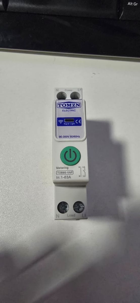

    I need help to configure a breaker TOMZN 63A with meter (BL0942)

    Device seems to be using CBU module, which is using BK7231N.

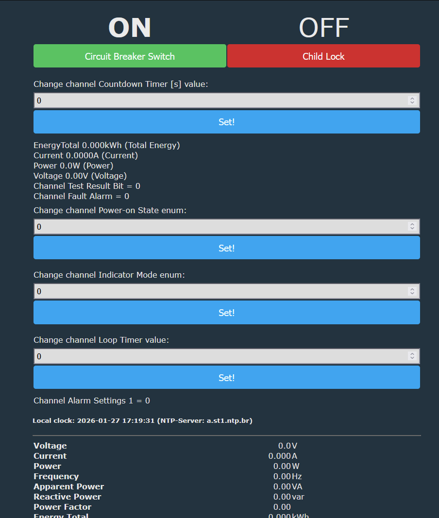

    I try to use this autoexec
    // TOMNZ 63A
    // Clear all previous definitions
    //clearIO
    // LAST POWER STATE 0 = no / 1 = on / -1 last
    setChannel 1 1
    // clear flags
    //flags 0
    // START DRIVERS
    startDriver TuyaMCU
    // BL0942
    startDriver BL0942
    // NTP BRAZIL
    startDriver ntp
    ntp_setServer a.st1.ntp.br
    ntp_timeZoneOfs -3:00
    waitFor MQTTState 1
    //tuyaMcu_defWiFiState 4
    //FLAG
    SetFlag 10 1 // [MQTT] Broadcast self state on MQTT connect
    SetFlag 30 1 // [MQTT] Enable Tasmota TELE etc publishes (for ioBroker etc)
    SetFlag 38 1 //[Power] Set power and current to zero if all relays are open
    SetFlag 46 1 // [TuyaMCU] Store raw data
    // Main Relay - id 1 "switch_1" -> Ch 1 (rw)
    setChannelType 1 toggle
    setChannelLabel 1 "Circuit Breaker Switch"
    // Countdown timer - id 9 "countdown_1" -> Ch 2 (rw)
    linkTuyaMCUOutputToChannel 9 val 2
    setChannelType 2 TextField
    setChannelLabel 2 "Countdown Timer [s]"
    // Total Energy - id 17 "add_ele" -> Ch 3 (ro)
    linkTuyaMCUOutputToChannel 17 val 3
    setChannelType 3 EnergyTotal_kWh_div100
    setChannelLabel 3 "Total Energy"
    // Current - id 18 "cur_current" -> Ch 4 (ro)
    linkTuyaMCUOutputToChannel 18 val 4
    setChannelType 4 Current_div1000
    setChannelLabel 4 "Current"
    // Power - id 19 "cur_power" -> Ch 5 (ro)
    linkTuyaMCUOutputToChannel 19 val 5
    setChannelType 5 Power
    setChannelLabel 5 "Power"
    // Voltage - id 20 "cur_voltage" -> Ch 6 (ro)
    linkTuyaMCUOutputToChannel 20 val 6
    setChannelType 6 Voltage_div10
    setChannelLabel 6 "Voltage"
    // Test Bit - id 21 "test_bit" -> Ch 7 (ro)
    linkTuyaMCUOutputToChannel 21 val 7
    setChannelType 7 ReadOnly
    setChannelLabel 7 "Test Result Bit"
    // Fault Alarm - id 26 "fault" -> Ch 8 (ro)
    linkTuyaMCUOutputToChannel 26 raw 8
    setChannelType 8 ReadOnly
    setChannelLabel 8 "Fault Alarm"
    // Relay Power-on State - id 38 "relay_status" -> Ch 9 (rw)
    linkTuyaMCUOutputToChannel 38 raw 9
    setChannelType 9 Enum
    setChannelLabel 9 "Power-on State"
    // Indicator Mode - id 40 "light_mode" -> Ch 10 (rw)
    linkTuyaMCUOutputToChannel 40 raw 10
    setChannelType 10 Enum
    setChannelLabel 10 "Indicator Mode"
    // Child Lock - id 41 "child_lock" -> Ch 11 (rw)
    linkTuyaMCUOutputToChannel 41 bool 11
    setChannelType 11 toggle
    setChannelLabel 11 "Child Lock"
    // Loop Timer - id 42 "cycle_time" -> Ch 12 (rw)
    linkTuyaMCUOutputToChannel 42 raw 12
    setChannelType 12 TextField
    setChannelLabel 12 "Loop Timer"
    // Alarm Settings 1 - id 48 "alarm_set_1" -> Ch 13 (rw)
    linkTuyaMCUOutputToChannel 48 raw 13
    setChannelType 13 ReadOnly
    setChannelLabel 13 "Alarm Settings 1"
    // Query all states on boot
    tuyaMcu_sendQueryState

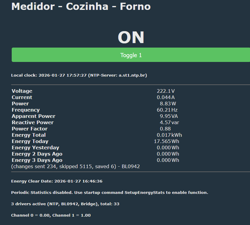

    But I get 0 for values

    Added after 25 [minutes]:
    Also I get work just using this
    that is the first time BL needs Bridge to turn on the light.
    just BL the light wont turn on
    // TOMNZ 63A
    setChannel 1 1
    // BL0942
    startDriver BL0942
    startDriver Bridge
    // NTP BRAZIL
    startDriver ntp
    waitFor MQTTState 1
    //FLAG
    Monitor screen showing energy consumption data for a kitchen oven

    It's not TuyaMCU. All Tuya devices have dpIDs when you look at their paired info in dev portal.
  • Questions about breaker data fields and power save mode
    #4 21821980
    tadeu1
    Posts: 83
    Hummm that's news for me. Everything is controlled by value, then I have to set like if current bigger than 20a turn off. Interesting
    I'll use it to monitor my oven, it's good to use PowerSave 1?
    Added after 1 [hours] 52 [minutes]:
    I have a question
    How they get some info from the breaker?
    for example
    "48": "Alarm Threshold Settings"
    "26": "Fault Alarm",
    this one its probably programming right?
    "41": "Child Lock",
    PowerSave 1 recommended and overcurrent check options
