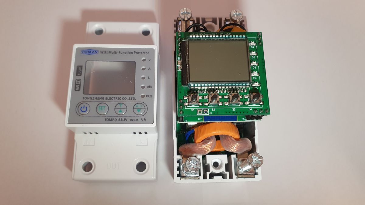

  • Hello, I recently bought this DIN power meter, it looks good, does anyone have this model with OpenBK working correctly?
    I have searched a lot in the forum and I have not found anything related to this model, so I open a thread.
    The brand of the device is TOMZN and the model is TOMPD-63LW 63A, apparently it is similar to TOMZN TOML-VA 63A.
    I'm new to this and need some initial help.

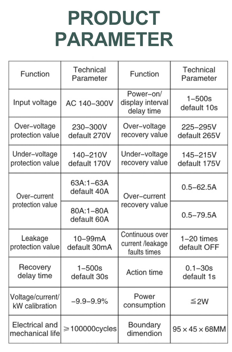

    Specs:
    The product can cut off L and N both.
    Rated voltage: 230V; Frequency: 50Hz/60HZ
    1. Remote control ON/OFF at anytime from anywhere by phone.
    2. Review current, voltage, leakage current, total kWh on phone.
    3. Timer function in smartlife TUYA app.
    4. Can set over voltage/under voltage/over current/leakage current in app or can set these by manual.
    5. Under voltage protection 140V-210V (adjustable) (default: 170V).
    6. Over voltage protection 225V-295V (adjustable) (default: 265).
    7. Over current protection 1A-63A (adjustable) (default: 40A).
    8. Reconnect time (delay on time): 1s-500s (default: 30s).
    9. Voltage/current/kW calibration: -9.9%-9.9%.
    10. Action time: 1-30s (default 1s).
    11. Power consumption less than 2W.
    12. White backlight.

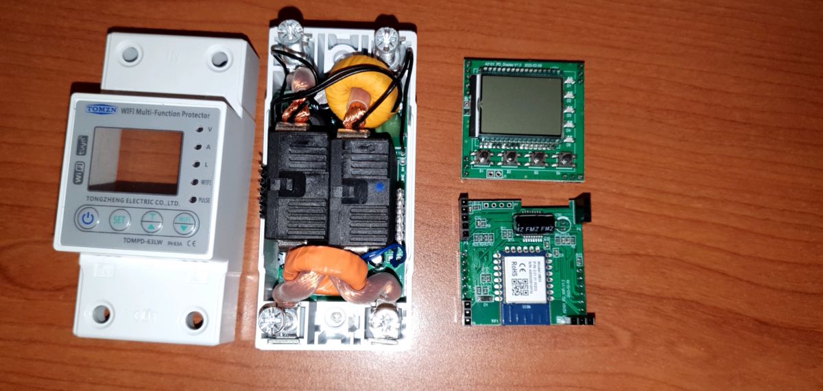

    Here are all the images he was able to collect.
    DIN power meter TOMZN TOMPD-63LW with cover and circuit board.
    TOMZN TOMPD-63LW 63A power meter with multifunction display.
    Front panel of the TOMZN TOMPD-63LW 63A power meter with feature descriptions
    Technical parameter table for the TOMZN TOMPD-63LW 63A DIN power meter.
    Interior of TOMZN DIN rail power meter device. Inside view of a DIN power meter with visible electronic components. Interior of the TOMZN DIN power meter model TOMPD-63LW 63A. Interior of a DIN power meter with visible electronic components and wiring. Close-up of the circuit board inside the TOMZN TOMPD-63LW 63A DIN power meter. Close-up view of the circuit board of the TOMZN model TOMPD-63LW 63A DIN power meter. Interior of a DIN power meter with visible electronics. Device display module with buttons and LCD screen. Interior of TOMZN DIN power meter with visible wiring and electronic components.

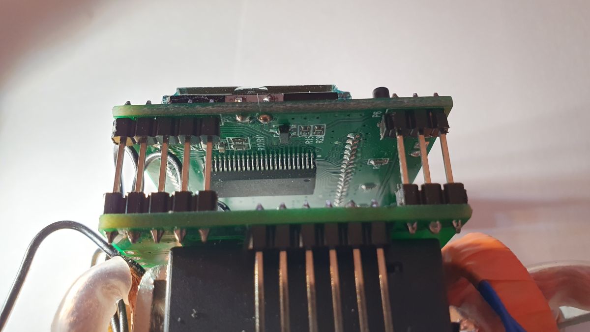

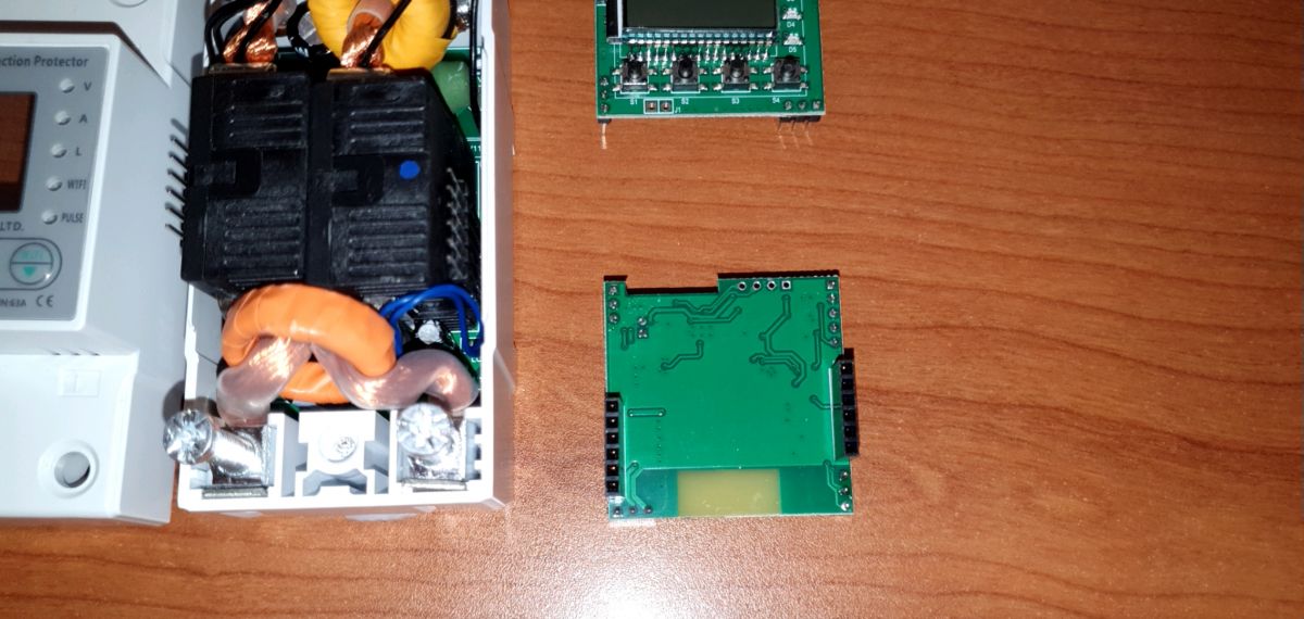

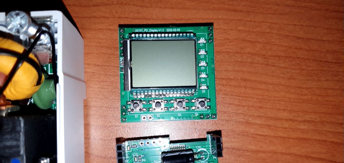

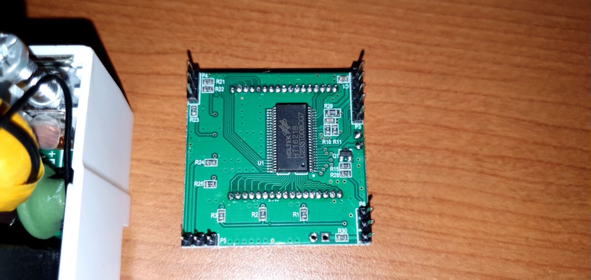

    Can you take a better picture, maybe of the bottom board? And if possible, maybe include the markings from the LCD controller?
  • Different board revisions allow easier access to UART pads
    #4 20693722
    crash1912
    Level 4  
    Posts: 15
    >>20693586

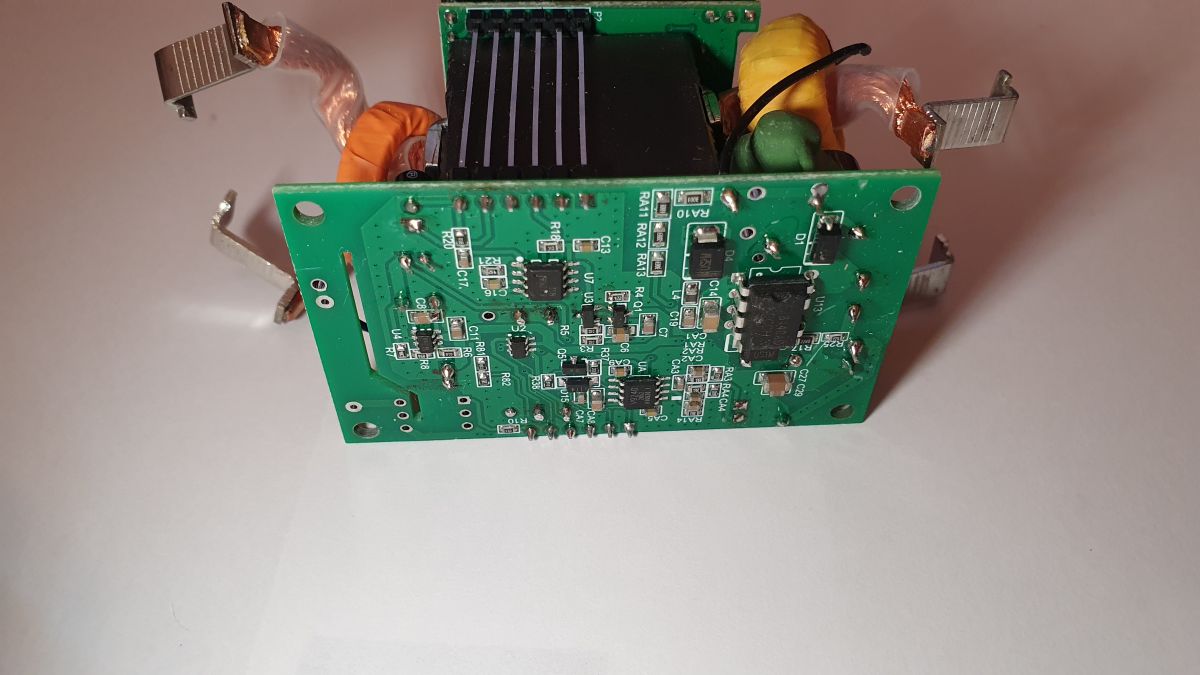

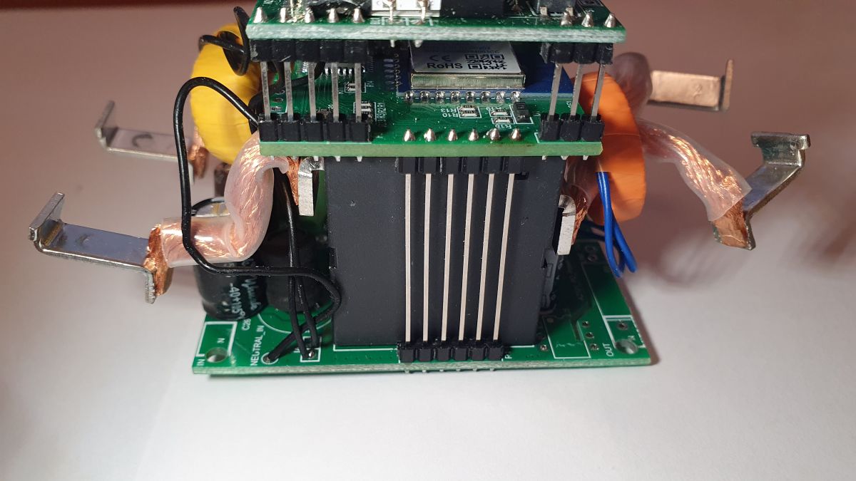

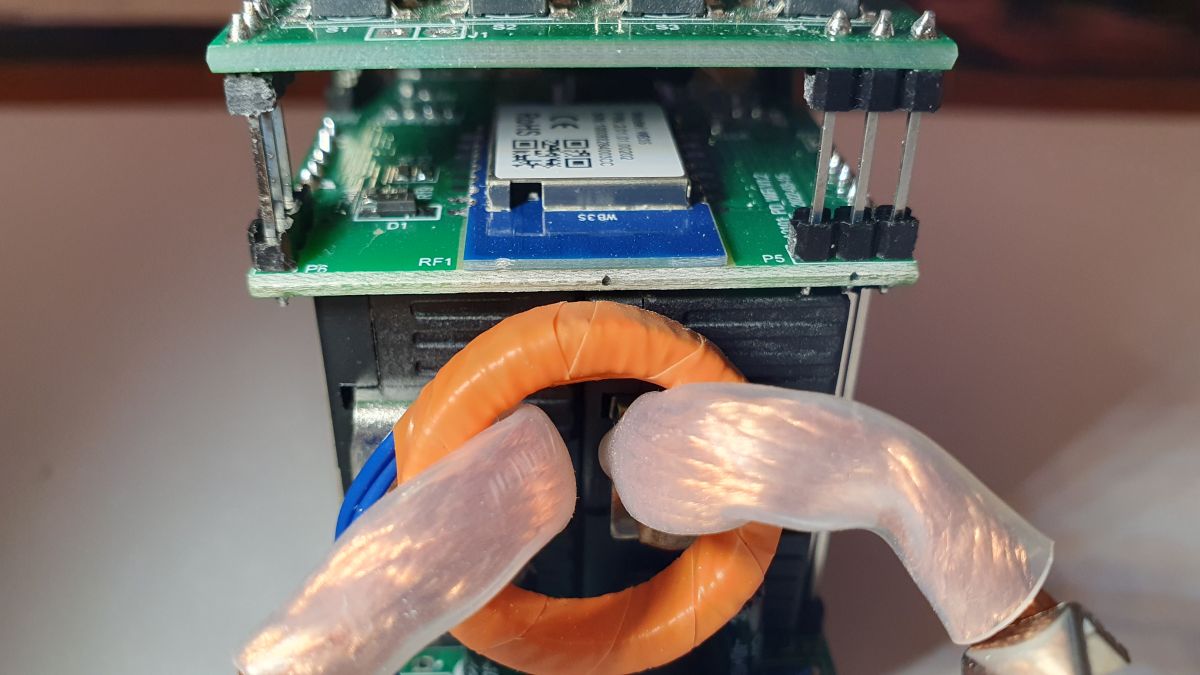

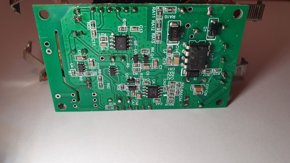

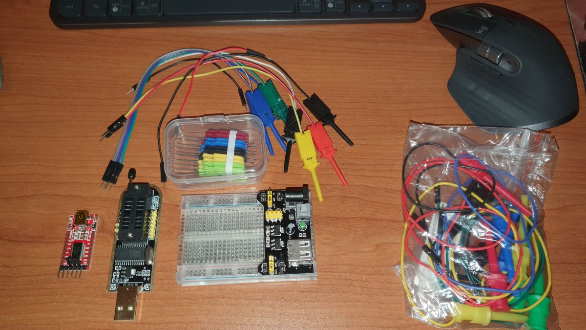

    Thanks for answering, I'm new to this, I have a moment of mental garbage with a lot of information, openbk, tasmota, esphome... but I'm advancing little by little.
    I don't know how to do UART data capture in a safe manner (sounds interesting to me!), if it's powered by 3.3v power supply and using tx rx pin then I have necessary hardware but I don't know how to proceed.
    If backup is connecting 3.3v, gnd, rx and tx then i think i can do it.

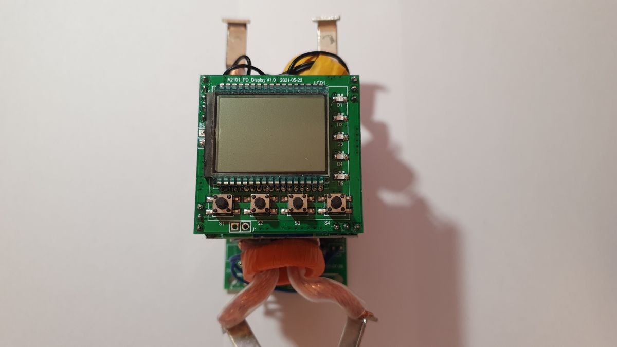

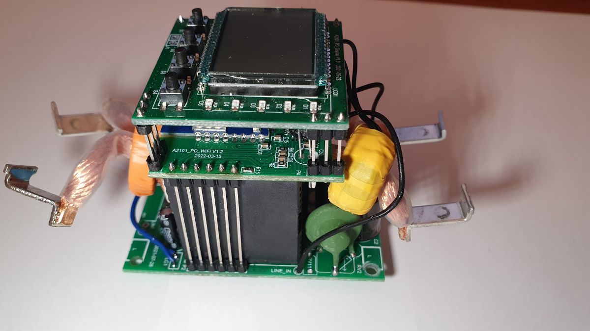

    Surprise for me, I have another TOMPD-63LW unit (I bought 4) and this one allows to disassemble boards much better, it is possible that I can do backup without soldering wires... (or is there another way of backup?)
    A set of electronic tools, including relay boards, wires, and connectors, on a desk.
    >>20693615
    Surprise for me, I bought 4 units and not all same exactly equal boards connection system.
    In this other unit can take better board pictures!
    Interior and parts of an electronic module on a wooden desk. Image of an electronic module and part of a device interior on a wooden surface. Close-up of a green printed circuit board with a microchip and pin labels. Electronic display with six buttons on a green circuit board. Disassembled WiFi multifunction protection module with circuit boards.

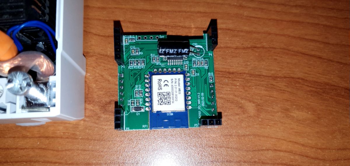

    #5 20693745
    Posts: 14770
    Rate: 12913

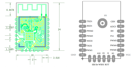

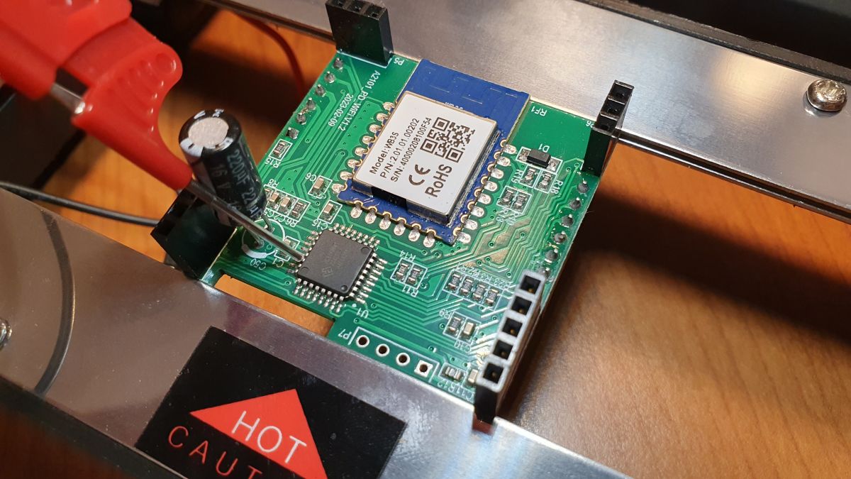

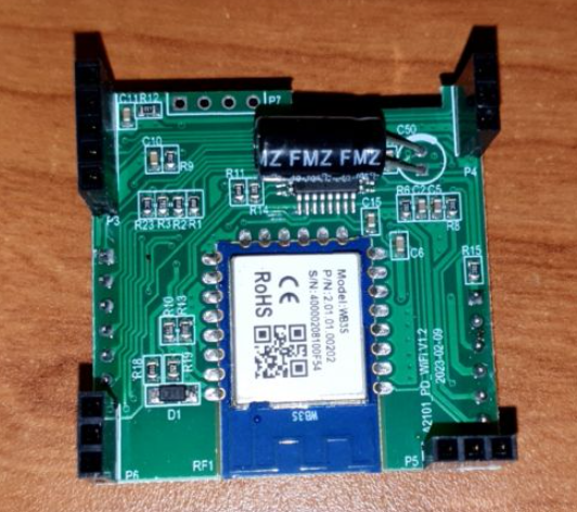

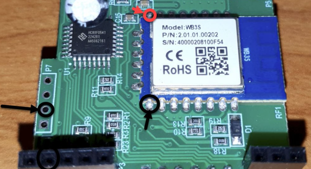

    What is under capacitor here:
    WB3S module with visible pin markings and a capacitor on the circuit board.
    This is WB3S bot:
    Diagram of the WB3S module with bottom view and pin designations.
    (Bottom view, not top view!).
    Where is RX1 and TX1 connected, where is GND, where is VDD? Is it broken out on that non populated pin header?
    Where else UART1 leads?
    Are there any other GPIOs routed out?
    Hidden TuyaMCU likely handles LCD and UART communication

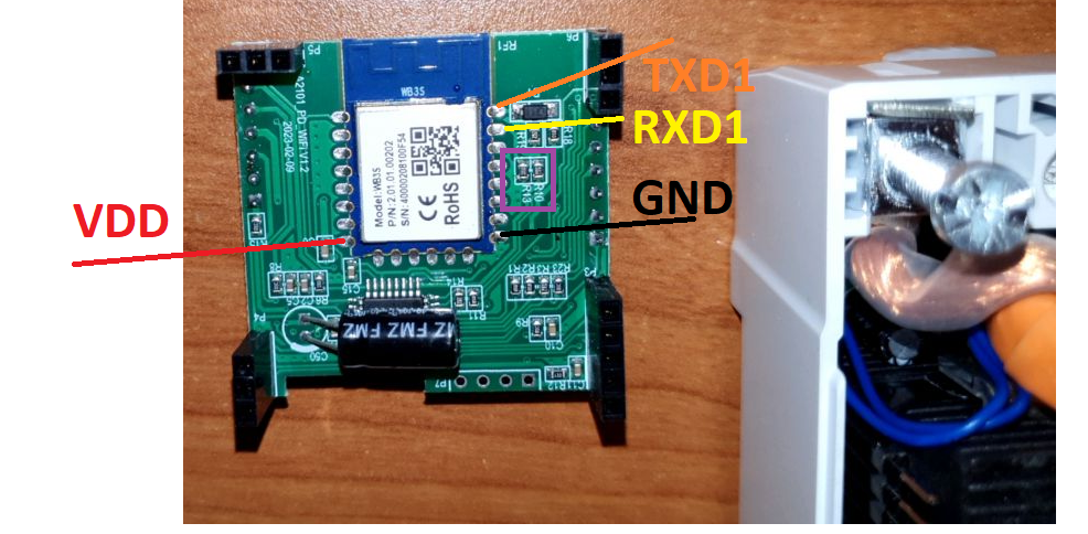

    In general, I think there is a hidden TuyaMCU under the electrolytic cap on one of your pictures which is responsible for reading data and LCD control. And it also communicates with the Wi-Fi (WB3S) module over UART.
  • #7 20693799
    Posts: 14770
    Rate: 12913
    You may be right. I can see UART traces there. They go through resistors.
    The image shows a circuit board with labels VDD, TXD1, RXD1, and GND next to a device with a metal component.
    That would mean that one would have to desolder them to temporary sever connection for the time of flashing.
    Or.... one could check if the MCU has some kind of RESET pin.
  • Direct wiring to TX1 and RX1 for flashing
    #8 20694140
    crash1912
    Level 4  
    Posts: 15
    >>20693745

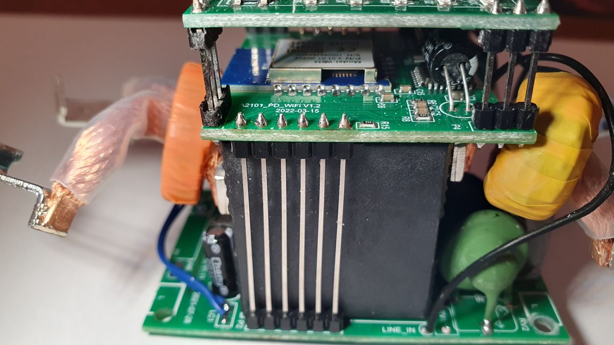

    With a multimeter, I can't find continuity between TX1, RX1, and any other board connection pin, only VDD and GND. I think I'll need to solder wires on TX1 and RX1...
    Under the capacitor, I can see:
    HC89F0541
    2242R1
    AA5062161
    Electronic board with WB3S model label, visible components, and pins.
    Added after 3 [minutes]:
    >>20693799
    Would that really mean that they would have to be desoldered to temporarily cut the connection when flashing? Soldering directly to TX1, RX1, VDD, GND not enough?
    TuyaMCU flashing may require resetting or cutting UART traces

    crash1912 wrote:
    With a multimeter I can't find continuity between TX1, RX1 and any other board connection pin, only VDD and GND, I think I'll need to solder wires on TX1 and RX1...
    Well, no surprises here, considering that it clearly looks like TX1 and RX1 go through resistors to MCU:
    Close-up of TuyaMCU module with HC89F0541 chip and WB3S module.
    crash1912 wrote:
    Under capacitor i can see:
    HC89F0541
    2242R1
    AA5062161

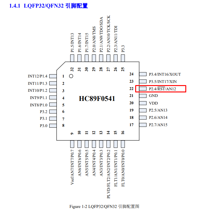

    It's TuyaMCU.
    Illustration of pin configuration for HC89F0541 chip in LQFP32/QFN32 package.
    Usually yes, but if you look at the HC89F0541 pinout above, you can see that it may have a RST signal at 22 pin of TQFP case. So, it may be possible to disable that MCU for the time of the flashing by grounding it's pin 22. If you do that, then cutting traces may not be required.
    In general, TuyaMCU is a device where WiFi module talks via UART with secondary MCU. The same UART is used for flashing. So, to flash, you need to either:
    a) put MCU in the RESET state (if possible)
    b) temporary cut the traces
    Added after 49 [seconds]:
    Just soldering it in case of TuyaMCU is usually not enough, but one can always try...

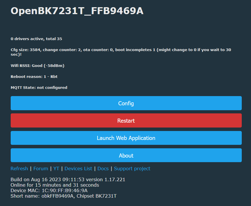

  • Backup and flash via pin 22 bridge with bk7231flasher
    #10 20697176
    crash1912
    Level 4  
    Posts: 15

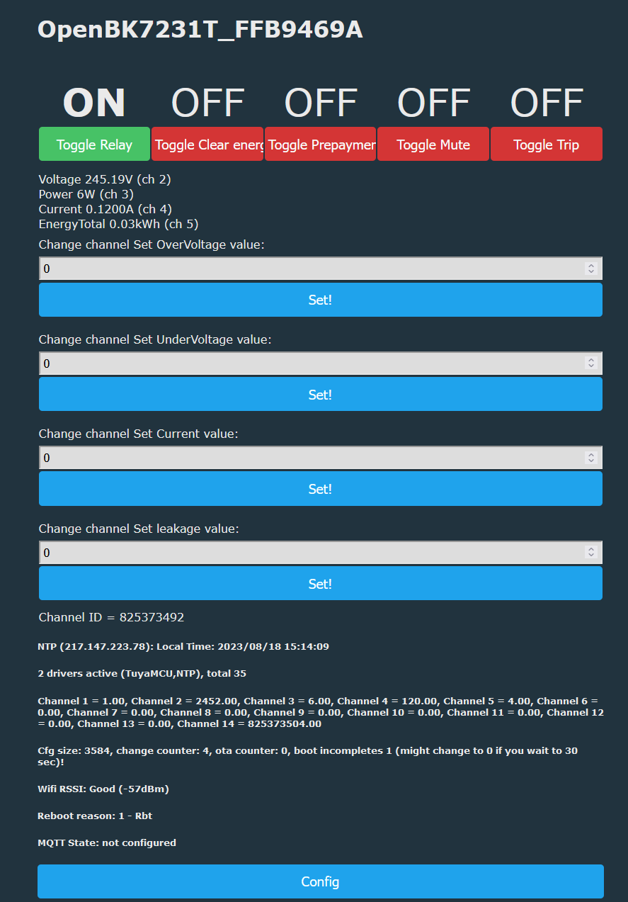

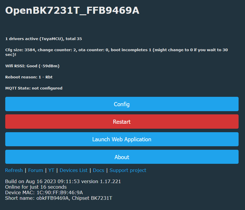

    You are right, without a bridge between pin 22 and GND, you cannot read/write anything.
    Using a little mini hook, I can create a bridge without soldering. For TX/RX, I held male pins to the board using my hands during backup and flashing (things one can do to avoid soldering... 😅)
    Circuit board with an integrated circuit and attached test probe.
    The backup and flash were successful using bk7231flasher_1.1.1. Now the device has the OpenBK7231T_UA_1.17.221.bin firmware (hopefully this is the correct firmware...). I'm not sure about the difference between UG, UA, or QIO, RBL. I understand that the UART version is better for my case, but I don't know if other flash methods exist (UG, RBL, QIO...).
    Is the extracted firmware generic or does it contain custom data only for my device? Same as MAC address, keys, etc...
    If the backup is safe to share, I can attach it to the main post so that anyone who needs it can use it.

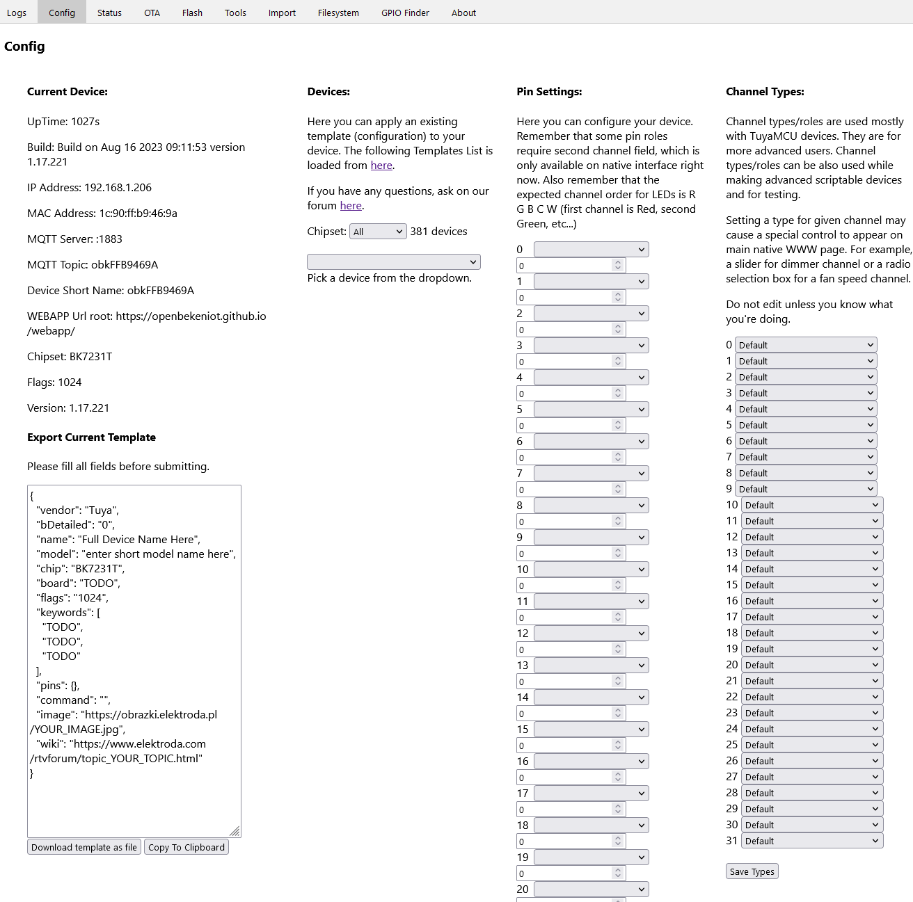

    Okay, now I have OpenBK 1.17.221, great! What is the next step?
    Screenshot of the OpenBK7231T interface with device information and configuration options.
    Screenshot of device configuration with OpenBK7231T firmware.

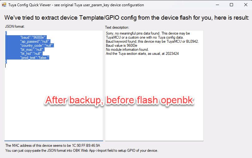

    2MB flash can contain your SSID if you paired it.
    Please post if you can, if not, please post only Tuya JSON.
    See how to extract JSON:
    This will tell us which baud rate is your device using.

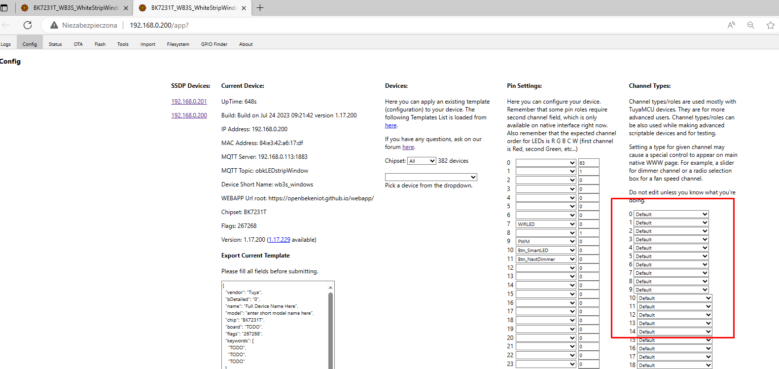

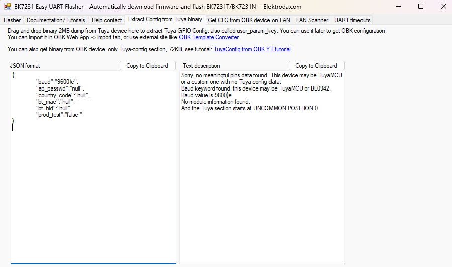

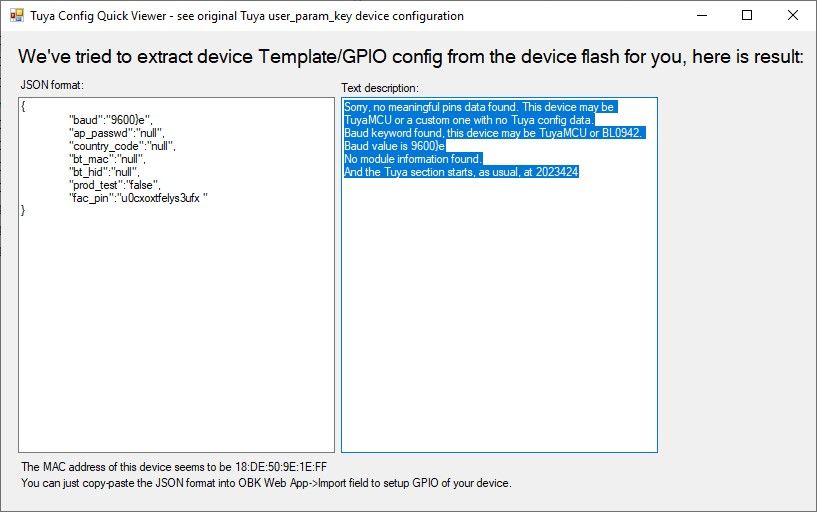

  • Backup JSON still extracts incorrectly after flash
    #12 20697221
    crash1912
    Level 4  
    Posts: 15
    The device is new, never used, does not contain any personal data configured for me. If it contains anything, it is from the factory (any device key or anything, I don't know).
    I have attached a backup to this answer. I hope it is correct. I don't know if I must upload it to an external server like Mega, etc.
    The extracted JSON appears incorrectly. I tried to extract this from the original backup before the flash, and now again the same as the video shared by you, both with the same data:
    Tuya Config Quick Viewer screen showing JSON and device configuration description.
    And after flash OpenBK(now)
    BK7231 Easy UART Flasher interface displaying JSON data and a text description.
    • readResult_BK7231T_QIO_2023-17-8-13-41-54.bin (2 MB) You must be logged in to download this attachment.

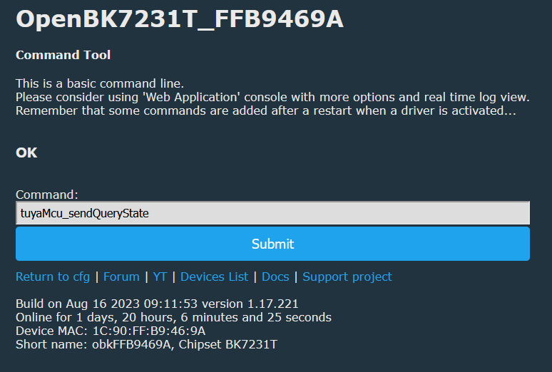

  • Set up TuyaMCU logging and test dPID changes

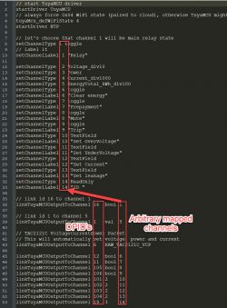

    #13 20697251
    Posts: 14770
    Rate: 12913

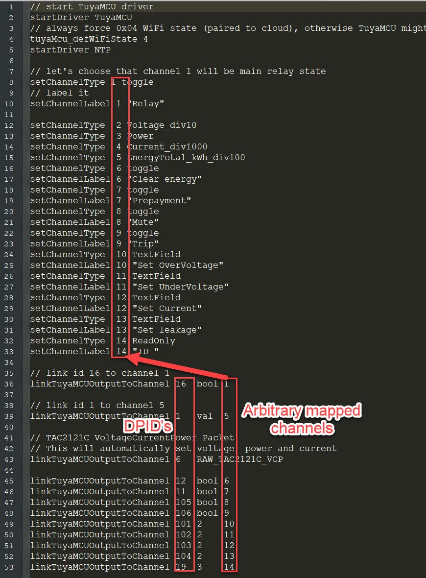

    That's good enough. Well done. So baud rate is the default, slow-speed one. Okay, so let's start with this autoexec.bat:
    // start TuyaMCU driver
    startDriver TuyaMCU
    // always force 0x04 WiFi state (paired to cloud), otherwise TuyaMCU might skip some data points
    tuyaMcu_defWiFiState 4
    This is autoexec.bat, create it in Web App -> LittleFS tab. Then save and reboot.
    Then open Web App log, and let's see what kind of data will be received. We will need to figure out the meaning of received data.
    Please see similar topic:
    https://www.elektroda.com/rtvforum/topic3959907.html
    Are you able to toggle the relay state on this device (does it even have a relay) from a physical button? If so, also do so, and look at the logs. Which dpID changes when you toggle the relay?
    EDIT: I looked at the first post, it seems this device also has some more buttons on case. So, you will need to also test those buttons. See what is being sent via TuyaMCU.
    Also note down the voltage readings, the current reading, etc.
    maybe put a 60W bulb load and then note down the voltage, current and power. Then post here separate Web App log. We will be searching for 60W, etc, in that log.

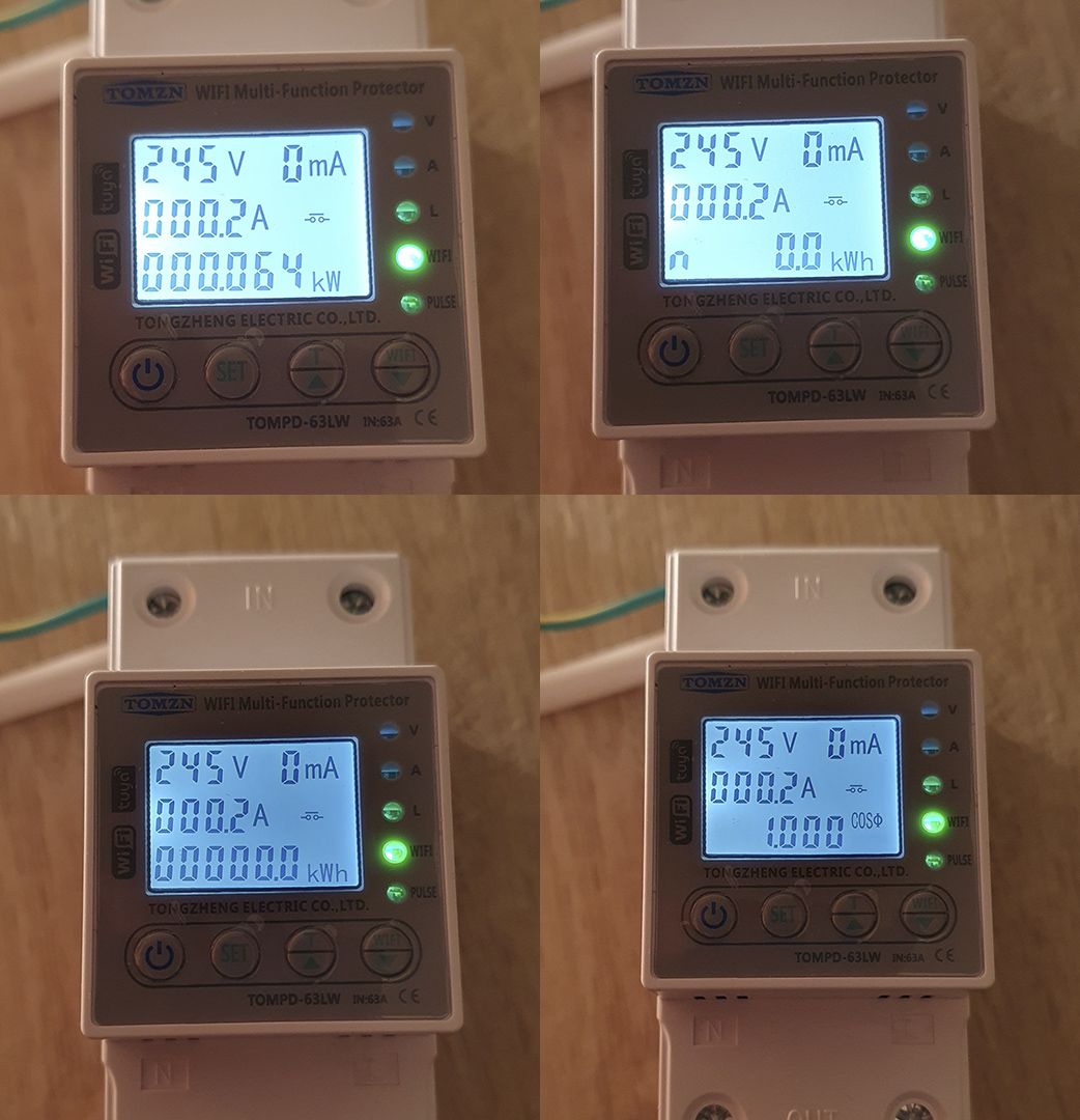

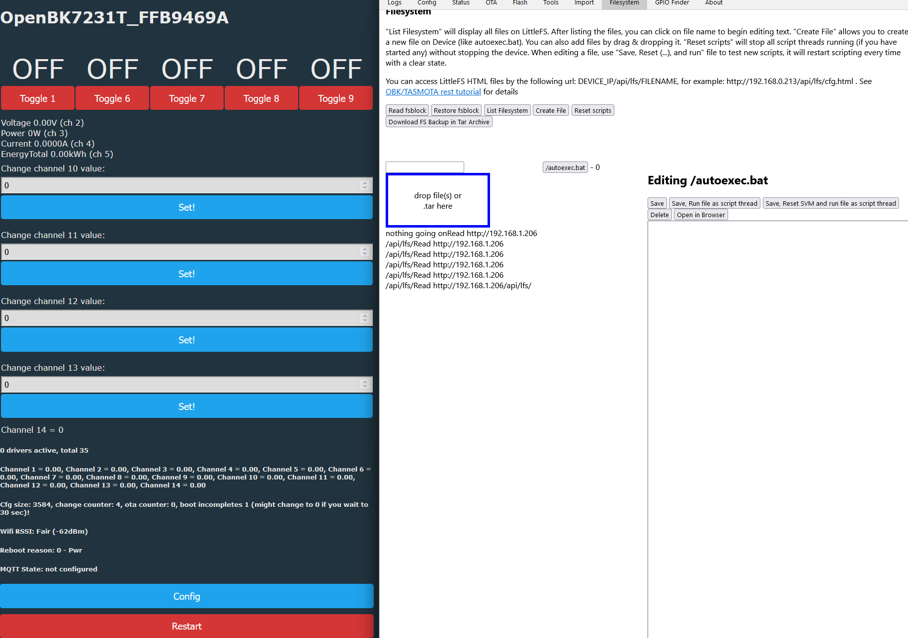

  • Captured TuyaMCU dpId 9 and 16 state messages
    #14 20697538
    crash1912
    Level 4  
    Posts: 15
    Ok now driver is already loaded:
    OpenBK7231T_FFB9469A user interface displaying device status information.
    Yes, i can toggle relay from physical button.
    In the recording tab, the data is very abundant, these are the minimum that I can capture after relay-off relay-on toggle with a 60w bulb connected(64w according to the meter display).
    Four images of a TOMZN WiFi Multi-Function Protector meter showing different current and voltage readings.

    PS: when you look at the EAMPDW-TY63 Alternative Firmware: Access Measurement Data with OpenBeken via TuyaMCU topic, it seems they also have dpId 16 used for relay. So maybe configs would be similar...
  • TuyaMCU mapping reveals missing voltage and leakage data
    #16 20698625
    crash1912
    Level 4  
    Posts: 15
    Correct, DP16 is a power switch relay! and using configuration from EAMPDW-TY63 now can see more data! but some is wrong...
    OverVoltage, UnderVoltage, Current and Leakage values appears 0, but OverVoltage is 270, UnderVoltage is 200, leakage current is 0 but set cut value is 20, and missing power factor values too.
    In other side, i'm happy viewing power values... but... only change in 2 minutes interval 😶, i understand this shit is possible hardware limited by factory, in lcd screen refresh each 0.5s, oh my god 2 minutes in remote... my first reason to flash was remove this bigger delay. F*ck! 😅
    I have 4 useless units! Ok, okay, I still want to get the best possible configuration so that they can serve other users who don't care so slow and inaccurate refresh values.
    This is configuration applied to autoexec.bat
    startDriver TuyaMCU
    startDriver NTP
    // let's choose that channel 1 will be main relay state
    setChannelType 1 toggle
    // label it
    setChannelLabel 1 "Relay"
    //linkTuyaMCUOutputToChannel 16 1 1
    setChannelType 2 Voltage_div10
    setChannelType 3 Power
    setChannelType 4 Current_div1000
    setChannelType 5 EnergyTotal_kWh_div100
    setChannelType 6 toggle
    setChannelLabel 6 "Clear energy"
    setChannelType 7 toggle
    setChannelLabel 7 "Prepayment"
    setChannelType 8 toggle
    setChannelLabel 8 "Mute"
    setChannelType 9 toggle
    setChannelLabel 9 "Trip"
    setChannelType 10 TextField
    setChannelLabel 10 "Set OverVoltage"
    setChannelType 11 TextField
    setChannelLabel 11 "Set UnderVoltage"
    setChannelType 12 TextField
    setChannelLabel 12 "Set Current"
    setChannelType 13 TextField
    setChannelLabel 13 "Set leakage"
    setChannelType 14 ReadOnly
    setChannelLabel 14 "ID "
    // link id 16 to channel 1
    linkTuyaMCUOutputToChannel 16 bool 1
    // link id 1 to channel 5
    linkTuyaMCUOutputToChannel 1 val 5
    // TAC2121C VoltageCurrentPower Packet
    // This will automatically set voltage, power and current
    linkTuyaMCUOutputToChannel 6 RAW_TAC2121C_VCP
    linkTuyaMCUOutputToChannel 12 bool 6
    linkTuyaMCUOutputToChannel 11 bool 7
    linkTuyaMCUOutputToChannel 105 bool 8
    linkTuyaMCUOutputToChannel 106 bool 9
    linkTuyaMCUOutputToChannel 101 2 10
    linkTuyaMCUOutputToChannel 102 2 11
    linkTuyaMCUOutputToChannel 103 2 12
    linkTuyaMCUOutputToChannel 104 2 13
    linkTuyaMCUOutputToChannel 19 3 14
    Configuration screen for the OpenBK7231T_FFB9469A device with options to change overvoltage, undervoltage, current, and leakage settings.
  • #17 20699148
    Posts: 14770
    Rate: 12913
    How does your current web app log looks like? Which dpIDs are working? You've jumped quickly to very advanced config and I am not sure if it's entirely correct.
    Have you tried to use tuyaMcu_sendQueryState command to get full state dumps quicker than default 2 minutes?
  • Mapping Tuya dpIDs to channels in TOMPD-63-LW
    #18 20700795
    crash1912
    Level 4  
    Posts: 15
    Ok, well I think so too, I've gone too fast :)
    tuyaMcu_sendQueryState force refresh arbitrary? this looks good!! I like this!! Works great!! ¿Can refresh each 5~10s automatically?
    ok, now let's talk about the dpID's. I'm bit confused, when define "linkTuyaMCUOutputToChannel 16 bool 1" 16 is "dpID" and "1" is arbitrary channel?
    By default all channels is free to use? I can set any dpID to any channel choose by me?
    TuyaMCU configuration code with dpID to channel links
    Ok, now let's see the current configuration
    startDriver TuyaMCU
    startDriver NTP
    setChannelType 1 toggle // works fine!
    // label it
    setChannelType  2 Voltage_div10 // correct value
    setChannelType  3 Power // correct value
    setChannelType  4 Current_div1000 // correct value
    setChannelType  5 EnergyTotal_kWh_div100 // *possibly correct value
    setChannelType  6 toggle // i think this doesn't work, on/off apparently doesn't change any function
    setChannelType  7 toggle // * i think this works, with this enabled, i cannot turn on main relay (i think possible stored prepay value is 0)
    setChannelType  8 toggle // i think this doesn't work, on/off apparently doesn't change any function
    setChannelType  9 toggle // i think this doesn't work, on/off apparently doesn't change any function
    setChannelType  10 TextField // shows 0
    setChannelType  11 TextField // shows 0
    setChannelType  12 TextField // shows 0
    setChannelType  13 TextField // shows 0
    setChannelType  14 ReadOnly // shows 825373492
    linkTuyaMCUOutputToChannel 16  bool 1 // Main Relay
    linkTuyaMCUOutputToChannel 1   val  5 // possibly correct value
    linkTuyaMCUOutputToChannel 6   RAW_TAC2121C_VCP // how works this?
    linkTuyaMCUOutputToChannel 12  bool 6 // unknown
    linkTuyaMCUOutputToChannel 11  bool 7 // i think possible prepay switch
    linkTuyaMCUOutputToChannel 105 bool 8 // unknown
    linkTuyaMCUOutputToChannel 106 bool 9 // unknown
    linkTuyaMCUOutputToChannel 101 2    10 // unknown
    linkTuyaMCUOutputToChannel 102 2    11 // unknown
    linkTuyaMCUOutputToChannel 103 2    12 // unknown
    linkTuyaMCUOutputToChannel 104 2    13 // unknown
    linkTuyaMCUOutputToChannel 19  3    14 // unknown
    This log contains multiple tuyaMcu_sendQueryState:

    Command trigger area is this, right?
    OpenBK7231T command console interface with an input field for entering a command.
  • dpId 12 missing; raw dpId 18 needs decoding

  • How RAW_TAC2121C_VCP populates voltage, power, and current
    #20 20702297
    crash1912
    Level 4  
    Posts: 15
    Repeating event is wonderful, i added "addRepeatingEvent 10 -1 tuyaMcu_sendQueryState" and works amazing.
    Possible stupid question: if channels are like variable and dpID's are same as constant forced... can bad channel configured overwrites any dpID accidentally?
    In other words, if currently exists dpID... 1 and using "variable" channel allocated to channel 1, channel 1 can be overwrite accidentally?
    Is possible dump all dpIDs and Channels currently available same as var_dump in other programming languages?
    Ok, in other order i removed potential problems in my script (script was copied from other thread of EAMPDW-TY63), now i cleaned autoexec.bat for start from more clean scenary.
    Now my autoexec.bat is:
    startDriver TuyaMCU
    startDriver NTP
    // label it
    // NOTE: addRepeatingEvent [RepeatTime] [RepeatCount]
    // code below will forever toggle relay every 15 seconds
    How works linkTuyaMCUOutputToChannel 6 RAW_TAC2121C_VCP? What does exactly? removing this, i can see channels 2,3,4,5 with "0" values.
    I have a question, after remove all autoexec.bat, in main screen buttons is not removing, all fields keep here without values. ¿How to remove this without hard reset?
    Screenshot of the OpenBK7231T user interface with panels for controlling buttons and the autoexec.bat file.
    Lastly, I don't know what dpid 18 could be... what can i do to help find out?

    Info:MAIN:Time 62035, idle 258381/s, free 84008, MQTT 0(3877), bWifi 1, secondsWithNoPing 61966, socks 2/38
    Info:MAIN:Time 62037, idle 530968/s, free 84008, MQTT 0(3877), bWifi 1, secondsWithNoPing 61968, socks 2/38
    Info:TuyaMCU:TUYAMCU received: 55 AA 03 00 00 01 01 04
    Info:TuyaMCU:TuyaMCU_ProcessIncoming[ver=3]: processing command 0 (Hearbeat) with 8 bytes
    Info:MAIN:Time 62038, idle 267223/s, free 84008, MQTT 0(3877), bWifi 1, secondsWithNoPing 61969, socks 2/38
    Info:MAIN:Time 62039, idle 263547/s, free 84008, MQTT 0(3877), bWifi 1, secondsWithNoPing 61970, socks 2/38
    Info:MAIN:Time 62040, idle 259322/s, free 84008, MQTT 0(3877), bWifi 1, secondsWithNoPing 61971, socks 2/38
    Info:GEN:dhcp=0 ip=192.168.1.206 gate=192.168.1.1 mask=255.255.255.0 mac=1c:90:ff:b9:46:9a
    Info:GEN:sta:rssi=-57,ssid=MyWifi-2G,bssid=xx:xx:xx:xx:xx:xx,channel=1,cipher_type:CCMP
    Info:TuyaMCU:TUYAMCU received: 55 AA 03 07 00 05 10 01 00 01 01 21
    Info:TuyaMCU:TuyaMCU_ProcessIncoming[ver=3]: processing command 7 (State) with 12 bytes
    Info:TuyaMCU:TuyaMCU_ParseStateMessage: processing dpId 16, dataType 1-DP_TYPE_BOOL and 1 data bytes
    Info:TuyaMCU:TuyaMCU_ParseStateMessage: raw data 1 byte:
    Info:GEN:No change in channel 1 (still set to 1) - ignoring
    Info:TuyaMCU:TUYAMCU received: 55 AA 03 07 00 08 13 03 00 04 31 32 33 34 F5
    Info:TuyaMCU:TuyaMCU_ProcessIncoming[ver=3]: processing command 7 (State) with 15 bytes
    Info:TuyaMCU:TuyaMCU_ParseStateMessage: processing dpId 19, dataType 3-DP_TYPE_STRING and 4 data bytes
    Info:TuyaMCU:TuyaMCU_ParseStateMessage: raw data 4 int: 825373492
    Info:TuyaMCU:TUYAMCU received: 55 AA 03 07 00 08 11 00 00 04 04 01 00 14 3F
    Info:TuyaMCU:TuyaMCU_ParseStateMessage: processing dpId 17, dataType 0-DP_TYPE_RAW and 4 data bytes
    Info:TuyaMCU:TuyaMCU_ParseStateMessage: raw data 4 int: 67174420
    Info:TuyaMCU:TUYAMCU received: 55 AA 03 07 00 10 12 00 00 0C 01 01 00 28 03 01 01 0E 04 01 00 C8 41
    Info:TuyaMCU:TuyaMCU_ProcessIncoming[ver=3]: processing command 7 (State) with 23 bytes
    Info:TuyaMCU:TuyaMCU_ParseStateMessage: processing dpId 18, dataType 0-DP_TYPE_RAW and 12 data bytes
    Info:TuyaMCU:TUYAMCU received: 55 AA 03 07 00 08 01 02 00 04 00 00 00 0C 24
    Info:TuyaMCU:TuyaMCU_ParseStateMessage: processing dpId 1, dataType 2-DP_TYPE_VALUE and 4 data bytes
    Info:TuyaMCU:TuyaMCU_ParseStateMessage: raw data 4 int: 12
    Info:GEN:No change in channel 5 (still set to 12) - ignoring
    Info:TuyaMCU:TUYAMCU received: 55 AA 03 07 00 08 0F 02 00 04 00 00 00 00 26
    Info:TuyaMCU:TuyaMCU_ParseStateMessage: processing dpId 15, dataType 2-DP_TYPE_VALUE and 4 data bytes
    Info:TuyaMCU:TuyaMCU_ParseStateMessage: raw data 4 int: 0
    Info:TuyaMCU:TUYAMCU received: 55 AA 03 07 00 0C 06 00 00 08 09 51 00 01 40 00 00 48 06
    Info:TuyaMCU:TuyaMCU_ProcessIncoming[ver=3]: processing command 7 (State) with 19 bytes
    Info:TuyaMCU:TuyaMCU_ParseStateMessage: processing dpId 6, dataType 0-DP_TYPE_RAW and 8 data bytes
    Info:GEN:CHANNEL_Set channel 2 has changed to 2385 (flags 0)
    Info:MQTT:Channel has changed! Publishing 2385 to channel 2
    Info:GEN:CHANNEL_Set channel 4 has changed to 320 (flags 0)
    Info:MQTT:Channel has changed! Publishing 320 to channel 4
    Info:GEN:No change in channel 3 (still set to 72) - ignoring
    Info:TuyaMCU:TUYAMCU received: 55 AA 03 07 00 05 0B 01 00 01 00 1B
    Info:TuyaMCU:TuyaMCU_ParseStateMessage: processing dpId 11, dataType 1-DP_TYPE_BOOL and 1 data bytes
    Info:GEN:No change in channel 7 (still set to 0) - ignoring
    Info:TuyaMCU:TUYAMCU received: 55 AA 03 07 00 08 0D 02 00 04 00 00 00 00 24
    Info:TuyaMCU:TuyaMCU_ParseStateMessage: processing dpId 13, dataType 2-DP_TYPE_VALUE and 4 data bytes
    Info:MAIN:Time 62041, idle 282274/s, free 84008, MQTT 0(3877), bWifi 1, secondsWithNoPing 61972, socks 2/38
    Info:MAIN:Time 62043, idle 257623/s, free 84008, MQTT 0(3877), bWifi 1, secondsWithNoPing 61974, socks 2/38
    Info:MAIN:Time 62044, idle 263821/s, free 84008, MQTT 0(3878), bWifi 1, secondsWithNoPing 61975, socks 2/38
    Info:MAIN:Time 62045, idle 259735/s, free 84008, MQTT 0(3878), bWifi 1, secondsWithNoPing 61976, socks 2/38
    Info:MAIN:Time 62046, idle 267121/s, free 84008, MQTT 0(3878), bWifi 1, secondsWithNoPing 61977, socks 2/38
    Info:MAIN:Time 62047, idle 257009/s, free 84008, MQTT 0(3878), bWifi 1, secondsWithNoPing 61978, socks 2/38
    Info:TuyaMCU:TUYAMCU received: 55 AA 03 07 00 08 09 05 00 04 00 00 00 08 2B
    Info:TuyaMCU:TuyaMCU_ParseStateMessage: processing dpId 9, dataType 5-DP_TYPE_BITMAP and 4 data bytes
    Info:TuyaMCU:TUYAMCU received: 55 AA 03 07 00 05 10 01 00 01 00 20
    Info:GEN:CHANNEL_Set channel 1 has changed to 0 (flags 0)
    Info:MQTT:Channel has changed! Publishing 0 to channel 1
    Info:MAIN:Time 62048, idle 262548/s, free 83816, MQTT 0(3878), bWifi 1, secondsWithNoPing 61979, socks 3/38
    Info:TuyaMCU:TUYAMCU received: 55 AA 03 07 00 08 09 05 00 04 00 00 00 00 23
    Info:GEN:CHANNEL_Set channel 1 has changed to 1 (flags 0)
    Info:MQTT:Channel has changed! Publishing 1 to channel 1
    Info:NTP:Seconds since Jan 1 1900 = 3901610319
    Info:NTP:Unix time  : 1692621519
    Info:NTP:Local Time : 2023/08/21 12:38:39
    Info:MAIN:Time 62049, idle 243723/s, free 84008, MQTT 0(3878), bWifi 1, secondsWithNoPing 61980, socks 2/38
    Info:MAIN:Time 62050, idle 231608/s, free 84008, MQTT 0(3878), bWifi 1, secondsWithNoPing 61981, socks 2/38
    Info:TuyaMCU:TUYAMCU received: 55 AA 03 07 00 0C 06 00 00 08 09 4E 00 01 0E 00 00 41 CA
    Info:GEN:CHANNEL_Set channel 2 has changed to 2382 (flags 0)
    Info:MQTT:Channel has changed! Publishing 2382 to channel 2
    Info:GEN:CHANNEL_Set channel 4 has changed to 270 (flags 0)
    Info:MQTT:Channel has changed! Publishing 270 to channel 4
    Info:GEN:CHANNEL_Set channel 3 has changed to 65 (flags 0)
    Info:MQTT:Channel has changed! Publishing 65 to channel 3
    Info:MAIN:Time 62051, idle 258218/s, free 84008, MQTT 0(3878), bWifi 1, secondsWithNoPing 61982, socks 2/38
    Info:MAIN:Time 62052, idle 178909/s, free 84008, MQTT 0(3878), bWifi 1, secondsWithNoPing 61983, socks 2/38
    Info:MAIN:Time 62056, idle 261273/s, free 84008, MQTT 0(3878), bWifi 1, secondsWithNoPing 61987, socks 2/38
    Info:MAIN:Time 62058, idle 260566/s, free 84008, MQTT 0(3878), bWifi 1, secondsWithNoPing 61989, socks 2/38
    Info:MAIN:Time 62059, idle 262307/s, free 84008, MQTT 0(3878), bWifi 1, secondsWithNoPing 61990, socks 2/38
    I have compiled a list with all the values that this device handles, with the fixed values included. I hope it can help
    Switches:
    Power Switch: Channel 1
    Prepayment switch: Channel 7 (probably, although the prepaid balance cannot be changed, the function test is difficult)
    Leakage test switch: unknown Channel
    Read only data:
    Voltage:      Channel 2
    Power(w):     Channel 3
    Current(a):   Channel 4
    Current(kWh): Channel 5
    Prepayment balance energy(kwh): unknown Channel
    Power factor Φ: Unknown channel
    Over-voltage protection status: boolean
    Under-voltage protection status: boolean
    Over current protection status: boolean
    Leakage protection status: boolean
    Read+Write configuration sections:
    (id)   : Val  | Description (unit)
    (bt)   : 15   | Screen bright time (S)
    (At)   : off  | Display interval delay time (S)
    (Pt)   : 10   | Power-on delay time (S)
    (UH)   : 270  | Over-voltage protection value (V)
    (UHr)  : 265  | Over-voltage recovery value (V)
    (UHrt) : 30   | Over-voltage recovery delay time (S)
    (UHtt) : 1    | Over-voltage protection action time (S)
    (UL)   : 200  | Under-voltage protection value (V)
    (ULr)  : 210  | Under-voltage recovery value (V)
    (UHrt) : 30   | Under-voltage recovery delay time (S)
    (ULtt) : 1    | Under-voltage protection action time (S)
    (CH)   : 40.0 | Over-current protection value (A)
    (CHrt) : 30   | Over-current recovery delay time (S)
    (CHtt) : 3    | Over-current protection action time (S)
    (CC)   : off  | Continuous over current faults times (1-20)
    (LC)   : 20   | Leakage protection value (mA)
    (LCrt) : 30   | Leakage recoery delay time (S)
    (LCC)  : off  | Continuous leakage faults times (1-20)
    (UAd┘) : 0.3  | Voltage calibration (%)

  • TuyaMCU channel mapping and raw dpid diagnostics
    #22 20707663
    Posts: 14770
    Rate: 12913
    You can't break TuyaMCU that way, but it may cause wrong readings.
    The best I can suggest at the moment is tuyaMcu_sendQueryState.
    This is a special type that parses given packet binary data and splits it into separate voltage, current and power channels. In that case, single dpID contains all those 3 values.
    You are correct. You still have channel types set in Web App.
    It looks like it is raw bytes type, I might need to add ability to dumps this data to console so we can analyze it.

  • Need to clear channel types in web app
    #24 20710385
    crash1912
    Level 4  
    Posts: 15
    ¿How to remove this buttons previously created by autoexec.bat when autoexec.bat now is clean but buttons still appears without hard reset?
    I can see that cleaning autoexec.bat is not enough.
    It looks like it is raw bytes type, I might need to add ability to dumps this data to console so we can analyze it.[/quote]
    Can i do anything for help?
  • #25 20710443
    Posts: 14770
    Rate: 12913
    I will add ability to dump this to console soon.
    Regarding buttons, I think you need to set Channel Type to none here;
    Screenshot of device configuration panel with various settings.
    Please try and let me know if it helps.
  • #26 20713320
    crash1912
    Level 4  
    Posts: 15
    It works, now set all to default and main interface is clean.

    I received it yesterday, and have made a dump from the "virgin" device (attached) before even powering it up for the first time.
    I've found two differences from the one of @crash1912 in the first post: Mine has a CBU module instead of WB3S (so the corresponding PCB has small differences to accommodate the different pinout, and the display is now colored and "negative" (black background). The rest of the hardware seems to be the same (I will add photos later on)
    Screenshot from the Tuya Config Quick Viewer application showing device configuration in JSON format and a text description.
    • readResult_BK7231N_QIO_TOMPD-63LW_virgin_2023-23-11-18-05-53.bin (2 MB) You must be logged in to download this attachment.

  • The breaker is rated 230 V, 50/60 Hz, up to 63 A, and the product description listed adjustable thresholds such as undervoltage 140–210 V, overvoltage 225–295 V, overcurrent 1–63 A, reconnect delay 1–500 s, and action time 1–30 s. [#20693422]
  • A successful flash path on the WB3S version used a full 2 MB backup, bk7231flasher_1.1.1, and OpenBK7231T_UA_1.17.221.bin; grounding pin 22 of the HC89F0541 reset line enabled UART read/write without permanent board cutting. [#20697176]
  • dpID 16 was confirmed as the main relay, dpID 6 carries the combined voltage/current/power packet, dpID 1 is total energy, and dpID 9 is the fault bitmap rather than a single numeric alarm. [#20697712]
  • The Tuya cloud model exposed at least 20 dpIDs on later units, including 104 power factor, 105 supply frequency, 106 refresh, 116 voltage, 117 current, and 118 active power, beyond the earlier basic set. [#20837470]
  • Default reporting was slow enough to frustrate users, but adding addRepeatingEvent 10 -1 tuyaMcu_sendQueryState produced practical refreshes every 10 s instead of waiting for the long factory interval. [#20702297]

Why do some TOMZN TOMPD-63-LW units need the HC89F0541 reset pin tied to GND before UART read/write will work?
They need it because the TuyaMCU shares the same UART lines used for flashing the Wi-Fi module. If the HC89F0541 stays active, it drives or listens on that bus and blocks clean UART read/write. One successful workaround grounded pin 22, the reset pin, during backup and flashing. That let UART access work without desoldering the resistor links between the TuyaMCU and the WB3S module. [#20694223]

Which dpIDs have been identified for the TOMZN TOMPD-63-LW, and what do dpIDs 1, 6, 9, 11, 12, 13, 14, 15, 16, 17, 18, 19, 21, 101, 104, and 105 mean?
The key dpIDs are known. 1 total energy, 6 phase A V/I/P raw packet, 9 fault bitmap, 11 prepayment switch, 12 clear prepaid energy, 13 balance energy, 14 charge energy, 15 leakage current, 16 relay switch, 17 alarm_set_1, 18 alarm_set_2, 19 breaker ID, 21 leakage test, 101 clear all energy, 104 power factor, and 105 supply frequency. Later cloud data also exposed 106 refresh, 116 voltage, 117 current, and 118 active power on newer units. [#20854635]
How do channels and dpIDs differ in OpenBeken, and how should linkTuyaMCUOutputToChannel be used correctly on a TuyaMCU breaker?
dpIDs are fixed Tuya datapoints; channels are OpenBeken variables you assign yourself. You can map any suitable dpID to any free channel, but the meaning and type of the dpID do not change. The correct syntax is linkTuyaMCUOutputToChannel [dpId] [varType] [channelID]. In practice, the thread used mappings like linkTuyaMCUOutputToChannel 16 bool 1 for the relay and linkTuyaMCUOutputToChannel 1 val 5 for total energy. [#20700864]

What is the best way to remove leftover buttons or fields from the OpenBeken web UI after changing or clearing autoexec.bat on this breaker?
Set the old channels back to Channel Type = none in the Web App. Clearing autoexec.bat alone does not remove previously stored UI channel types, so the empty controls remain visible. The fix was confirmed after manually resetting those channel types to default, which cleaned the main interface without a hard reset. If you change autoexec layouts often, clear channel types before assuming the script failed. [#20710443]
