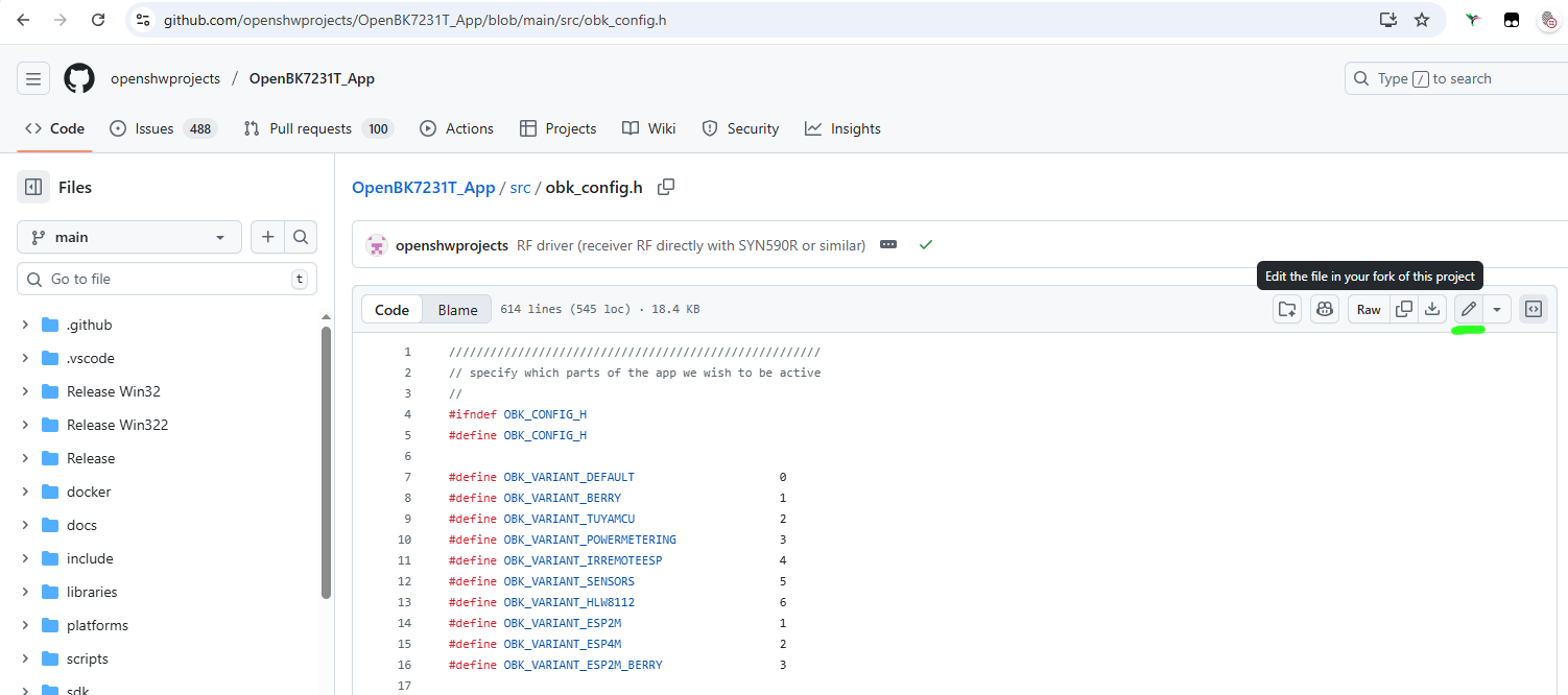

    I don't recall when but I enabled workflows in my own fork so now only do a PR when there's something for your attention.
    You could try pencil icon edit to a file on main and it'll just do a little Patch-1 fork? Sometimes I do this for small edits like in obk_config.h
    maybe @Tilator go here https://github.com/openshwprojects/OpenBK7231T_App/blob/main/src/obk_config.h
    and then:

    I made a fork.
    Then I changed header file even though I'm still not sure what section there is for BK7231N and *T devices. There isn't such section.
    If I now make a pull reguest, what exactly happens? It sounds like it does not start any compiling.
    I managed to make my first release, but it contains only two source code packages. Do I only need to wait now for it to compile or what?
