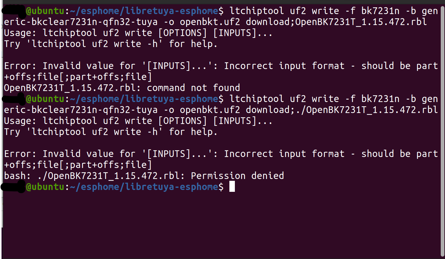

    Hi, I have successfully flashed OpenBK7231T using tuya-cloudcutter and all is working well. Teardown submitted.
    However, with some earlier attempts with the same bulb, I flashed esphome using tuya-cloudcutter. I could not get the right config working with esphome and so would now like to re-flash it with OpenBK7231T. Unfortunately, I don't have any soldering skills so I need to do this OTA.
    I can access the device using the "Fallback wifi hotspot" (192.168.4.1) and the via esphome server page. However when I try to use any of the firmware from the OpenBK7231T releases the flashing fails with:
    "Update Failed: ard=8,uf2=2"
    I'm presumed this means that the esphome requires the firmware to be in the uf2 format. So I tried running the running the OpenBK7231T_UG_1.15.454.bin file through a bin2uf2 converter without success, this time the esphome ota fails with:
    "Update Failed: ard=11,uf2=3"
    Should it in theory be possible to flash OpenBK7231T using the esphome OTA web service or is flashing to esphome a one-way street?
    Does anyone have any suggestions on how I can convert/flash any of the OpenBK7231T releases using the esphome web service.

    On libretuya, convert the openbk.rbl firmware to .uf2 using lchiptool, then upload to your web server.
    #convert rbl to uf2
    ltchiptool uf2 write -f bk7231n -b generic-bk7231n-qfn32-tuya -o openbkt.uf2 download;OpenBK7231N_1.12.50.rbl

    Thanks, unfortunately, I couldn't get that command to work.
    I tried using "download;OpenBK.....rbl" and also "download;./OpenBK.....rbl" as per screenshot below.
    I tried using sudo, but got the same Permission Denied.
    Also does it matter that it's using bk7231n and not bk7231t?
    I tried changing it to use bk7231t and it errors with "Family not found"

    I also tried
    ltchiptool uf2 info OpenBK7231T_UG_1.15.472.rbl
    which returned
    E: ValueError: Invalid Magic 1 (b'RBLx00')
    E: |-- File "/home/username/.local/lib/python3.8/site-packages/uf2tool/models/block.py", line 76, in decode

    nealjka wrote:
    Also does matter that it's using bk7231n and not bk7231t?
    I'm not quite sure, but it's better to stick with the device type scheme (T or N)
    Mostly just following the instruction posted by the dev, works well for me on windows

    for bk7231t -> -f bk7231u
    ltchiptool uf2 write -f bk7231u -b generic-bk7231t-qfn32-tuya -o openbkt.uf2 ';;download;OpenBK7231T_1.15.440.rbl'
    ltchiptool uf2 info openbkt.uf2
    I: Family: BK7231U / Beken 7231U/7231T
    I: Tags:
    I: - BOARD: generic-bk7231t-qfn32-tuya
    I: - DEVICE_ID: 7b4bd984
    I: - BUILD_DATE: 12ac1264
    I: - OTA_VERSION: 01
    I: - DEVICE: LibreTuya
    I: - LT_HAS_OTA1: 00
    I: - LT_HAS_OTA2: 01
    I: - LT_PART_1:
    I: - LT_PART_2: download
    I: Data chunks: 1868
    I: Total binary size: 478016
