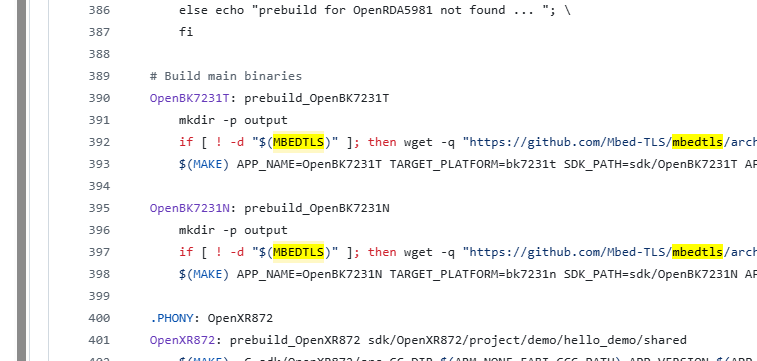

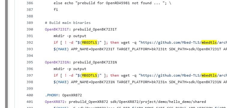

    I think you need some little changes to makefile, because BK7238 path may not contain it.
    https://github.com/openshwprojects/OpenBK7231T_App/blob/main/Makefile
    Look for MBEDTLS
    Makefile snippet with build commands and MBEDTLS directory check using wget

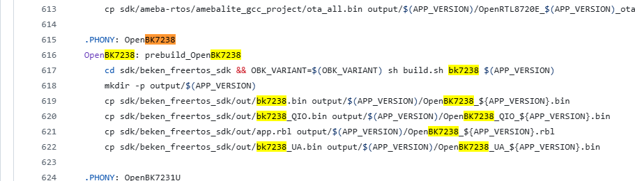

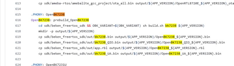

    It's not included for bk7238
    Makefile snippet with build targets for BK7238 variant
    @insmod would you know how to add this for BK7238 path? I think BK7238 does not have auto file search, so would also need to include makefiles. Or maybe is the MBEDTLS in beken_Freertos_sdk?

    beken_freertos_sdk uses mbedtls by default, so only some flags would need to be enabled.
