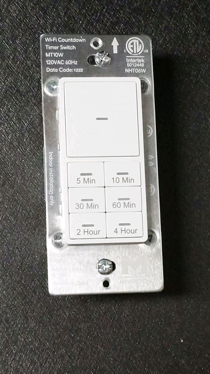

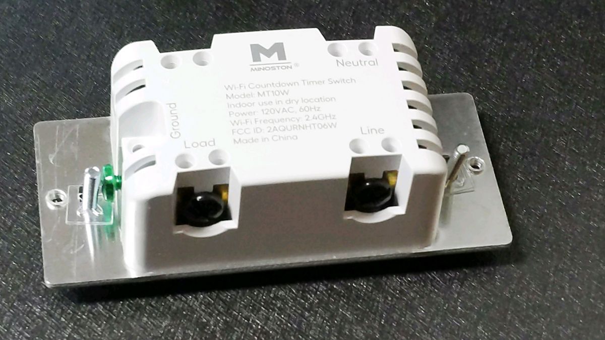

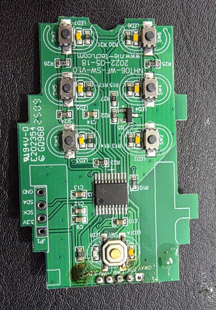

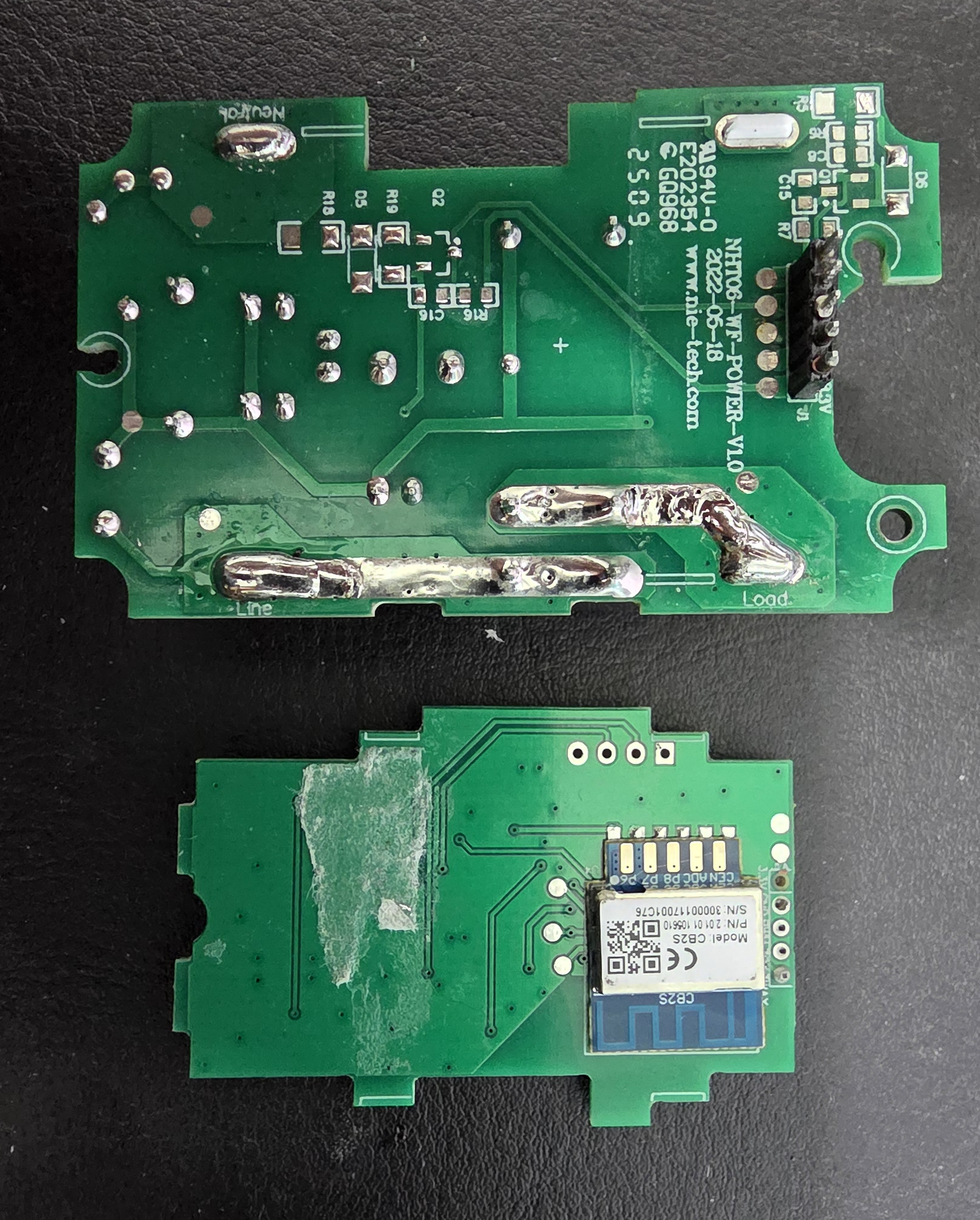

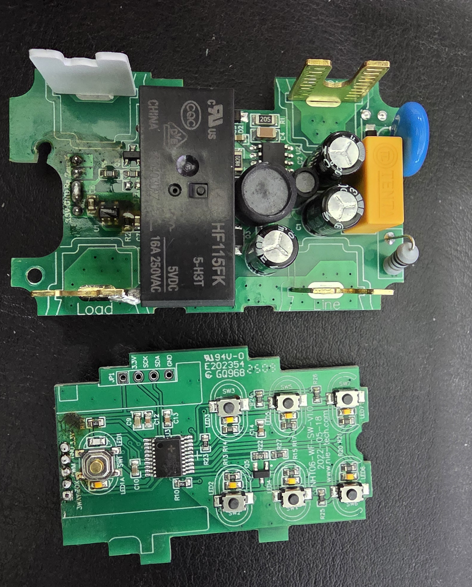

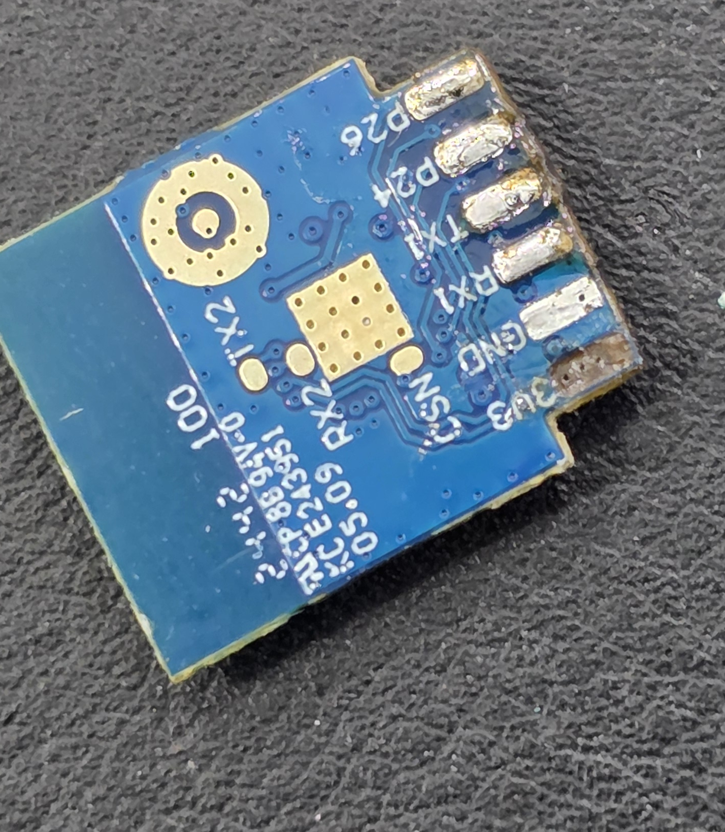

    Photos of the device
    Wi-Fi timer switch with buttons to set time from 5 minutes to 4 hours. Minoston MT10W Wi-Fi timer switch.

  • #13 21901066
    gomelkiev
    Posts: 15
    I separated both PCBs from timer.
    [BK7231N] OpenBeken install on Minoston MT10W timer switch with TuyaMCU
    To where I need to connect UART programmer?
    Thanks.
    I have timer completely apart, if someone needs more photos, just let me know.
  • #14 21901339
    Posts: 5212
    Help: 446
    Rate: 914
    looks like the TuyaMCU half, what's on the other side and on the other PCBs?
  • #16 21901707
    Posts: 5212
    Help: 446
    Rate: 914
    yes, OK. It's the CB2S you'll want to connect up to to dump factory flash then program OpenBK7231N

    gomelkiev
    Posts: 15
    Got 2nd unit from eBay, trying to unsolder CB2S, broke 3.3 V, I'm not good with the solder, anyone in the USA can program 3 Wi-Fi timers and sell to me?
    Got 2 more incoming, will try again. Also on AliExpress someone selling new CB2S, can I buy those and replace broken mines?
    Thanks.
  • #21 21906457
    gomelkiev
    Posts: 15
    Able to de-solder/solder one, so have 1 unit working!
    But 2nd CB2s i think 3.3 V contact is dead?
  • #22 21909264
    gomelkiev
    Posts: 15
    Confirming: Got new cb2s from aliexpress, soldered to timer and it's working, thanks to everyone for help!
  • Damaged 3.3V pin may still be repairable
    #23 21909267
    Posts: 14755
    Rate: 12881
    This CB2S module with a damaged 3.3V pin could still potentially be repaired with some precise soldering, so it may still be useful for experiments or testing.
    It’s also possible that the module could still power on if 3.3V is connected to a different pin, although this is not recommended. The BK7231 may contain internal protection/clamping diodes that allow power to pass internally in such cases. Maybe @divadiow could test this behavior on a working CB2S module.
  • #24 21909270
    gomelkiev
    Posts: 15
    >>21909267 Thanks for advice, I already soldered new one and it is working.
