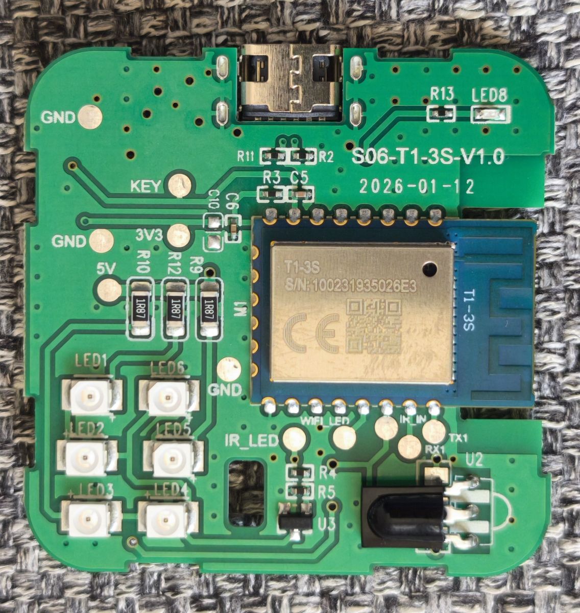

    I recently did a tear-down and reflash of a new S06 Pro.
    Hardware
    This device has already been covered in a number of posts and is already in the teardown database.
    However, as you can see from the images, my device seems to be a new version that uses the T1-3S CPU - which is a BK7238.
    Blue PCB with Bluetooth module and USB-C port on wooden surface
    Blue PCB with LEDs, a micro USB port, labeled components, and test points on the side.
    For the original jailbreak I first tried Tuya Cloudcutter on the off-chance - but no avail.
    I would have been amazed if it was not patched to block this.
    However, a UART based attempt was fairly simple.
    The relevant pins for UART connection were:
    UARTMCU
    RXTX1 (16)
    TXRX1 (15)
    GNDGND (9)
    As the device is USB-C powered there is no need to hook up 3.3v rail - just connect to USB-C power.

    I traced the board to determine the pins used for the relevant connections and found these as follows:
    Physical PinMCU Pin NameFunctionConnected to
    13P24GPIO\_24 / PWM4LED 8 / WiFi/Pair
    14P26GPIO\_26 / PWM5IR Receiver
    5P6GPIO\_06 / PWM0IR Transmitter
    7P9GPIO\_09 / PWM3Push Button

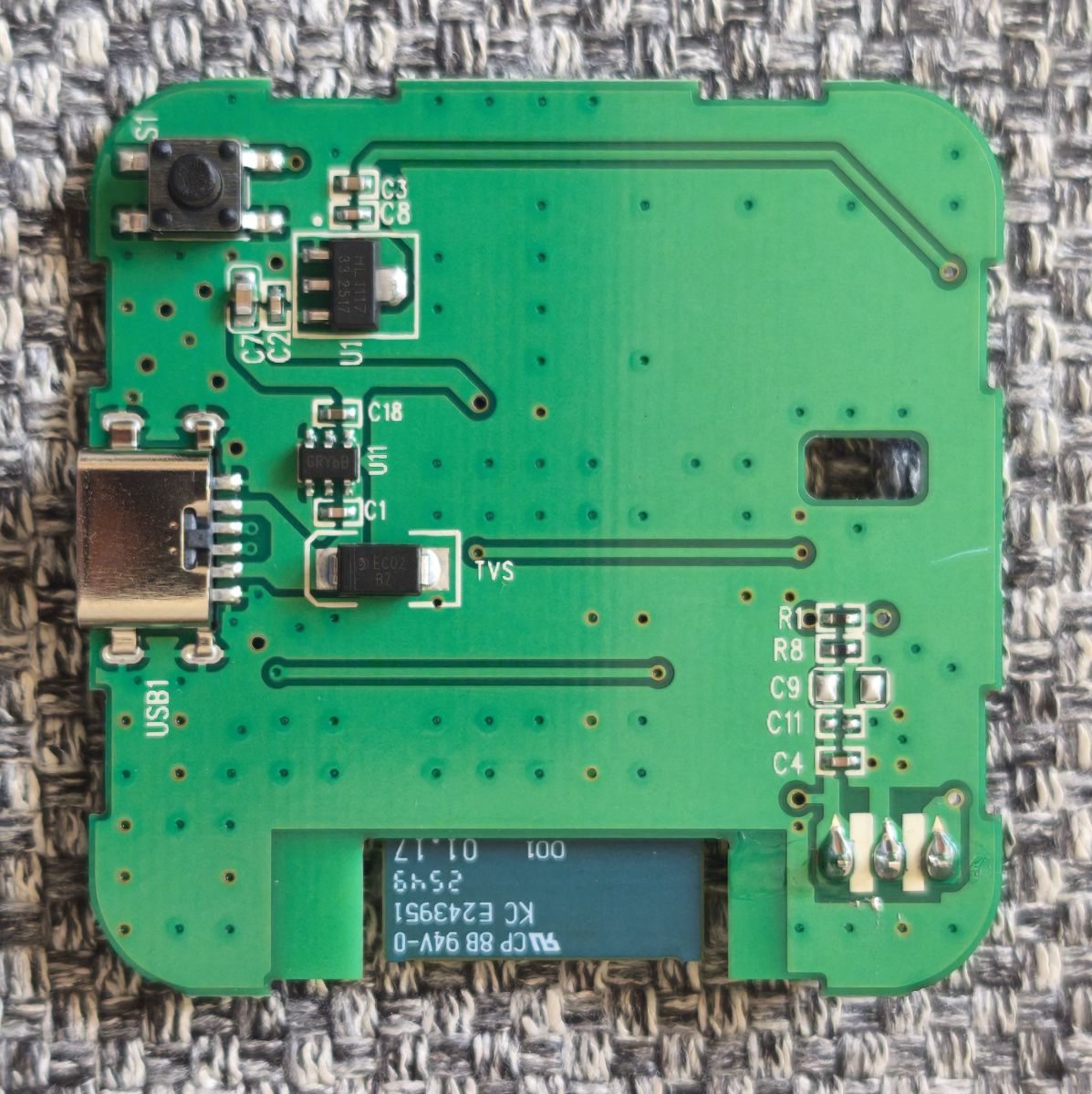

    Hi, Deeekos! Nice job! I think my device is the same, but not Pro version. It doesn't have temperature and humidity sensors. The MCU and pinout are the same.
    Green PCB with micro‑USB port, T1‑3S module, multiple LEDs, and an IR sensor on a woven fabric background
    Green PCB with USB‑C port, push button, SMD components, and a rectangular cutout.
