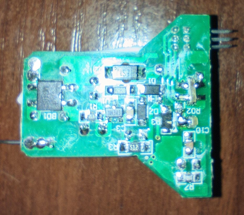

    Good afternoon. I have a led lamp with a bk7321 processor and a sht30 sensor on my hands. I don't need it as a lamp, but I need it as a temperature and humidity meter. What firmware do I need to upload to it? To implement this. Sorry for my english, I'm from Ukraine. Thank you
  • #2 20450395

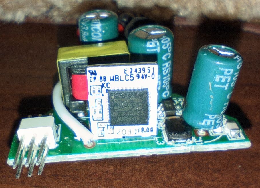

  • #3 20450513
    yuretskor
    Posts: 52
    I have such a module with a lamp. I did not take pictures of the module with LEDs. Thank you for reaching out to help. Tell me how to determine where to connect for the firmware,
    also the module needs to be soldered?

    You have WBLC5 module:
    [BK7231T/WBLC5] How to attach SHT30 sensor to smart Tuya LED?
    You don't have much choice when it comes to IO pins:
    Pin No.SymbolI/O typeFunction
    1ANTOExternal antenna pad pin
    2GNDPGround pin
    3PWM4I/OHardware PWM pin, which is connected to the P24 pin on the internal IC
    4PWM5I/OHardware PWM pin, which is connected to the P26 pin on the internal IC
    5PWM0I/OHardware PWM pin, which is connected to the P6 pin on the internal IC
    6VCCPPower supply pin (3.3 V)
    P6, P24, P26... you will need to use one of those pins.

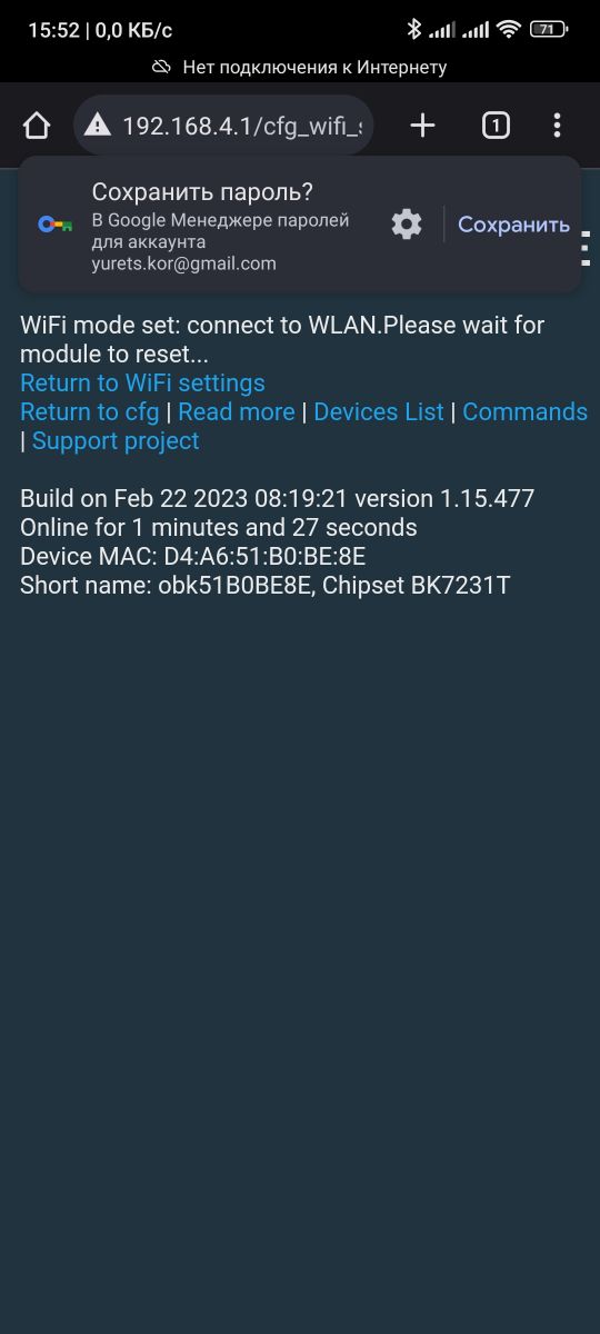

    Kind. I did everything according to the instructions. And I managed to flash it, I saw the access point, went into the settings, registered my point and password. Reloaded the module and now I can't find it. I did the firmware on a new one and now the access point does not appear. The first time was like that. After that, the whole module was lost. [BK7231T/WBLC5] How to attach SHT30 sensor to smart Tuya LED?

    After you configure your wifi endpoint the ip of your device changed. You need to check on your routeur which ip is assigned to your device (hostname will begin with opk.....)

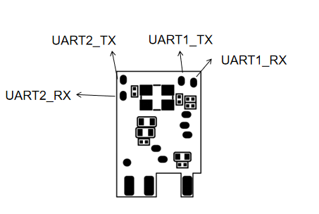

    Well, in that case, you might be able to reuse the TX1 and RX1 port as a software I2C port for SH30. Maybe... I haven't tried that. You'd have to try.

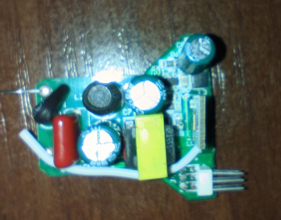

  • #11 20452963
    yuretskor
    Posts: 52

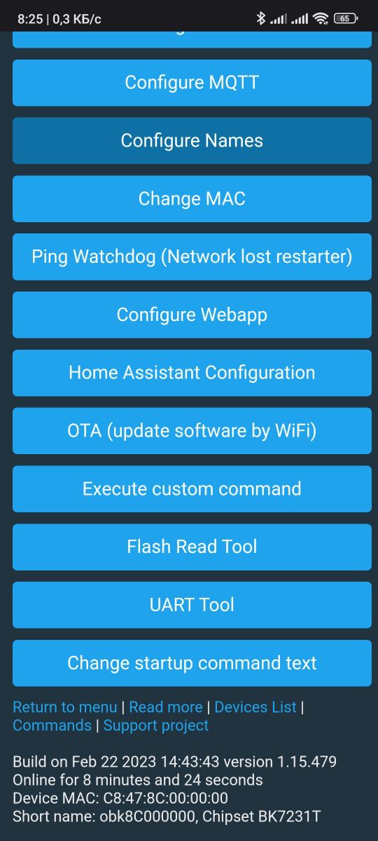

    Now I need to solder the module back. How to understand on which contacts the LED module works?
    Added after 2 [hours] 15 [minutes]:
    Achieved stable operation of the module. I connect the sht30 sensor to vdd-vdd, grn-grn, sda-sda(pin rx uart1), scl-scl (pin tx uart1) . I make pin settings via the web. No data. Is there anything else you need to do to get the job done?

    For input output I use pins Rx1, Tx1 for sht30. Well, I’ll deal with the ice module right away.

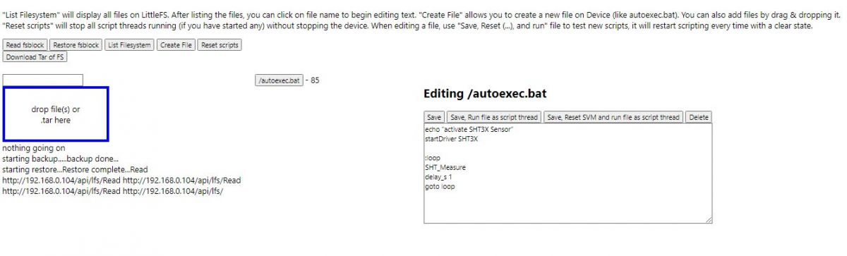

    You just need to write this script in white webapp/littlefs tab.
    You can access the white webapp from the main menu of the device. There's a button
    In this mode you can test command in panel "logs" and write script in "filesystem" tab
    Once you are satisfied with your script you can put it as start command.
  • #19 20453801
    yuretskor
    Posts: 52
    Will it work on Rx Tx?
    Added after 2 [hours] 43 [minutes]:
    With the help of the script, below came out to get the readings. Only it works while I send the command. How can I make measurements automatically every 1 second when power is applied?
    PowerSave
    echo "activate SHT3X Sensor"
    startDriver SHT3X
    :loop
    SHT_Measure
    delay_s 1
    goto loop
    Added after 22 [minutes]:
    This is how it is now displayed, while I press "save, run file as ... " then the data is updated, no further.

    Maybe just use addRepeatingEvent instead of trying to write loop? Your syntax of label seems incorrect, and furthermore autoexec is run in place and not executed as script, hmm.... but you can peek here:
    https://github.com/openshwprojects/OpenBK7231T_App/blob/main/src/selftest/selftest_script.c
    Repeating event is simpler...
    https://github.com/openshwprojects/OpenBK7231.../main/src/selftest/selftest_repeatingEvents.c

    Well, all you need to do is:
    PowerSave
    startDriver SHT3X
    addRepeatingEvent 10 -1 SHT_Measure
    And this should work, repeating measurement every 10 seconds, forever.

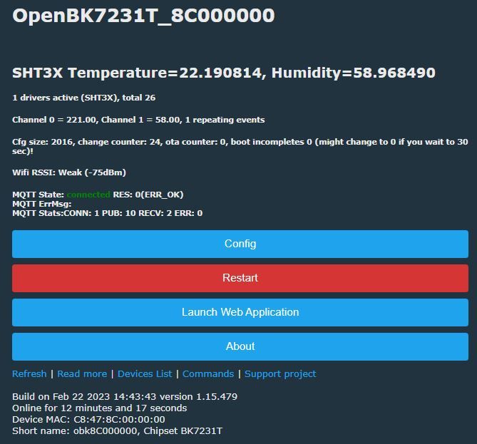

  • #23 20454228
    yuretskor
    Posts: 52

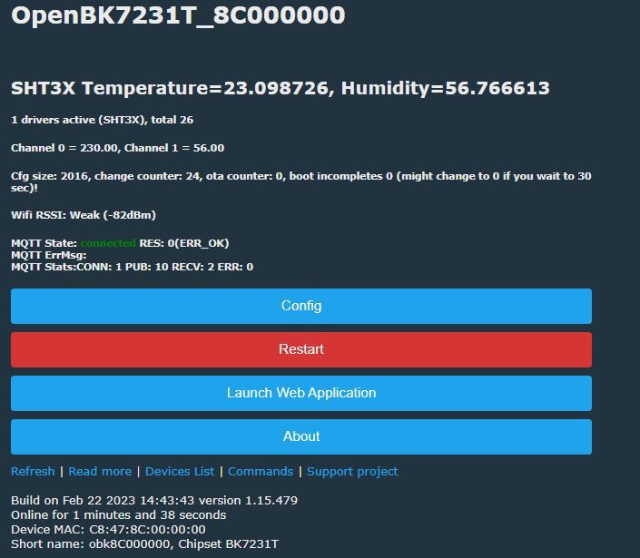

    Thanks It works. A little more and I will leave you behind, and you will forget me like a bad dream.
    Now how can I get this data via MQTT if I have the following settings and the part with Log
    Info:GEN:No change in channel 0 (still set to 222) - ignoring
    Info:GEN:No change in channel 1 (still set to 58) - ignoring
    Info:SENSOR:SHT3X_Measure: Temperature:22.289615C Humidity:58.985275%

    Posts: 14615
    Help: 655
    Rate: 12631
    Better stay with us on the forum, we are happy to help.
    So, maybe let's start with it - what is your status here, has the MQTT connection succeed?

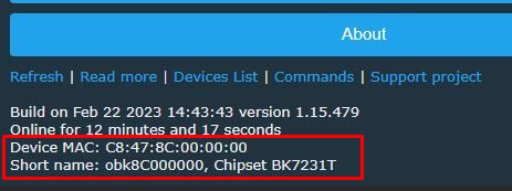

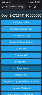

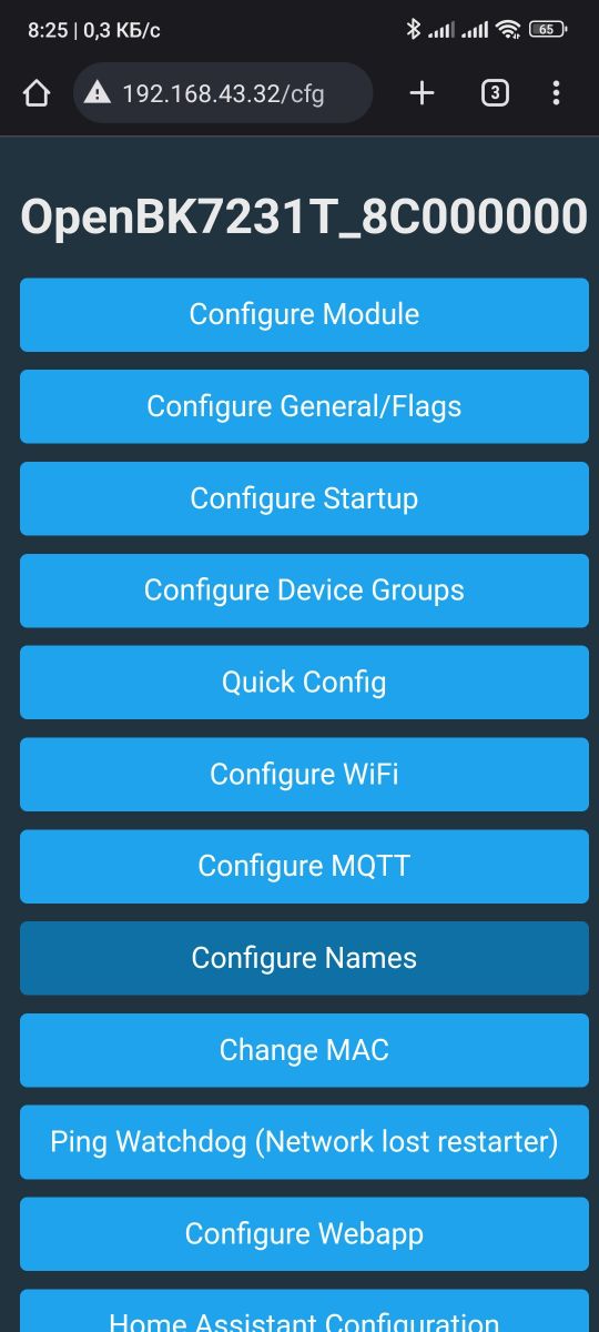

    Btw you have 00000s in MAC, you might want to fix it in Open Web Application -> Flash -> restore RF partition..
  • #25 20454243
    yuretskor
    Posts: 52
    >>20454237 @p.kaczmarek2 Yes, there is a connection. What does 00000 in a MAC address do?
  • #26 20454271
    Posts: 14615
    Help: 655
    Rate: 12631
    You might have accidentally erased your MAC, this is why here is 00:00:00:
    Not a problem, it's easy to fix as I said.

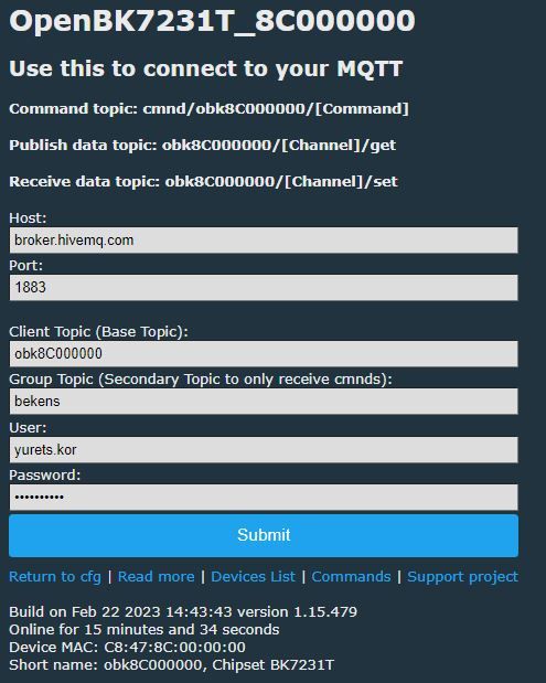

    Is your MQTT server a Home Assistant?
  • #27 20454302
    yuretskor
    Posts: 52

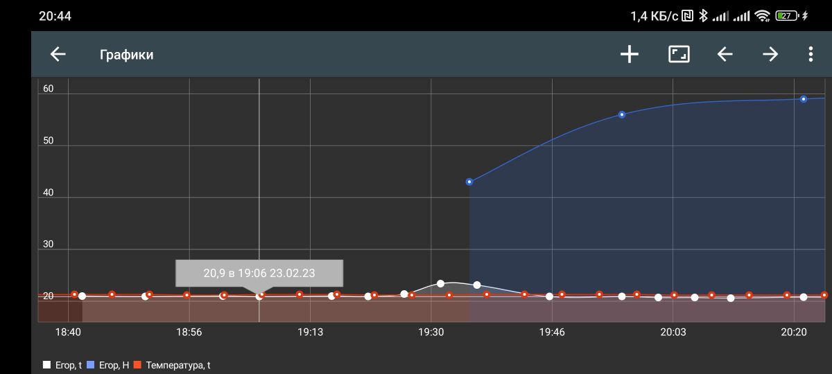

    No, this is not Home Assistant. I need to get data separately 22.2 is one topic 58.7 is another topic. Is it possible? I need a direct link to a topic like
    rule1ds1egor/tasmota_fd09d1/SENSOR
    Added after 1 [hours]:
    I understand the topic should be obc8C000000/channel1/get
    ? But there's nothing there

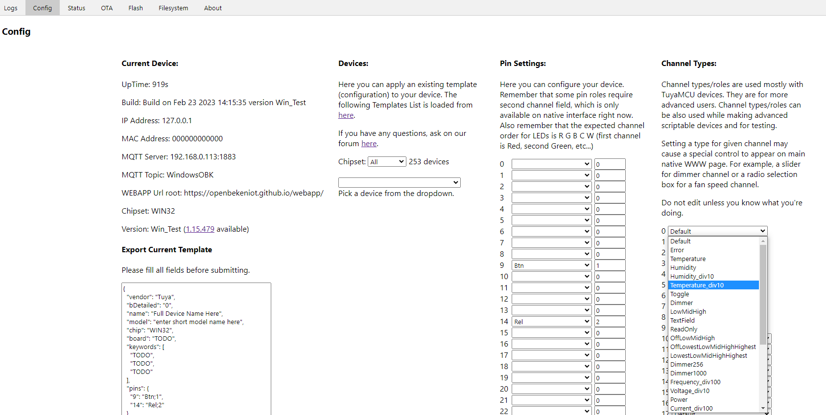

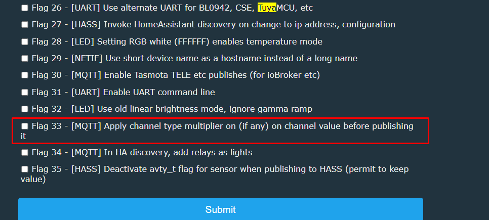

    @yuretskor enable that in flags:
    then, assuming you have latest version, in Launch Web Application set channel types; for temperature (channel 0) set Temperature_Div10, for humidity (1) set humidity:

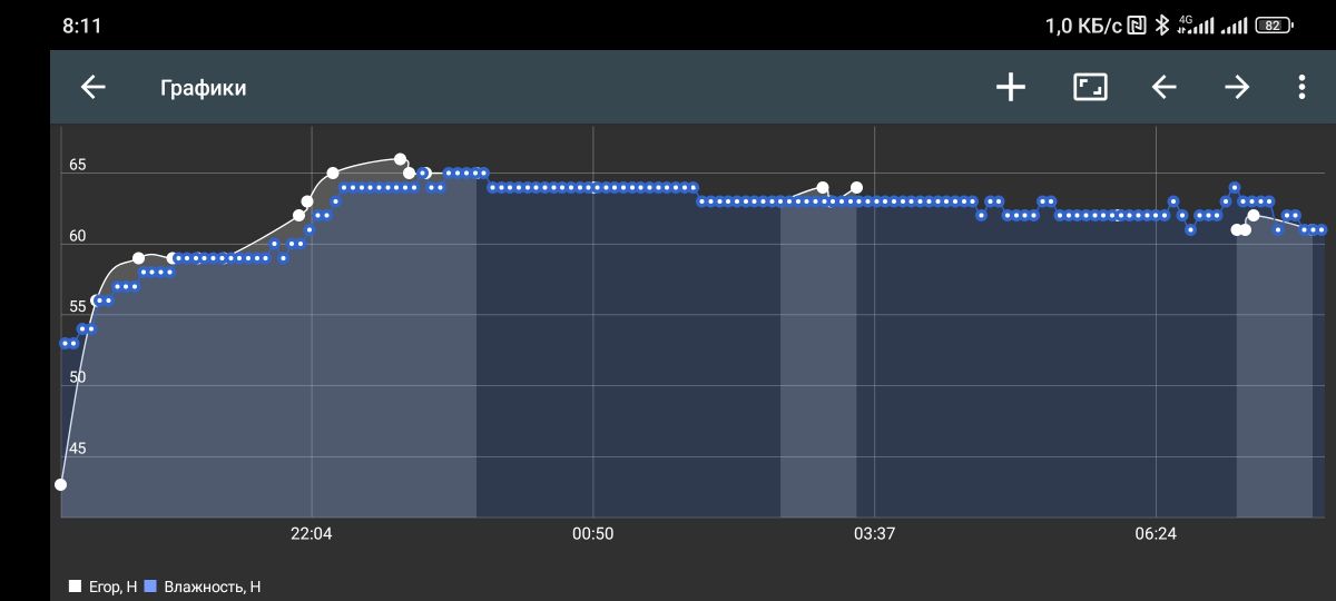

    yuretskor
    Posts: 52

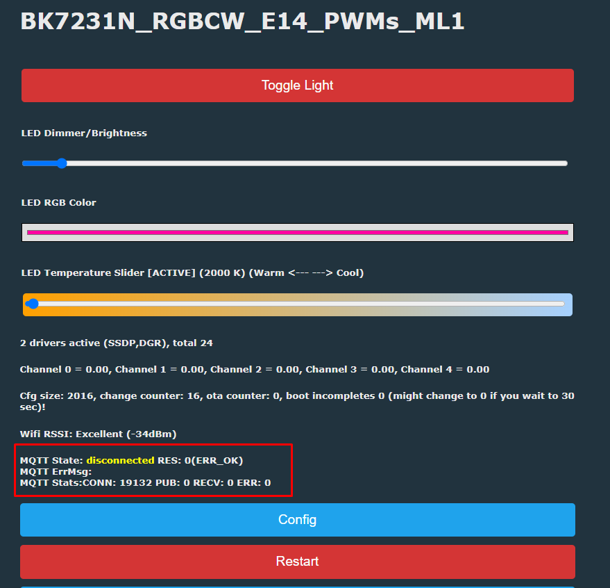

    @p.kaczmarek2 thanks, it worked. But there is a BIG BUT:
    1. data via mqtt can only be received until the module is rebooted, after rebooting it is necessary to enter the channel type again, for some reason they are not saved.
    2. if the data on the channels does not change and has one value, then mqtt displays an error, this is very visible in humidity, since there is rounding to an integer and it does not change so quickly, it is less in temperature, there is rounding to hundredths of 0.1 and there are fewer errors, although they also exist.

    A quick solution to the problem is to make the same bit depth for humidity as for temperature. How to do?
    Or maybe there is a flag for such purposes?
    I am close to solving my problems
    Added after 9 [minutes]:
    in Log writes
    How to remove this function that always published the value?
    Added after 43 [minutes]:
    I need the data every 5 minutes to send to the server. Below is a screen on which the red line sends data without gaps (temperature from another module), the white temperature with bk7231t sht30 sometimes has a gap every 10 minutes, and the blue line is humidity, it can be seen that the data came very few times due to the fact that humidity changes much less frequently than temperature and rounding to the nearest whole number. The temperature rounds up to 0.001 everything is fine. Also, after all, the type of flags was preserved, perhaps there was some kind of glitch. Like this (
    Added after 11 [hours] 25 [minutes]:
    The guys are really bad with the data. There is a module on esp8266 with Tasmota firmware that works on the same server, only sends data to the mqtt topic according to the rule. And there is no problem with passes.

• BK7231T UART1 pins = 3.3 V, GND, P24 (RX1), P26 (TX1) [Elektroda, p.kaczmarek2, post #20450565] • SHT30 supply: 2.4–5.5 V, 150 µA active, 0.5 µA sleep [Sensirion DS, 2022] • OpenBeken build ≥ 1.15.507 fixes I²C LED/SHT conflict [Elektroda, p.kaczmarek2, post #20459538] • SM2135 LED driver current default 10 mA per channel [Elektroda, p.kaczmarek2, post #20457907] • MQTT broadcast period set by mqtt_broadcastInterval SECONDS (range 1–86400) [OpenBeken Docs]

  1. Solder 3.3 V, GND, RX1 (P24) and TX1 (P26) to a USB-UART adapter.
  2. Start “Backup firmware (read)” in BK7231 GUI Flash Tool.
  3. Power-cycle the module to enter bootloader, finish read, then write OpenBeken [Elektroda, p.kaczmarek2, post #20450565]

Start the driver and schedule measurements:
startDriver SHT3X
Save these lines in autoexec.bat or the LittleFS editor, then reboot [Elektroda, p.kaczmarek2, post #20454182]
How do I make OpenBeken publish MQTT data every 60 s even when values don’t change?
Set persistent interval broadcasting:
mqtt_broadcastInterval 60
mqtt_broadcastItemsPerSec 2
This forces a publish every 60 s per channel whether or not the reading changed [Elektroda, p.kaczmarek2, post #20455491]

Edge-case: MQTT stops when temperature and humidity stay constant—why?
OpenBeken suppresses MQTT messages if No change in channel to save bandwidth [Elektroda, yuretskor, post #20454637] Override by lowering mqtt_broadcastInterval or forcing repeating events to push unchanged data.
