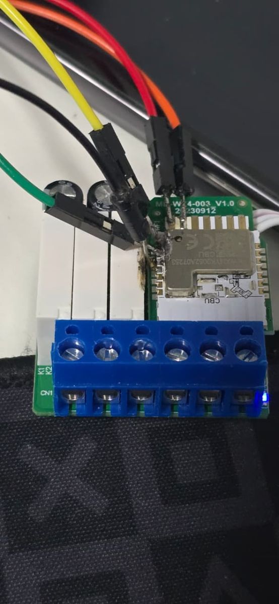

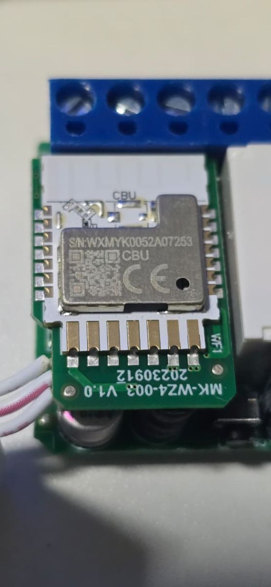

    New device flashed (BK7231N)
    Novadigital 3 way smart switch
    CONNECT ALL UART
    3.3, GND, TX , RX
    short cut fast CEN to GND
    photos
    CBU module labeled MK-WZ4-003 V1.0 with pin header and CE markNovadigital MS-106 module with UART wires connected to board pinsNovadigital MINI Wi-Fi 3-Channel module with visible connectors and wires
    link

    TEXT
    - Relay (channel 3) on P9
    - Pair/Toggle All Button on P8
    - WiFi LED on P6
    - TglChannelToggle (channel 1) on P14
    - TglChannelToggle (channel 2) on P16
    - TglChannelToggle (channel 3) on P23
    - Relay (channel 2) on P17
    - Relay (channel 1) on P20
    Device seems to be using CBU module, which is using BK7231N.

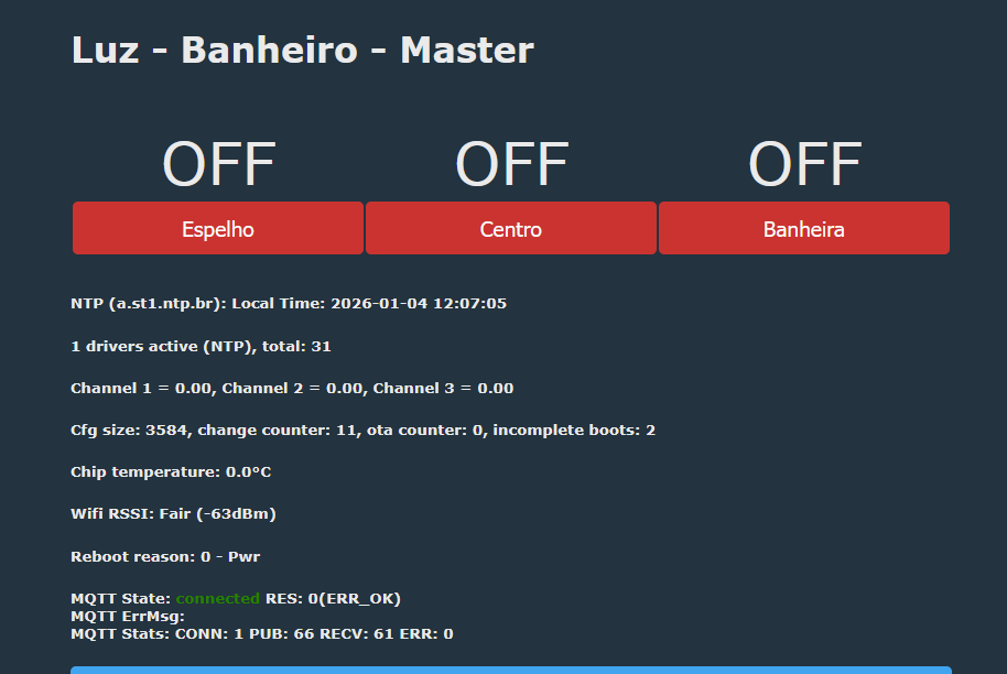

    CONFIG
    startDriver ntp
    ntp_setServer a.st1.ntp.br
    ntp_timeZoneOfs -3:00
    setChannelType 1 toggle
    setChannelLabel 1 "Channel Name"
    setChannelType 2 toggle
    setChannelLabel 2 "Channel Name"
    setChannelType 3 toggle
    setChannelLabel 3 "Channel Name"

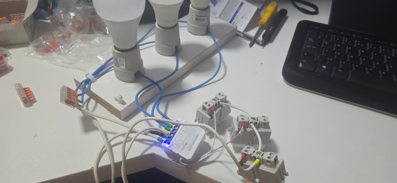

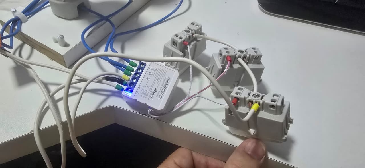

    Hey buddy @divadiow and @p.kaczmarek2, if it's possible I need your help, guys. On the web, everything works flawlessly, but when I create my test environment, the switch is not working. There's something I'm missing in the config?
    Bathroom light control panel with three OFF buttons
    Wiring diagram of Wi-Fi module connected to triple switch and three light bulbs
    • Novadigital 3-Way Smart Switch BK7231N (CBU) Pinout and Tuya Configuration Details bbbbb.jpeg (49.95 KB) You must be logged in to download this attachment.
    • Novadigital 3-Way Smart Switch BK7231N (CBU) Pinout and Tuya Configuration Details aaaaaa.jpeg (55.46 KB) You must be logged in to download this attachment.
  • #3 21798792
    tadeu1
    Posts: 83
    I mean the physical switch
  • #4 21799114
    Posts: 14745
    Rate: 12840
    You mean the device can't see S1, S2 and S3 being toggled?
  • #5 21799118
    tadeu1
    Posts: 83
    Yeah, when I change the physical switch, nothing happens.
  • #6 21799121
    Posts: 14745
    Rate: 12840
    Ok, so what happens if you go to Web App, to GPIO Doctor, set one of switch pins to Digital Input (pull up or not) and toggle switch? Is GPIO doctor able to read the state of the pin?
  • #7 21799129
    tadeu1
    Posts: 83
    Just digital pin? Try one by one and see the log? I'll try it tomorrow night.
  • #8 21799257
    Posts: 14745
    Rate: 12840
    Digital input, either with pull up or without it. Try both. And just check if the firmware can even see state 1 (switch open I guess?) and state 0 (switch closed?) If no change is seen, then try version with pull down...
    Maybe it's a pull up or pull down issue. We only have TglChanOnTgl, which is using input pullup.

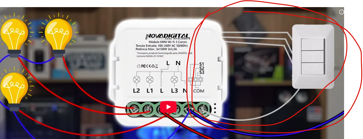

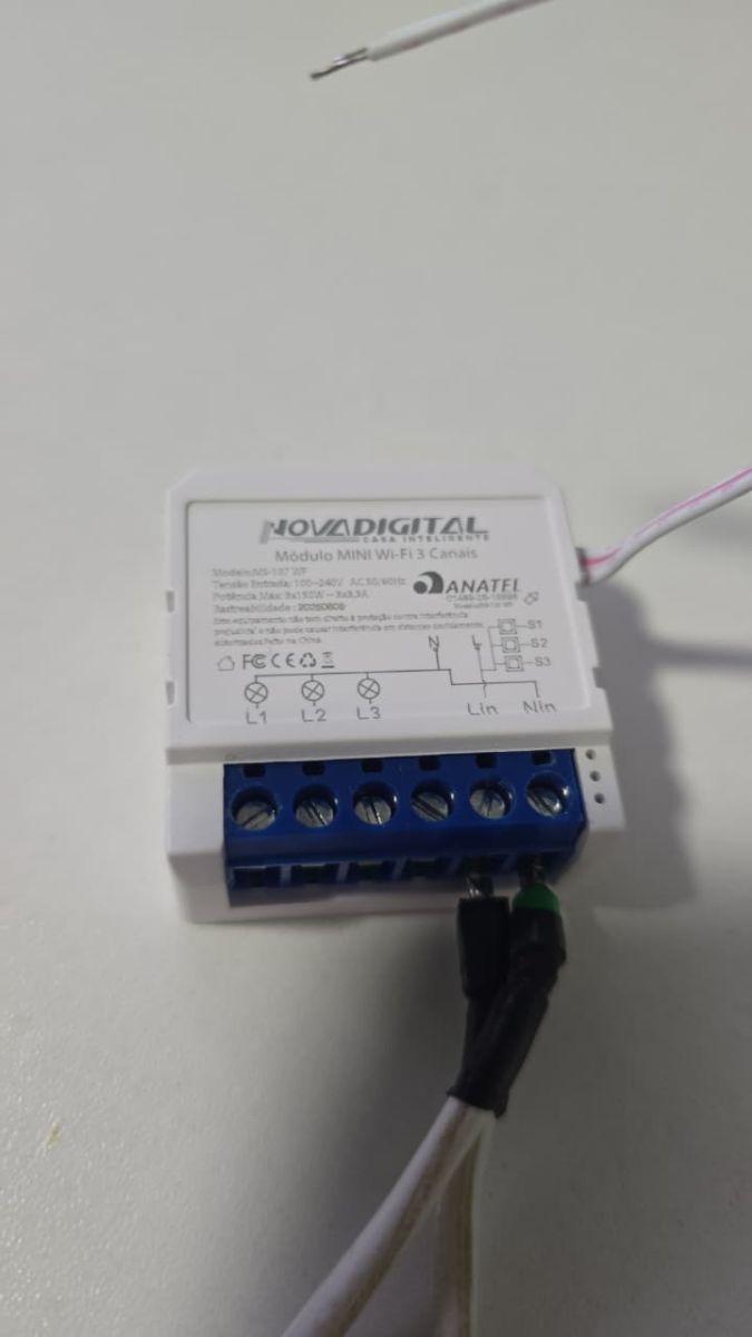

  • #9 21799353
    tadeu1
    Posts: 83
    Sorry, my mistake, there's no COM at the version MS-107, just MS-106. I have to connect it to a phase
  • #10 21800090
    Posts: 14745
    Rate: 12840
    Ahh, so it's working? Let us know once you check..
  • #11 21800101
    tadeu1
    Posts: 83
    Yha it's working.
