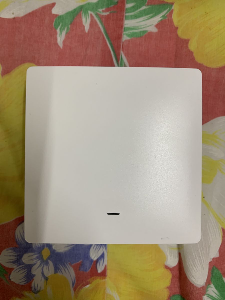

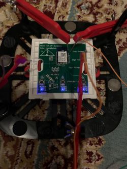

    Teardown Photos:
    [BK7231N - CB3S] Generic Tuya Wall Switch Push Button Type 1-3 Gang No Neutral [BK7231N - CB3S] Generic Tuya Wall Switch Push Button Type 1-3 Gang No Neutral
    [BK7231N - CB3S] Generic Tuya Wall Switch Push Button Type 1-3 Gang No Neutral [BK7231N - CB3S] Generic Tuya Wall Switch Push Button Type 1-3 Gang No Neutral [BK7231N - CB3S] Generic Tuya Wall Switch Push Button Type 1-3 Gang No Neutral [BK7231N - CB3S] Generic Tuya Wall Switch Push Button Type 1-3 Gang No Neutral [BK7231N - CB3S] Generic Tuya Wall Switch Push Button Type 1-3 Gang No Neutral [BK7231N - CB3S] Generic Tuya Wall Switch Push Button Type 1-3 Gang No Neutral

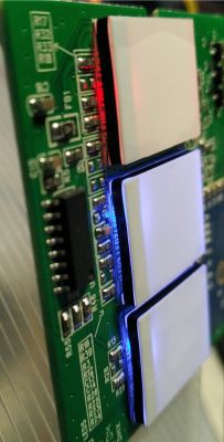

    It looks like there are 3 x LEDs for each touch switch.
    It would be great if anybody knows whether these can be controlled via the microcontoller, probably not.

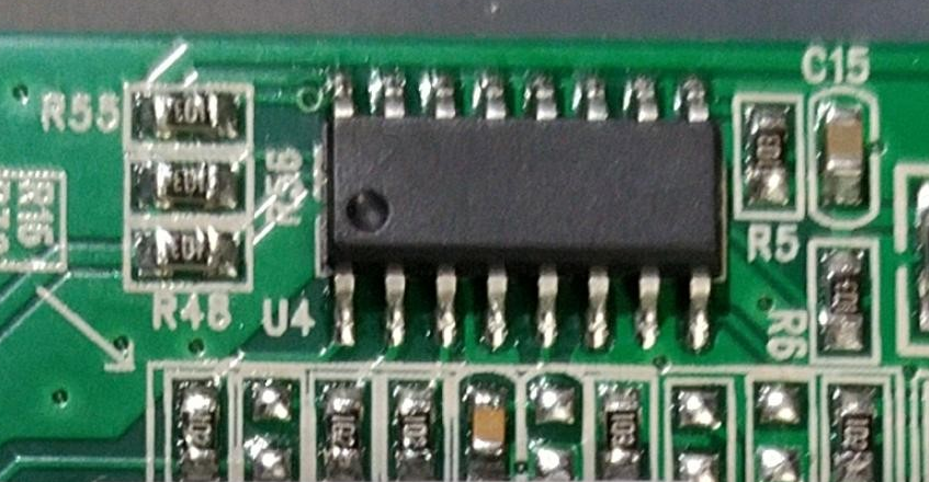

    Regarding LEDs... well, in case of such 3gang switches, the LEDs are usually connected to relay signals.
    I have just flashed this TYWE3S switch:
    and in case of that switch, LEDs are connected to relay signals.
    EDIT: but obviously you can cut the track from relay signal to the LED (but keep resistor!) and connect that LED to IO pin of WB3S and use it in OpenBeken anyhow you want. It's easy, that way you could free all 3 diodes.

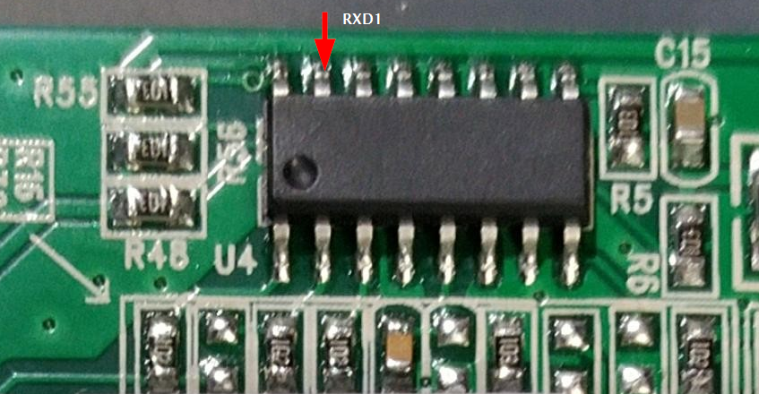

    RXD1 is connected as follows:
  • #11 20322500
    Posts: 14754
    Rate: 12875
    Directly connected?
    Is there any place where you can cut the trace easily? If not... well... you will have to desolder the chip. First try on some scrap boards. It's easy. Just like I did on the video. Just remember to use flux, pb solder and keep soldering iron tip clean...
    Is there a pinout for this Ic?

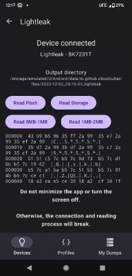

  • Need matching Tuya firmware version for OTA flash
    #20 20334772
    jkwim
    Posts: 186
    Rate: 25
    ferbulous wrote:
    @jkwim can you get the tuya firmware version for your device?
    you could still flash it ota with tuya-cloudcutter by selecting the profile that has the same firmware version as your device
    Thanks for bringing up this point.
    I am interested in knowing more as well.
    So in a nutshell I should not be worrying about device model as far as I match the firmware version and the chip?
    I will try to connect to Tuya and get it.
    Added after 2 [hours] 37 [minutes]:
    My switch firmware versions are:

  • Cutting the live track to isolate low-voltage outputs
    #29 20377813
    jo_sef
    Hi guys I bought 3 gang switch and I would like to ask you for an advice. The thing is that the live wire is connected on L1, L2, L3 contacts once it switches on but I need to disconnect live wire from all three contacts, because my gate motor uses low voltage only. If I cut the track as showing below, does it do the job for me?
    Thank you.
    Josef
  • Need full device photo to identify relay cut point
    #30 20378180
    Posts: 14754
    Rate: 12875
    Hello @jo_sef , it is certainly possible to detach those relays from live wire (then basically there is a separation between relay contacts and coil), but from the photo I am unable to determine if you located the correct place. It even feels like it's not the correct place to cut. I'm afraid that cutting there would cut off the power supply of the device. I would need to see the whole device, where are relays, etc.
    Futhermore, I am confused - what are those two MOSFETs doing there? Those KND3403A...
The discussion centers on the Generic Tuya Wall Switch Push Button Type 1-3 Gang No Neutral featuring the BK7231N (CB3S) module, model LSPS5. Users share teardown photos, flashing methods using serial tools like hid_download, and challenges with configuration and firmware versions. Various models such as DS-101, DS-101JL, DS-103, DS-1211SL, and related devices with BK7231N (CB3S) and WB3S (BK7231T) chips are compared. Flashing approaches include serial flashing with USB-TTL adapters, OTA flashing using tuya-cloudcutter, and alternative firmware like Tasmota and OpenBeken. Discussions highlight the importance of correct firmware profiles matching chip versions and firmware versions (e.g., 1.0.7), and the need to cut PCB traces or desolder chips to enable flashing. LED control wiring varies by model; some have LEDs tied directly to relays, while others allow independent LED control. Users explore GPIO repurposing, scripting for button events, and advanced features like multi-click and LED animations. Challenges include hardware modifications (e.g., removing 0 Ohm resistors), flashing failures due to pin conflicts, and identifying pinouts for unmarked ICs. The community provides resources such as OpenBK7231T firmware, BK7231 GUI flasher, and cloudcutter profiles. Additional topics include modifying relay wiring for low-voltage loads, using SSRs for silent switching, and the feasibility of WiFi switches without zero-cross detection using relays instead of triacs. Overall, the thread offers detailed technical insights into hardware teardown, firmware flashing, configuration, and customization of no-neutral Tuya wall switches with BK7231N-based modules.
