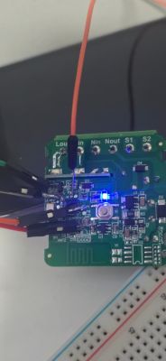

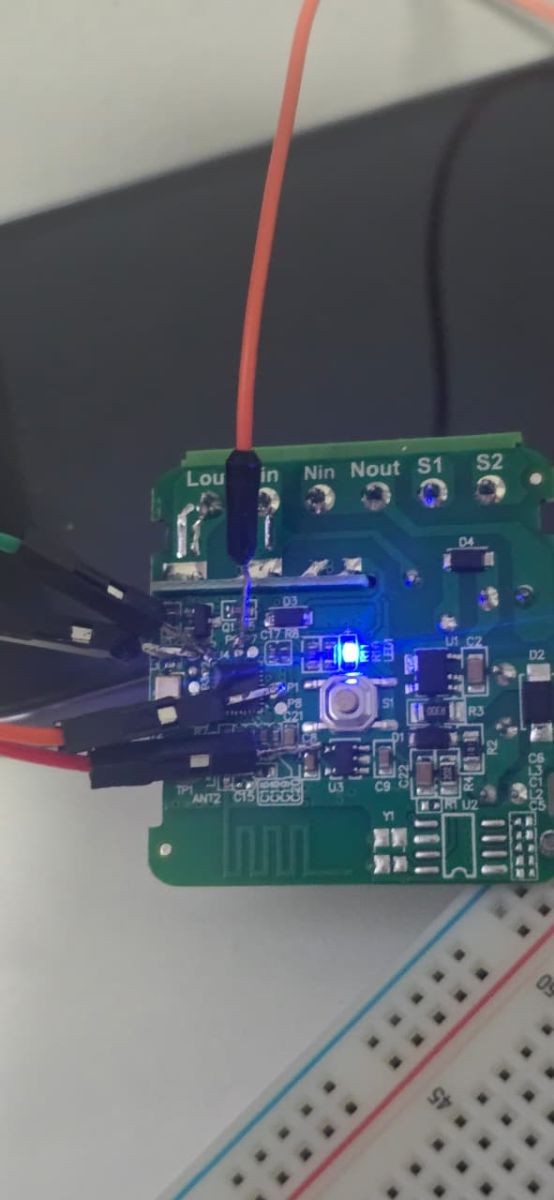

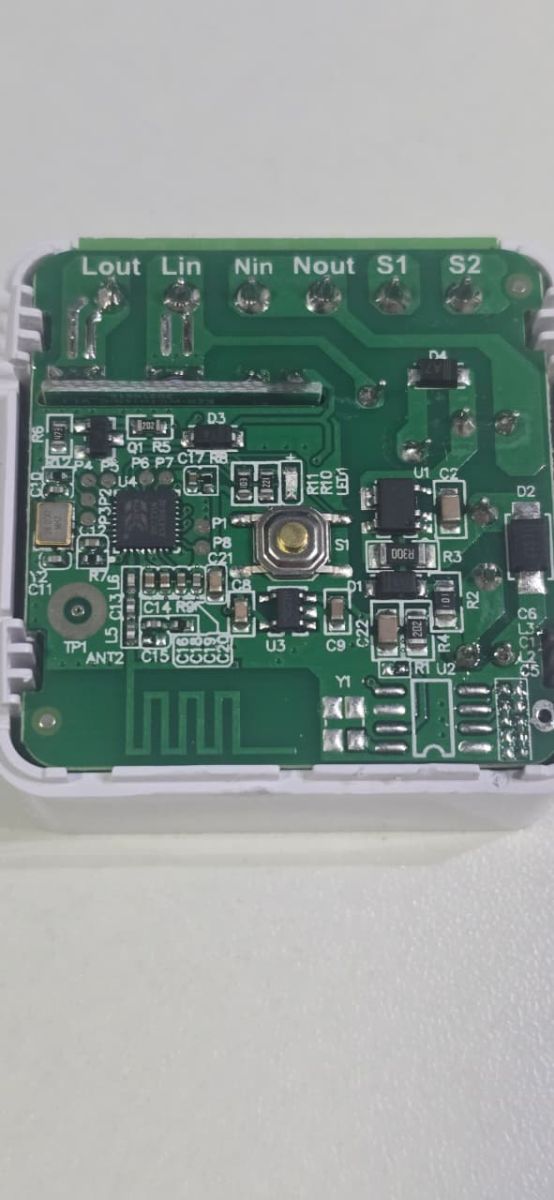

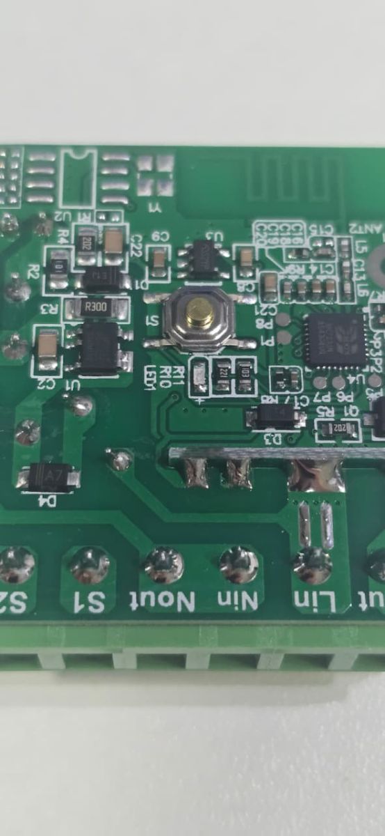

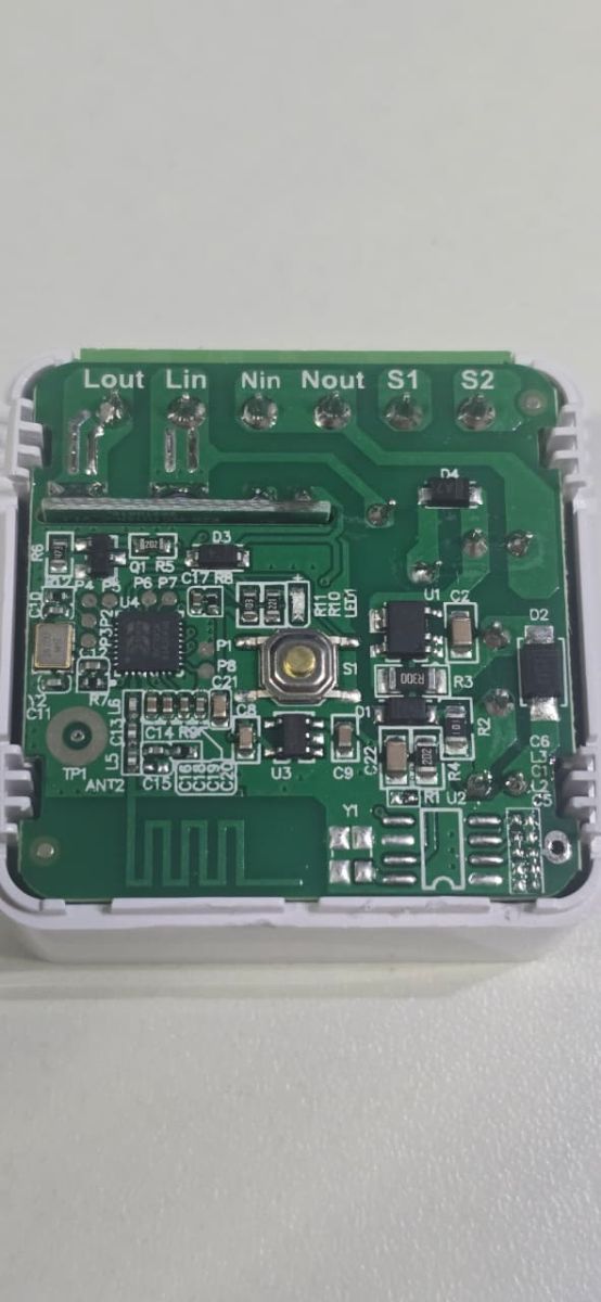

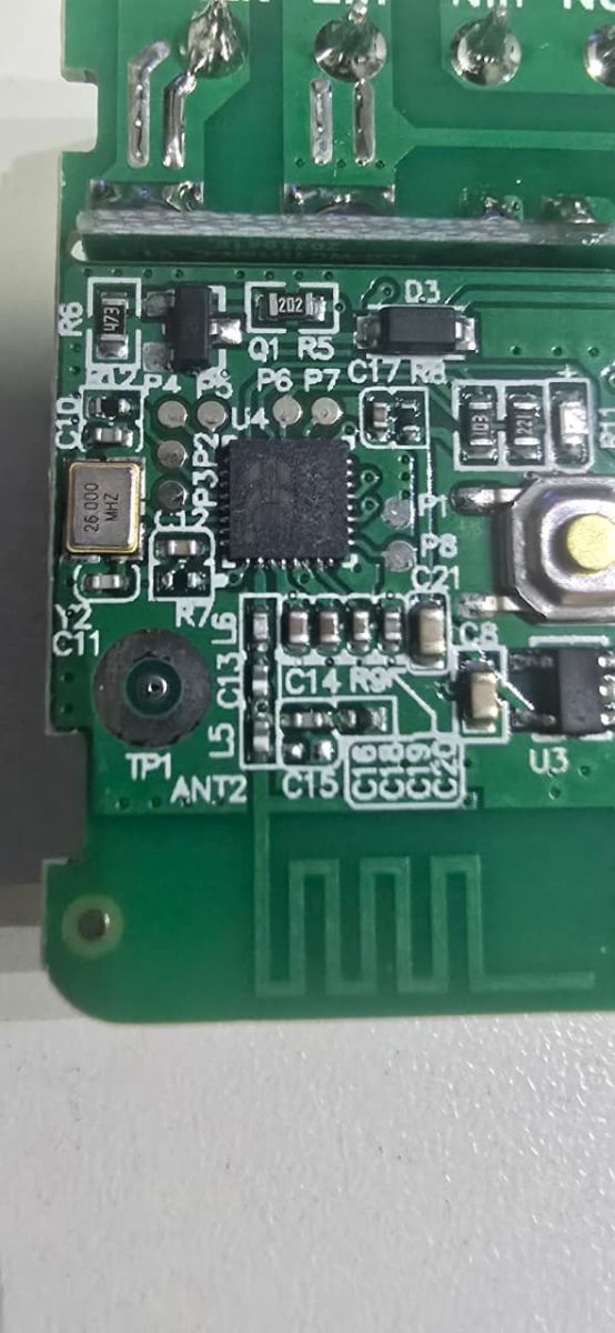

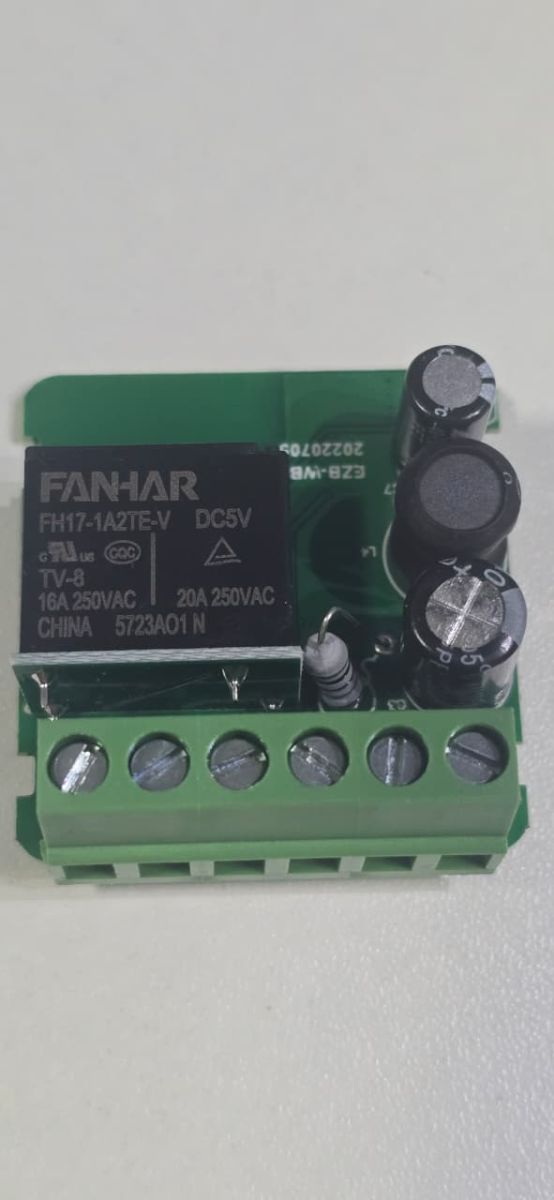

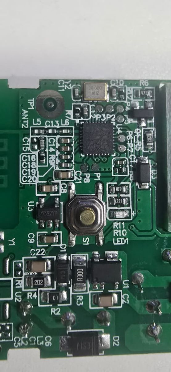

    Theres no module, they develop the pcb with the BK7231N, its hard to find the pinout, but i found it.

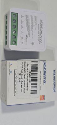

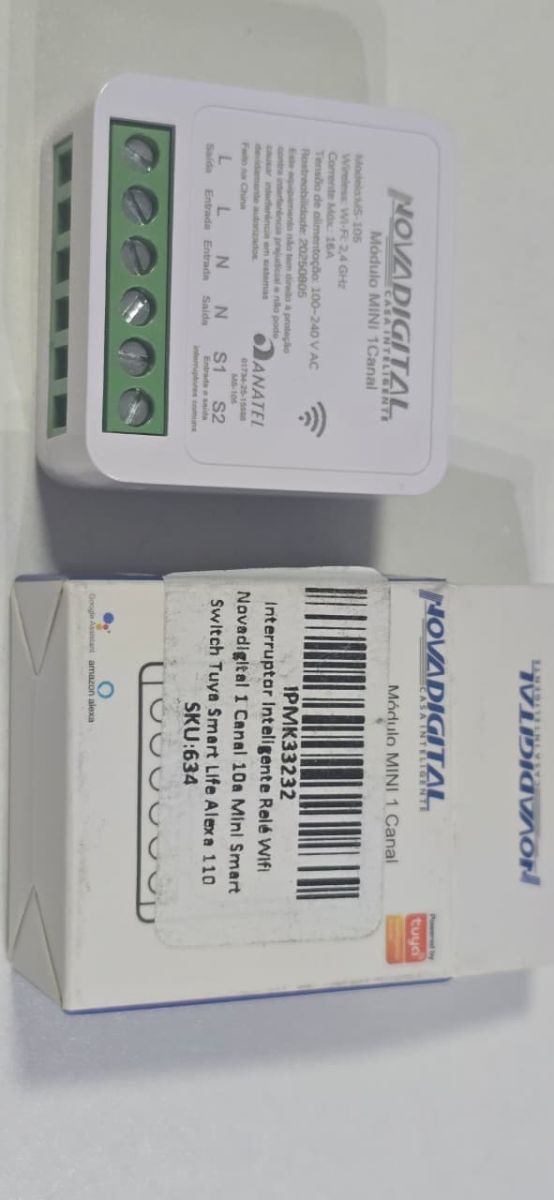

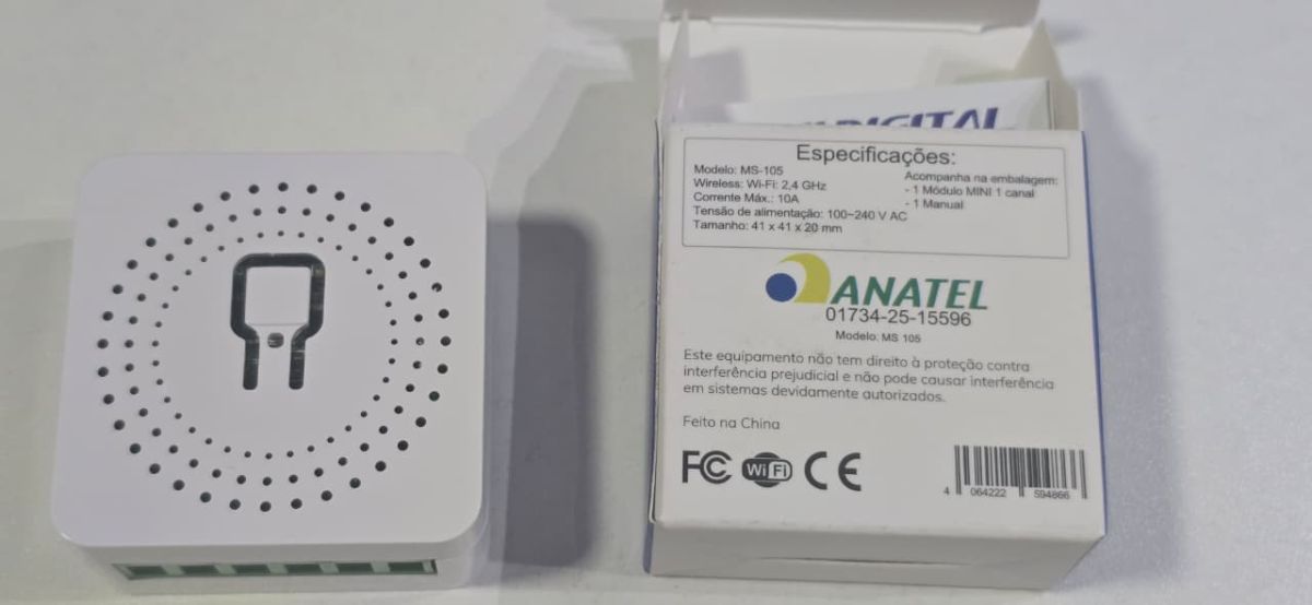

    Novadigital 1 way smart switch
    attached the original fw
    CONNECT ALL UART
    3.3, GND, TX , RX
    short cut fast CEN to GND
    PINOUT
    P6 = CEN
    P5 = RX
    P4 = TX
    P1 = GND
    C8 = 3.3

    TEXT
    - Pair/Toggle All Button on P8
    - WiFi LED on P6
    - RF Remote on P23
    - TglChannelToggle (channel 1) on P14
    - Relay (channel 1) on P15
    Device seems to be using CBU module, which is using BK7231N.

    Thanks for sharing, remember to use OpenBeken/s PowerSave 1 feature, otherwise soon you'll have to replace the capacitor:
    https://www.elektroda.com/rtvforum/topic3898805.html
    OpenBeken's PowerSave 1 system can really prolong your IoT device life.
    Btw, you're lucky that you didn't get T34-based version. It's much harder to flash it than this one.
