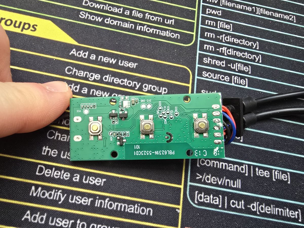

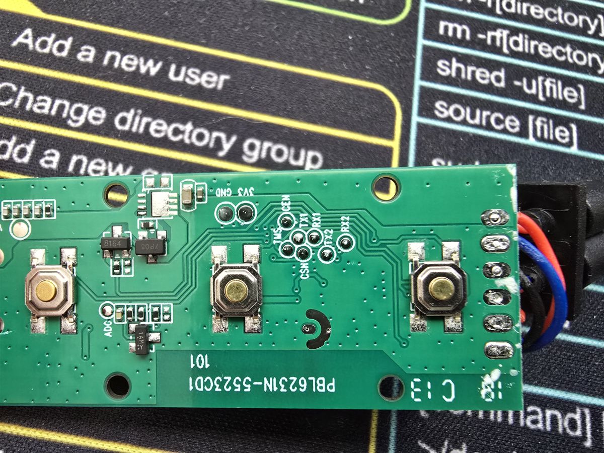

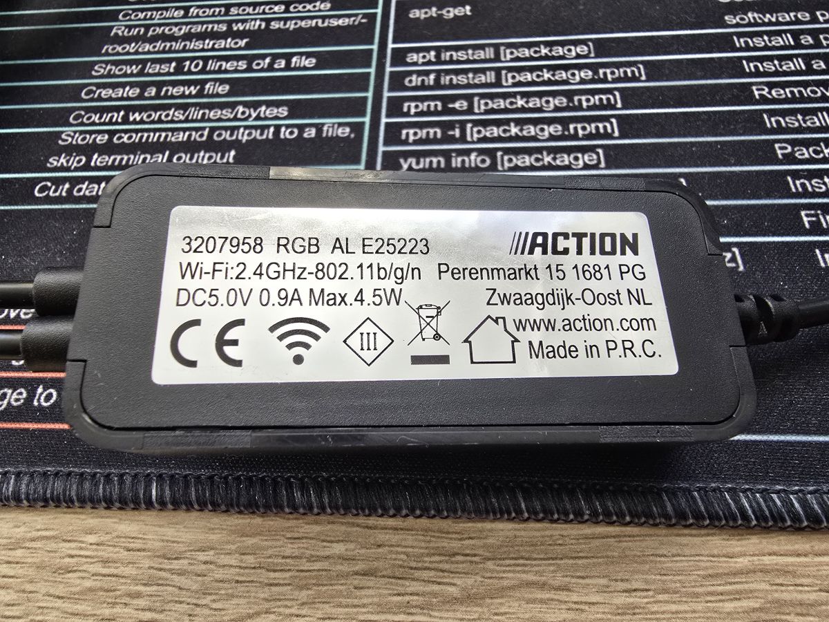

    I purchased the Multicolour LED Light Bar with BK7231N inside today from Action.
    RGB LED controller with technical label and Action branding on casing. PCB with buttons, UART labels, and wires on the right side PCB with BK7231N label, three push buttons, and wires connected on the right LED controller PCB with BK7231N chip and labeled solder pads for UART and power.
    Seemed like a simple topic, all pads beautifully described, but when uploading the UART with Flasher I get this message:
    Using hack to write QIO - just skip bootloader....
    ... so bootloader will not be overwritten!
    The whole thing ends with the message Write success! but the chip doesn't boot, no default WIFI network is visible, when I push the WIFI config to it from the flasher it doesn't connect either

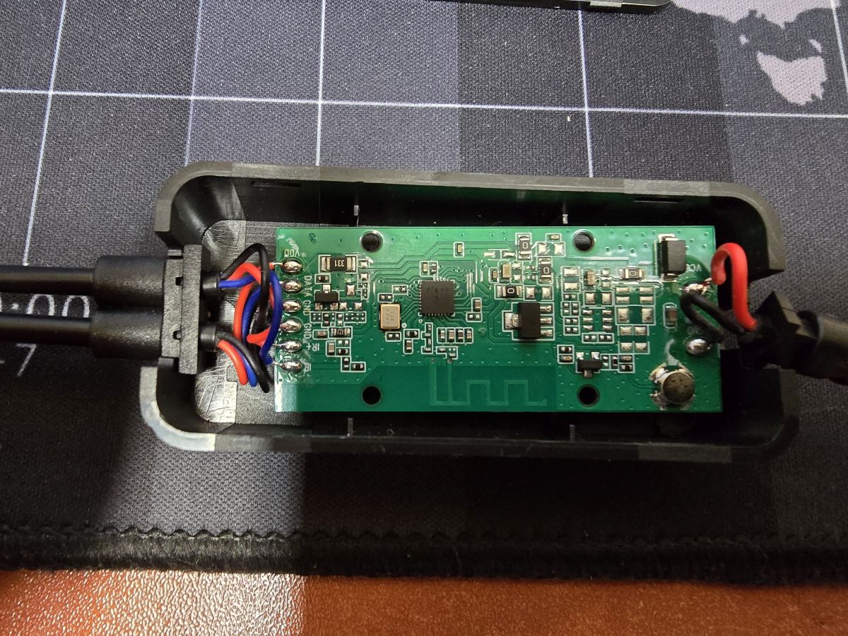

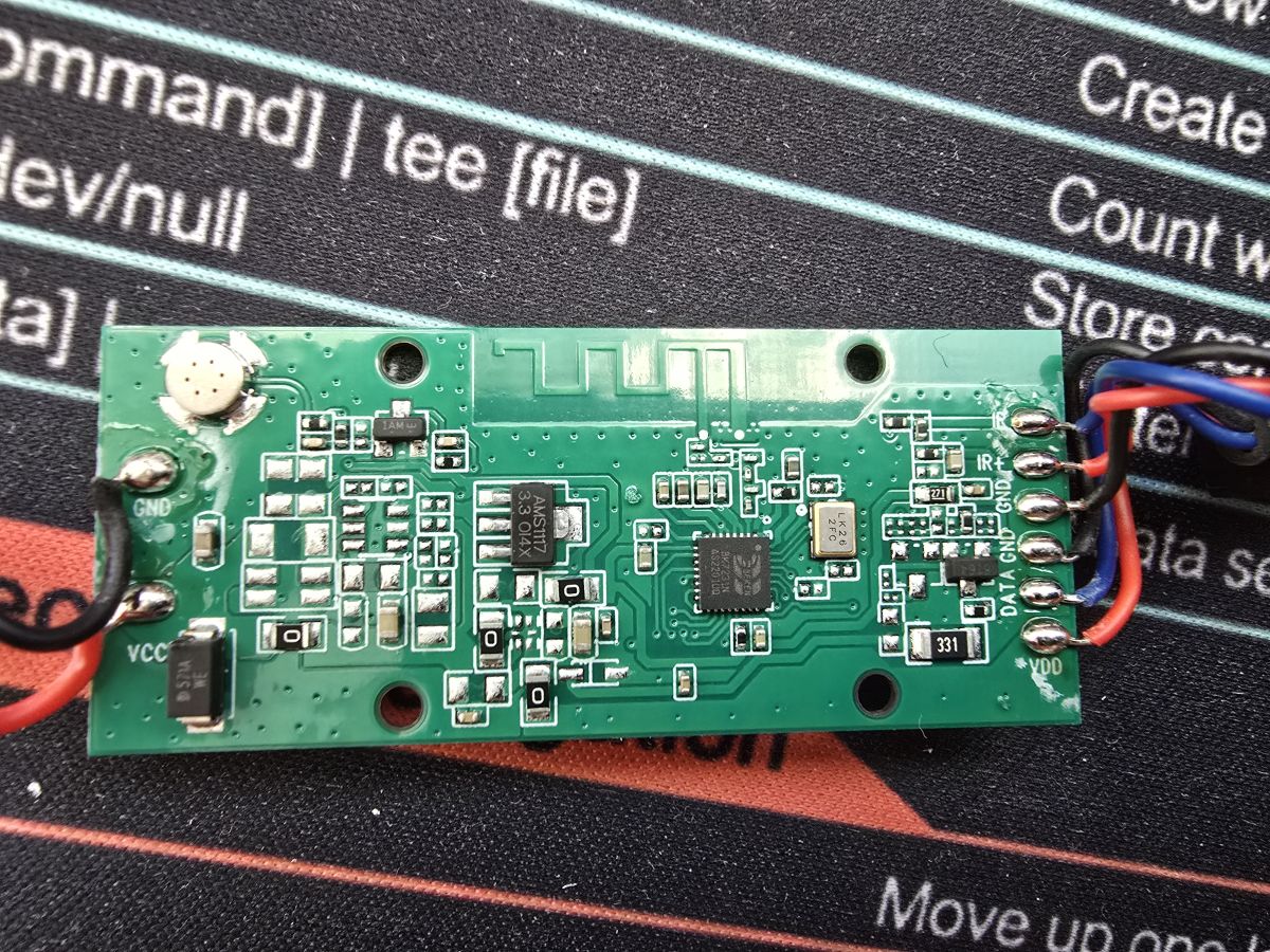

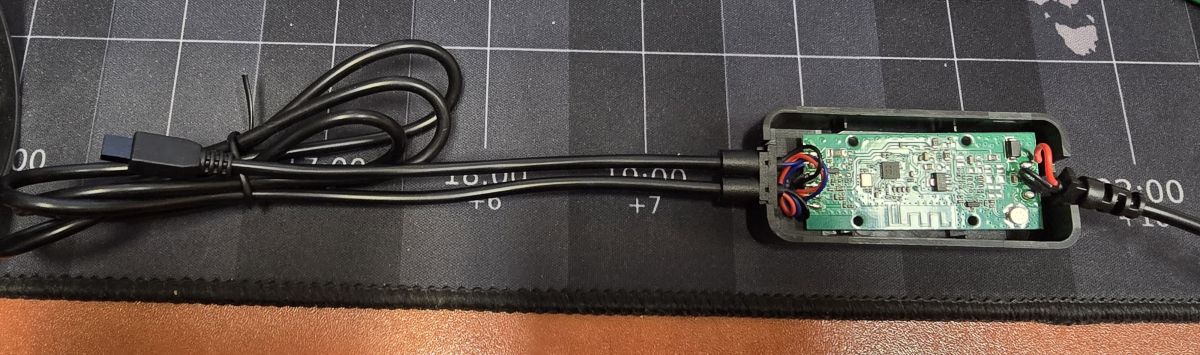

    Show a photo of the board where the IR sensor is and/or test with a multimeter (with the device switched off) whether it is physically connected to the Beken pin, or perhaps via some transistor?
    Alternatively, also check from Github the IRRemoteESP variant, this is the other library for IR, another implementation of the
  • #12 21806527
    Mad_Maxs
    Posts: 81
    >>21806444
    Opened enclosure with visible green PCB and connected wires PCB with electronic components and colored wires inside a black plastic housing
    The IR diode is at the end of this short cable, at the bottom is the blue IR, which goes via a capacitor to the 23rd pin of the chip, and with a second capacitor to the 17th
