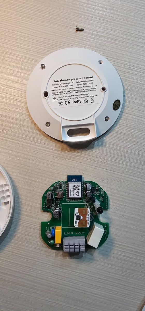

Can this WBR3-based human presence sensor be flashed in-circuit without desoldering the module?
Probably not; people who tried concluded you need to solder onto the board pads rather than rely on a no-desolder RX/TX hookup. One reply says the BK7231GUIFlashTool now supports WBR3, but still expects access to the bottom pads, and that RX/TX alone will not suffice [#21787984] Another reply says flashing without desoldering might only be possible via cloudcutter, but the device appears patched against that exploit, so it is not a dependable route [#21787988][#21789209] A user who worked on this sensor and the flush-mounted version says it was necessary to solder, and that in the flush-mounted variant they even replaced the WBR3 with a CB3S because WBR3 flashing was not possible at the time [#21792038] They also note the WBR3 only communicates with the MCU over TX and RX, and that there are four solder points on the back including RX/TX if a pad gets damaged [#21792443]

    Photos:
    Disassembled presence sensor with exposed circuit board and casing parts.
    What do you think? Is it flashable without desoldering?

    I asked for flashing without desolder

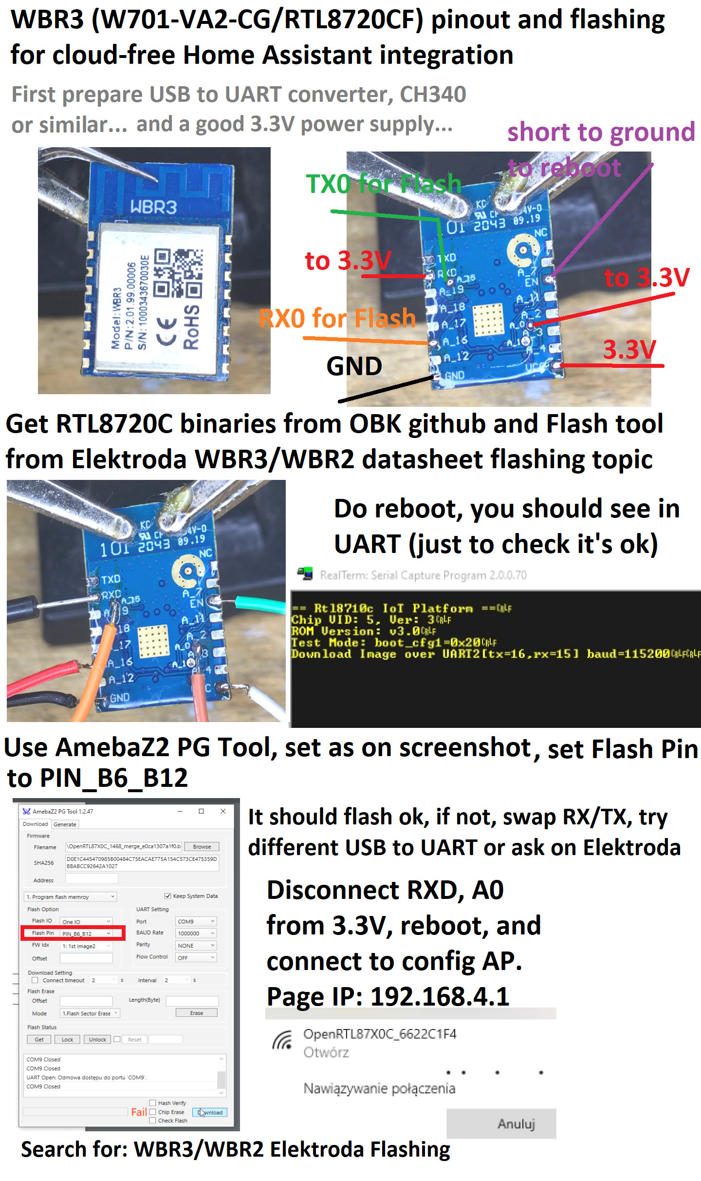

  • #6 21787984
    Posts: 14795
    Rate: 12945
    Our flasher supports now WBR3:
    But I still think you need to access the pads on the bottom of the board, RX TX will not suffice. It's not Beken!

  • #11 21792038
    tomik67
    Posts: 111
    Rate: 11
    I have gone through the subject with this presence sensor, and before that with the flush-mounted version.
    Unfortunately it is necessary to solder, in the flush-mounted version I replaced the module with a CB3S because at the time it was not yet possible to flash the WBR3.
    I have prepared a config for it as far as I know, both versions work successfully.
    Files are available if required.
  • #12 21792219
    lamero345
    Posts: 33
    How did you desolder it? With hot air solder?

    #13 21792443
    tomik67
    Posts: 111
    Rate: 11
    As shown by p.kaczmarek2 in one of the tutorials - with a soldering iron, with the flush-mounted version the electronic components were a bit further away from the WBR3, in the flush-mounted version which is the one you have very close there are electrolytic capacitors so there is less space, I damaged a couple of solder points but fortunately the WBR3 only talks to the MCU with Tx and Rx.
    On the back behind the WBR3 there are four solder points including Rx and Tx so if a path is damaged you can short wire them.
    Next time (I've ordered four more pieces) I think I'll try hot air while carefully shielding the capacitors from the temperature, I have the impression that the module is soldered with lead-free tin so it goes harder and the temperature must be higher.
