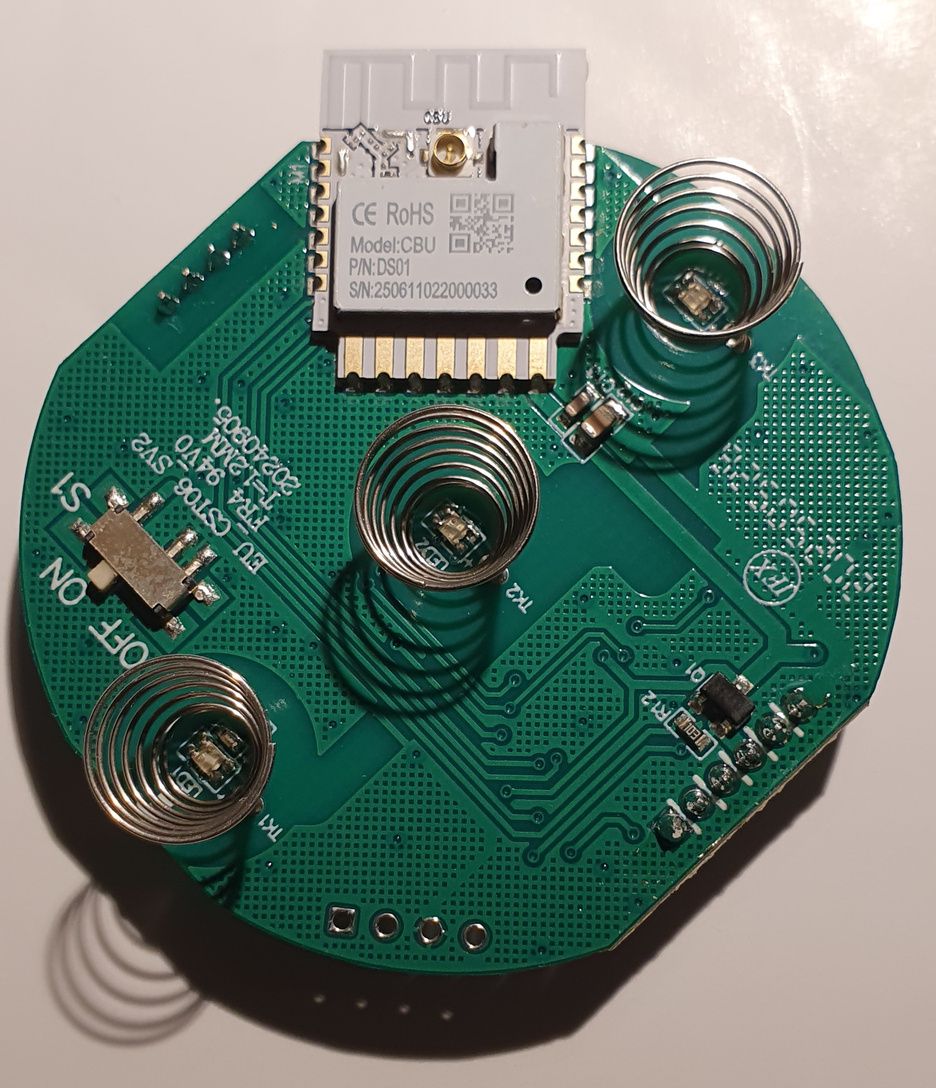

    Hi !
    This is a wall dimmer with touch controls.
    I have several on the outside identical older units equipped with TYWE3S (ESP8266).
    This one seem to be based on a LN822H module ?
    It looks rather similar to the WL2H-U module but partly mirrored.
    Anyway, 3.3V and GND are on the same pads (14 and 13).
    And possibly RX/TX ? (16 and 15).
    But the boot mode pad (A9) ? ("Top side test point" according to the WL2H-U spec).
    Anyone have any idea ?
    PCB with four spring terminals and CBU DS01 wireless communication module
    https://www.aliexpress.com/item/32980493334.html

    >>21804944
    Hi!
    The LN882 was just a (bad) guess based on some similarities.
    So it seems to be the CBU-IPEX module then, BK7231N-based.
    As for the boot mode pad, I guess it will be trial-and-error.
    Thanks.

    You're lucky, CBU in light switch makes some cool modifications possible. for example, you can use P16 (SPI output) to control a single or few WS2812 LEDs inserted as new kind of switch background light.
    Did you manage to flash it?
