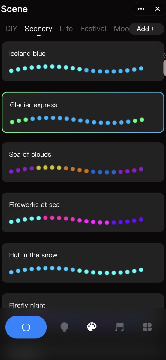

    I have purchased yet another led strip to play around with a “Malli Aurora 5m rgbic strip”. It looks like it’ll be easy to flash being Tuya based with a Tuya cbu.
    However my query is thus, this strip shows various lighting modes in the Tuya app. Is it possible to mimic these in openbeken? If I understand correctly this will be controlled by a microcontroller that the Tuya mcu “presents” via the app and therefore controls.
    I’ve no doubt I’d be able to do Rgb colours but the various “colour chase” modes would be good to retain.
    Picture for reference
    List of light scenes with color effects like Glacier express and Sea of clouds

    It's already supported by SM16703P and PixelAnim drivers, but animations will be a somewhat different.

    It's not TuyaMCU, it's SPI LED, SM16703P /WS2812.
    What kind of animations would you like to have?

    Ive managed to get it working with Pixel Anim and I think there is about 5 different modes? are they plans for any more at all?
    Also will the PixelAnim options be presented to home assistant - that would be awesome if they could be!
