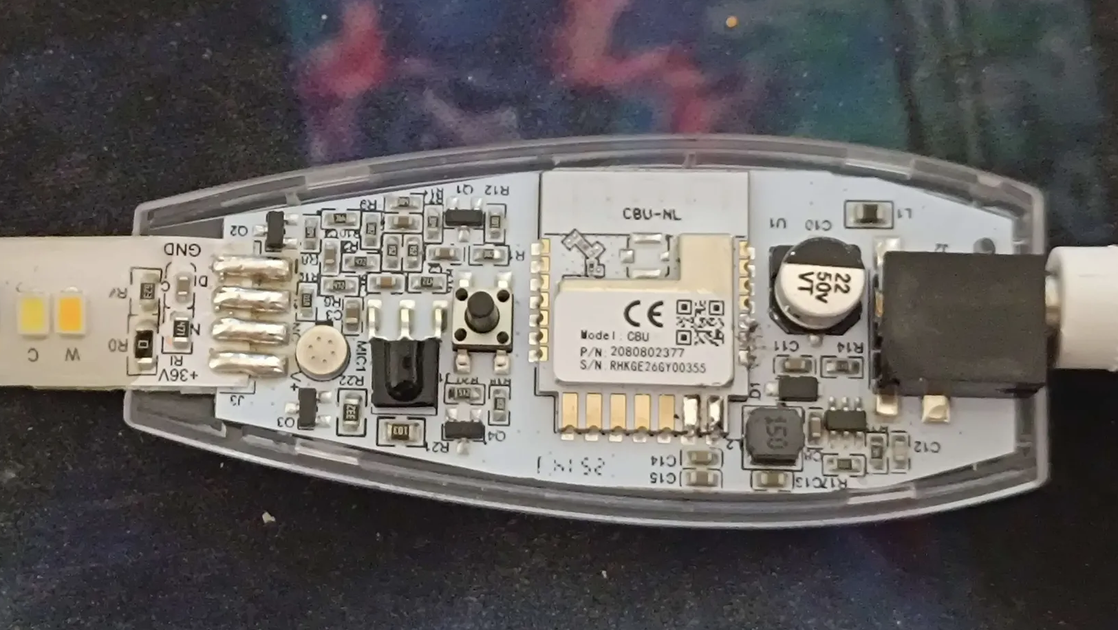

    here is how i teardown and flash openbeken on an Action 20m led strip controler 3218153
    i haven't found anyone with this led strip, it wasn't sold for a long time

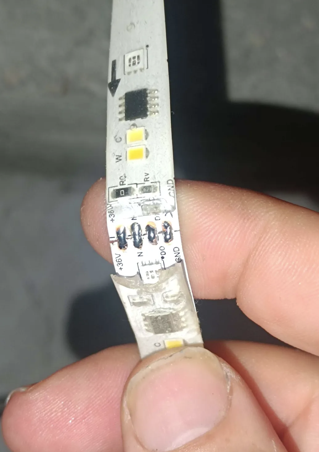

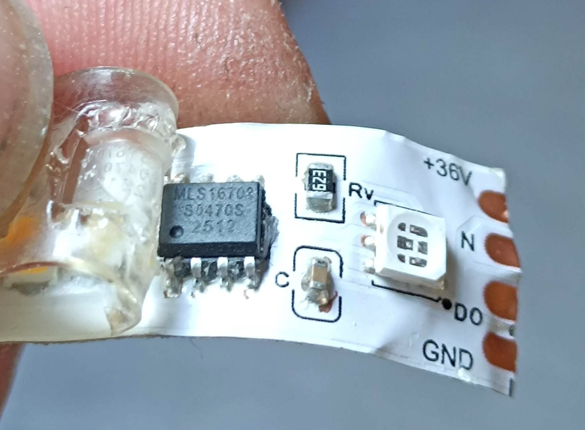

    it's a 36V 20 meters RGBWC led strip with 60 pixel blocks of 10 rgb led / 10 WW leds/ 10 CW leds with two chip per block : MLS 16703 (which seems to work like a FW1906, and not a ws2811 clone as i was thinking first)
    there is 4 lines on the strip : 36V / N / D0 / GND
    it has a button and remote control
    [BK7231N] [CBU-NL] [MLS16703] LSC CONNECT 3218153 from Action 20m led strip teardown and flash [BK7231N] [CBU-NL] [MLS16703] LSC CONNECT 3218153 from Action 20m led strip teardown and flash
    [BK7231N] [CBU-NL] [MLS16703] LSC CONNECT 3218153 from Action 20m led strip teardown and flash[BK7231N] [CBU-NL] [MLS16703] LSC CONNECT 3218153 from Action 20m led strip teardown and flash

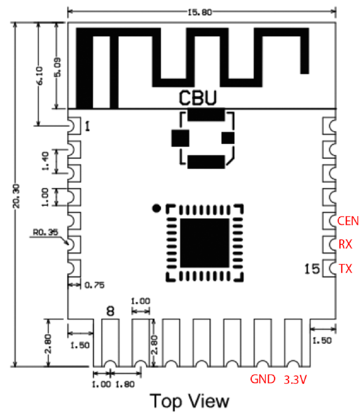

    the pinout for the CBU-NL is like the CBU

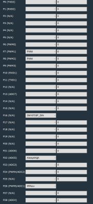

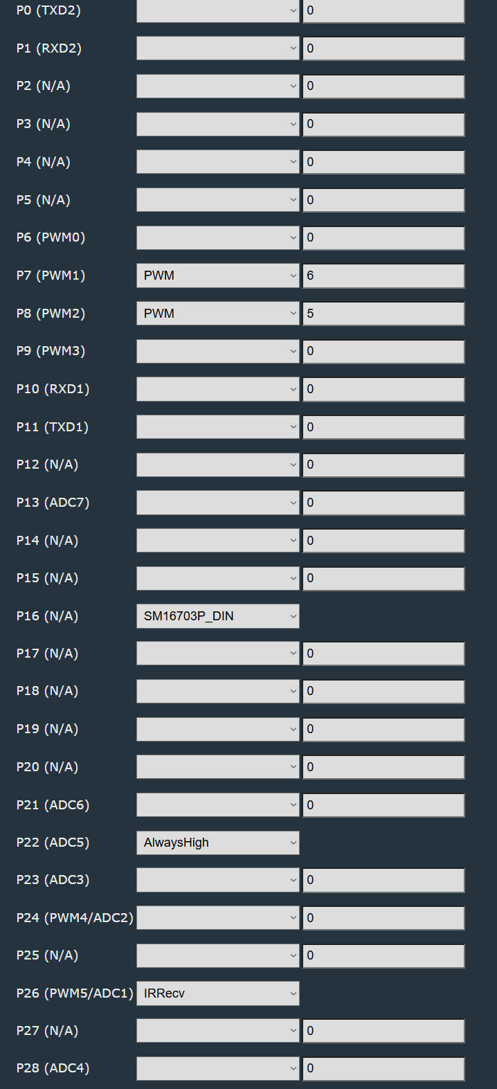

    After few trials and errors i think i found the pinout (i think there is a button on 20, button i don't use it)
      "vendor": "Tuya",
      "bDetailed": "0",
      "chip": "BK7231N",
      "board": "TODO",
      "flags": "272",
      "keywords": [
        "TODO",
        "TODO",
        "TODO"
      "pins": {
        "7": "PWM;5",
        "8": "PWM;4",
        "16": "SM16703P_DIN;0",
        "22": "AlwaysHigh;0",
        "26": "IRRecv;0"
      "command": "",
    But i've got a problem for using it
    there is a drift in the control of the led
    if i choose a full RED for the strip, all the pixel are in a different color
    after diging i found what are the code to have the same color in all pixels
    the exemple of my autoexec.bet for only 5 pixelsof led (the color scheme is repeting every 5 pixels)
    it seems to use a RGBCW pattern and there is a drift on one pixel
    RED
    SM16703P_SetPixel 0 0 255 0 0 0
    SM16703P_SetPixel 1 0 0 255 0 0
    SM16703P_SetPixel 2 0 0 0 255 0
    SM16703P_SetPixel 3 0 0 0 0 255
    SM16703P_SetPixel 4 0 0 0 0 0
    SM16703P_SetPixel 5 255 0 0 0 0
    BLUE
    SM16703P_SetPixel 0 0 0 255 0 0
    SM16703P_SetPixel 1 0 0 0 255 0
    SM16703P_SetPixel 2 0 0 0 0 255
    SM16703P_SetPixel 3 0 0 0 0 0
    SM16703P_SetPixel 4 255 0 0 0 0
    SM16703P_SetPixel 5 0 255 0 0 0
    GREEN
    SM16703P_SetPixel 0 255 0 0 0 0
    SM16703P_SetPixel 1 0 255 0 0 0
    SM16703P_SetPixel 2 0 0 255 0 0
    SM16703P_SetPixel 3 0 0 0 255 0
    SM16703P_SetPixel 4 0 0 0 0 255
    SM16703P_SetPixel 5 0 0 0 0 0
    WARM WHITE
    SM16703P_SetPixel 0 0 0 0 255 0
    SM16703P_SetPixel 1 0 0 0 0 255
    SM16703P_SetPixel 2 0 0 0 0 0
    SM16703P_SetPixel 3 255 0 0 0 0
    SM16703P_SetPixel 4 0 255 0 0 0
    SM16703P_SetPixel 5 0 0 255 0 0
    COLD WHITE
    SM16703P_SetPixel 0 0 0 0 0 255
    SM16703P_SetPixel 1 0 0 0 0 0
    SM16703P_SetPixel 2 255 0 0 0 0
    SM16703P_SetPixel 3 0 255 0 0 0
    SM16703P_SetPixel 4 0 0 255 0 0
    SM16703P_SetPixel 5 0 0 0 255 0
    So, manage to use it for plain colors but it's not as easy as using a strip fully working in openbeken
    and i need to use mqtt script for all the colors in home assistant
    for a mix of colors i need to lower the power of the colors to 125ish so the color is the same in the 20m, if not, it's a grandiant of colors, the 36v power supply seems a littre weak for 20 meters of led
    i can't use the colors sliders, or the colors is a rainbow :)
    same for white colors
    does anybody know if there's a way to use it properly? may i have missed something? or is it software related?
    if you need more info, no problems
    thanks!

  • WLED test confirms GRBCW works on ESP32
    #3 21881977
    snuf69
    >>21881955
    hi thanks for your reply
    i think i've made a mistake when i wrote my post
    i've got the same description
    - Microphone (TODO) on P23
    - LED Cool (Channel 4) on P8
    - IR Receiver is on P26
    - PWM Frequency 1000
    - SPI MISO 17
    - SPI MOSI 16
    - Control Pin (TODO) on P22
    - SPI CS 15
    - LED Warm (Channel 5) on P7
    - SPI SCL 14
    Device seems to be using CBU module, which is using BK7231N.
    Device internal platform - bk7231n, equals BK7231N.
    And the Tuya section starts, as usual, at 2023424 (0x1EE000)
    i change my error on the main post
    if i can manage to only make the colors working and not the whites it's not a problem, it's not the main light in my gameroom
    thanks
    EDIT: i disconnected de N line : nothing changed
    EDIT2: i have tested the strip on an ESP32 with wled : i can handle colors and whites perfectly if i use the FW1906 GRBCW
    but it would be great if i can manage to use the original driver on OBK
