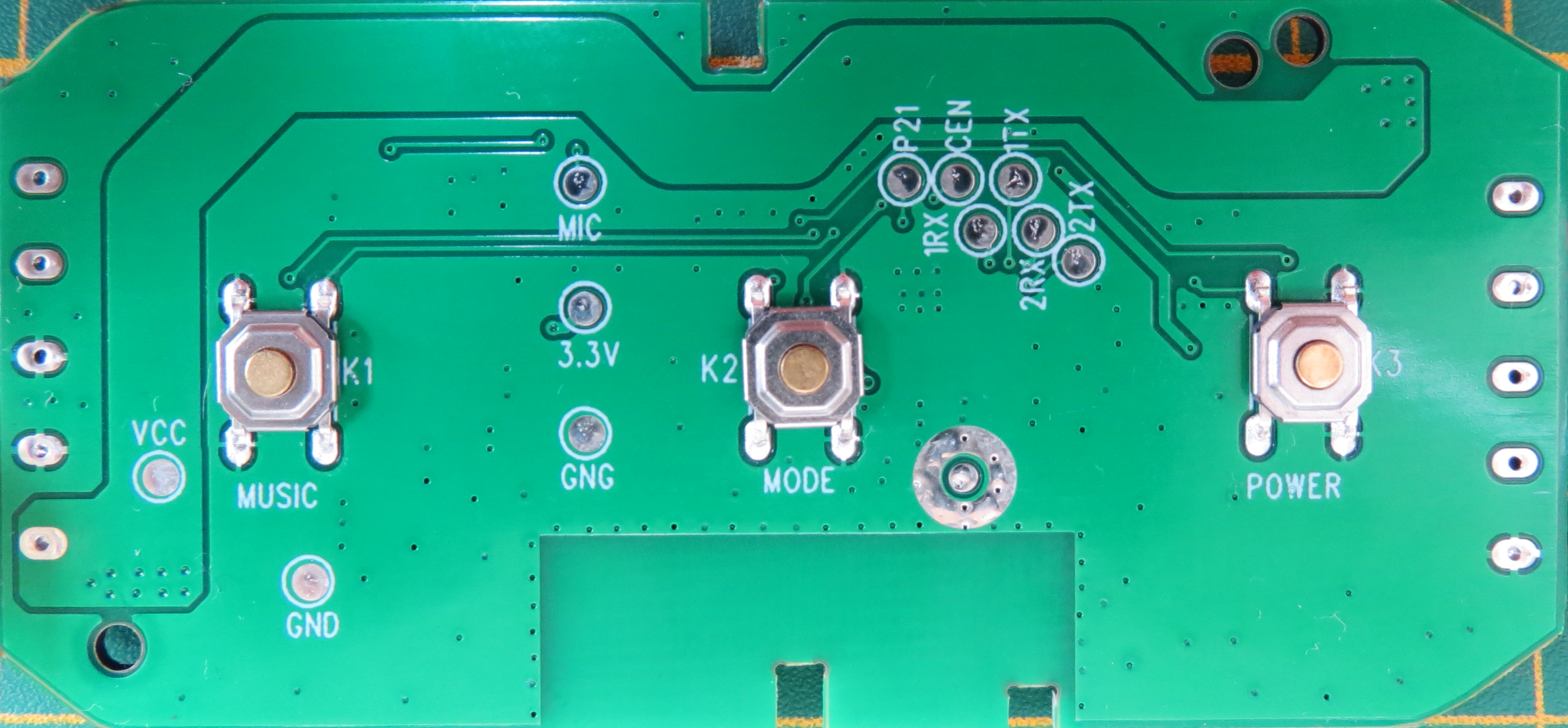

    Firmware flashing
    In addition to local operation of the light column via remote control and in music mode, it is also possible to disconnect from the Tuya cloud using attached CloudCutter profile.
    Of course, OpenBeken can also be flashed via the serial interface (GND, 3.3V, 1TX, 1RX).
    Close-up of green PCB with three labeled buttons: MUSIC, MODE, and POWER
    Firmware configuration
    OpenBeken template:

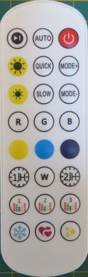

    Remote with buttons for RGB lamp control, including AUTO, R/G/B, timer, and music modes
    ManufacturerShenzhen Langxun Intelligence Control Technology Co., Ltd
    Brand nameLang Xun Zhi Kong (LXZK)
    Model name?24Key Remote Control?
    Model number?
    PCB nameLXZK-BT3024-2.4G V4.0
    Chip labeling3-D12E42-J2M
    HousingLXZK-2024

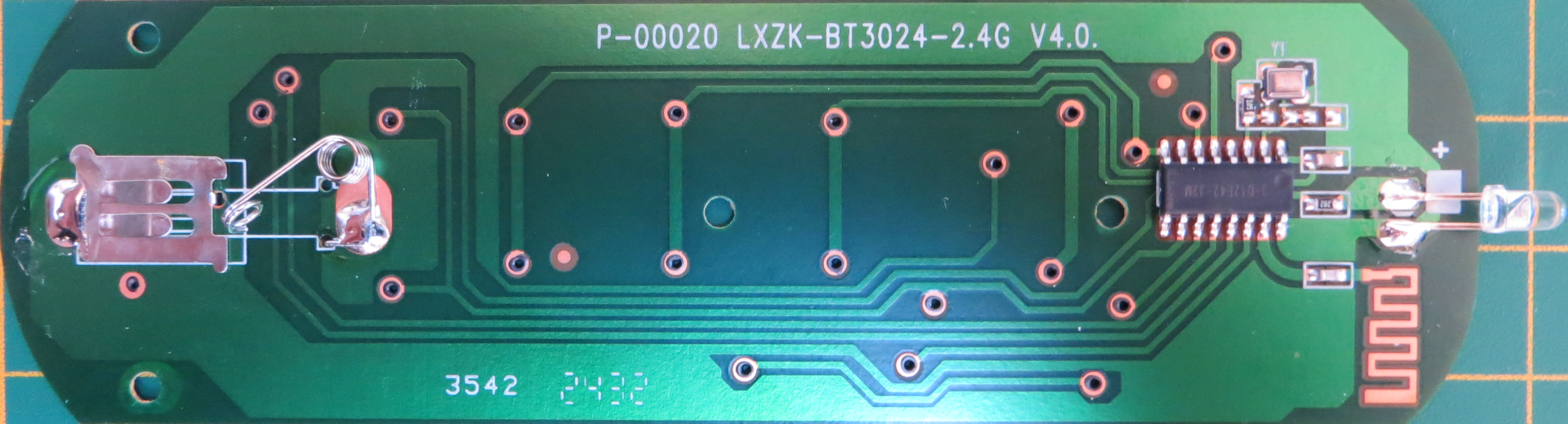

    Does anyone have more information about this remote control, the chip it uses, and how to use Bluetooth or RF with OpenBeken?
    I was able to find similar remote controls here (LXZK-TX2029-2.4G-E-VER2.0 with 3-D0TG15-J2M) and here (LXZK-TX1044T-V3.0).
    Could the chip possibly be a Y62G by Yufan Micro?
    View of PCB LXZK-BT3024-2.4G V4.0 with IC and RF antenna trace
    The unknown IC has 16 pins, with pin number 1 connected to the cathode of the LED and pin number 9 connected to the anode of the LED. Pin number 15 leads to the antenna. Pin number 2 is connected to the SMD quartz at the top right and pin number 3 is connected to the SMD quartz at the bottom left. The SMD quartz is labeled “24.000 49N.”

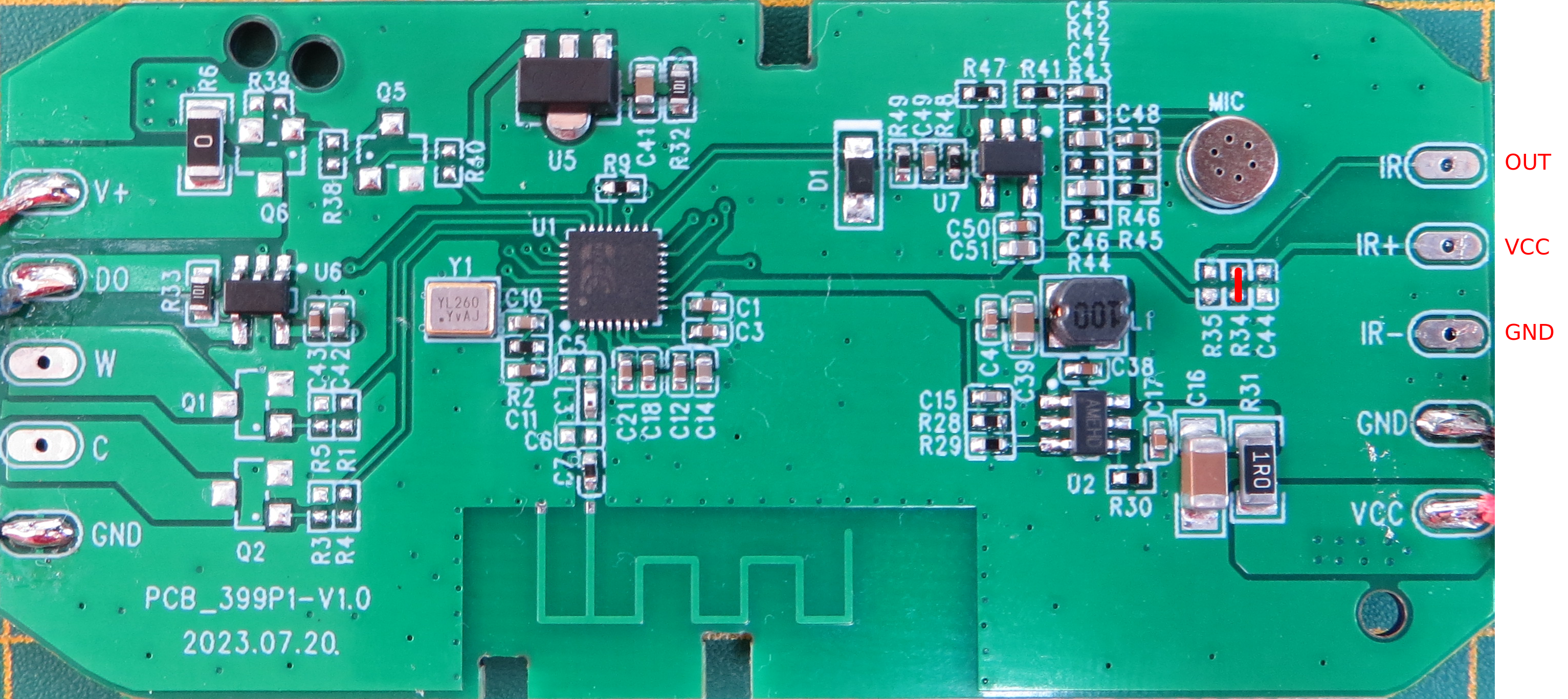

    The PCB already has the necessary preparations for an IR receiver, so that after a minor modification, an IR receiver (e.g. TSOP38238) can easily be added:
    Close-up of RGB controller PCB with labeled IR pins and model PCB_399P1-V1.0
    I use the remaining remote control from my second RGB Light Bar and have adjusted the autoexec.bat accordingly:

    Thank you for yet another LED presentation! Would you have time to share the effects, again?
    Hmmm, you didn't show us the remote, did you? Well, if remote is using Bluetooth, then it's still on our TODO list...
  • Remote control likely uses RF, not BLE
    #3 21628433
    emarck
    Posts: 15
    Rate: 8
    The effects are taken from the RGB Light Bar and therefore look almost identical. There is no noticeable difference in a video. However, I will submit corresponding videos as soon as the included remote control works under OpenBeken and the range of functions has been modeled after the original.
    I am not sure whether the remote control works with BLE or RF. The UART log with the original firmware output different codes for the buttons, which contained references to IR and Bluetooth. Since IR can be ruled out due to the lack of a receiver, I initially assumed that Bluetooth must be used. However, I was unable to receive a Bluetooth signal with the BLE Radar app. I do not currently have an SDR available for identifying RF.
  • CloudCutter profile and IR remote mappings added
