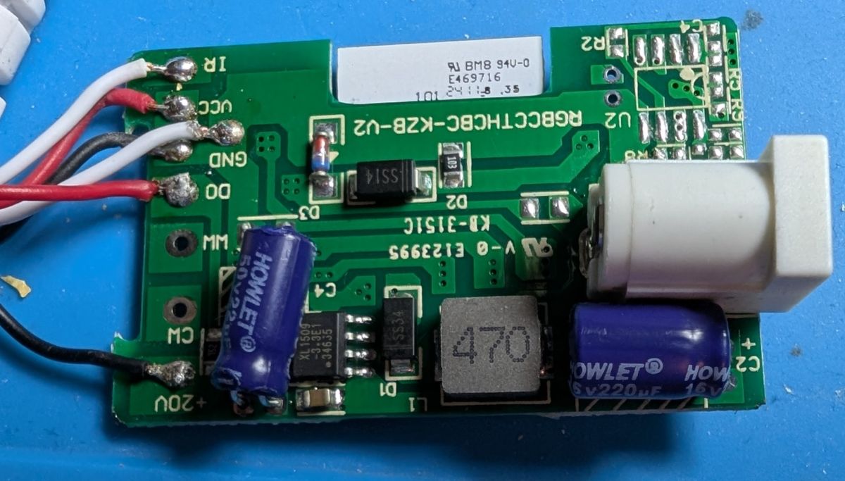

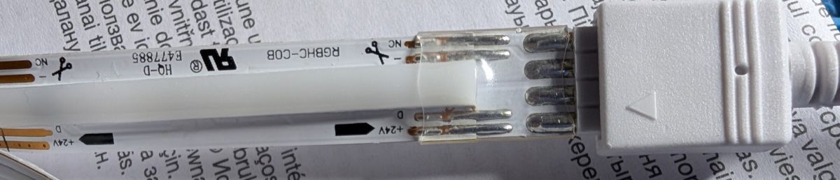

    I have an unknown LED strip here. It's a "LEDVance COB Magic RGB" 3 m COB LED Strip. The strip is powered by 24 V and uses 3 pins (the connector has 4 pins, but one is not connected).

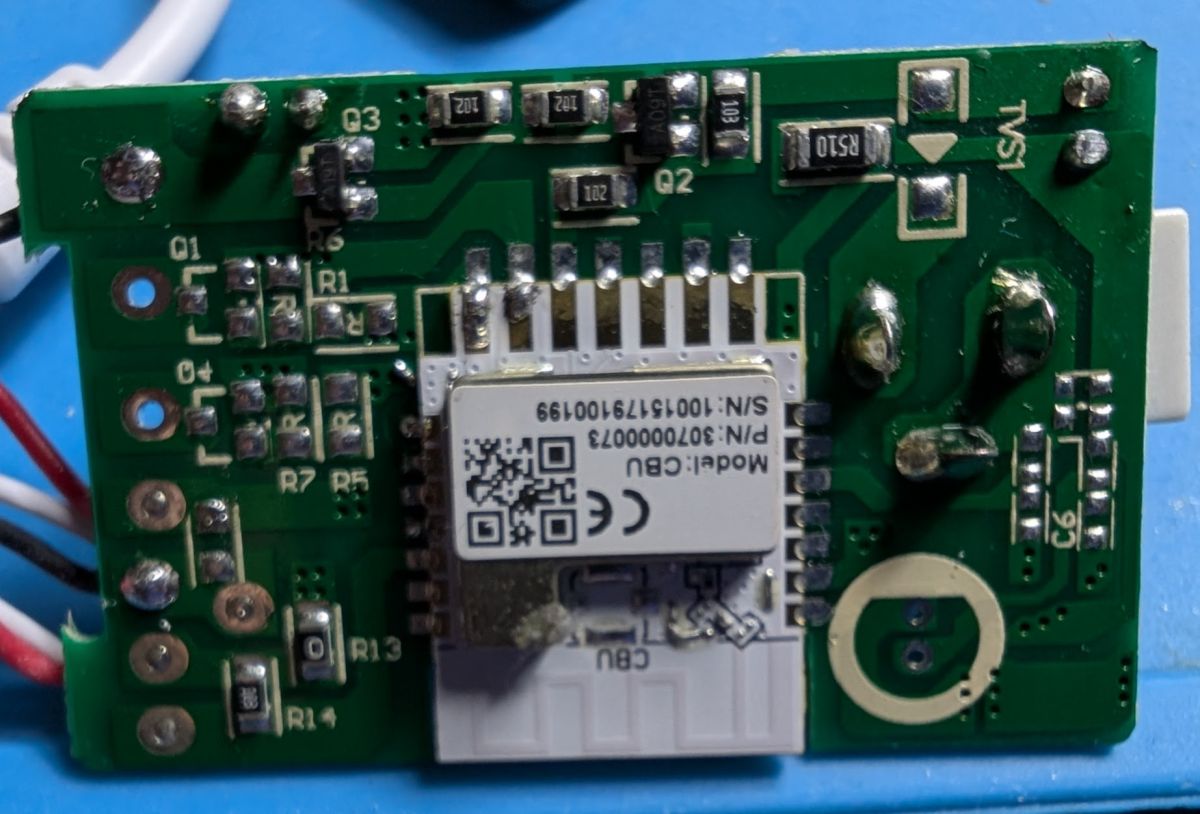

    It comes with a controller that has a Tuya CBU module. I was able to dump the module just fine and flash Openbeken on it. However, no matter what I try, I cannot control the strip, or even get it to light up at all. I also connected the LED strip to an ESP8266 with WLED, and tried all the config options for the LED type, but none will make it light up.
    If I restore the backup of the CBU, it will work just fine right away again.
    Anyone have any idea what kind of LED strip this is?

    maybe P0 needs to be assigned AlwaysHigh?

    Got it figured out.
    The circuit requires P24 to be "AlwaysHigh" to enable power to the strip.
    Once that was set, I was able to use Openbeken normally.
    Edit: And now realized what it does. P24 essentially turns off the 24V power supply to the LED strip when the strip is turned off.
    Is it possible to do this in Openbeken, too?
  • P24 must be held always high to enable strip power
    ah yes, P24 is seen in further extraction from your backup
