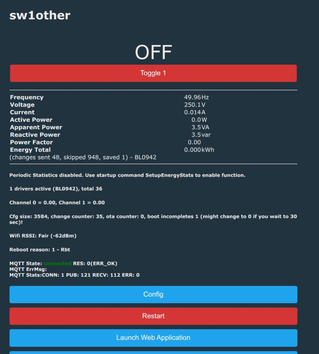

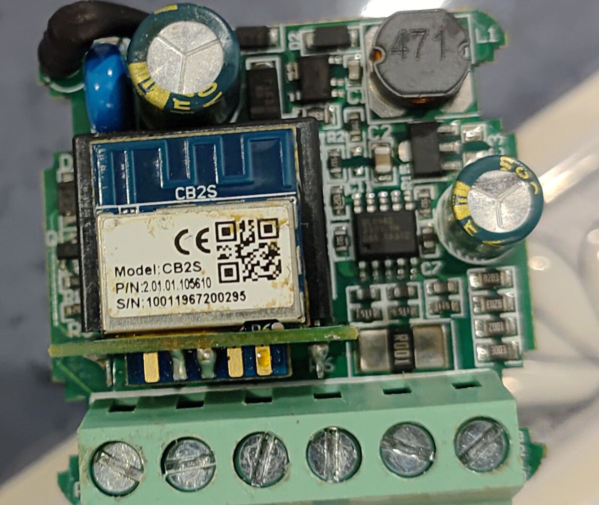

    I've been reflashing and setting it up for a long time now, but I couldn't find the config file in the device.json file, so I decided to post it here.
    Reflashing the Mini Smart Switch with an energy monitor BL0942 Reflashing the Mini Smart Switch with an energy monitor BL0942
      "vendor": "Tuya",
      "bDetailed": "0",
      "name": "Mini Smart Switch With Power Monitor - 16A",
      "chip": "BK7231N",
      "board": "CB2S",
      "flags": "1024",
      "keywords": [
        "switch",
        "relay",
        "CB2S",
        "BK7231N",
        "BL0942"
      "pins": {
        "8": "Rel;1",
        "23": "WifiLED;0",
        "24": "Btn_Tgl_All;0",
        "26": "TglChanOnTgl;1"
      "command": "backlog startDriver BL0942; PowerSave 1",
      "image": "https://obrazki.elektroda.pl/8987584400_1767345124.jpg",
      "wiki": "https://www.elektroda.com/rtvforum/viewtopic.php?p=21796183"
    Power control interface with toggle button and real-time energy statistics
    https://github.com/OpenBekenIOT/webapp/pull/247

    Thanks for sharing, don't forget to use OpenBeken's PowerSave 1 feature, otherwise you'll be doing this repair soon:
    https://www.elektroda.com/rtvforum/topic3898805.html
  • #3 21796214
    vokamut
    Posts: 7
    Is it enough to change the team from "startDriver BL0942" to "PowerSave 1"?
  • #4 21796303
    Posts: 14622
    Help: 655
    Rate: 12638
    no, you need both:
  • #5 21798561
    vokamut
    Posts: 7
    Replaced as you wrote, thank you
