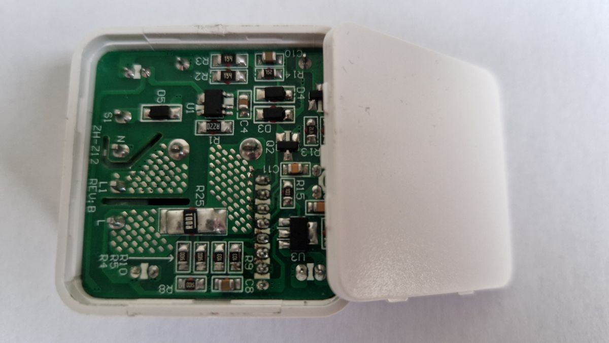

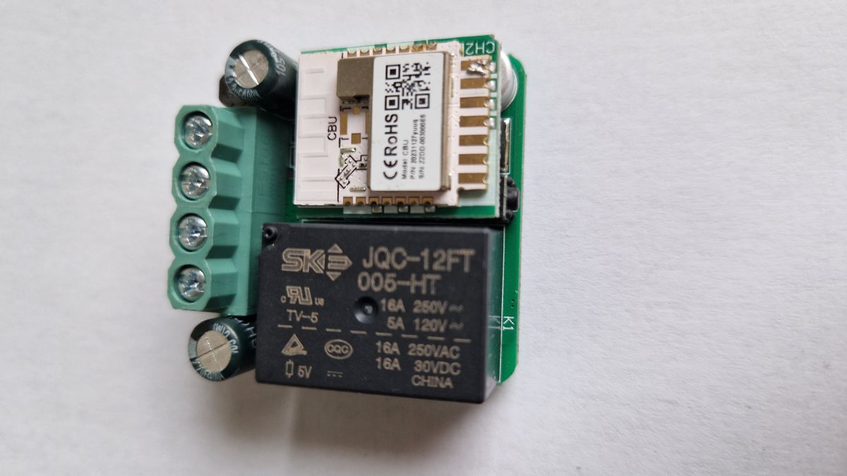

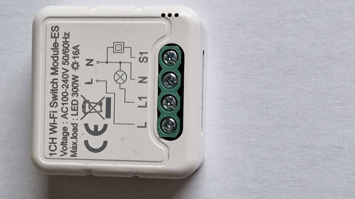

    This is rather rare smart switch with power monitoring in Live leg of the circuit. This allows it to be put under light switches easily.

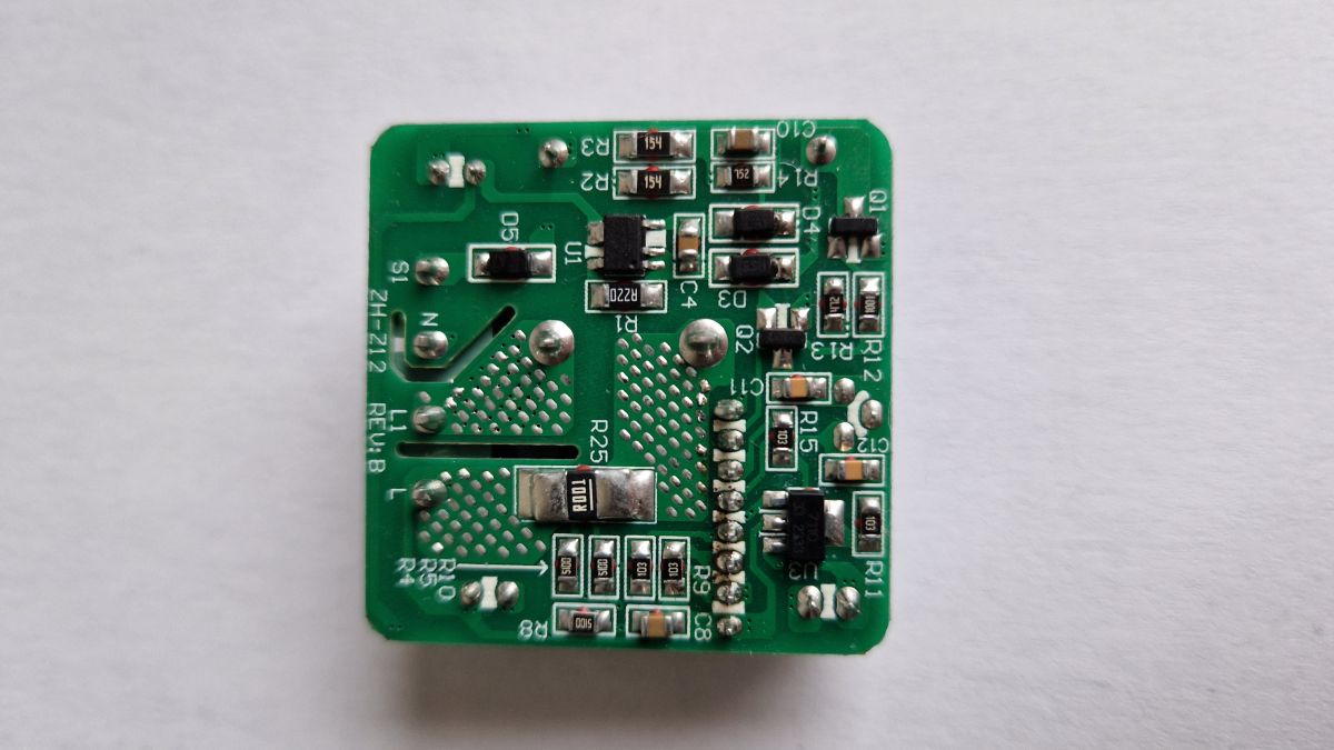

    Contains usual BP2525 power supply and BL0942 chips for power monitoring.
    Flashing is as usual, solder rx, tx, 3.3V. Ground can be connected to Live terminal of the switch (Circuit is live referenced, probably to allow such monitoring on Live leg). No need to desolder anything, BL0942 does not interfere with flashing.

    1CH Wi-Fi switch module with power monitoring, 16A. View of the interior of the GIRIER Tuya smart switch module with power monitoring circuitry. Smart switch module with power monitoring and WiFi component Green printed circuit board with electronic components on the surface.
