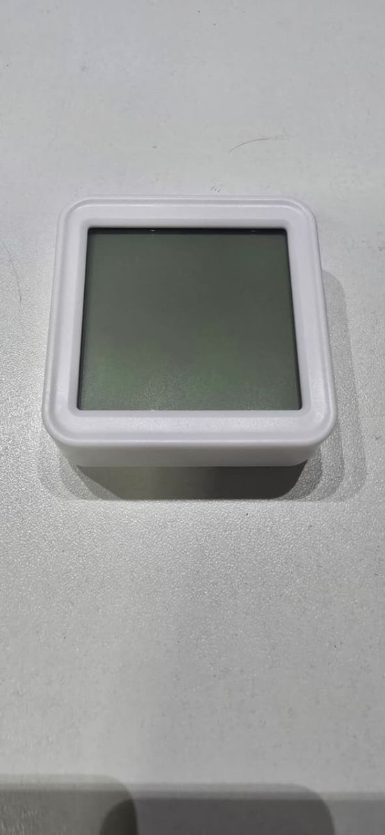

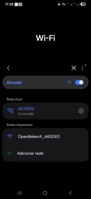

    I dump and flash of the TH08 with t1 u hl
    I can see the wifi, I try to connect and get and error, sometimes I still connect for a milesecond.
    any ideias?

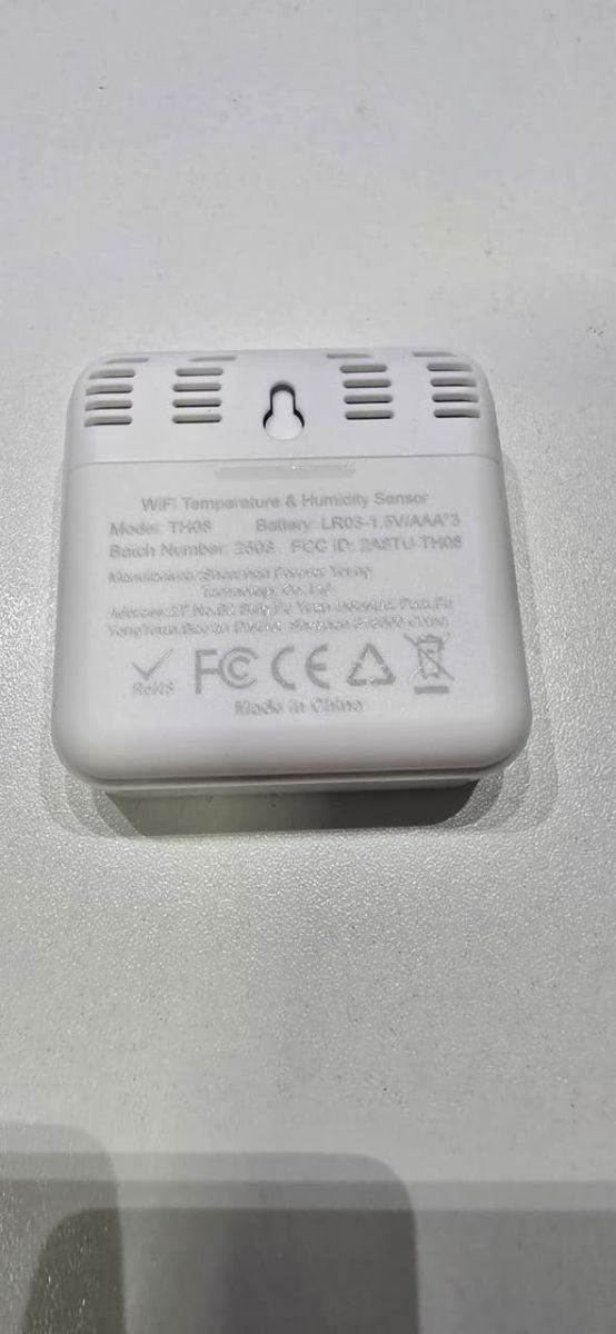

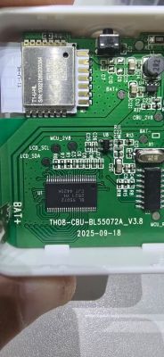

    T1-U-HL module on PCB with visible CE mark and serial number Smartphone Wi-Fi screen showing ASTERIX connected and OpenBekenX_A60DE0 available Close-up of a PCB with visible S8305 DA130 IC and other electronic components. Box of WiFi temperature and humidity sensor A20-FLY TH08 near keyboard Back of a white Wi-Fi temperature and humidity sensor model TH08 Square device with a dark LCD screen and white frame on a light surface. TH08 sensor packaging with technical specifications and QR code PCB with Wi-Fi module labeled “TH08-BU-BL55072A_V3.8” inside a plastic enclosure TH08 circuit board with T1-UHL Wi-Fi module and TH08-CBU-BL55072A_V3.8 label TI-UHL Wi-Fi module on green PCB with BL55072 chip

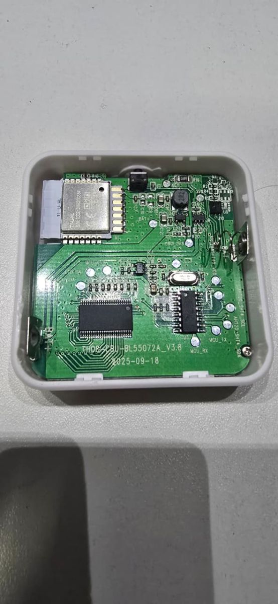

    TuyaMCU is probably killing power after set period of time. Does it allow you to connect if you keep pushing the button to keep it awake?

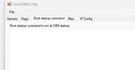

    I try to push fast, I connect one, but loose the connection, theres a way to fix it to send the autoexec
    and the display is blank, its normal?
    Added after 6 [minutes]:
    something I can put here?
    Software configuration window with Short startup command tab active

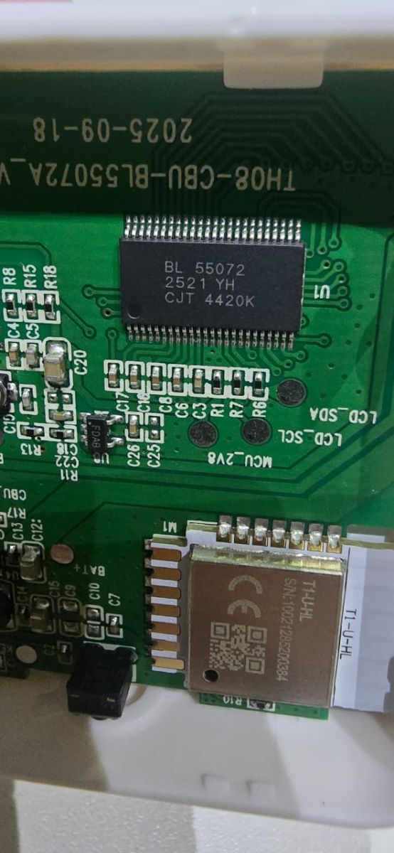

    you can solder T1-U-HL module ground and power to 3.3v/ground directly so TuyaMCU doesn't cut power to the module. This will at least let you navigate OpenBeken and upload your ready-made autoexec. Not sure if the display/TuyaMCU will work in that mode though. You'd have to connect power as normal to test properly.
    There are lots of battery-powered TuyaMCU devices in the device list that link to many threads where the awkwardness around TuyaMCU in battery devices are discussed https://openbekeniot.github.io/webapp/devicesList.html

    another trick, we have to add CEN to high (3.3) to still with wifi working!!! this work for me!
