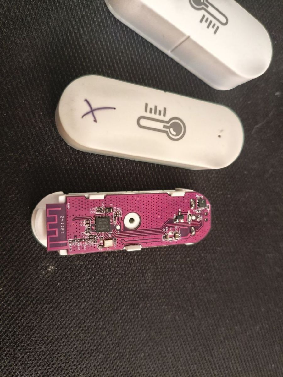

    I present the inside of a temperature and humidity sensor on Zigbee.
    The idea to present the inside came to me after it stopped working properly.
    An offset appeared on my temperature reading. When it was 20 degrees it was showing 3 degrees.
    I ordered a new one of the same kind and it turned out....

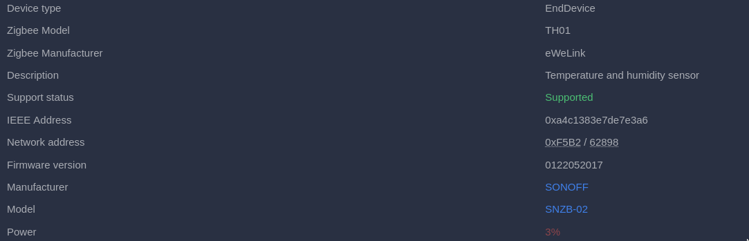

    My sensor is read by Zigbee2Mqtt, the documentation and model page for this sensor can be found here:
    https://www.zigbee2mqtt.io/devices/SNZB-02.html
    Zigbee SNZB-02 eWeLink sensor status with 3% battery level

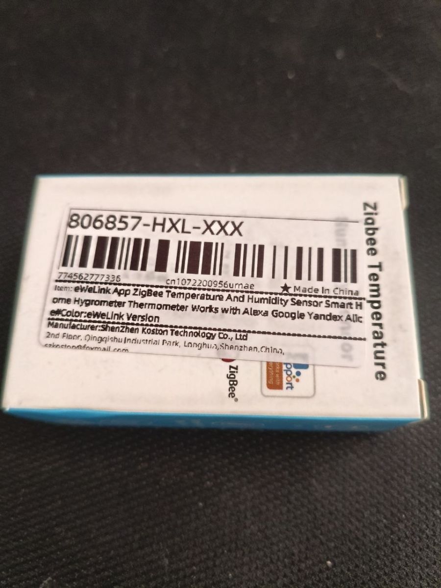

    It is called eWeLink on the packaging.
    Close-up of Zigbee eWeLink temperature and humidity sensor packaging

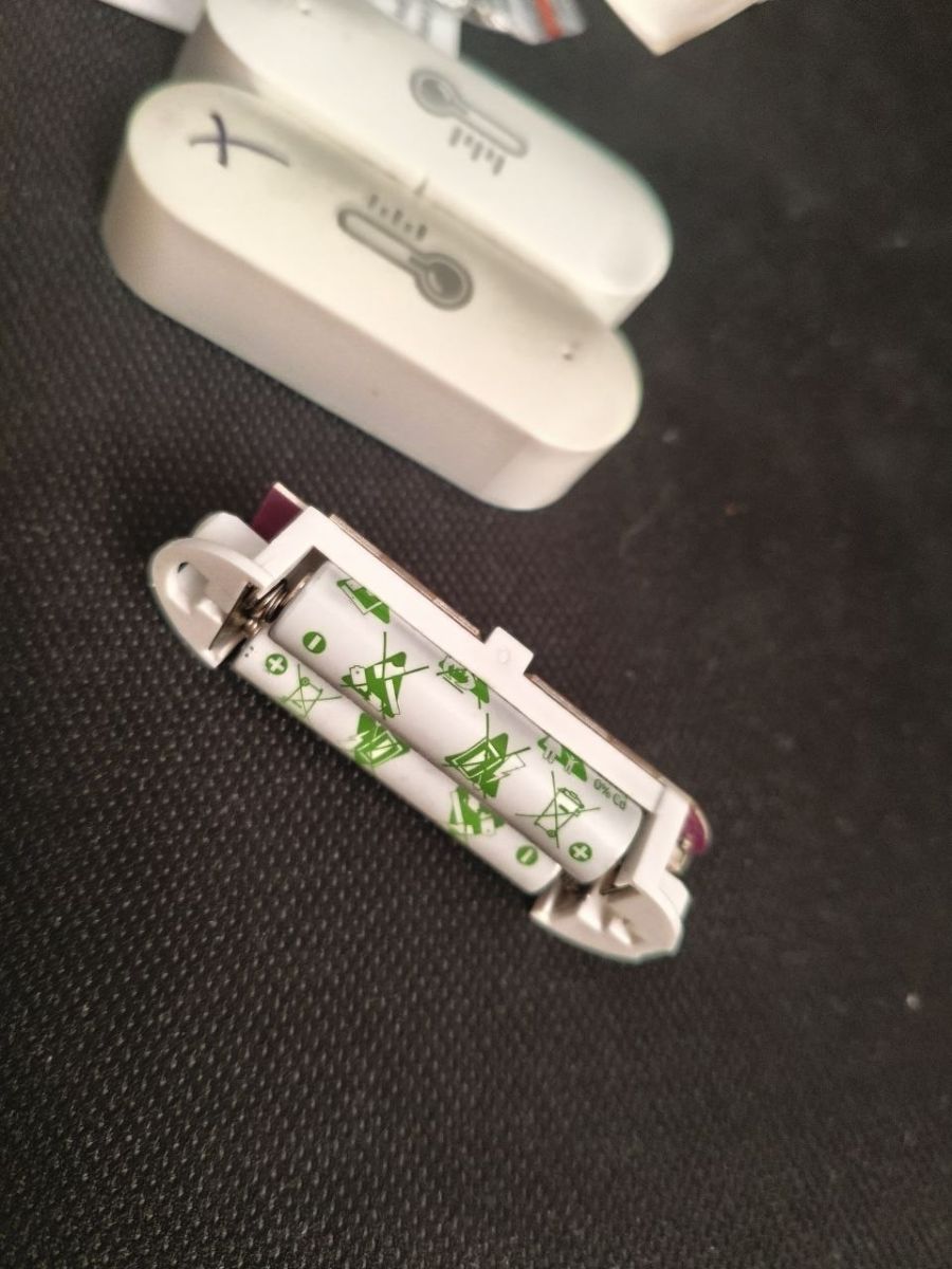

    When the sensor stopped working, I saw what was inside to check for any damage. It had been mounted on the north window outside for several months.
    Zigbee sensor battery module with visible cell and white enclosures in background

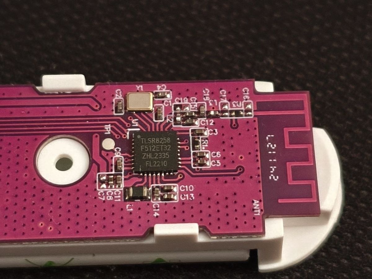

    Interior of Zigbee sensor with exposed purple PCB and electronic components
    Close-up of Zigbee sensor PCB with TLSR8258 microcontroller
    Close-up of Zigbee sensor PCB with visible SMD components

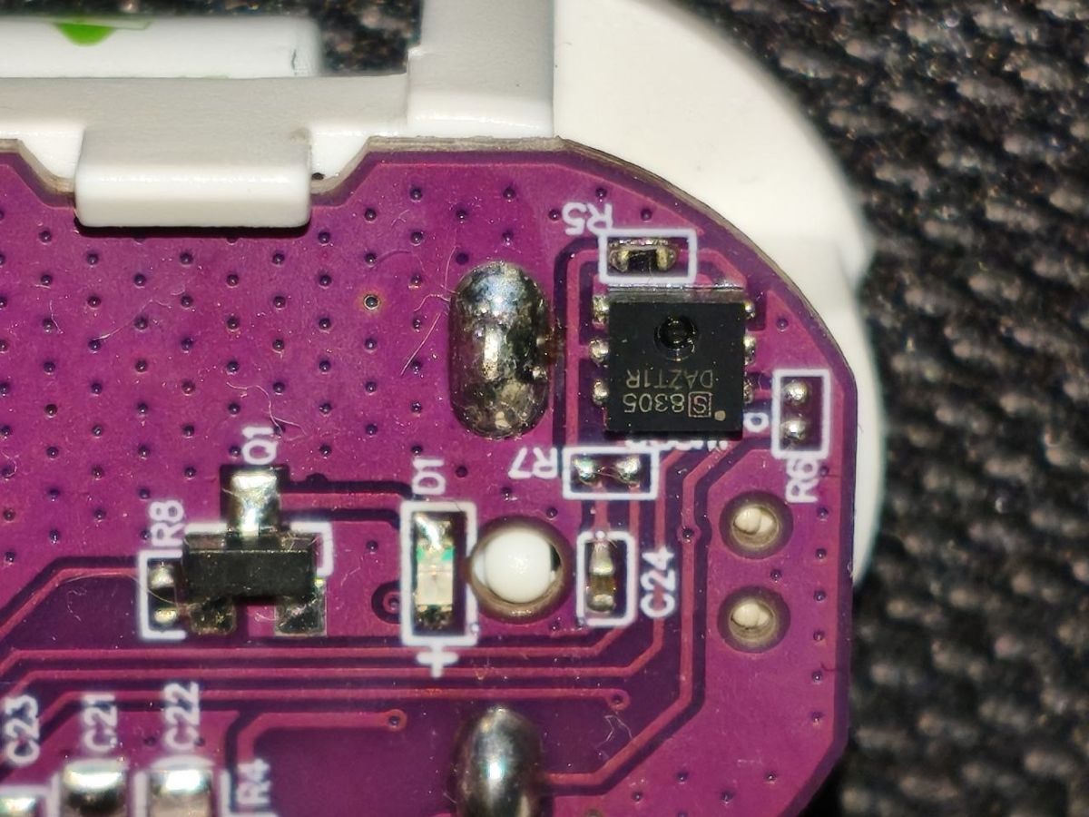

    Close-up of a PCB with CH8305 sensor and SMD components

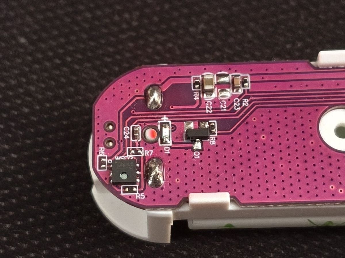

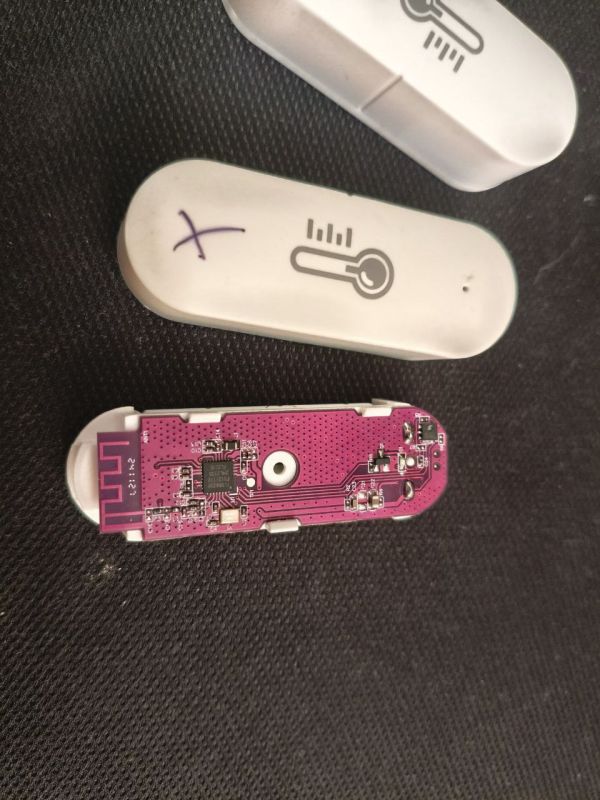

    Inside everything looks correct, nothing is flooded.
    As you can see there are few components inside:
    -mikrokontroler TLSR8258F512ET32
    -temperature and humidity sensor ch8305
    - lED and its control transistor in SOT-23
    - a button to pair with the network and start instantaneous measurement(didn't catch the photo)

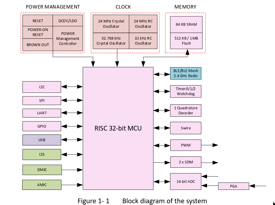

    TLSR8258F512ET32 64KB 512KB
    Qualified for Bluetooth 5.3, AOA/Tx, Bluetooth Mesh, 802.15.4, Zigbee 3.0, RF4CE, HomeKit, Dual-Mode, 2.4G Proprietary
    Block diagram of RISC-based MCU with integrated 2.4 GHz radio and peripherals
    As you can see from the brief description the microcontroller has 512kB flash 64kB RAM. So it is quite large. In addition, it is equipped with a radio chip with quite a lot of capabilities. It has everything integrated into one housing with inverters and memory and radio. It works with voltages from 1.8V to 3.6V.

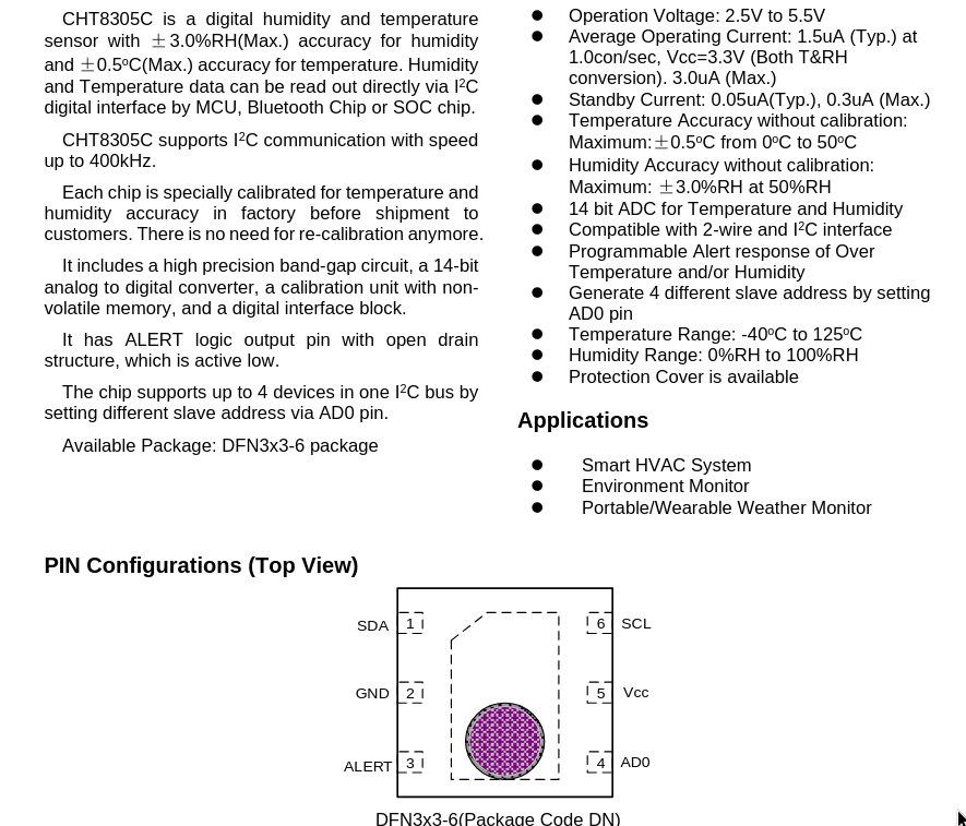

    Temperature sensor ch8305
    Technical specifications of CHT8305SC sensor with pinout diagram
    This is a small 3x3mm IC in a DFN housing. It has an I2C interface. The average current consumption is 3uA. It operates over a supply voltage range of 2.5V to 5.5V.
    After buying a new sensor, I re-purposed the battery from the old one, connected it to the mains and found that this sensor was also showing the temperature reading incorrectly.
    The only common element left was the battery. I fitted new ones and found that everything worked. Zigbee2Mqtt was showing that there was still 3% battery, so I didn't pay attention to that right away. The other sensors I have work to the end of the battery until they stop responding completely.
    Measuring the battery voltage with a multimeter and it comes out 2.2V, which I thought was enough, there should still be some energy pulling from them, especially as the Zigbee connectivity was working fine.
    A quick measurement on the board and it turned out that the sensor is powered directly from the batteries, and is running from 2.5V to 5.5V. Which is the direct cause of the problem.
