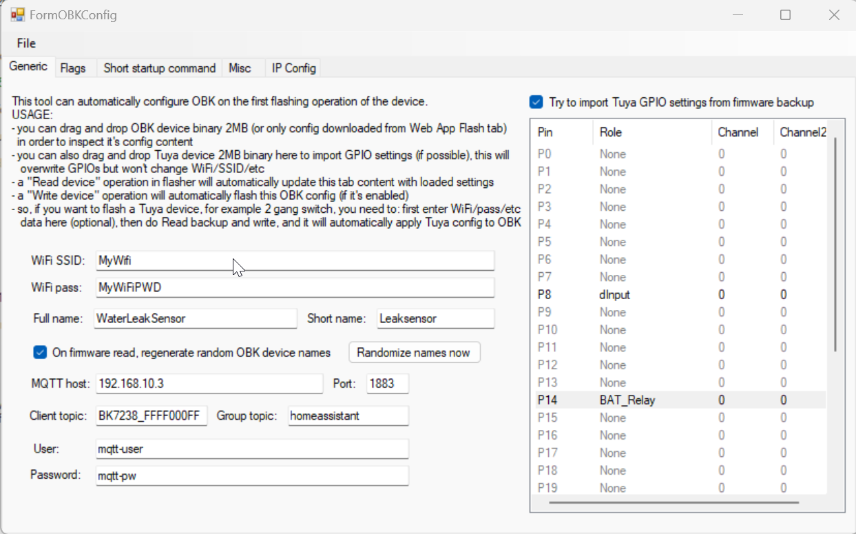

    I recently bought a Tuya Wifi Water Leak Sensor off Aliexpress with the CB3S Chipset.
    I managed to backup & flash the firmware and configuring OBK. After a successful OBK-write and a reset, the device won't connect to my WiFi, hence not doing anything.
    I'd assume the device is dead, but i can successfuly read OBK data. I tried while powering the chip with my jumpercable-setup or with batteries. Nothing happens.
    OBK device configuration interface showing WiFi and MQTT settings
    FormOBKConfig app window showing configuration options with some checkboxes selected

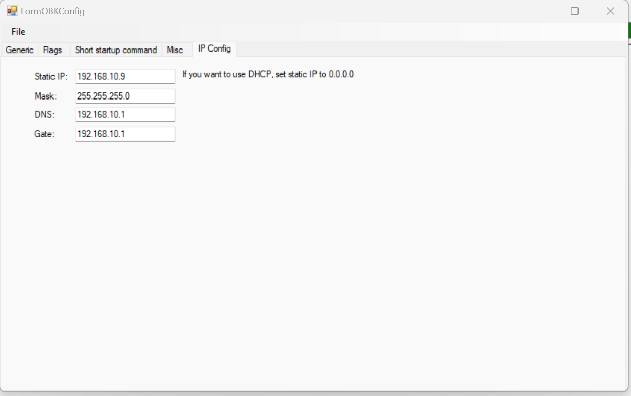

    “IP Config” tab showing static IP, mask, DNS, and gateway settings in FormOBKConfig

    Any help is greatly appreciated. Thanks
    afaik4711
    AI: Could you share the exact WiFi settings you entered in OBK (SSID, security type, password, etc.) and how you configured them?
    Please see my wifi settings in the embedded picture
    AI: Are there any error messages, unusual LED patterns, or log outputs when the device tries to connect to WiFi after flashing OBK? If so, could you provide those details?
    No visible error messages, no LED is on, unable to find where to view the UART-log

    afaik4711
    Hello again,
    I managed to get it working. I had the wrong chip selected and installed the wrong bin file.
    When I realized my mistake, I wrote back the original firmware dump with the wrong chip settings and started off anew.
    Now it starts correctly and I can use it.
