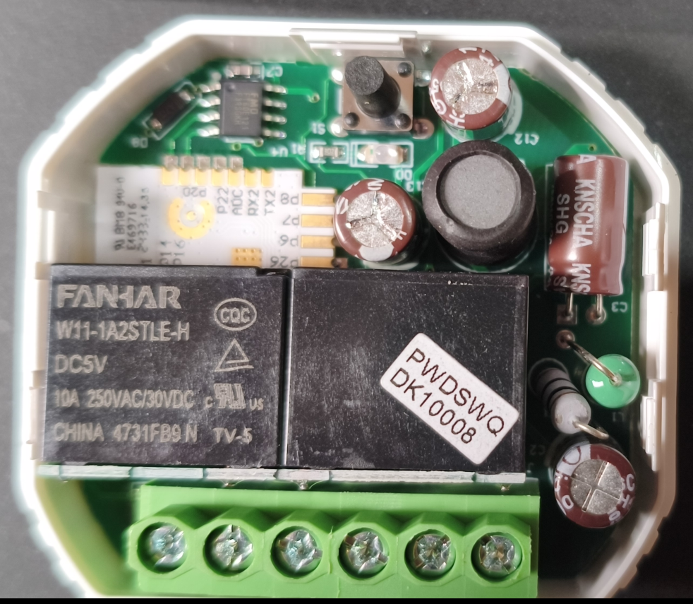

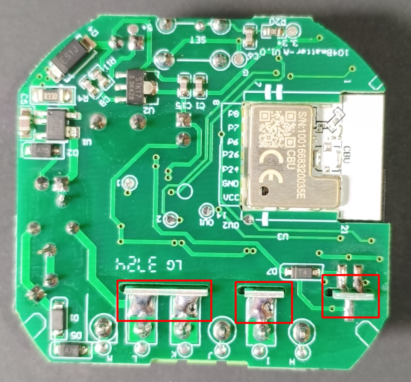

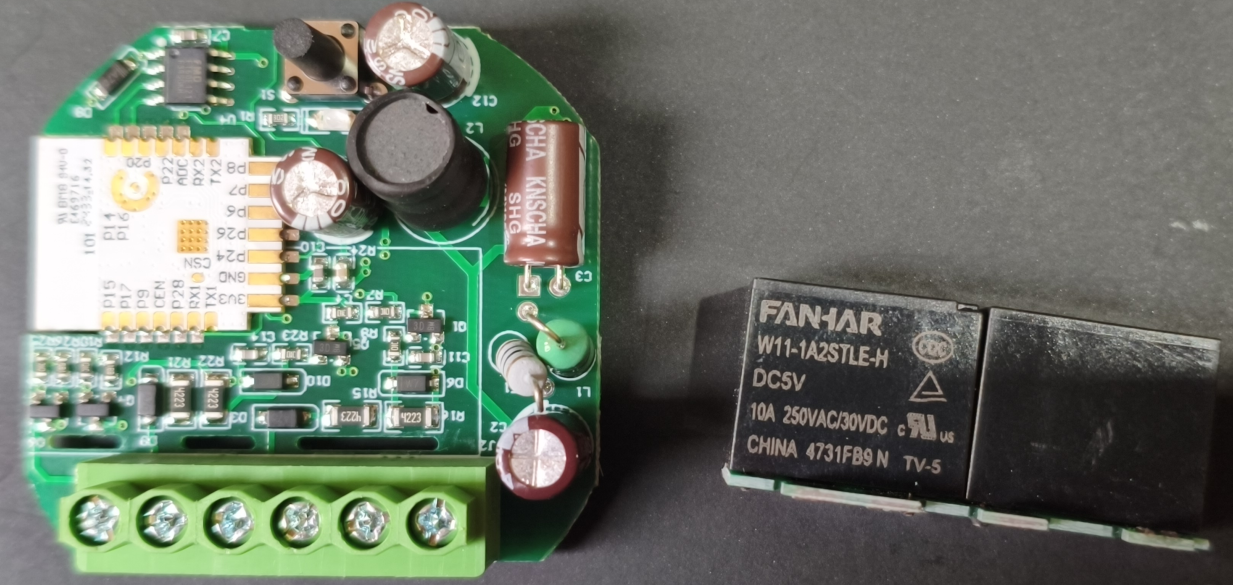

    1. Open the module
    Close-up of Moes MS-104B module interior with labeled components and relays
    2. Release the 2 relays to access the Tuya CBU
    Moes MS-104B module with visible PCB and detached FANHAR relays

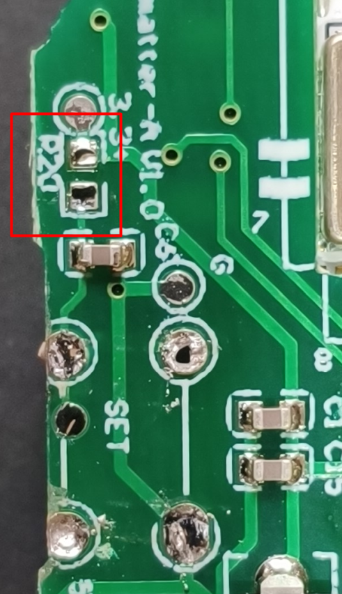

    3. Cut both 3V3 and GND vias near the Tuya CBU
    You need to do it to break the pull-ups and pull-downs preventing to flash the Tuya CBU.
    Note: you will need to re-join them again, so do a very small cut.
     Before  Close-up of 3V3 and GND traces on Tuya CBU module with marked cut area   After  Close-up of Tuya CBU module with labeled pins and signal pathways visible

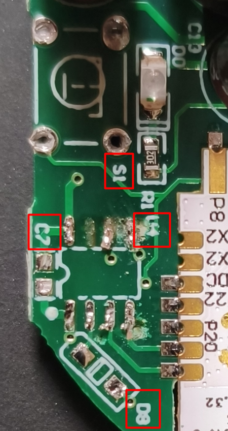

    4. Remove following components:
      - Micro controller U4 - signal conditioning, not required anymore will be replaced by 2 shunts, mandatory
      - Resistor R20 - 10k pulling up the RX1 and the button S1, mandatory
      - Diode D8 - debounce and voltage limiter for S1 and RX1, mandatory
      - Button S1 - Pulled up and connected to RX1, optional
      - Capacitor C7 - power filter to U4, not required, optional
        Front side    Close-up of PCB with highlighted areas where components were removed.                  Back side    Close-up of PCB with highlighted area showing 3V3 and GND vias cut

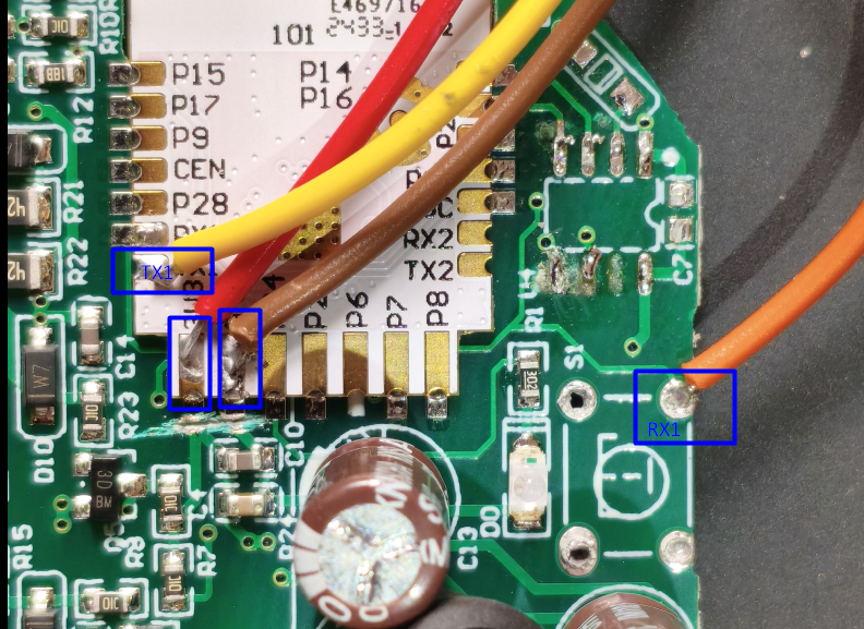

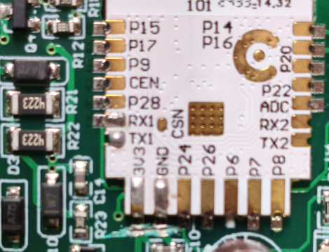

    5. Connect the wires:
             Close-up of Tuya CBU board with wires connected to TX1 and RX1 pins

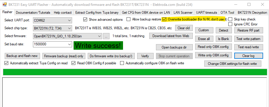

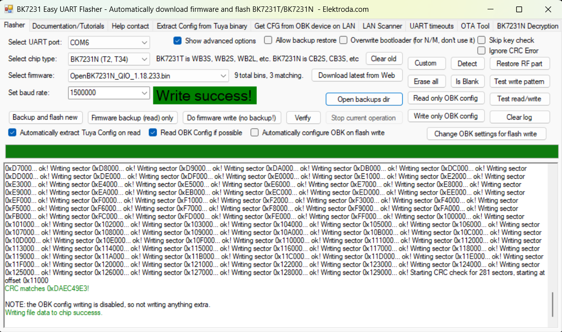

    6. Flash it with BK7231 Flasher
    BK7231 Easy UART Flasher interface with Write success! message and sector write log

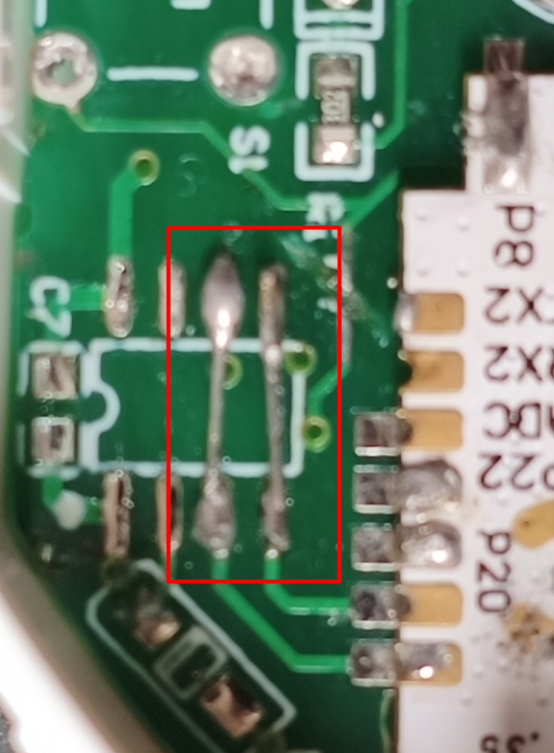

    8. Do 2 shunts for the S1 and S2 external inputs
    Close-up of PCB with two soldered wires highlighted in a red rectangle

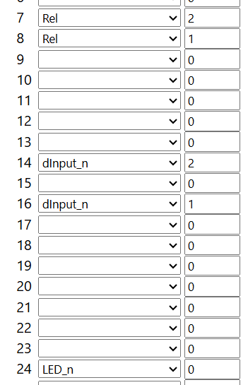

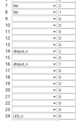

    - Pin setting:
    Screenshot of Moes MS-104B pin configuration after firmware flashing
    - Channel Types:
    Dropdown list showing three entries set to Toggle

    Reflash with overwrite bootloader and restore TLV partition
    #4 21824784
    Posts: 5220
    Help: 449
    Rate: 918
    Not an issue necessarily, just re-flash with overwrite bootloader selected
    BK7231 Easy UART Flasher window with “Write success!” message
    and while cabled for flashing (not mains power, obvs), the TLV partition probably needs restoring from backup file too https://www.elektroda.com/rtvforum/topic4106397.html#21764525
