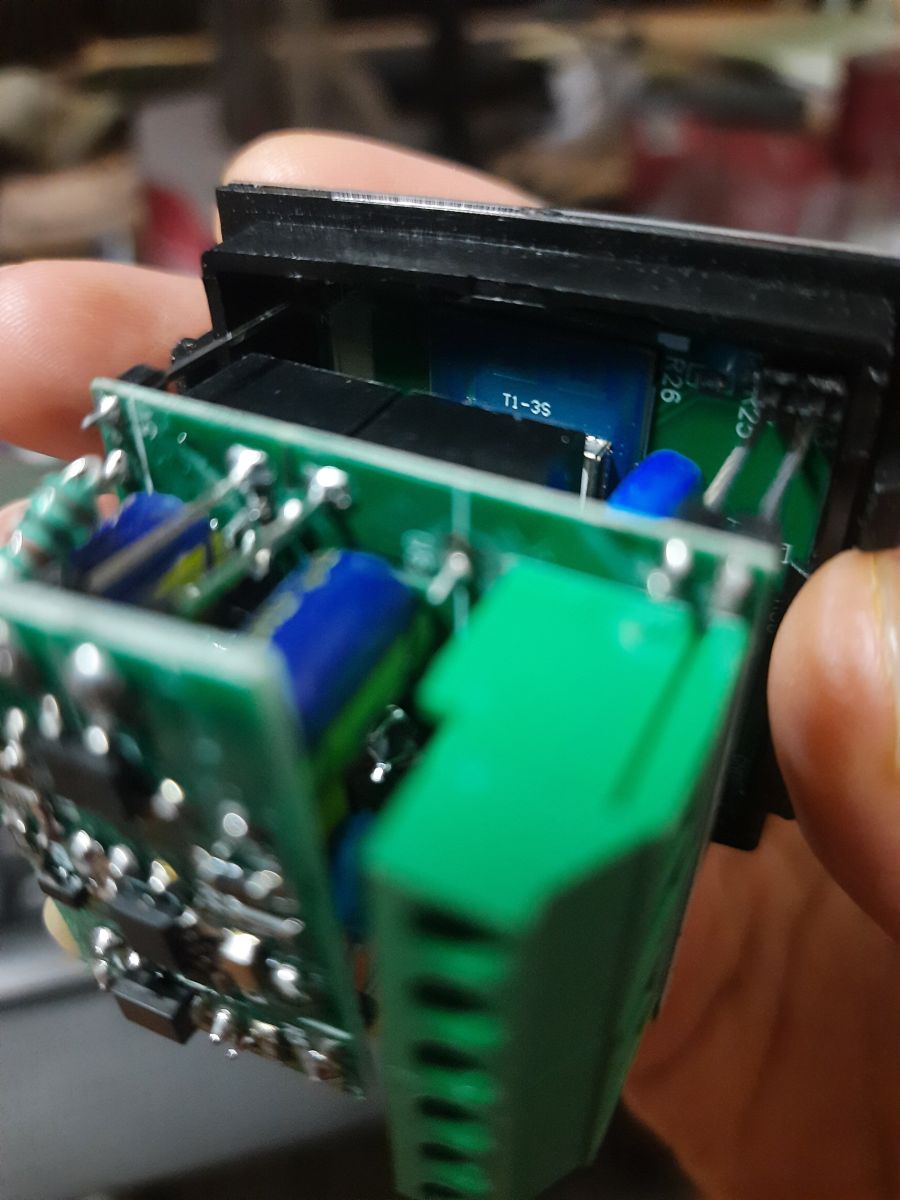

    I would like to share a teardown and configuration for the latest version of the HomeMate 4-Gang Touch Switch. There is an existing topic for this device here, but that version utilized the CB3S chip.
    Units produced recently (after Dec 2025) have replaced the chip with the T1-3S (BK7238). While the physical enclosure and PCB layout remain identical, the pin definitions have changed.
    new t1-3s chip
    Close-up of electronic module with visible components and green terminal block

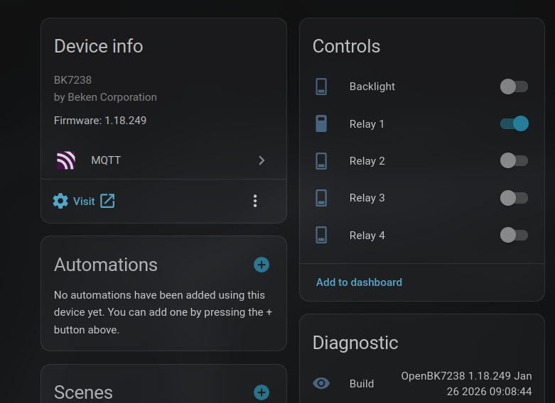

    HA Screenshot
    BK7238 device control panel with Relay 1 switched on

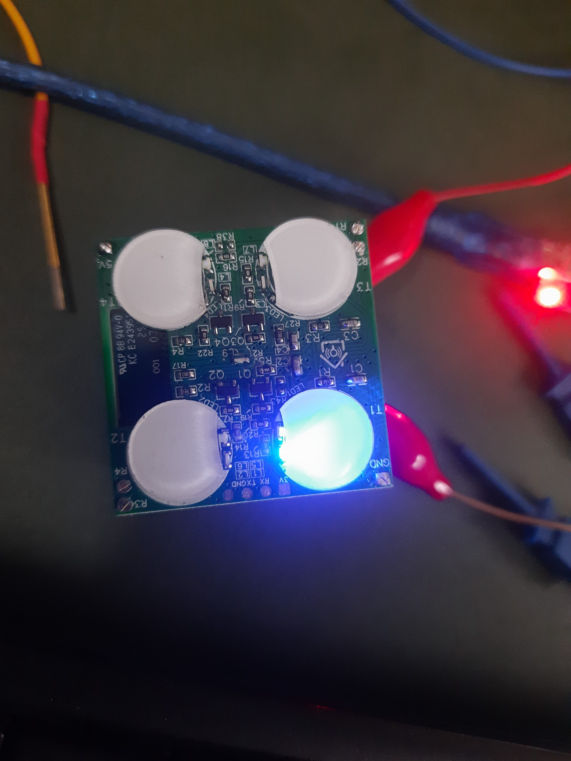

    Close-up of a PCB with four white capacitive touch sensors and a glowing blue LED.
    The "Tri-State" Backlight Feature:
    Like many ESPHome users, I find the default backlight too bright for bedrooms. By using OpenBeken scripting, I have implemented a tri-state logic for the relay pins:
    Relay ON: LED is active (High).
    Relay OFF + Backlight ON: Pin is Output Low (LED glows).
    Relay OFF + Backlight OFF: Pin is set to High-Impedance (Input), turning the LED completely off for sleep.

    This script has been working perfectly. The OnPress events make the switch feel just as responsive as the original firmware, and the ability to kill the backlight entirely via a long-press (or Home Assistant automation) is a great upgrade.
    If anyone has suggestions for further optimizing the addChangeHandler logic, please let me know!
