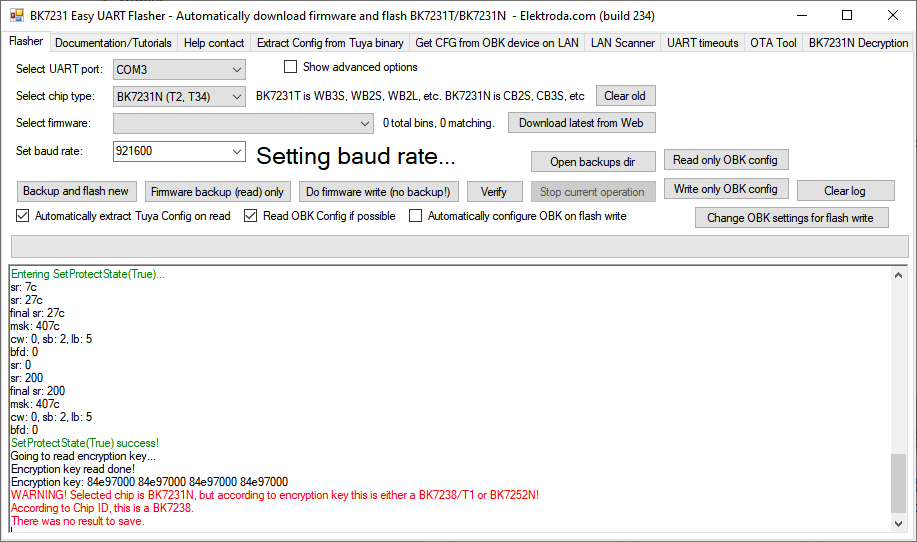

    I have a small water leak sensor from AliExpress that I would like to re-flash with OpenBeken. It is branded as a Tuya device. Inside there is a T1 U HL chip which seems to correspond to a BK7238. I have a UART attached and am running BK7231Flasher.exe using mono under Linux. Communication seems to work at 921,600 baud without any glitches.
    I copied the stock firmware but the Flasher app could not detect any Tuya configuration information. I installed OpenBK7238_QIU_1.18.248.bin. Just poking around the circuit I came to these conclusions:

  • Restoring backup with correct BK7231 settings fixed boot
    #3 21824060
    afaik4711
    Hey,
    I am also a beginner to OBK, but had similar problems as you. I thought my CB3S was a BK7238 when the chip was actually a BK7231. The flasher did a backup and write successfully, but after that, nothing happened.
    To resolve my issue, I restored the backup using the BK7238 settings and then starting over with BK7231 settings. After a reboot (RX/TX disconnected), the device powered up. I hope it helps
