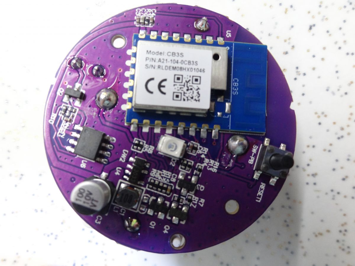

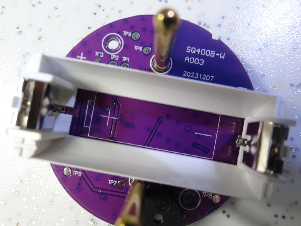

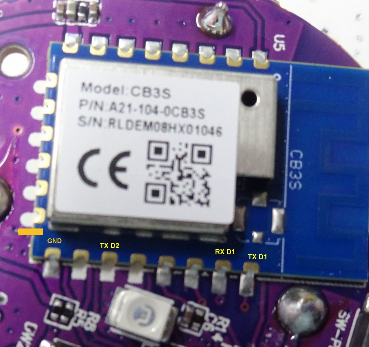

    Did anyone yet come across the Tuya Wifi Water Sensor DY-SQ400B?
    It has a CR123A 3V-battery and a CB3S Com-Board:
    Close-up of the interior part of the Tuya Wifi Water Sensor DY-SQ400B with CB3S board. Top view of the Tuya Wifi Water Sensor DY-SQ400B circuit board with CB3S module. White Tuya Wifi water sensor DY-SQ400B with three views: top, side, and bottom.
    • Tuya Water Sensor WiFi DY-SQ400B Flashing, Configuration for OBK Esphome/Tasmota style firmware Tuya Wifi Watersensor.JPG (8.35 KB) You must be logged in to download this attachment.
  • #2 21068872
    Posts: 5222
    Help: 449
    Rate: 918
    I have not. Have you opened it up? what module/chip?
  • #3 21069018
    io2345
    Posts: 273
    Rate: 7
    CB3S Board. Pictures now in the first thread

    Looks like TuyaMCU device:
    Electronic board with CB3S module and component markings
    Please do TuyaMCU capture to confirm:
    https://www.elektroda.com/rtvforum/topic3970199.html#20528459
    See also generic TuyaMCU tutorial:
    https://www.elektroda.com/rtvforum/topic4038151.html
  • #5 21069430
    io2345
    Posts: 273
    Rate: 7

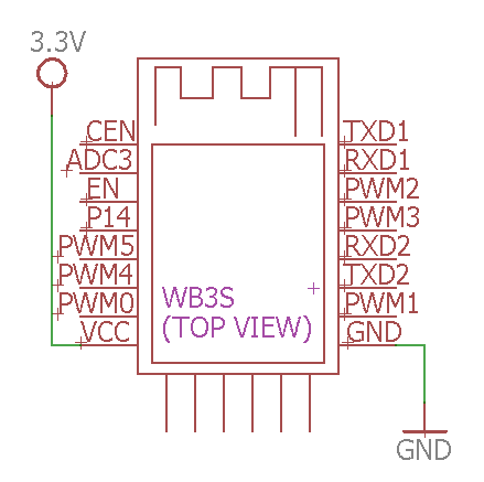

    Alright, I'll try that. Seems to be quite easy with battery powered modules.
    As I am still a beginner, please, could anyone confirm, that these are the Pins, that I have to connect to UART?
    What about TX2, does that have to be connected somewhere? Or only TX1 ?
    Close-up of CB3S electronic module with visible pins labeled GND, TX D2, RX D1, TX D1.
  • #6 21069433
    Posts: 14781
    Rate: 12920
    Both flashing and TuyaMCU are using UART1, so you need to check TXD1 and RXD1:
    Pin schematic of the WB3S module showing connections to UART1.
    Both WB3S and CB3S have UART1 on the same pins.
  • #7 21069440

    >>21069433
    Thanks for clearing things with Pinout. I mistakenly did put GND pin position on the photo on the wrong place "around the corner" ;-)
    EDIT: Fixed photo in above thread #5, so nobody get's confused

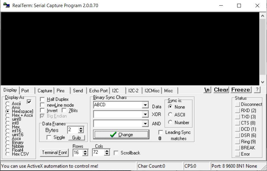

    #12 21069867
    io2345
    Posts: 273
    Rate: 7

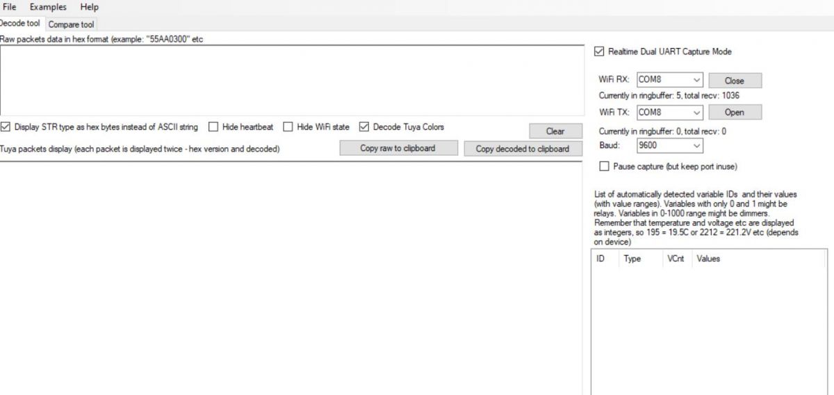

    RealTerm program interface for serial data capture. Screenshot of a program for analyzing UART packets, showing the interface for capturing data. >>21069228
    Tried that, but no luck. So, maybe I did something wrong, or there is no MCU-communication.
    I tried with UART RX, TX -> Chip RX, TX and with crossed lines as well. Nothing on TX1 and only crap on TX2 (which I guess isn't even connected - see "captures.zip").
    First I tried to capture with "Tuya MCU Explorer / Analyzer", then with "RealTerm".
    I think it is very possible, that there is no MCU-communication, as there is not really much of functionality on the board: Only a hardware button, a buzzer and the two sensor contacts.
    • captures.zip (4.38 KB) You must be logged in to download this attachment.

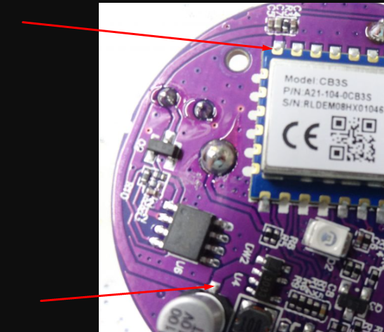

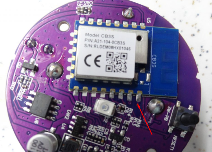

    #14 21069910
    Posts: 14781
    Rate: 12920
    I still think it's TuyaMCU, either at 9600 baud or at 115200. Let's check something else, but still related.
    Make sure that batteries are inserted.
    When batteries are inserted, is there 3.3V directly on the WiFi module (between WiFI module GND and 3.3V)?
    I am asking because TuyaMCU devices are often controlling WiFi module power via transistor so WiFI module is off most of the time.
    second question - take off batteries, is the continuity between those two points?
    Purple circuit board with WiFi module model CB3S labeled.
    Maybe it's not MCU, after all...
    Also, still without batteries, where TXD1 and RXD1 go? Check with multimeter. Do they connect to SOIC8 chip?
  • #15 21070005
    io2345
    Posts: 273
    Rate: 7
    There is always power between GND and V+ on the CB3S unit (measuring with multimeter for four minutes).
    There is direct connection between V+ of the CB3S and the buffer capacitor.
    Tx and Rx on the CB3S unit are not connected to the U6 chip.
  • #16 21070016
    Posts: 14781
    Rate: 12920
    So this is not a TuyaMCU device. Can you try doing 2MB firmware read with our tool?
