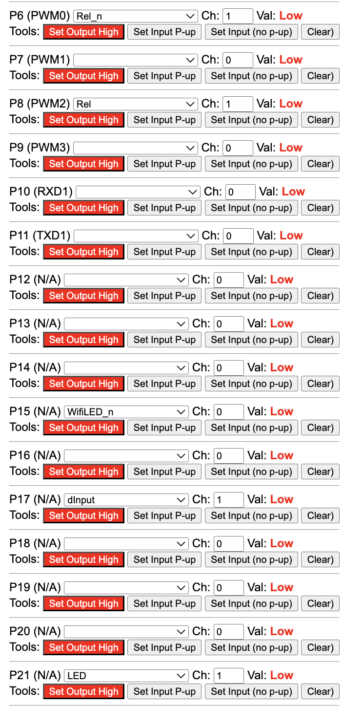

    Hi,
    Got this smart circuit breaker from Ali and flashed it with OpenBeken. The Easyflash extracted config and wrote it.
    https://de.aliexpress.com/item/1005009843409337.html
    Switching the relay works from the web, but the problem I have is the button. The button should toggle the relay on/off. As it is configured as "Btn" from the original config, it does not do anything, but gives me tons of
    Info:GEN:17 Button_OnLongPressHold
    in the log. I tried all the other options, but basically none of the other config options work; the only things that work are "dInput" and "ToggleChanOnTgl", but it does not do what it is supposed to do. Pressing it toggles, but releasing it toggles it back...
    Any help appreciated.

    This is how it looks like after a restart, configured as input:
    Screenshot of a GPIO interface with pins set as input and output configurations

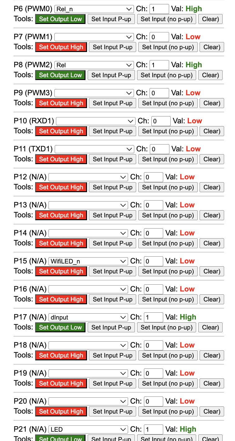

    Here's how it looks pressing the button:
    GPIO configuration interface showing 16 pins all in Low logic state.
    Toggles, but toggles back on release.

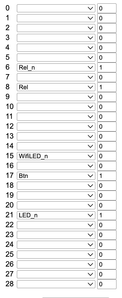

  • #4 21821037
    insmod
    Posts: 1397
    Help: 164
    Rate: 436
    If dInput works, then Btn should work too...
    If it spams Button_OnLongPressHold, then replace Btn with Btn_n.
  • #5 21821038
    belveder79
    Posts: 15
    >>21821037 does not help.
    Added after 1 minute:
    >>21821038 - it does not spam, but it also does not work :-(.
  • #6 21831453
    Posts: 5065
    Help: 438
    Rate: 893
    there was a bug introduced in version 1.18.248. Please try 1.18.256+
  • #7 21832734
    belveder79
    Posts: 15
    >>21831453 Upgraded to 256, still spams LOG with long button press, but works perfectly - thanks a lot.
    Added after 7 minutes:
    >>21832734 Using btn and led_i works to make it work the way it should
    Screenshot of a pin mapping table 0–28 with dropdowns and 0/1 values
