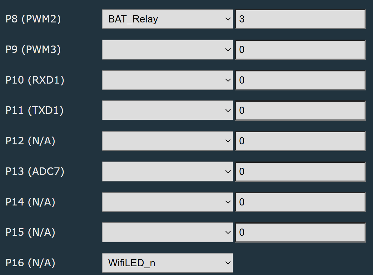

    tahunasky
    Level 4  
    Posts: 11
    >>21828523
    Hi, Thanks for the reply...
    So I added "flags": "13", in template/config - I guess that's what you mean.
    This is what it says for pin 14 and removed "14": "Btn_n;4;0",
    Table assigning functions to pins P8–P16, showing BAT_Relay and WifiLED_n selected
  • Pin 14 state and template configuration shown

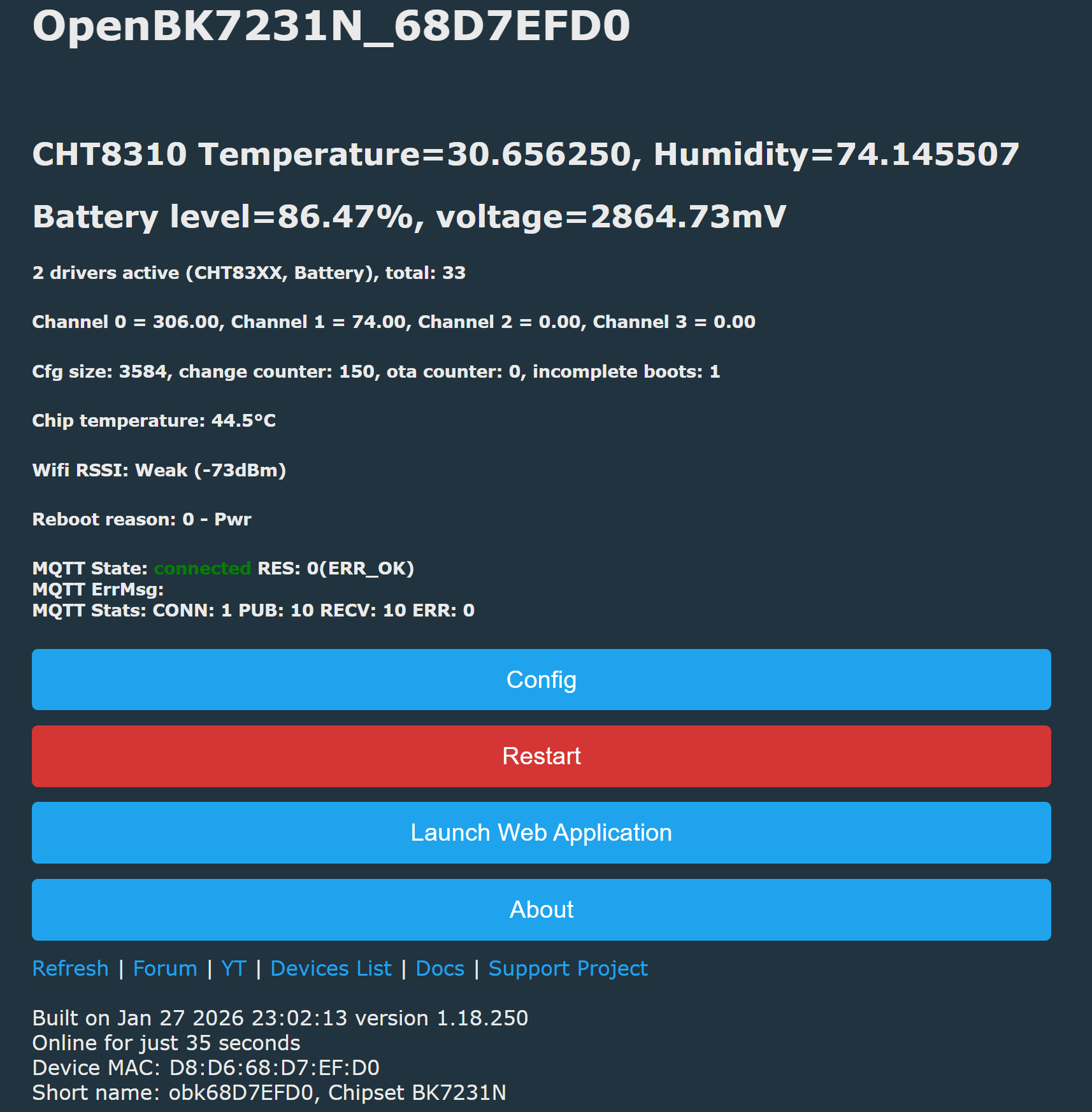

    tahunasky
    Level 4  
    Posts: 11
    >>21828531
    This is pin state.
    OpenBK7231N status screen showing CHT8310 readings, battery level, MQTT state, and control buttons
    Maybe I did something wrong... this is the template as is shown in webapp

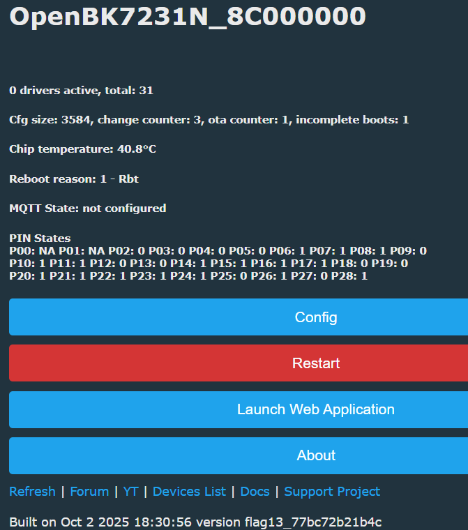

    from main gui -> config menu -> Configure General/Flags -> tick "Flag 13 - [HTTP] Show actual PIN logic level for unconfigured pins" -> Submit
  • #7 21828546
    tahunasky
    Level 4  
    Posts: 11
    >>21828542
    PIN 14: 1 is what it shows.
  • #8 21828547
    Posts: 5220
    Help: 449
    Rate: 918
    but also, the original template has IO14 as
    I don't know if that's correct, but it doesn't seem like it's a normal button
    Added after 44 [seconds]:
    >>21828546
    and does it change to 0 when you push the button? does it change back to 1 when you release the button?
