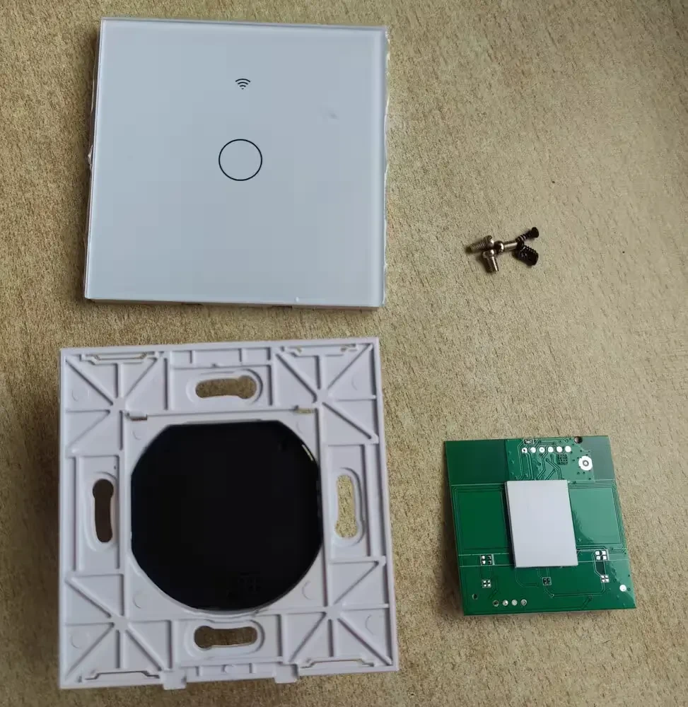

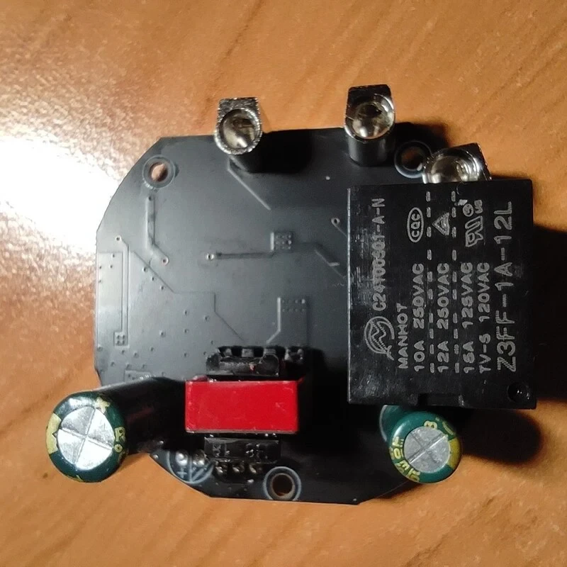

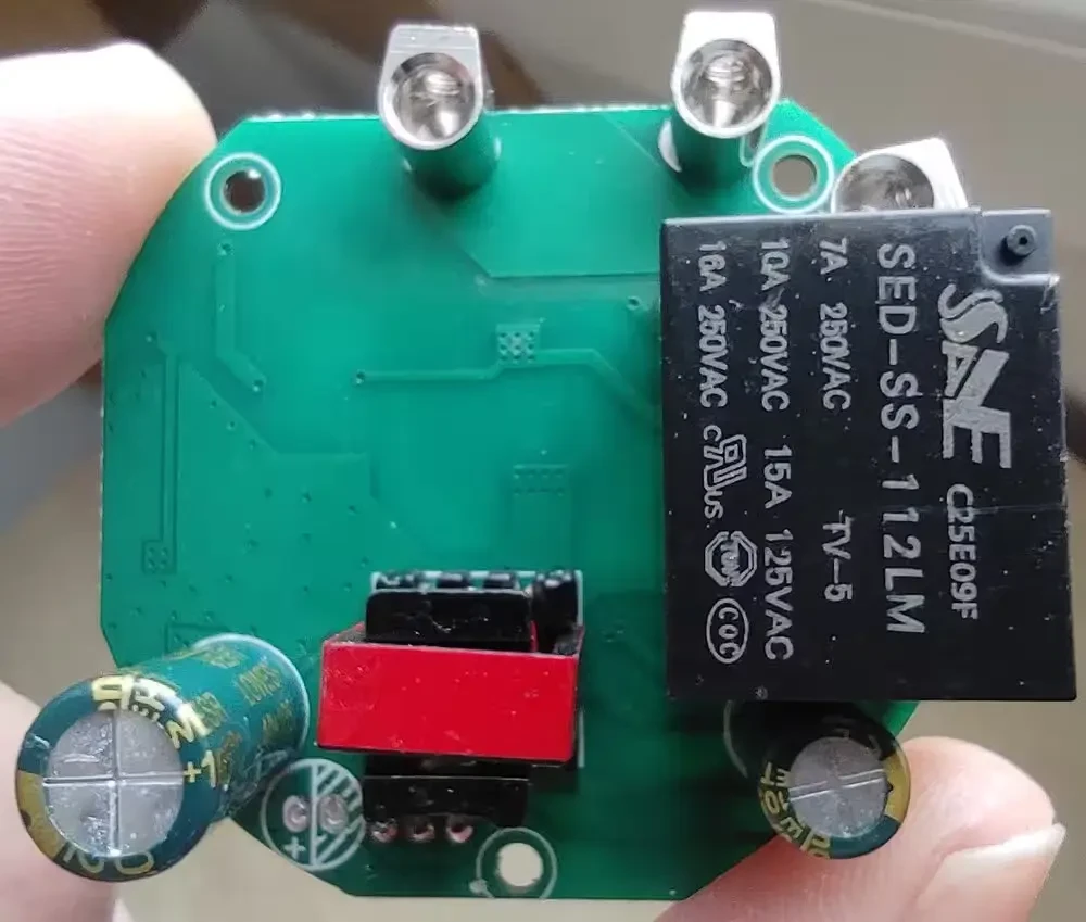

    I bought several pieces of Tuya Smart WiFi Light Switch Touch Panel Wall Switch from
    https://www.aliexpress.com/item/1005006903350922.html
    (mix of 1 gang and 2 gang)

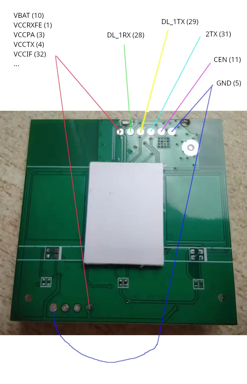

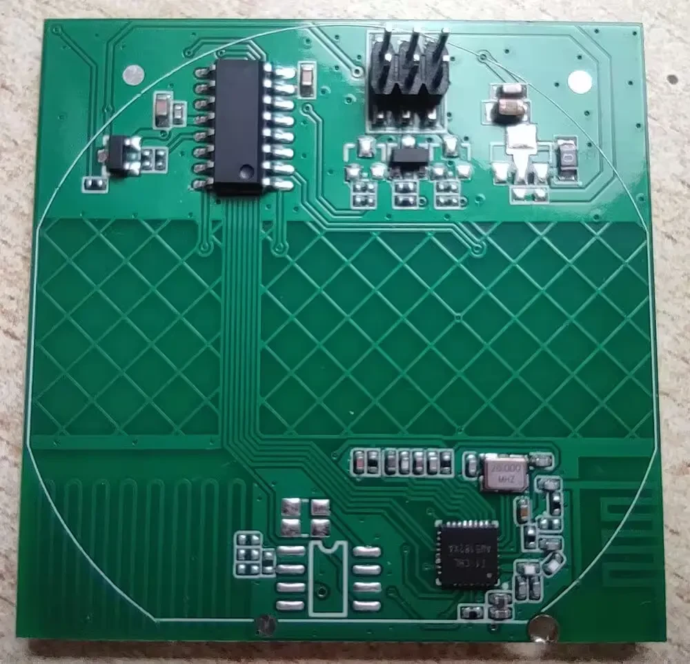

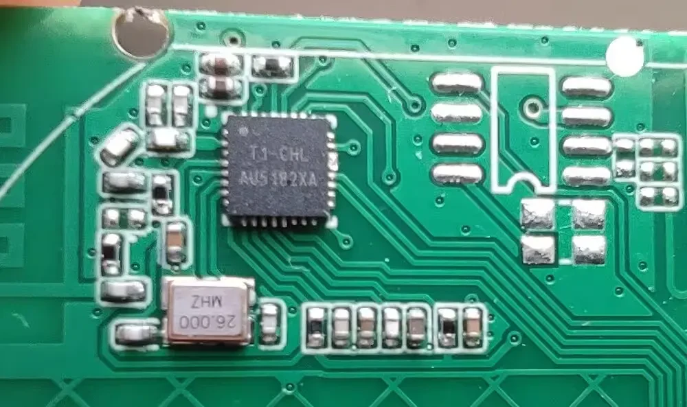

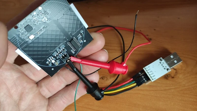

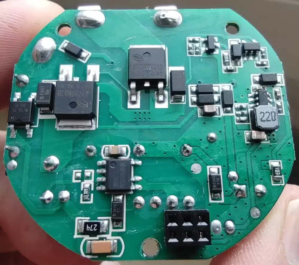

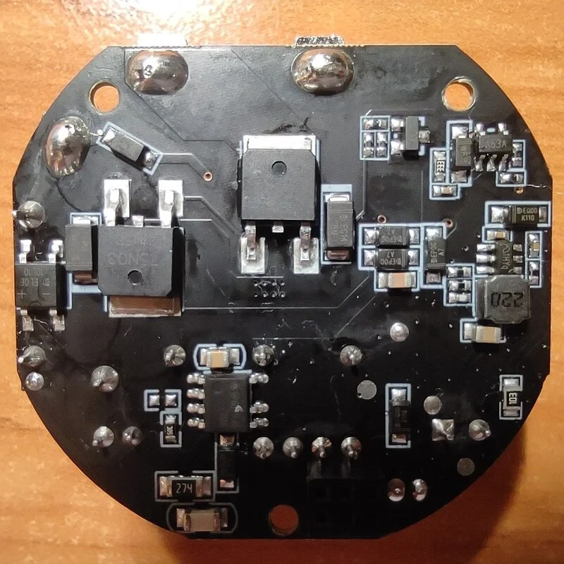

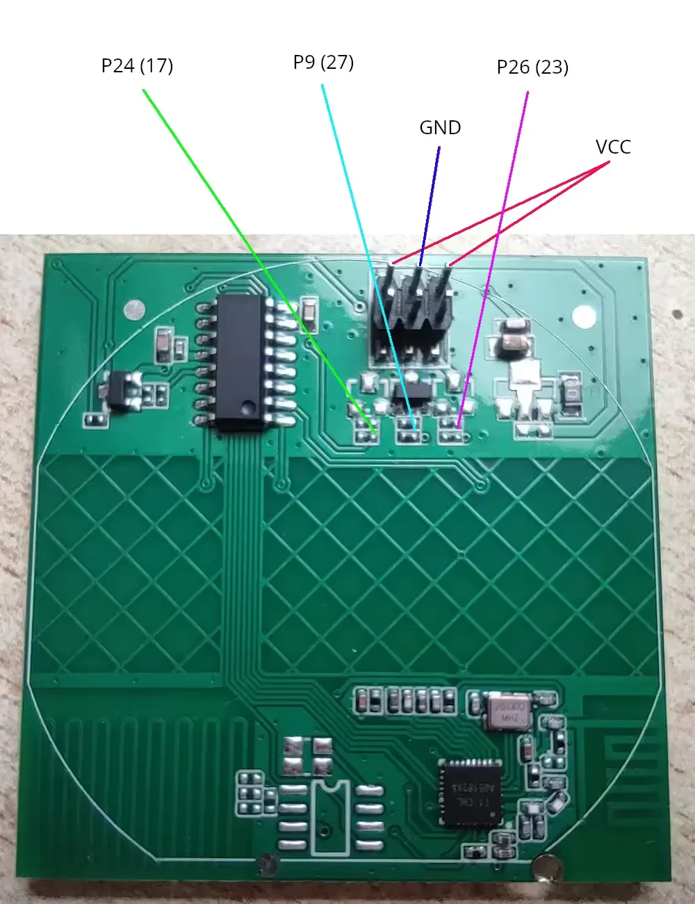

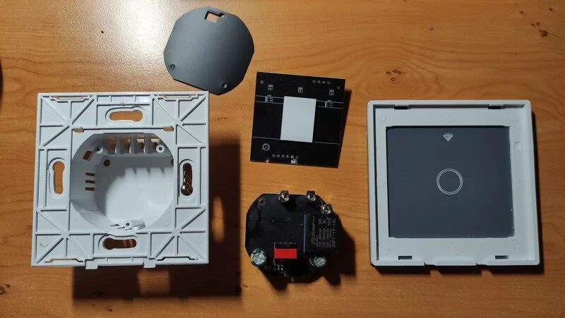

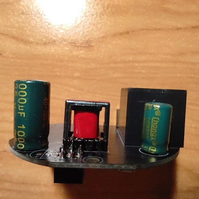

    It contains BK7238 and I have successfully flashed OpenBK7238_QIO_1.18.287.bin through UART on these. The first two items I ordered had a green PCB, the items in the second order have a black mask on the PCB.
    Tuya Smart WiFi Touch Wall Switch BK7238 1/2 gang Tuya Smart WiFi Touch Wall Switch BK7238 1/2 gang Tuya Smart WiFi Touch Wall Switch BK7238 1/2 gang Tuya Smart WiFi Touch Wall Switch BK7238 1/2 gang Tuya Smart WiFi Touch Wall Switch BK7238 1/2 gang Tuya Smart WiFi Touch Wall Switch BK7238 1/2 gang Tuya Smart WiFi Touch Wall Switch BK7238 1/2 gang

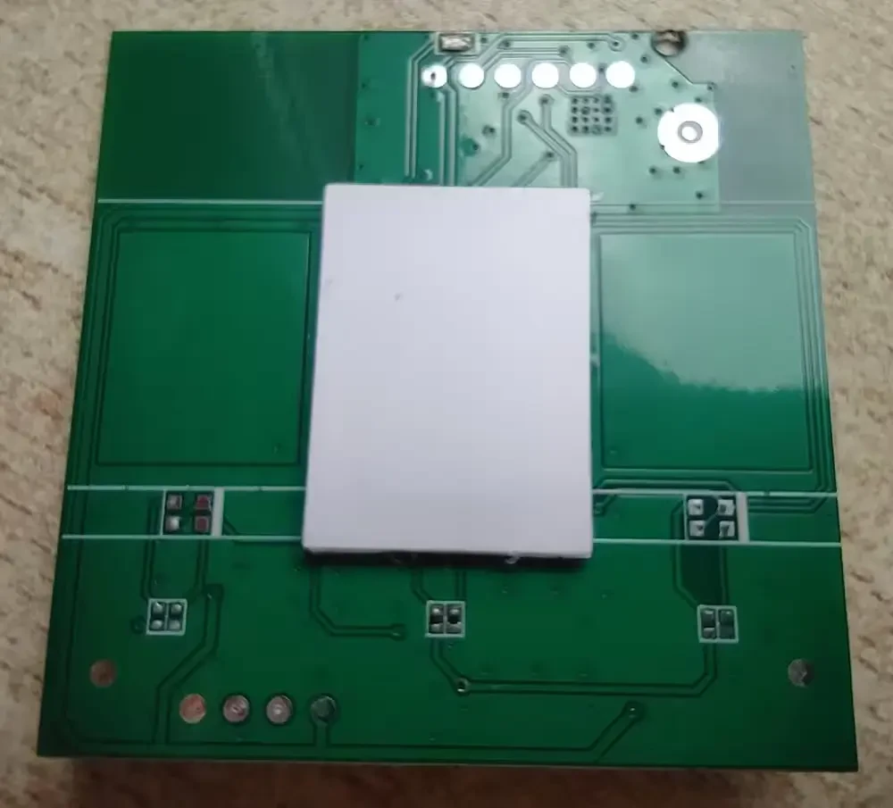

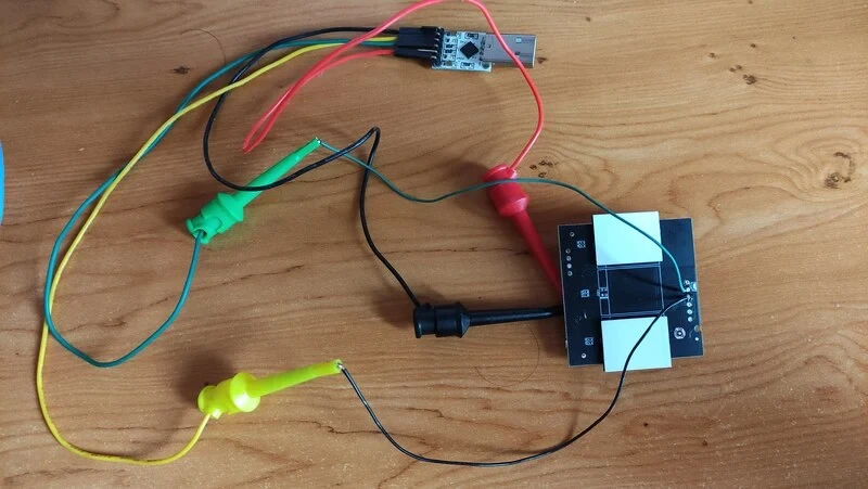

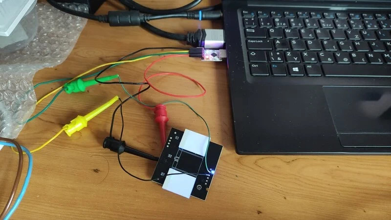

    To flash the device, two wires need to be soldered at least. It works for me to power the MCU part from a TTL UART converter. I had to set bigger UART timeouts to write to flash. I increased the default value from 5 to 15. The easyflasher was run on Linux using Mono. It works like a charm! :)

    Unfortunately there is no model number or other key like serial or so. On the back side, there is the label "WIFI Wall Light Switch" and technical values like 100-240 V AC. The PCBs have different colors (green/black), but I think they are the same layout.

    I did backups. Yesterday I did in 4 steps
    1. backup original factory fw
    2. move RF partition (according to instructions from log of previous step)
    3. write OpenBK
    4. write OBK config
    I left one 1-gang and one 2-gang switch with original firmware for a while. (attached extracted OBK config and description from easyflasher - it worked as is)
