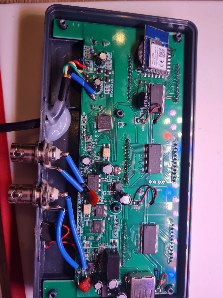

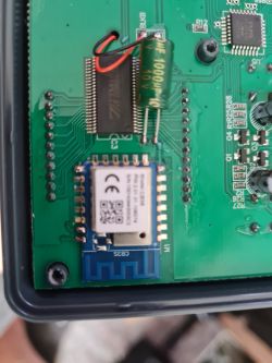

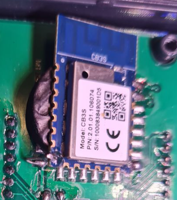

    I bought this device through Ali

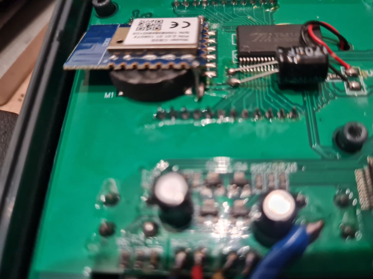

    A CB3S chip is installed but a little different than what I know
    I'm not sure how to proceed with this device

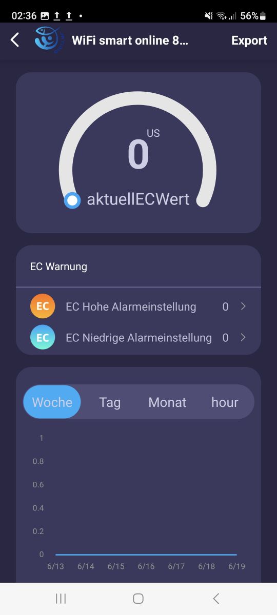

    Water parameter measurement device with display and smartphone.
    Measurement device set with CB3S chip from AliExpress in packaging.
    Ali
    https://de.aliexpress.com/item/10050050508917...t_main.47.48145c5fva8llF&gatewayAdapt=glo2deu

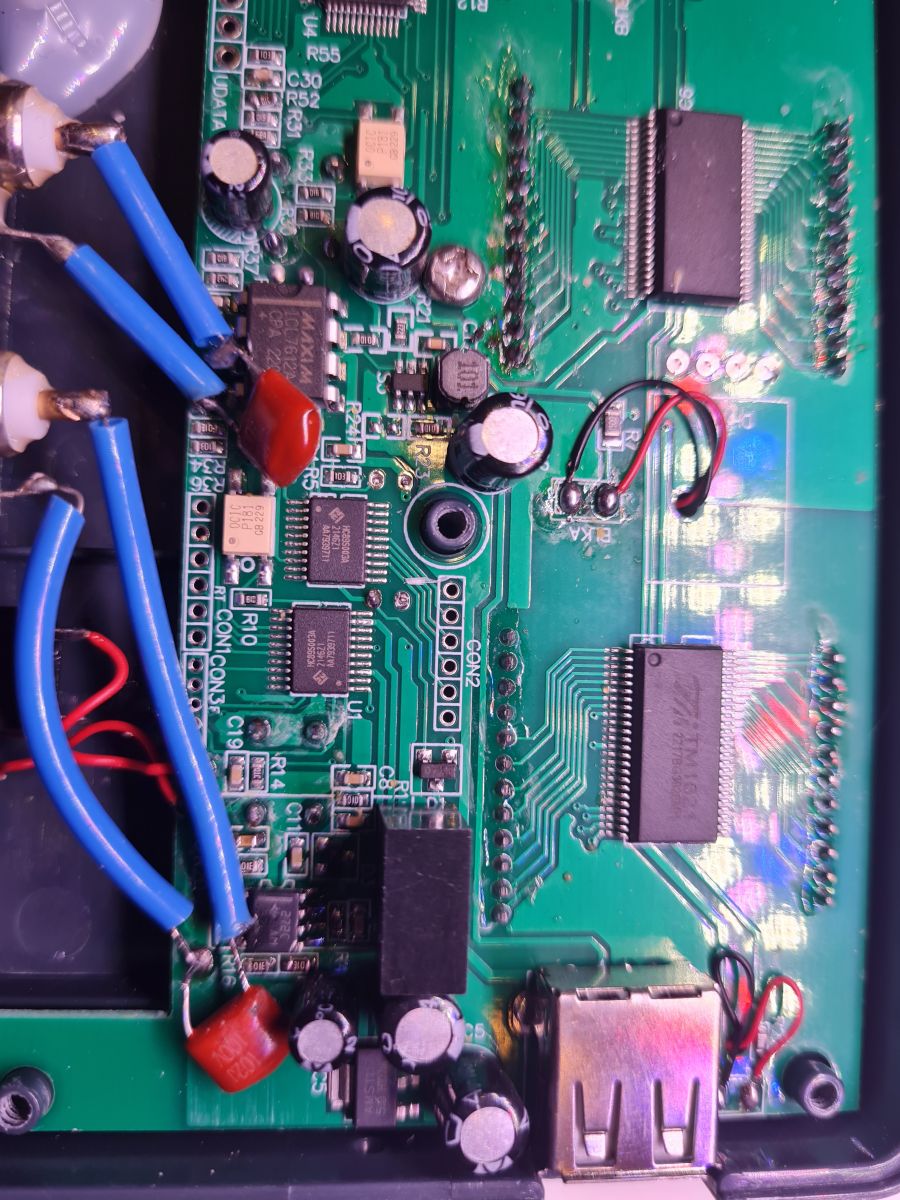

    Close-up of a circuit board with visible electronic components such as capacitors, integrated circuits, and wires. PCB with installed CB3S chip. Photo of the inside of an electronic device with visible circuit board and wires.
    Close-up of a circuit board with CB3S chip and electronic components. App monitoring temperature, pH, and TDS with a temperature of 25°C Screenshot of a temperature monitoring app with a 25°C reading, temperature alarms, and additional parameters like EC and salinity. App screen displaying temperature graph and alarm settings. Screenshot of an app displaying a pH level of 7.91 and a weekly pH trend graph. WiFi Smart online app on a mobile device showing TDS values and alarm settings. App interface for monitoring electrical conductivity (EC) with a current reading of 0 µS. WiFi smart online device app screen displaying salinity value of 0 ppm. Screenshot of a smart system's share value monitoring app. WiFi Smart Online app screen showing ORP value -1364 mV and a trend graph. App screen displaying CF measurement at 0 with alarm settings. App displaying current temperature of 25°C with a temperature graph. App screen for WiFi smart online 8 in 1 tester showing various settings and notifications options.

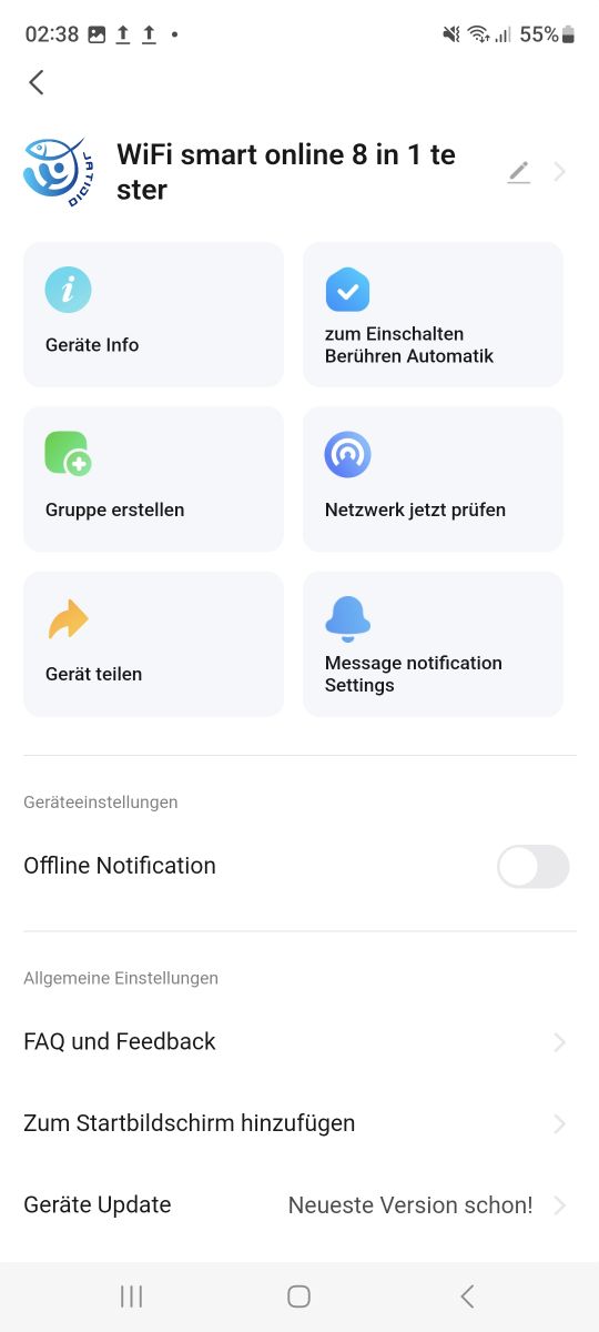

    dpIDs
    Code: Arduino
    Standard Status Set
    Code: Arduino
    Query Things Data Model
    Code: Arduino

    At the first glance it looks like TuyaMCU device. Have you tried the basic TuyaMCU steps from our guide?
    https://www.elektroda.com/rtvforum/topic4038151.html
    Please check out the guide I linked to get some basic info, then I can help futher with supporting your device.

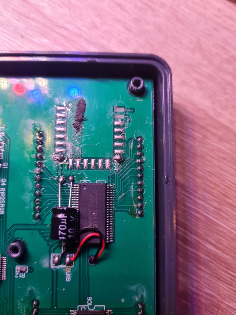

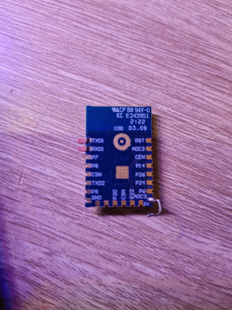

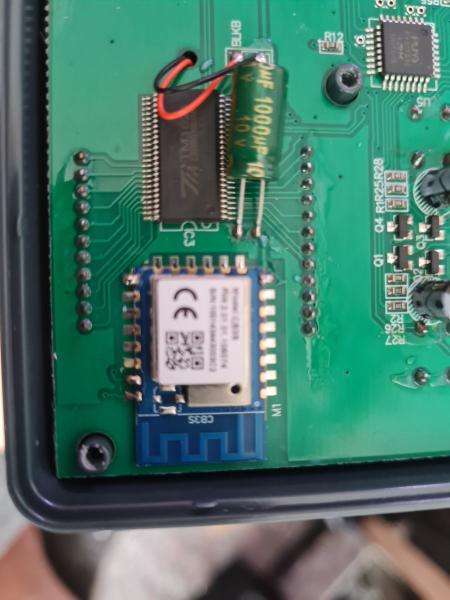

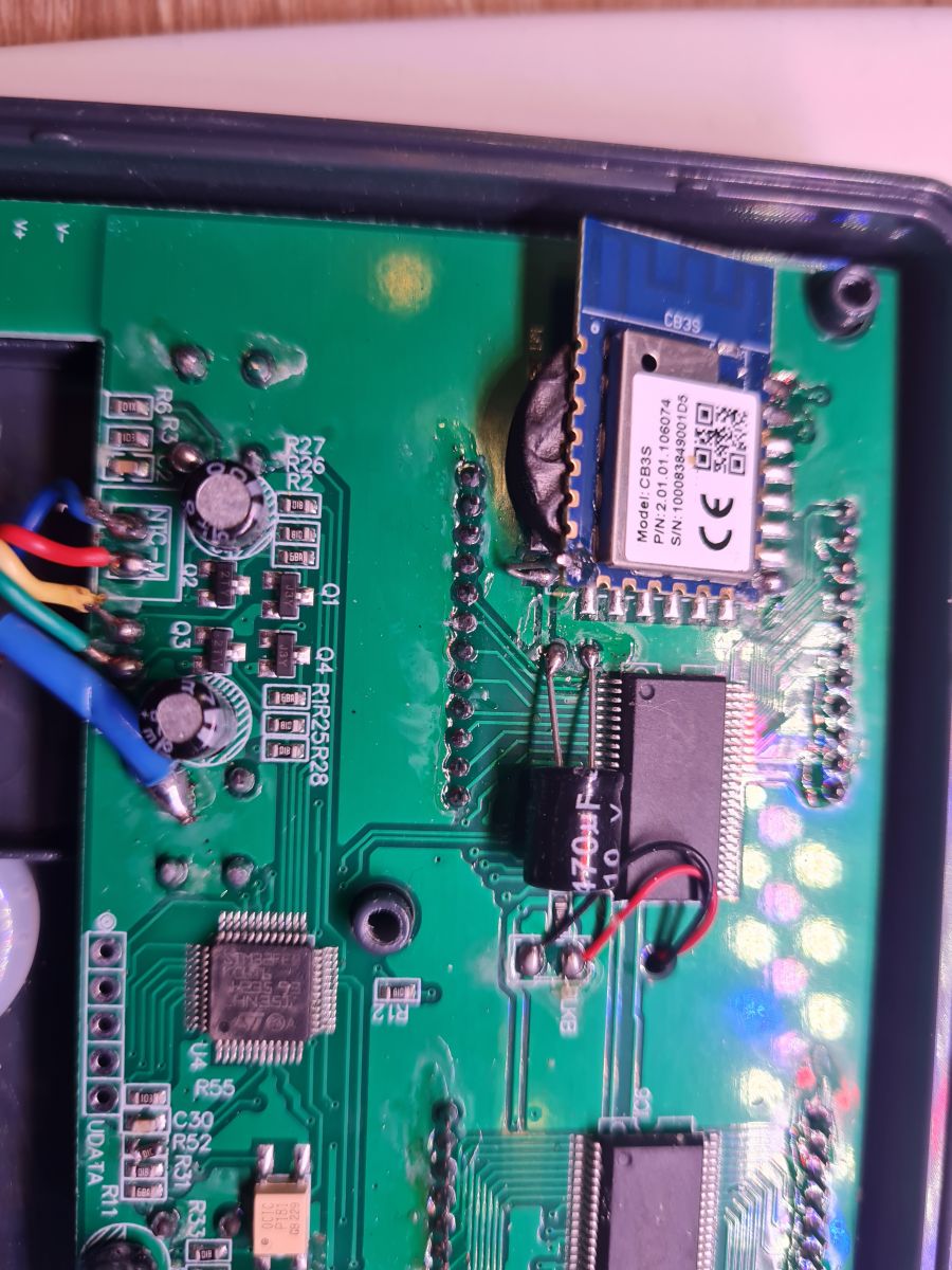

    Unfortunately something happened to me, the CB3 came off, you can save something like that
    The image shows a close-up of a circuit board with visible electronic components. One component, labeled CB3, is damaged or missing. Electronic module with a broken-off CB3 component on a wooden table.
  • Suggesting pad repair and continuity checks on CB3S board
    #4 21124407
    Posts: 5216
    Help: 448
    Rate: 917
    wow. it came from the factory soldered at this angle?
    CB3S module soldered at an unusual angle on a green PCB.
    if you've only torn these two pads
    Close-up of a damaged PCB with visible TXD1, RXD1, and P7 pads.
    then it looks like you could reveal the remaining copper and bridge the CB3S contact to whatever is left
    Image of a PCB with visible damaged pads marked in yellow.
    although, maybe it looks like some of the copper trace is lifted too?
    if it was me I would reveal the remaining copper from those two torn pads on the PCB then see if there's still continuity to wherever they go
    is this a factory 3V3 drop to the PCB?
    Soldered electronic component on a blue PCB with a protruding wire.
    also, what does the boot log on CB3S and factory fw look like?

  • #6 21124642
    Posts: 14767
    Rate: 12907
    Did you try to desolder CB3S or was it really that way when it came?
    You need to either reuse the remaining traces (scrap the soldermask) to reconnect TX1/RX1 or find where they go to make jumpers...
  • #7 21125308
    Nordlicht77
    Posts: 67
    It happened when I wanted to attach the pogo pins and when I pressed it, it broke away.
    I find it strange that it came that way from the factory.
    The pins
    Close-up of a circuit board with broken pins highlighted in yellow.

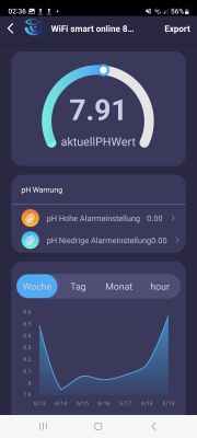

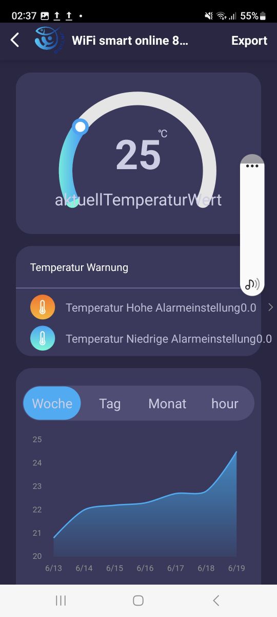

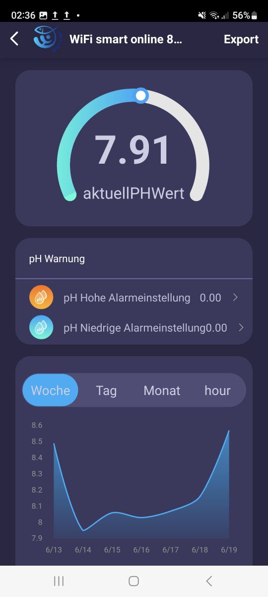

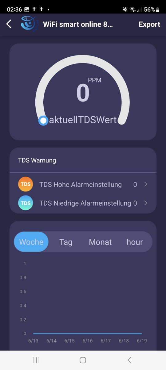

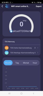

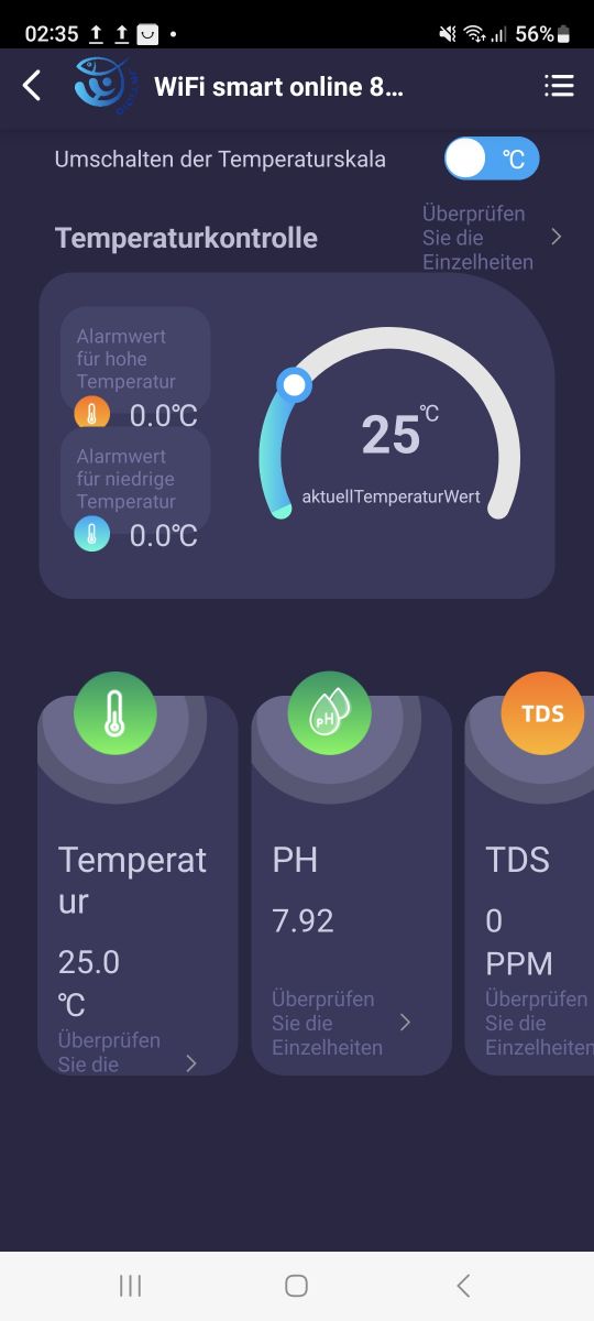

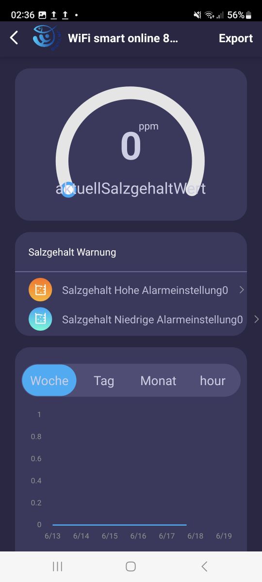

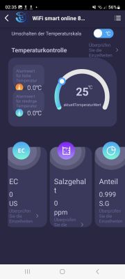

    I was now able to find and set up the WiFi point
    Unfortunately the problem is again with the same Mac
    Now I need help with the config

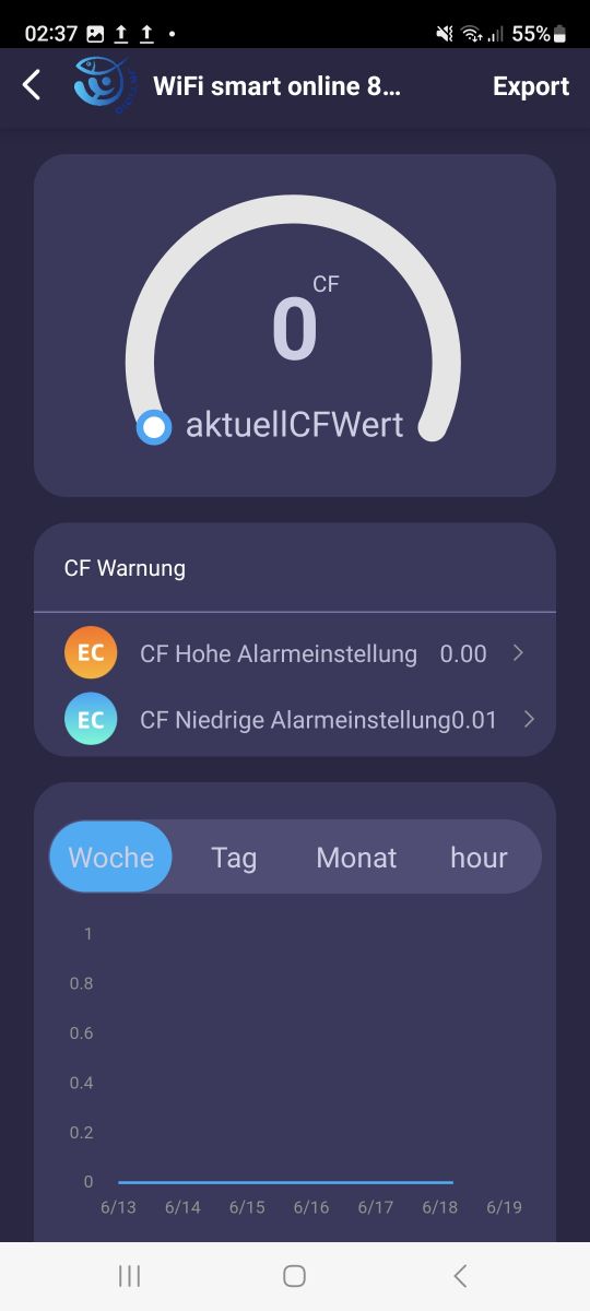

    Hinzugefügt nach 2 [Stunden] 43 [Minuten]:
    I'm a little further
    But now I still have a formatting problem
    I have it set about how it looks now and how it should look
    You can send the alarm values ​​to MCU and save them
    startDriver NTP
    startDriver TuyaMCU
    startDriver tmSensor
    ntp_setServer 172.20.48.1
    ntp_timeZoneOfs 2
    tuyaMcu_defWiFiState 4
    setChannelType 1 temperature_div10
    linkTuyaMCUOutputToChannel 8 val 1
    setChannelType 2 temperature_div10
    setChannelLabel 2 "High temperature alarm value"
    linkTuyaMCUOutputToChannel 102 val 2
    setChannelType 3 temperature_div10
    setChannelLabel 3 "Low temperature alarm value"
    linkTuyaMCUOutputToChannel 103 val 3

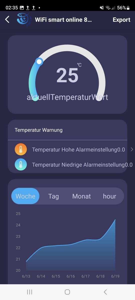

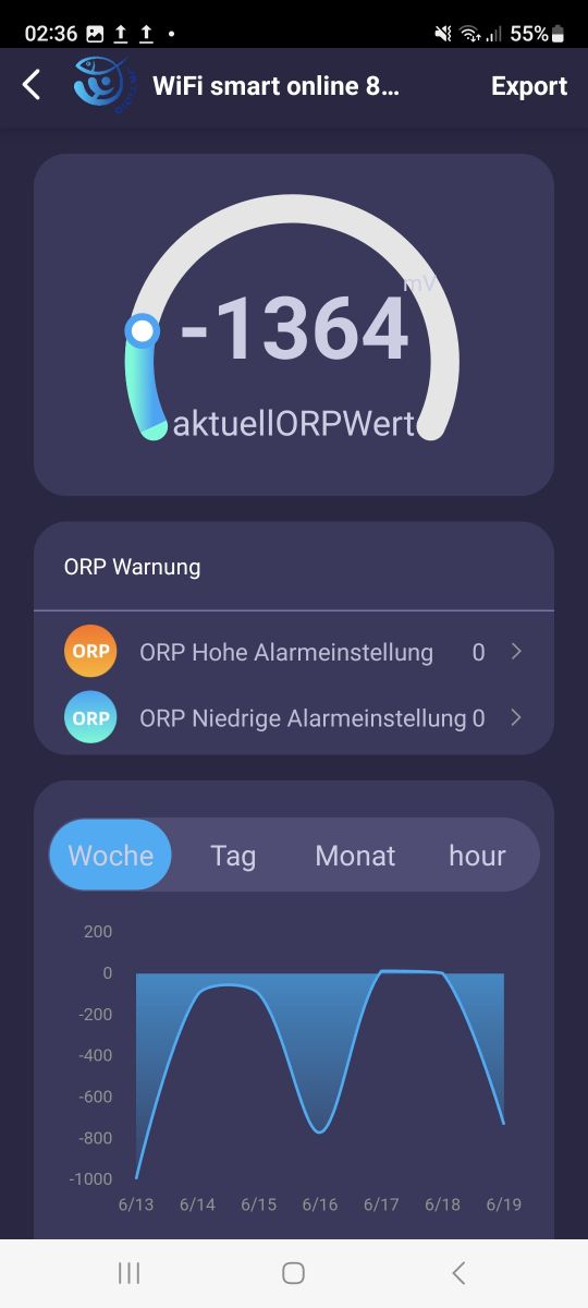

    //currently :  Temperature 389.0C (PH Aktuell)
    //correct :  3.89 PH (PH Aktuell)
    setChannelType 4  temperature
    setChannelLabel 4 "PH Aktuell"
    linkTuyaMCUOutputToChannel 106 val 4
    setChannelType 5  temperature_div10
    setChannelLabel 5 "Warning pH value higher than set"
    linkTuyaMCUOutputToChannel 107 val 5
    setChannelType 6  temperature_div10
    setChannelLabel 6 "Warning pH value lower than set"
    linkTuyaMCUOutputToChannel 108 val 6
    //currently :  Temperature 3150.0C (TDS value)
    //correct :  03.14 TDS  (TDS value)
    setChannelType 7  temperature
    setChannelLabel 7 "TDS value"
    linkTuyaMCUOutputToChannel 111 bool 7
    setChannelType 8  temperature_div10
    setChannelLabel 8 "Warning TDS value higher than set"
    linkTuyaMCUOutputToChannel 112 val 8
    setChannelType 9  temperature_div10
    setChannelLabel 9 "Warning TDS  value lower than set"
    linkTuyaMCUOutputToChannel 113 val 8
    //currently :  Temperature 626.00C (EC value)
    //correct :  6260 EC (EC value)
    setChannelType 10  temperature_div10
    setChannelLabel 10 "EC value"
    linkTuyaMCUOutputToChannel 116 val 10
    setChannelType 11  temperature_div10
    setChannelLabel 11 "EC high alarm value"
    linkTuyaMCUOutputToChannel 117 val 11
    setChannelType 12  temperature_div10
    setChannelLabel 12 "EC low alarm value"
    linkTuyaMCUOutputToChannel 118 val 12

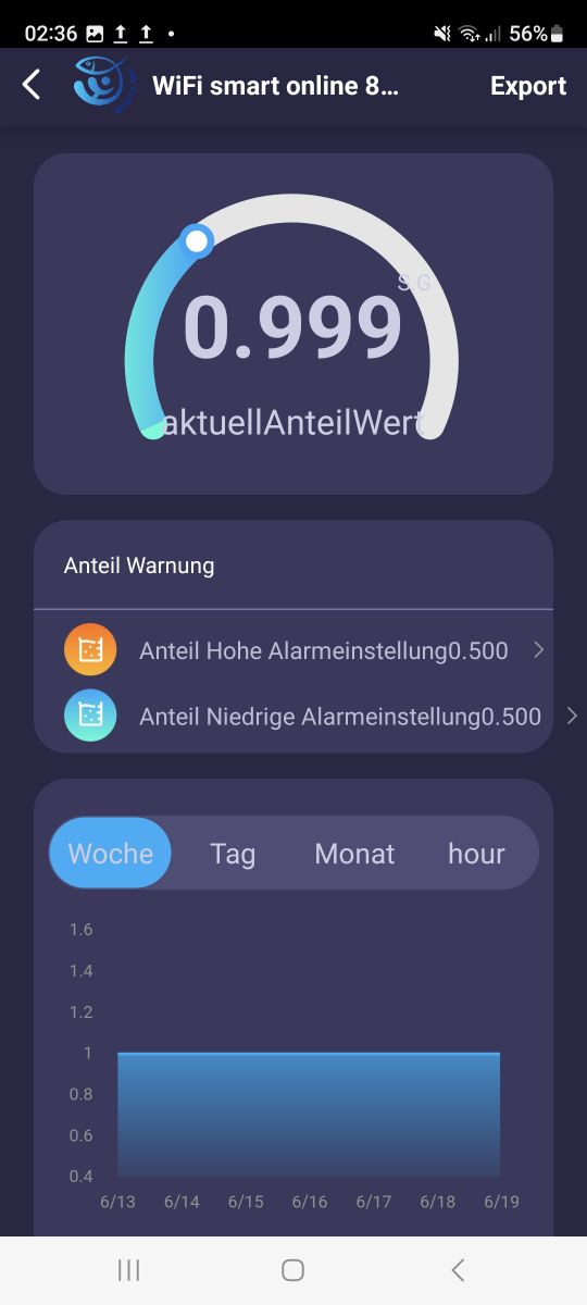

    //currently : Temperature 360.00C (Salinity value)
    //correct :  36000 SALT (Salinity value)
    setChannelType 13  temperature_div10
    setChannelLabel 13 "Salinity value"
    linkTuyaMCUOutputToChannel 121 val 13
    setChannelType 14  temperature_div10
    setChannelLabel 14 "High salinity alarm value"
    linkTuyaMCUOutputToChannel 122 val 14
    setChannelType 15  temperature_div10
    setChannelLabel 15 "Low salinity alarm value"
    linkTuyaMCUOutputToChannel 123 val 15
    //currently : Temperature 100.00C (Proportion value)
    //correct :  100.00 (Proportion value)
    setChannelType 16  temperature_div10
    setChannelLabel 16 "Proportion value"
    linkTuyaMCUOutputToChannel 126 val 16
    setChannelType 17  temperature_div10
    setChannelLabel 17 "Proportion high alarm value"
    linkTuyaMCUOutputToChannel 127 val 17
    setChannelType 18  temperature_div10
    setChannelLabel 18 "Proportion low alarm value"
    linkTuyaMCUOutputToChannel 128 val 18
    //currently : Temperature  -29.29C (ORP value)
    //correct : 291 ORB
    setChannelType 19  temperature_div10
    setChannelLabel 19 "ORP value"
    linkTuyaMCUOutputToChannel 131 val 19
    setChannelType 20  temperature_div10
    setChannelLabel 20 "ORP high alarm value"
    linkTuyaMCUOutputToChannel 132 val 20
    setChannelType 21  temperature_div10
    setChannelLabel 21 "ORP low alarm value"
    linkTuyaMCUOutputToChannel 133 val 21
    //currently :  Temperature 611.00C (CF value)
    //correct :  061.0 CF
    setChannelType 22  temperature_div10
    setChannelLabel 22 "CF value"
    linkTuyaMCUOutputToChannel 136 val 22
    setChannelType 23  temperature_div10
    setChannelLabel 23 "CF high alarm value"
    linkTuyaMCUOutputToChannel 137 val 23
    setChannelType 24  temperature_div10
    setChannelLabel 24 "CF low alarm value"
    linkTuyaMCUOutputToChannel 138 val 24
    setChannelType 25  temperature_div10
    setChannelLabel 25 "??? value"
    linkTuyaMCUOutputToChannel 141 val 25

  • Working TuyaMCU script for PH, TDS, ORP, EC and salinity
    #19 21549543
    zebcrs
    >>21546266
    I have tinkered for a bit here and this code is working for me now.
    The only problem I have is that the autoexec is very limited in size. This script is at the max limit now.
    startDriver TuyaMCU
    setChannelLabel 1 "Water temp"
    setChannelType 1 Temperature
    addRepeatingEvent 15 -1 publishFloat temperatur $CH1/10 0 2
    setChannelType 2  Ph
    setChannelLabel 2 "PH Aktuel"
    setChannelType 2 PH_Value
    linkTuyaMCUOutputToChannel 106 val 2
    addRepeatingEvent 15 -1 publishFloat ph $CH2/100 0 2
    setChannelType 3  Tds
    setChannelLabel 3 "TDS val"
    setChannelType 3 TDS_Value
    linkTuyaMCUOutputToChannel 111 bool 3
    addRepeatingEvent 15 -1 publishFloat tds $CH3 0 2
    setChannelType 4  Orp
    setChannelLabel 4 "ORP val"
    linkTuyaMCUOutputToChannel 131 val 4
    addRepeatingEvent 15 -1 publishFloat orp $CH4 0 0
    setChannelType 5  Ec
    setChannelLabel 5 "Ec_current"
    linkTuyaMCUOutputToChannel 116 bool 5
    addRepeatingEvent 15 -1 publishFloat Ec $CH5 0 2
    setChannelType 6  Sal
    setChannelLabel 6 "salinity_current"
    setChannelType 6 Salt Level
    linkTuyaMCUOutputToChannel 121 bool 6
    addRepeatingEvent 15 -1 publishFloat Sal $CH6 0 0
    setChannelType 7  Pc
    setChannelLabel 7 "pro_current"
    linkTuyaMCUOutputToChannel 126 bool 7
    addRepeatingEvent 15 -1 publishFloat Pc $CH7 0 2
    setChannelType 8 Cf
    setChannelLabel 8 "cf_current"
    linkTuyaMCUOutputToChannel 126 bool 8
    addRepeatingEvent 15 -1 publishFloat Cf $CH8 0 2
    setChannelType 9 Rh
    setChannelLabel 9 "rh_current"
    setChannelType 9 Humidity
    linkTuyaMCUOutputToChannel 141 bool 9
    addRepeatingEvent 15 -1 publishFloat Rh $CH9 0 2
    tuyaMcu_sendQueryState
    delay_s 120
    again:
    delay_s 15

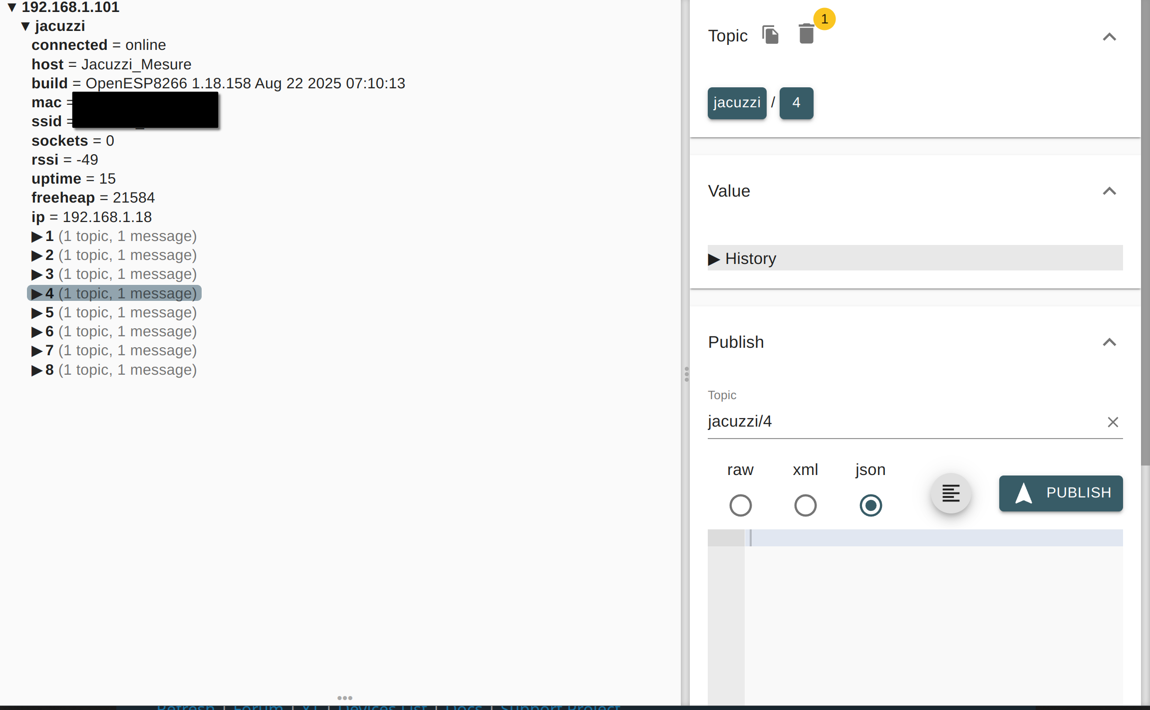

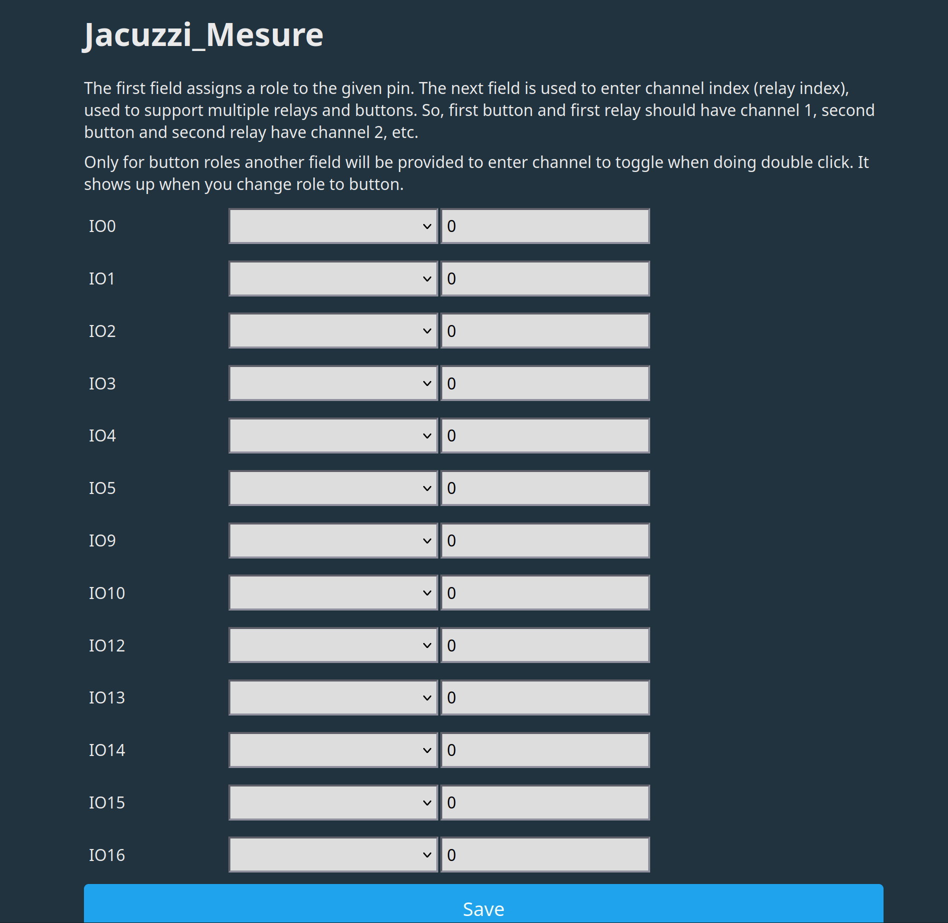

    I've been unsuccessful flashing the C3BS and probably fried/bricked it on the way.
    I replaced the module with an ESP-12S ESP8266 and successfully flashed OpenBeken.
    I also configured wifi and mqtt, but all the channels/metrics stay to 0,
    despite the 3 little screens of the device displaying values.
    I wonder if the pin setting must be set ?
    OpenBeken interface showing sensor channels with 0.00 values and MQTT state as connected
    GPIO pin configuration table in OpenBeken with no roles or channels assigned.

    Also, the channel labels in autoexec.bat dont seem to pass to MQTT ?
    MQTT panel showing jacuzzi device with domain and zero-value channels
    What did I do wrong ?
