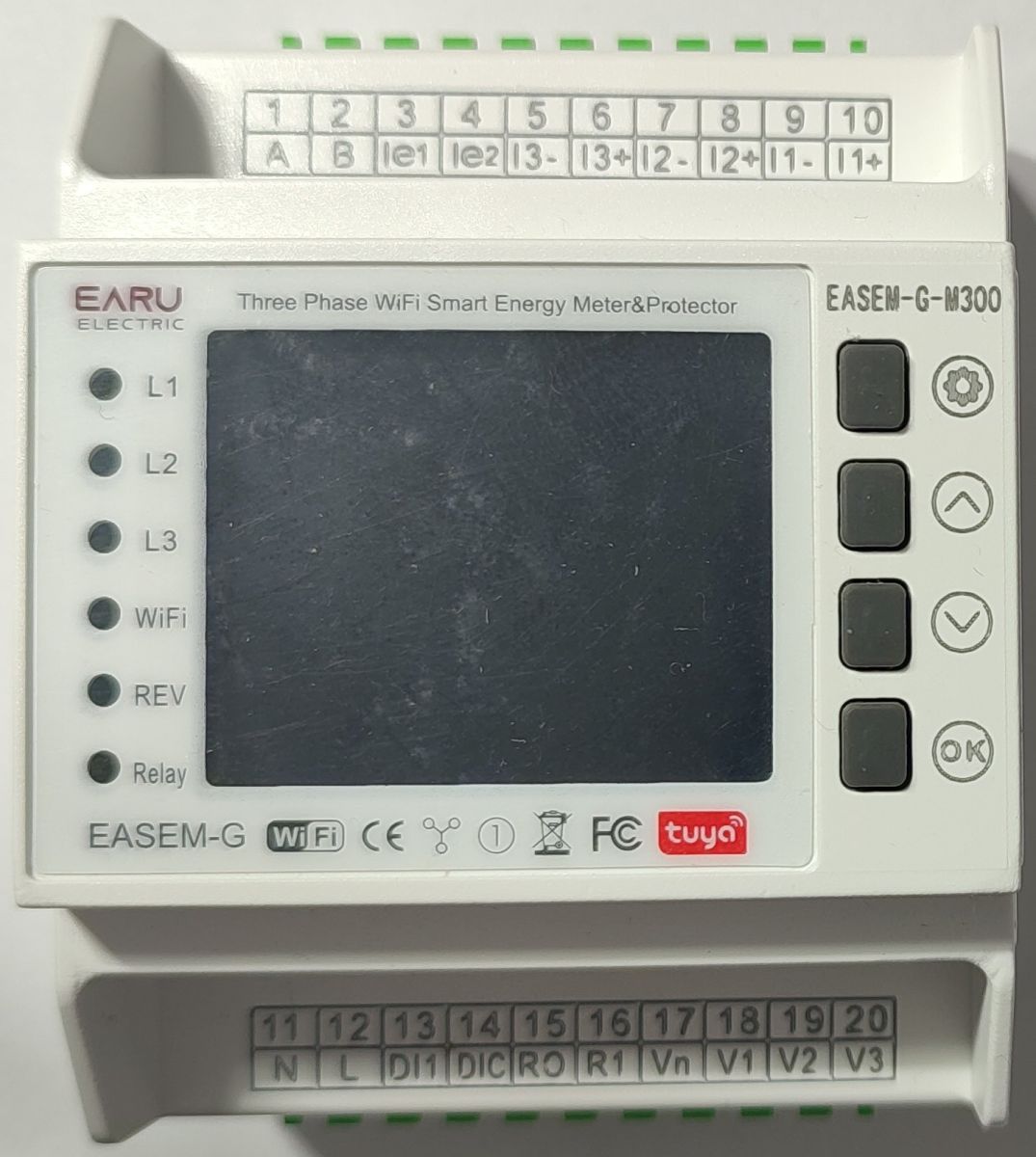

    Front of the unit:
    Three-phase WiFi energy meter with display and navigation buttons
    Easy to open, just 4 clips on the sides

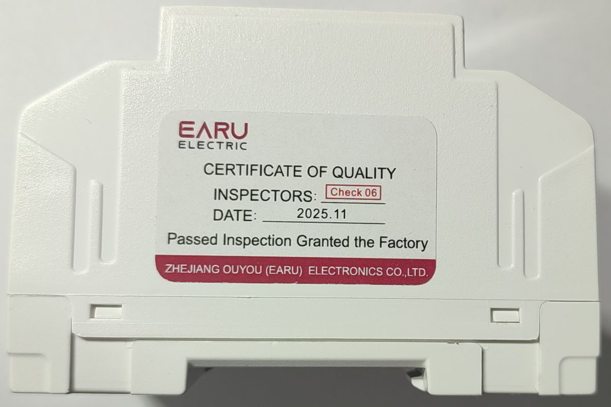

    Plastic device with quality certificate label from EARU ELECTRIC

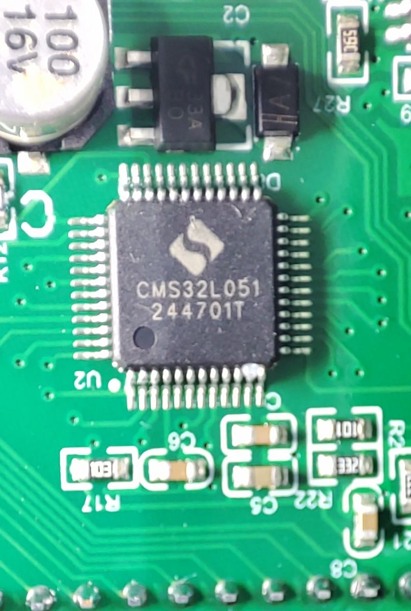

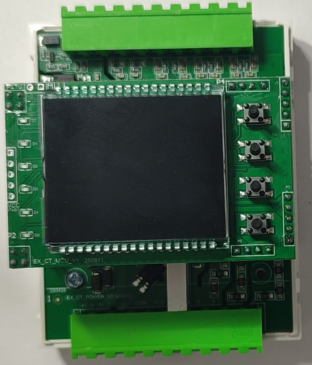

    Inside the unit, notice the JTAG labelled connector on the left. It goes to the  CMS32L051 "Tuya MCU", so it seems that it would be pretty hackable
    if someone wanted to replace the Tuya firmware.

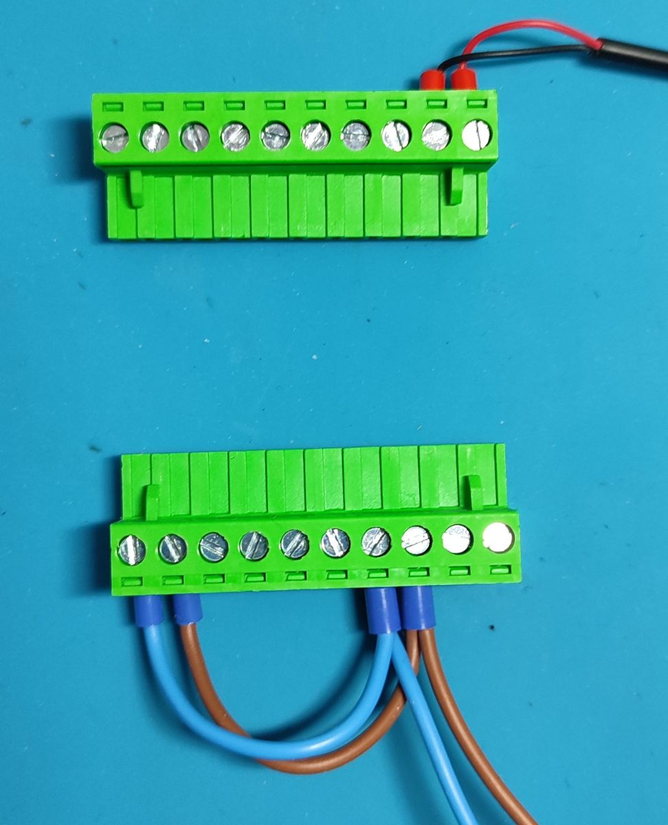

    It uses pluggable terminal blocks which is nice if you have to replace/open the device without disturbing the wiring.
    Green screw terminal blocks with brown and blue wires on a blue background

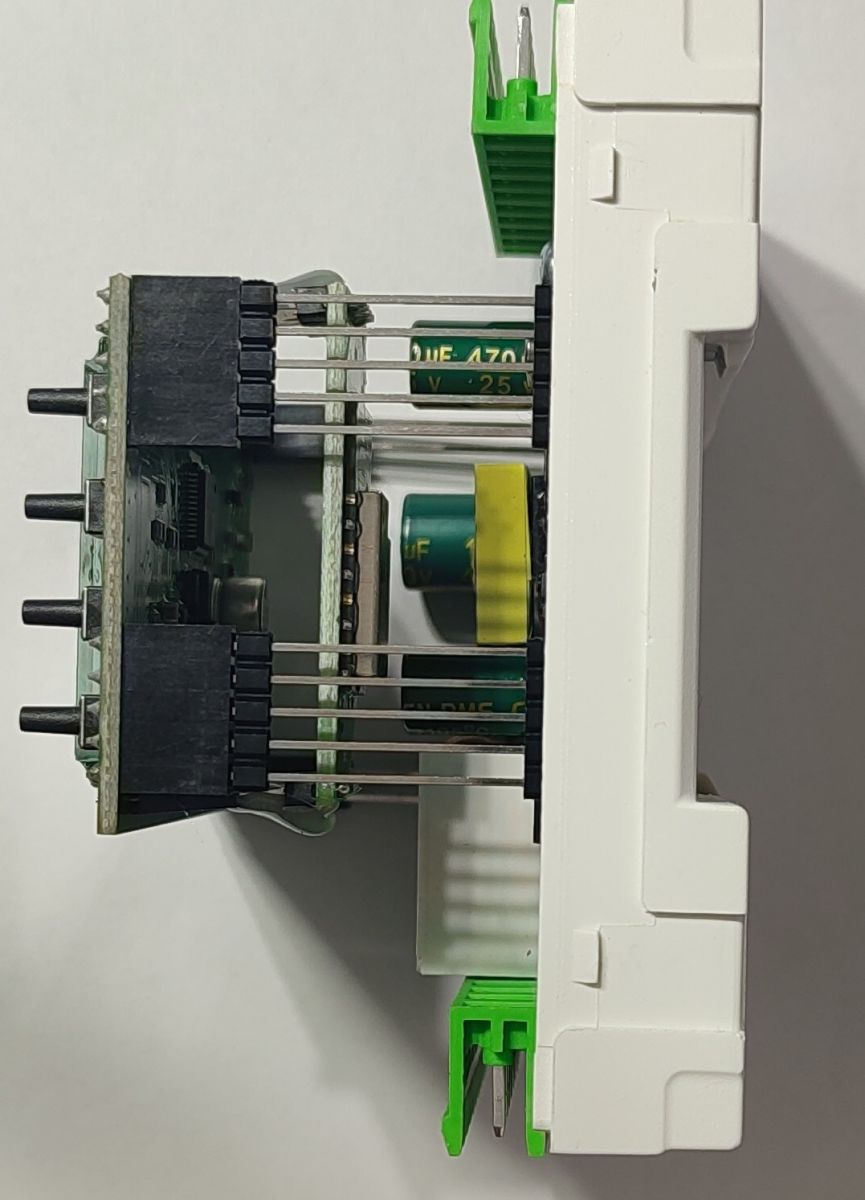

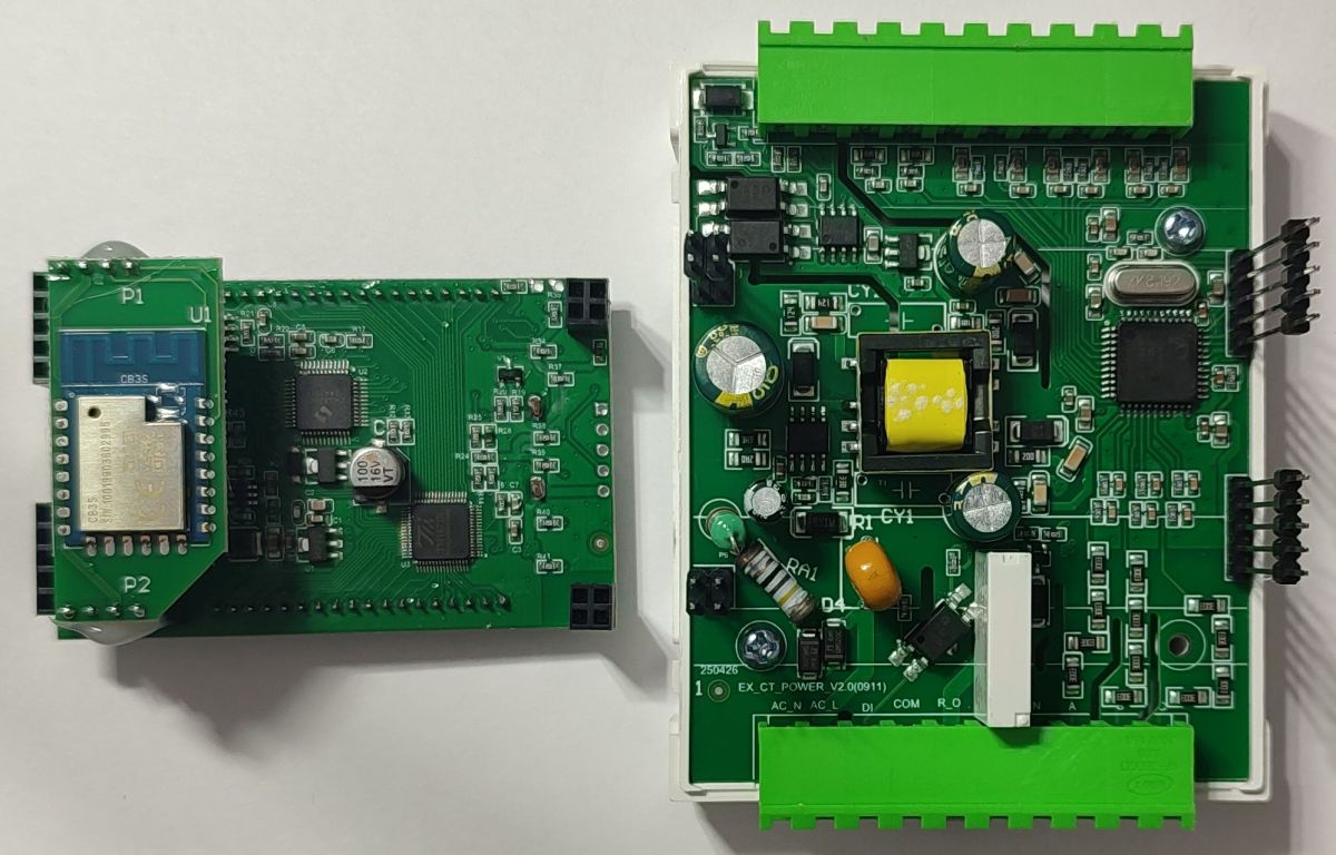

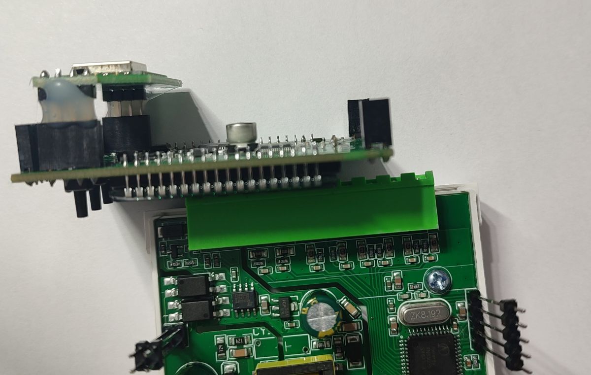

    The board with the screen, TuyaMCU and the CB3S module is easily separated from the base unit that holds the power section, metering chip, RS485 chip etc:
    Side view of electronic module with PCBs, capacitors and pin connectorsClose-up of a PCB with electronic components and pin headers Two printed circuit boards with electronic components and connectors

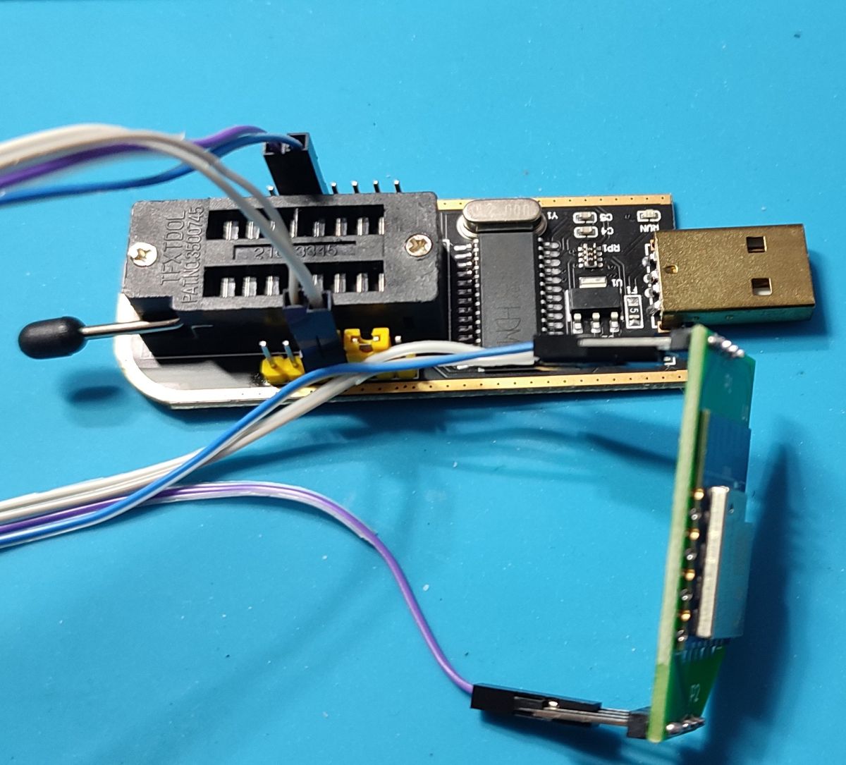

    CB3S module is also easy to separate (douse the hot glue blobs with ethyl/isopropyl alcohol, it peels of after a few seconds).
    USB programmer with ZIF socket and connected PCB module on blue background
    I used the "CH341 Programmer" to dump the firmware since it has a 3.3V regulator on board and none of my other USB to serial boards have that feature.
    Overkill and something like this "programmer" would be better is someone needs a cheap adapter with a 3.3V regulator: link

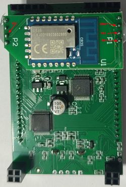

    Pinout for the CB3S board:
    CB3S module on green PCB with labeled UART pins: VCC, GND, TX1, RX1

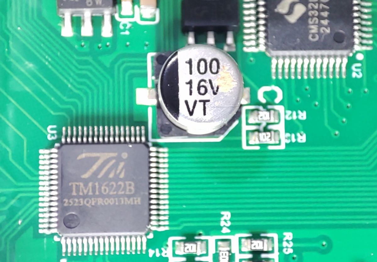

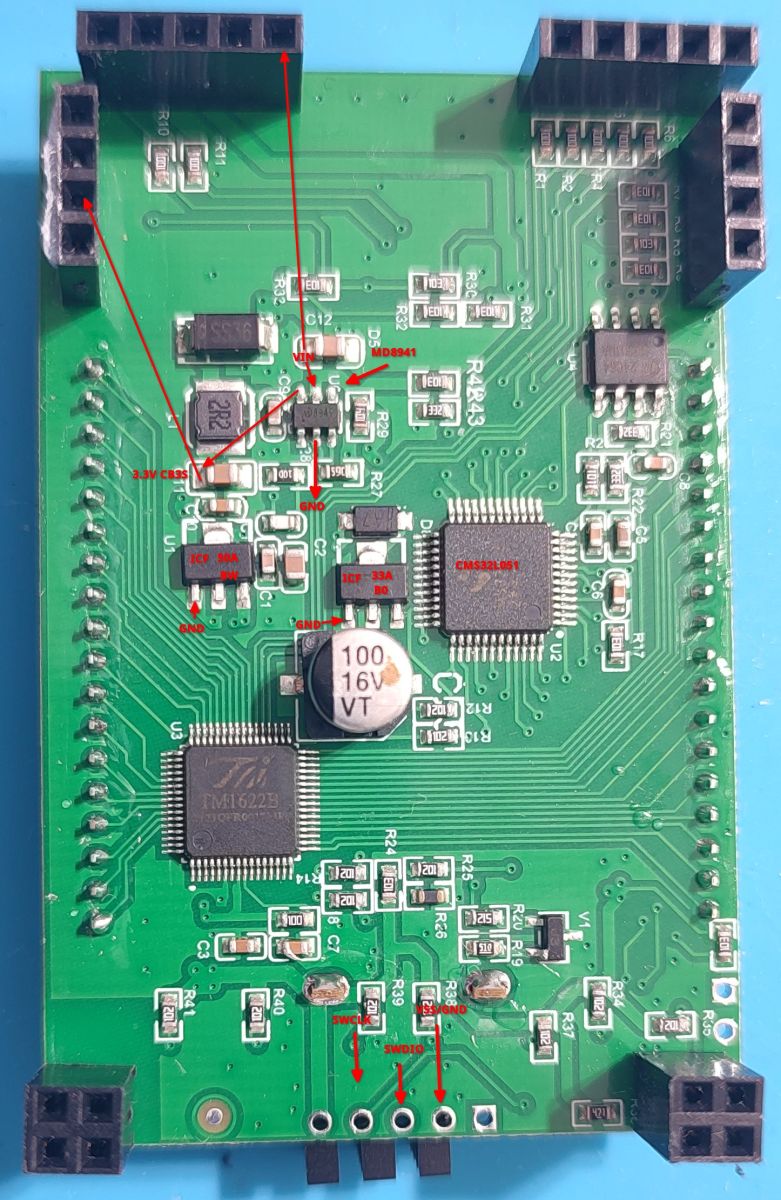

    Tuya MCU and the display chip:
    Close-up of a PCB with a 16V capacitor and TM1622B and CMS32 microchips visible CMS32L051 microcontroller mounted on a green PCB circuit board
    Main board with some pins labelled, for some reason it uses the DC2DC converter to generate 3.3V for the CB3S module, haven't yet found where the VCC for the MCU comes from, labelling on the top of the board suggest that it should be the pin on the far left, but it's not directly connected to the MCU and I did not have the time to trace it out yet.
    Seems to be pretty hackable considering that all you need (except the metering chip and RS485) is on this board.
    PCB with microcontrollers, header pins and labeled components

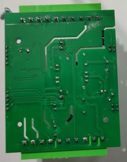

    Base board that holds the energy metering chip etc:
    Green printed circuit board underside with visible traces and solder points Renergy RN8302B integrated circuit on green PCB with visible surface-mount pins Printed circuit board with electronic components and green terminal blocks
    Sorry about the quality of the photos, lightning setup ...
