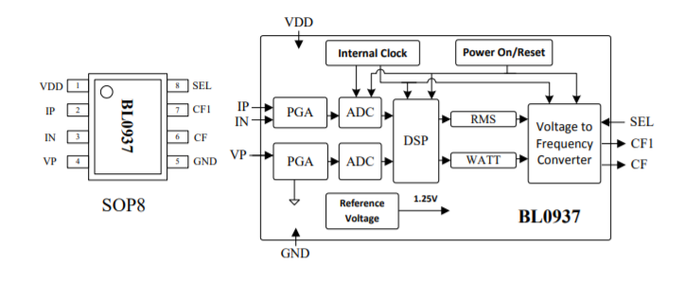

    I checked the datasheet for BL0937 and noted the position of the CF, CF1, SEL pins, it looked like they were connected to the pins leading to the wifi board.
    I was able to poke a meter probe in the gap to contact the pins in the positions they show on the datasheet and I can confirm they are connected to the wifi module, so I'm confident it is BL0937 hidden under the wifi board.
    It seems that it's sort of working... if there's no load, it shows Power=0.000000, when I add a small load it shows a value, when I add a larger load, it shows a value approx double... so it seems that power value is responding to the load, but it's way out of scale... is that possible? I can't make any sense of CF1 (voltage/current). The values are stable... it could just be that they're way out of scale?
    Using interrupts to measure PWM ticks feels potentially problematic; what is the PWM frequency? Does the CPU have enough clock rate?
    How do you read PWM on 2 pins at the same time? Do they both sample at the same time? Can interrupts interrupt eachother?
    Or do they take turns with timeslices? If CF isn't being constantly monitored correctly, it will not accumulate correct totals over long-term?
    Is this what other firmwares on devices that connect BL0937 to IO pins directly are doing? Tasmota/ESPHome also using this strategy? They're quite mature. Do we know what the stock firmware does?

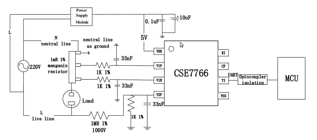

    Well, let's check the other supported energy metering chips...
    Exploring VKSELE (EARU?) BK7231T 2P DIN-rail Relay/Energy Meter: Teardown and Comparison
    It seems that the footprint is very similar in all cases.
  • #13 20293497
    TurkeyMan
    Posts: 59
    Rate: 9
    The first chip has 10 pins, so it's not that.
    The last one uses UART via opto-coupler which I didn't see, and only one wire connection. There are 3 connected, which means if it's that last chip, the positions for CF and RI are also connected... should they be connected to BK?
    I think it's most likely that it's BL0937... I can test if pin 5 is GND for further confirmation with a continuity probe.

    #14 20293514
    Posts: 14771
    Rate: 12914
    That aspect of schematic you can easily ignore. Tuya never uses optocouplers in such situations, after all, those devices does not feature a mains separation of the MCU side.
    Those signals should be connected to BK, but at the moment I don't remember if they connect them directly or (by any chance) through resistors. But we can check...
    Test it and we will see, that's always one more bit of useful information.
