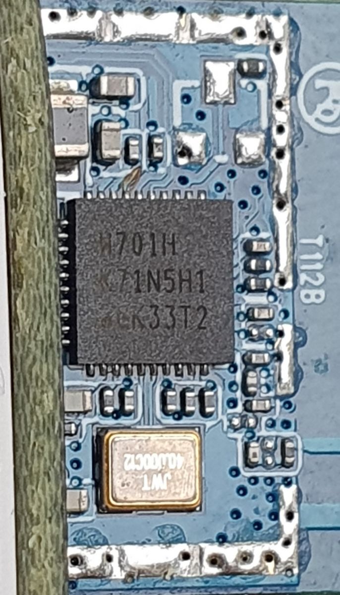

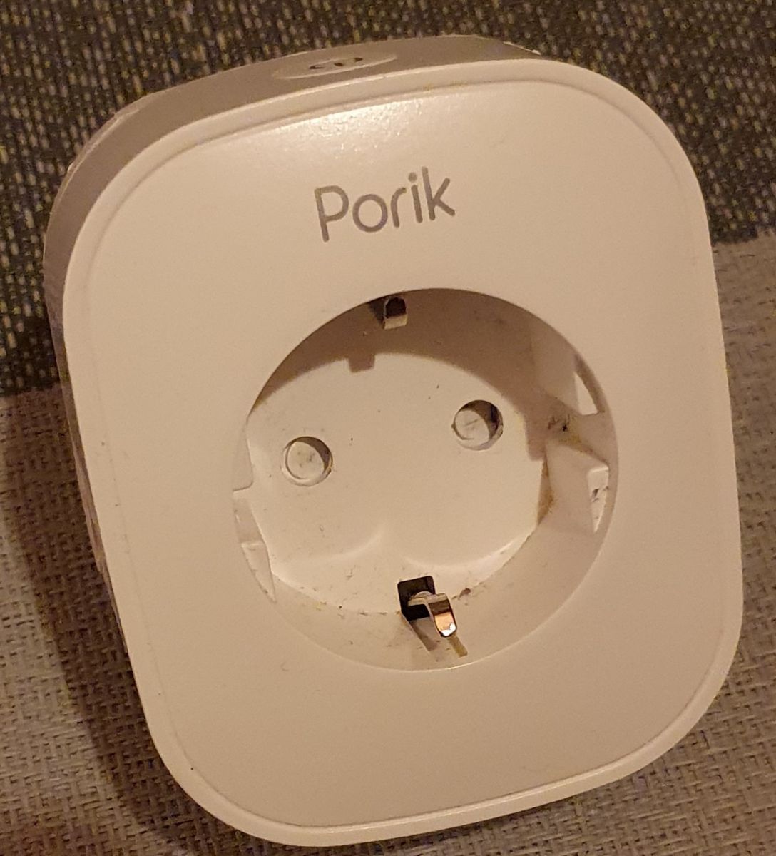

    Hi guys, I have been using a few smart sockets that I bought off Amazon. These are Tuya compatible white label sockets. I recently read about the possibility of flashing smart plugs with Tasmota so I was very excited and wished they would have some ESP chip inside but to my disappointment, it's some other Chinese module. The markings on the chip show W701H - K71N5H1 - GK33T2.
    I searched the chip model on the internet and the most results are about WBR3L or WBR2L. But the RF chip in these modules is W701H-VT2-CG. So I am a bit confused :( and have the following questions.
    -Are both these chips the same/similar?
    -Can you suggest any third party firmware that offers similar features as Tasmota or ESPHome?

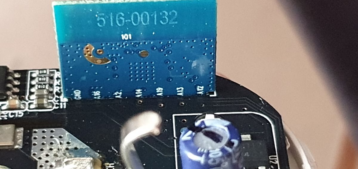

    -Lastly, can you give some tips how to flash this module as I don't see any exposed pins on the pcb. The only option I see is directly interfacing the RF chip.
    Here are some photos and thanks in advance for your suggestions :)
    Porik smart socket with visible electrical plug outlet.
    Close-up of an electronic module with a chip labeled W701H - K71N5H1 - GK33T2 on a blue printed circuit board.

    Close-up of an electronic module with a blue PCB labeled 516-00132.

    Thanks for your reply. So this means that it's not yet supported by OpenBK yet correct?
    Regarding the RF chip itself, another user also suggested that the W701H is RTL8720CF based whereas the post you linked mentions a BK7231N chip. Is there any way the exact chip could be determined through software?
    sorry, yes. the W701H is a Realtek RTL8720CF

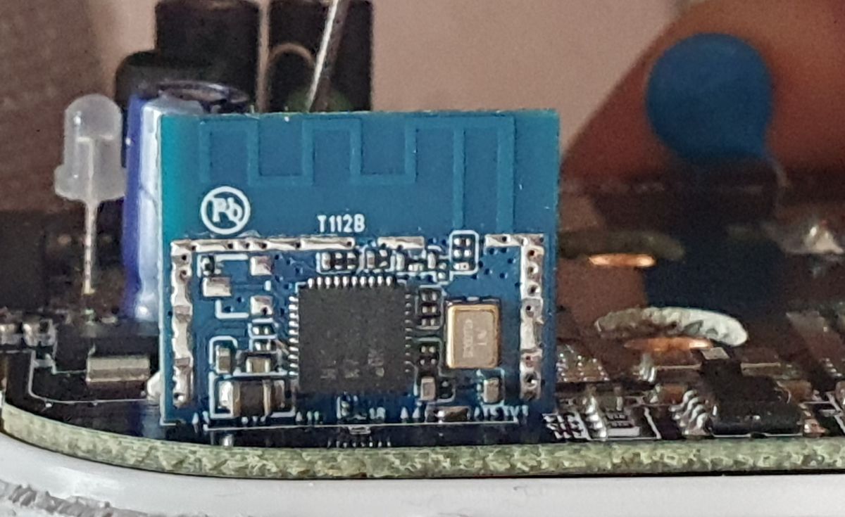

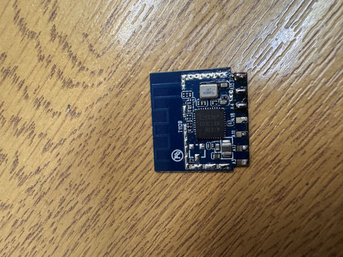

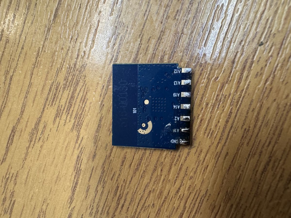

    Is there any way to flash these easily?
    I’ve got a couple and there appears to be no RX/TX UART presented (I don’t think I’ve got the skills to solder to the actual chip pins).
    [img-0] [img-1]
    A16 log TX and A15 log RX identified

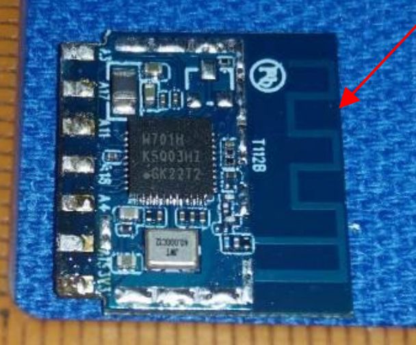

    T112B modules, specifically?

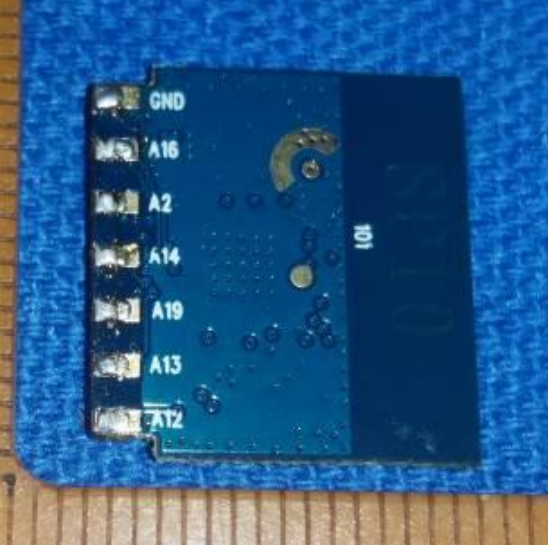

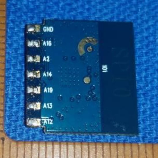

    SP10 electronic module with labeled pins: GND, A16, A2, A14, A19, A13, ATZ
    T112B electronic module with PCB antenna and H701H chip
    https://fccid.io/2APQK-SP10/Internal-Photos/Int-EUT-PHOTO-6026180

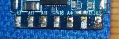

    I see an A16 (Log_TX) and I think the A15 (Log_RX). I don't see the A00 to be pulled high though but maybe it's like the WBR3 where an additional/other bootstrapping pin is used, IO13. https://www.elektroda.com/rtvforum/topic4097185.html

    Yeah, it's those ones. I was playing around with it, but as I can't properly reset it, I can't get to the necessary download area and keep a serial connection open. Did you manage to flash them?
    I will have to test that pin next time I look at them

    Close-up of bottom edge of blue PCB with eight pins and alphanumeric labels.
    A3, A17, A11, A18, A4, A15, 3V3
  • A13 pin needed for 3.3 V flashing
    #11 21734220
    gandi69
    Posts: 99
    Got one flashed. A13 is the pin to get to 3.3 V, like you suggested. Then just do a quick reset by pulling power, but make sure you keep power to the other pins:
    Config here

    Hi. Sorry I don't have any pictures of the inside of these, but they follow the same flavour as most others. Desoldering the main PCB is a must to get at the module out for flashing, though I guess you could make something to do this in situ with some wriggling. I don't even think they have a model number on the rear of the plug itself. I have a firmware backup I can send you directly.
