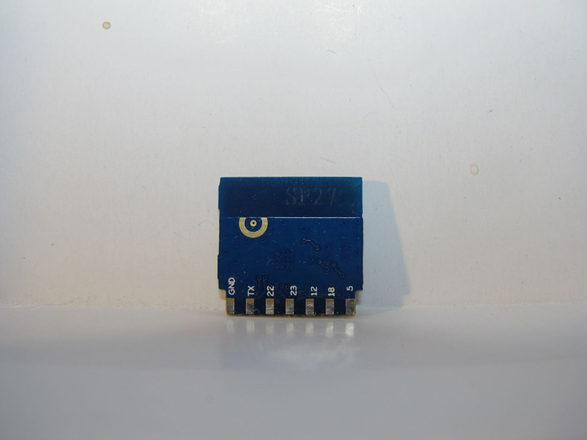

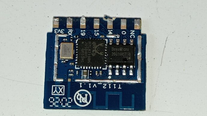

Is the T112_V1.1 module pin-compatible with any Espressif module such as ESP-02S or TYWE2S?
No—T112_V1.1 is not a drop-in pin-compatible replacement for ESP-02S/TYWE2S; it has a different pinout and is slightly wider, so you may need to solder wires instead of plugging it straight in [#20836499] It was only mentioned as possibly TYWE2S-compatible in Teckin SP23 discussions, but the thread consensus is that it is not like-for-like [#20835952][#20836811]

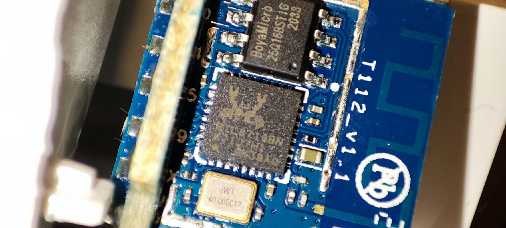

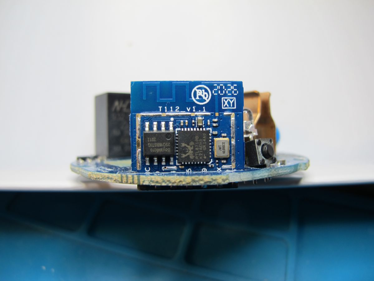

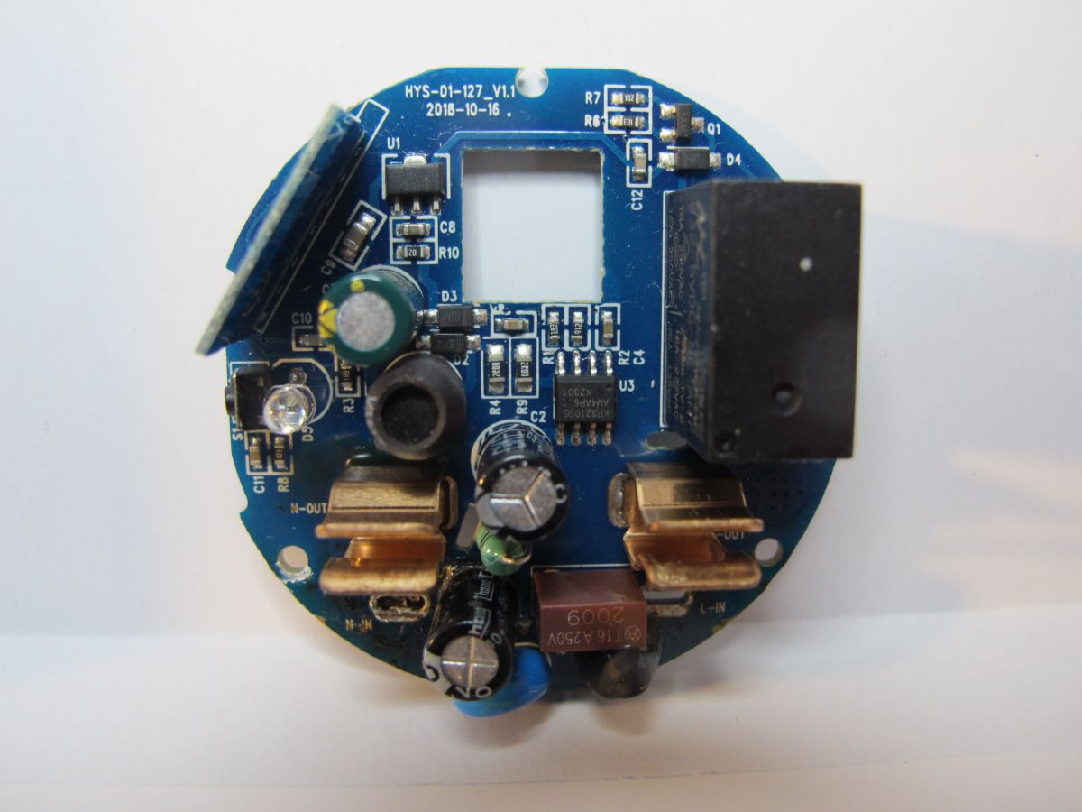

    I have two Teckin SP23s. Does anyone know if the T112_V1.1 module is pin-compatible with any Espressif versions?
    Close-up of the T112_V1.1 module with visible integrated circuits. T112_V1.1 module with BoyaMicro chip on a white background.

    Isn't it TYWE2S-compatible? So ESP-02S, etc?
    Btw, where did you get that modules? I need one to finish OBK port this platform.

    Not exactly a drop in replacement for esp-02s (different pinout & slightly wider).
    Might need to solder some wires to it

    Sadly, not like-for-like. I've seen a couple of posts about Teckins with this board that mention TYWE2S.
    https://github.com/ct-Open-Source/tuya-convert/issues/269
    https://github.com/arendst/Tasmota/issues/6434
    Regarding sourcing the T112_V1.1 board, I only have them inside the Teckin SP23s I got off eBay last week. The picture of one unsoldered is from a forum post somewhere :)
    I'd love for you to be able to develop OBK to include the RTLs, I don't want to get into ESPHome. Can you source Teckin SP23s? Are you in the UK?

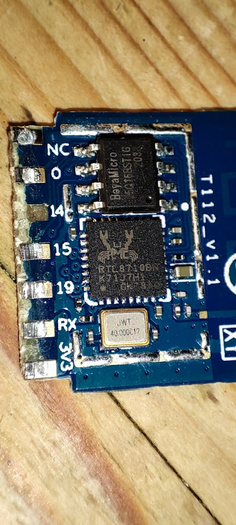

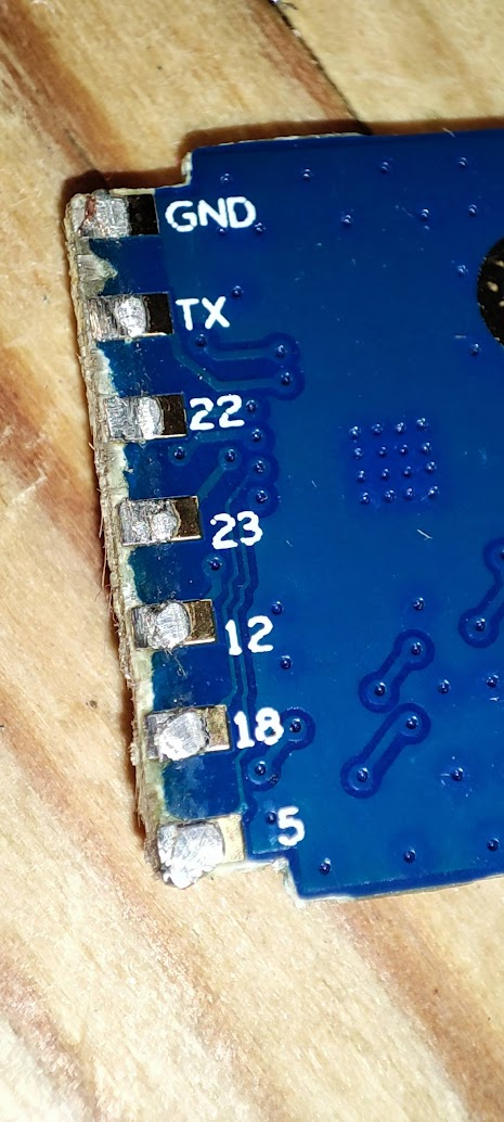

    It's out. Bit messy. Close-up image of a section of an electronic circuit on a printed circuit board with visible chips and connectors. Fragment of a blue circuit board with visible contacts and labels.
    DM me your address if still wanted.

    Well, I know how to regenerate a pad and only one is ripped so maybe that's not a lost case! I've send you a PM

    Can someone point me to a pinout? Where is the CEN pin?
  • #18 21732073
    Posts: 14770
    Rate: 12913
    Are you asking for T112_V1.1 module? Pinout is on the photos. There is no CEN, I think. CEN is Beken-specific....

    just pull TX2 (PA30) to ground at power-on. I never use CEN

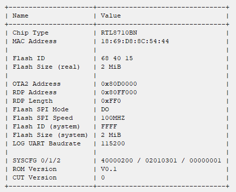

    I use a breadboard powered by an external 12 V power supply. How do I listen to TX?
The discussion identifies the T112_V1.1 module used in Teckin SP23 smart plugs as a Realtek-based board, not a direct pin-compatible drop-in replacement for ESP-02S/TYWE2S modules. It has a different pinout and is slightly wider, so wiring changes or soldered leads may be required. Later posts confirm the module boots as RTL8195A/RTL8710B-class hardware, and an OpenBeken template is shared for a similar Tuya smart plug platform using RTL8710B and BL0937 power metering. The thread also covers desoldering the module from the SP23 PCB, UART boot access, download-mode entry by grounding TX2/PA30 at power-on, and troubleshooting relay and power-monitoring configuration.
TL;DR: Teckin SP23’s RTL8710BN module boots with a 40 MHz crystal and logs "TUYA IOT SDK V:2.0.0"; validate via UART before any ESP swap or OBK flash. [Elektroda, divadiow, post #21376313]
