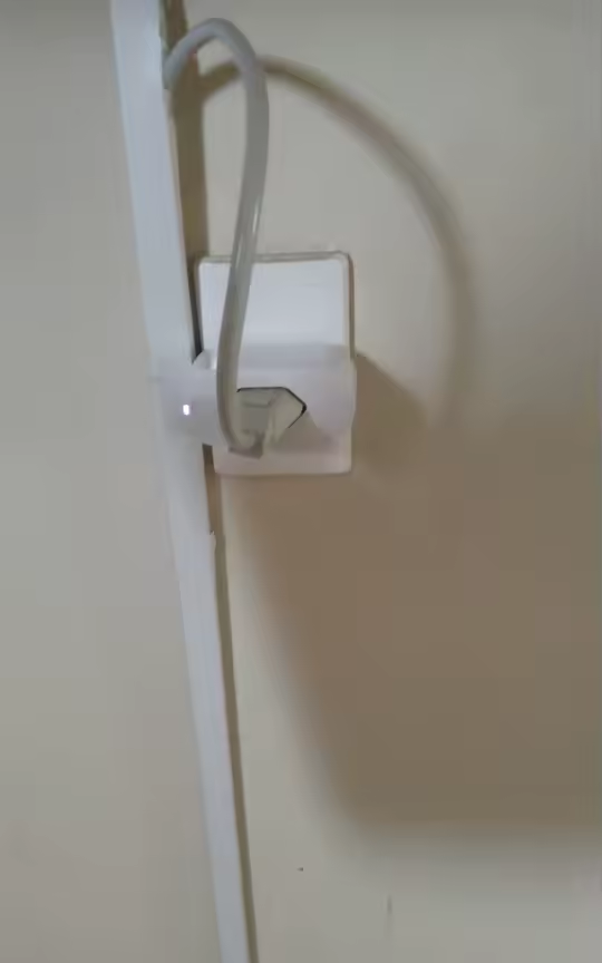

    Thanks for sharing, do you have some photos from device teardown?
    Don't forget to use PowerSave 1.
    Do you have 16A or 20A version? In title it looks like you put 20A. I wonder if they are both internally the same.
    Here are some extra photos from given link:
    Two smart plug boxes on a wooden shelf below a TCL television
    Plug with white cable connected to wall socket
