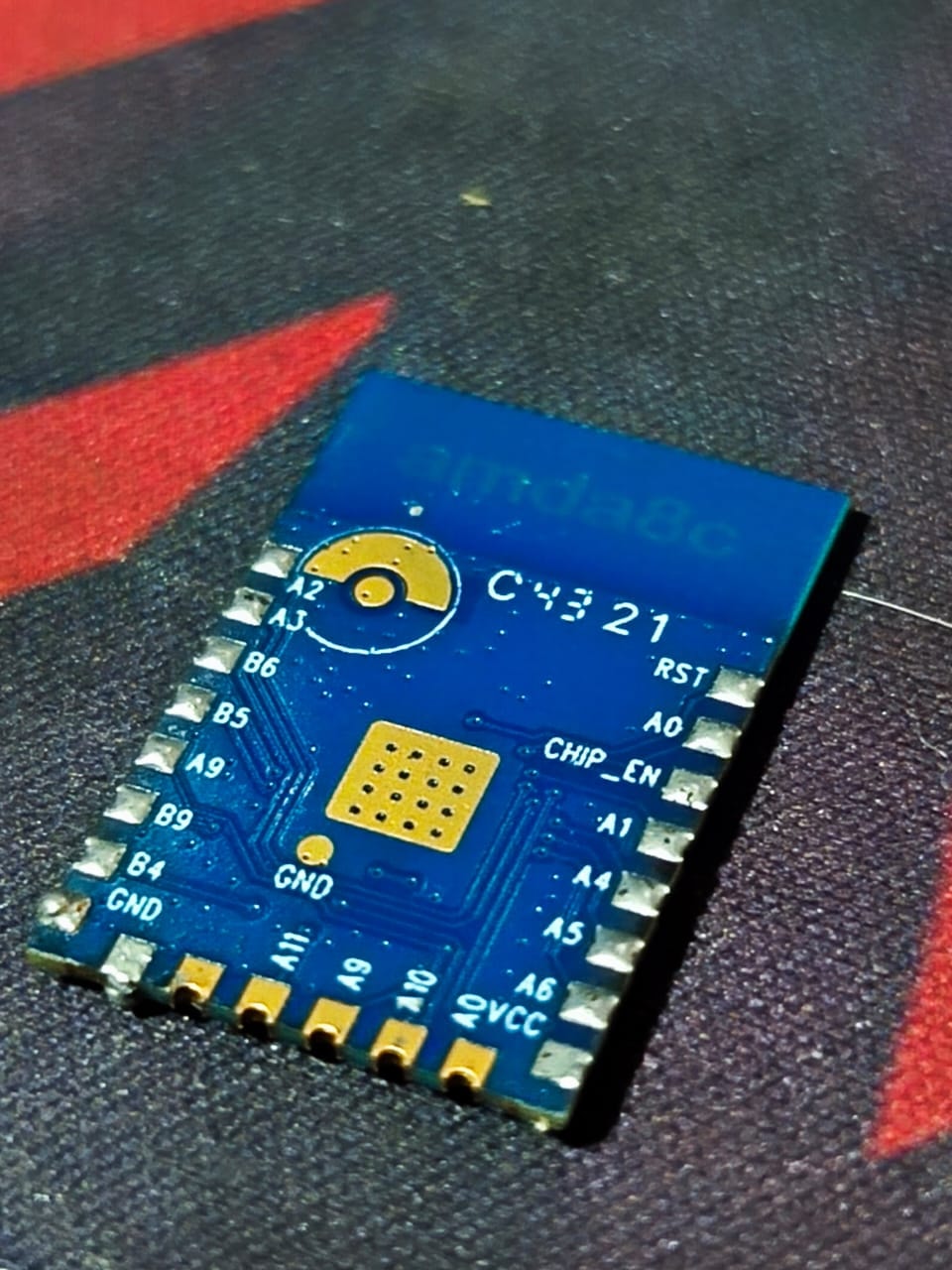

The WB03A module is identified as an LN882H module, not BK723x or ESP8684, and it uses a QFN32 chip with a 40 MHz crystal [#21839017][#21839043] For wiring and flashing, use A3 as RX, A2 as TX, and A9 as BOOT; connect BOOT to GND before powering up to enter flashing mode [#21839043] To capture boot logs, a USB-UART adapter and a terminal app can be used, with 115200 or 921600 as likely baud rates [#21839017] After backing up the firmware, enable flag 13 in the OpenBeken web app and watch which GPIO changes when pressing each button to map buttons, LEDs, and relays [#21908614]

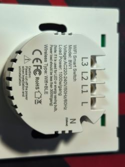

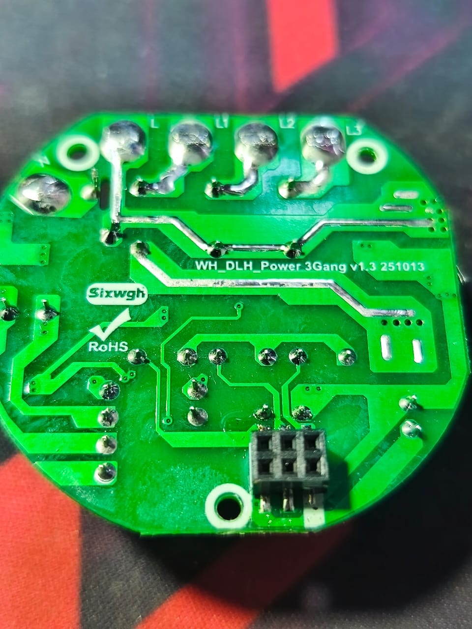

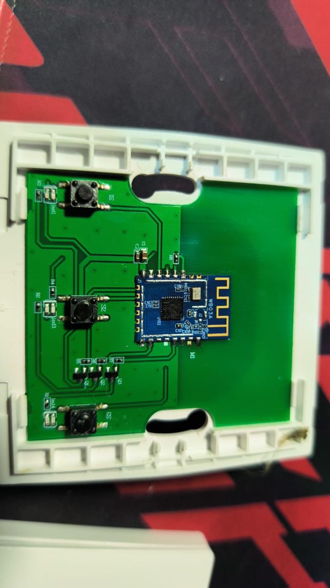

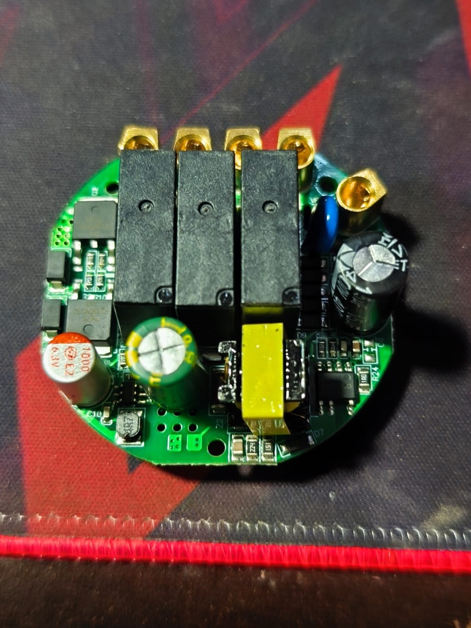

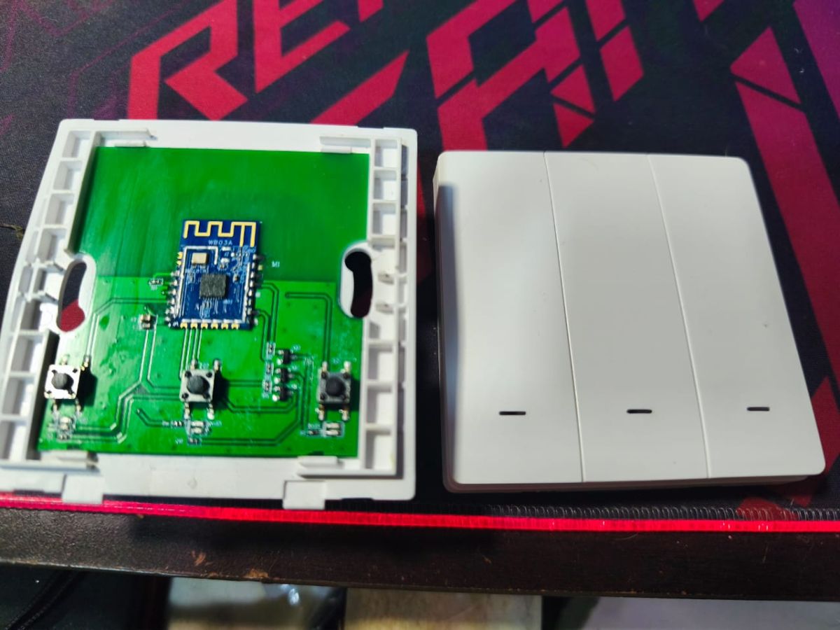

    I got a new 3-gang switch, but this chip is labelled WB03A. I really need help
    Opened three-gang wall switch: green PCB with radio module and three tactile buttons next to the cover
    on its pinouts to solder and what kind of chip this is. Back of a “WiFi Smart Switch” BW1 module with terminals labeled L, L1–L3, and N
    Blue WB03A electronic module with PCB antenna on a green printed circuit board
    PCB in a white case with three tactile switches and a blue module with a printed antenna

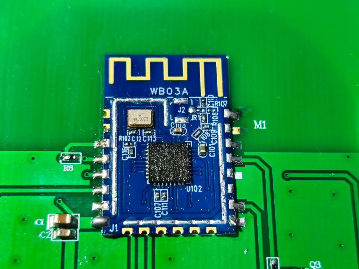

    Maybe an RTL8720CM?
    is there any readable text on the square black chip? I can't see anything in the pics.
  • #3 21836710
    insmod
    Posts: 1432
    Help: 168
    Rate: 455
    Definitely not BK723x (26mhz XTAL), RTL8720CM (requires external flash chip) or RTL8720CF (QFN40). This one is QFN32 with 40mhz XTAL.
    W800? LN882H?

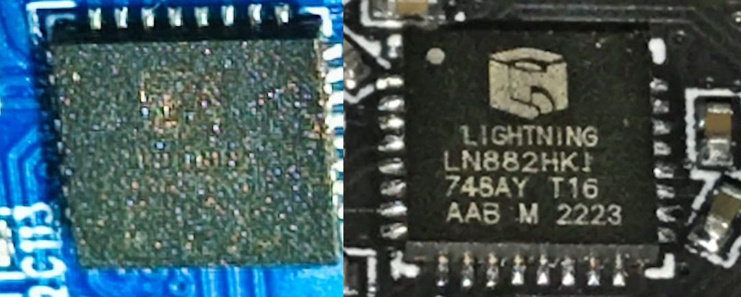

    kinda looks like a Lightning Semi cube
    Close-up of two PCB chips, including one labeled “LIGHTNING LN882HKI”.

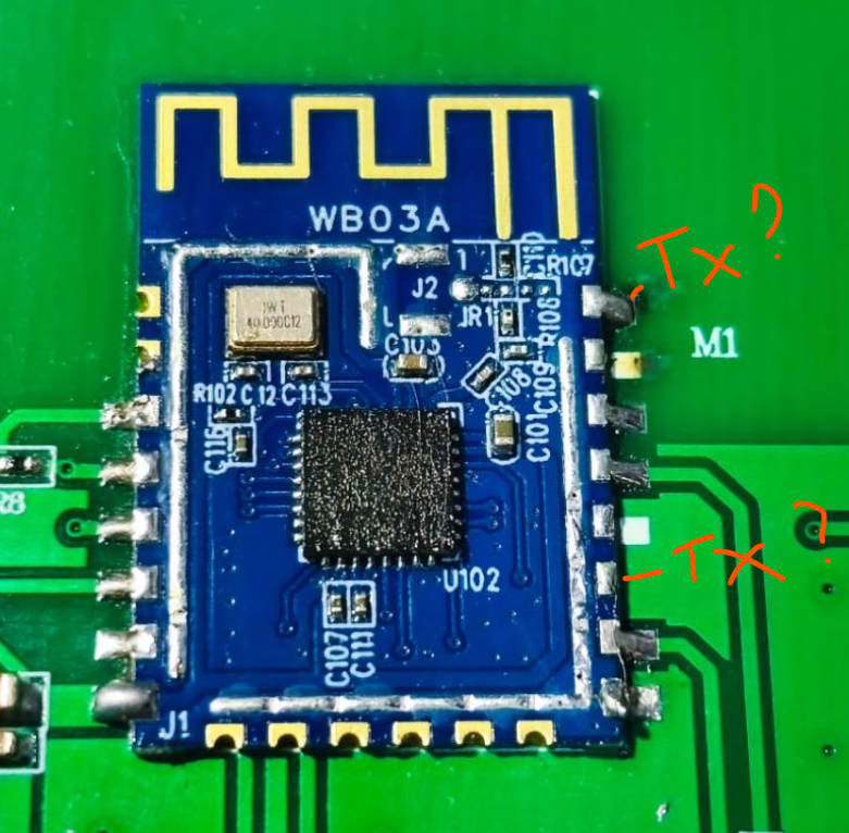

    anyway, you could just capture boot log. Maybe from one of these if theyre TXs like other 12F modules
    Close-up of WB03A PCB module on green board with red handwritten notes “Tx?” and “-Tx?”

    Doubtful, if Tuya.
    ESP8684 is QFN24, your is QFN32.
    Plus, it almost always comes with 26MHz XTAL, you have 40MHz.
    To capture logs, use any terminal app and USB-UART converter.
    Possible baud rates - 115200 and 921600.

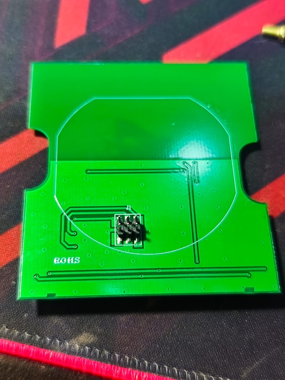

    >>21839017 I managed to desolder the chip, here is the rear view. I really don't know which one is TX and RX.

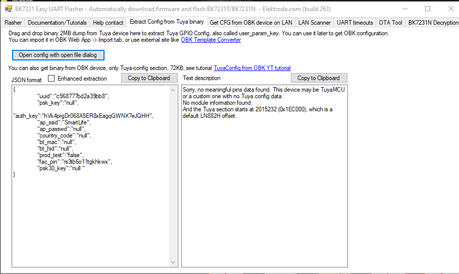

    >>21839047 Oh, no.. Now I’m really stuck.
    WB03A Chip Pinout and Identification for 3Gang Smart Switch Soldering
    Sorry, no meaningful pins data found. This device may be TuyaMCU or a custom one with no Tuya config data.
    No module information found.
    And the Tuya section starts at 2015232 (0x1EC000), which is a default LN882H offset.
    readResult...-48-07.bin (2 MB)You must be logged in to download this attachment.

    enable flag 13 then watch to see which pin's logic level change as you push each button on main gui page. then you've nailed your buttons.
    use GPIO dr/finder in web app to find LEDs and relays. bear in mind you only have the pool of pins labelled on rear of module to check.
    A1 should be one your buttons, I've reset your dump with it to get this clean boot log:
